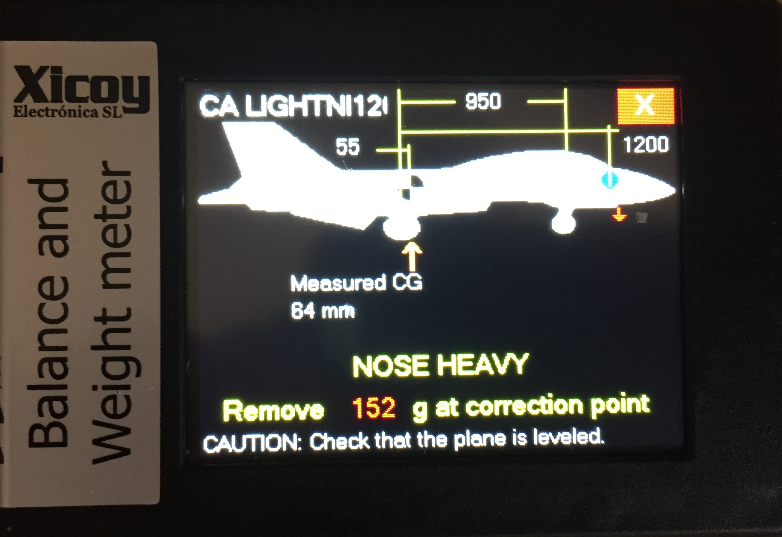

I'm about to maiden my Ultra Lightning. I've set up my CoG based on some of the older threads I've seen here, and cross checked that against what is in the manual for what I assume is wings on (it doesnt actually say that), ie. 15mm back from leading edge of inner gear door line.
Can anyone give me a tested CoG position with wings on and gear down? I'm using one of the Xicoy CoG meters, so if anyone has CoG setting for that it would be much appreciated!

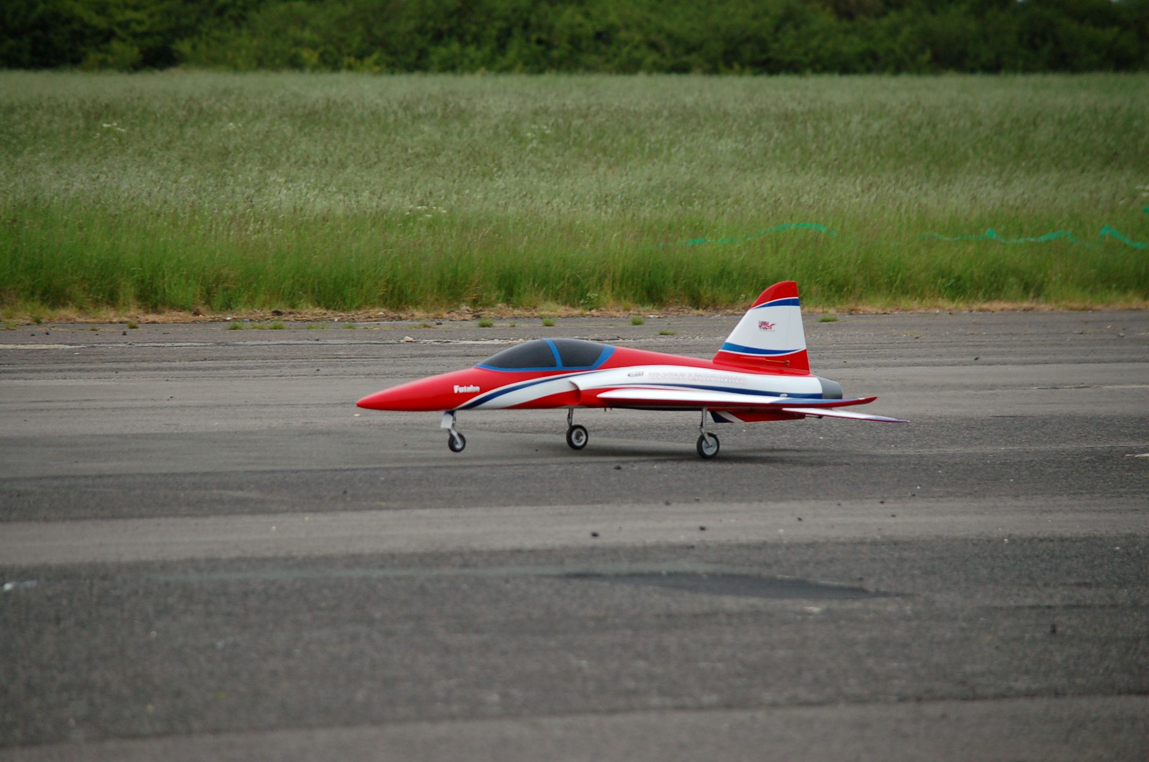

The ones I test flew were set at 15mm behind the door lip, but I think you can go further back-20mm. Wings off, its just behind the centre of the wing tube.
I'm sure Geoff will chip in if he sees this, he's flat out working before going to a meet in France tomorrow. He was flying his Saturday at a show here in England.

Thanks, but we would realy like to know what all the before mentioned wings-off/on measurements are equavilent to when the UL is sitting on it's wheels on top of a Xicoy cg balancer.

With this balancer you need to stand it on its wheels to get the axle position, seen pictures of models upside down measuring distances, this does not allow for wheel movement. Also the UL axle moves back a good distance with weight on it.

Thanks guys, but my understanding (or reading of the unclear manual) is that the 15mm aft of the leading edge of the gear door is with wings on, gear down. Can someone confirm this? If not what is the CoG position with wings on and gear down. As Jan said above, I want to put this on a Xicoy CoG meter, which you need the wings on for. I'm totally fine with how to use the Xicoy unit, just need to confirm the correct CoG position.

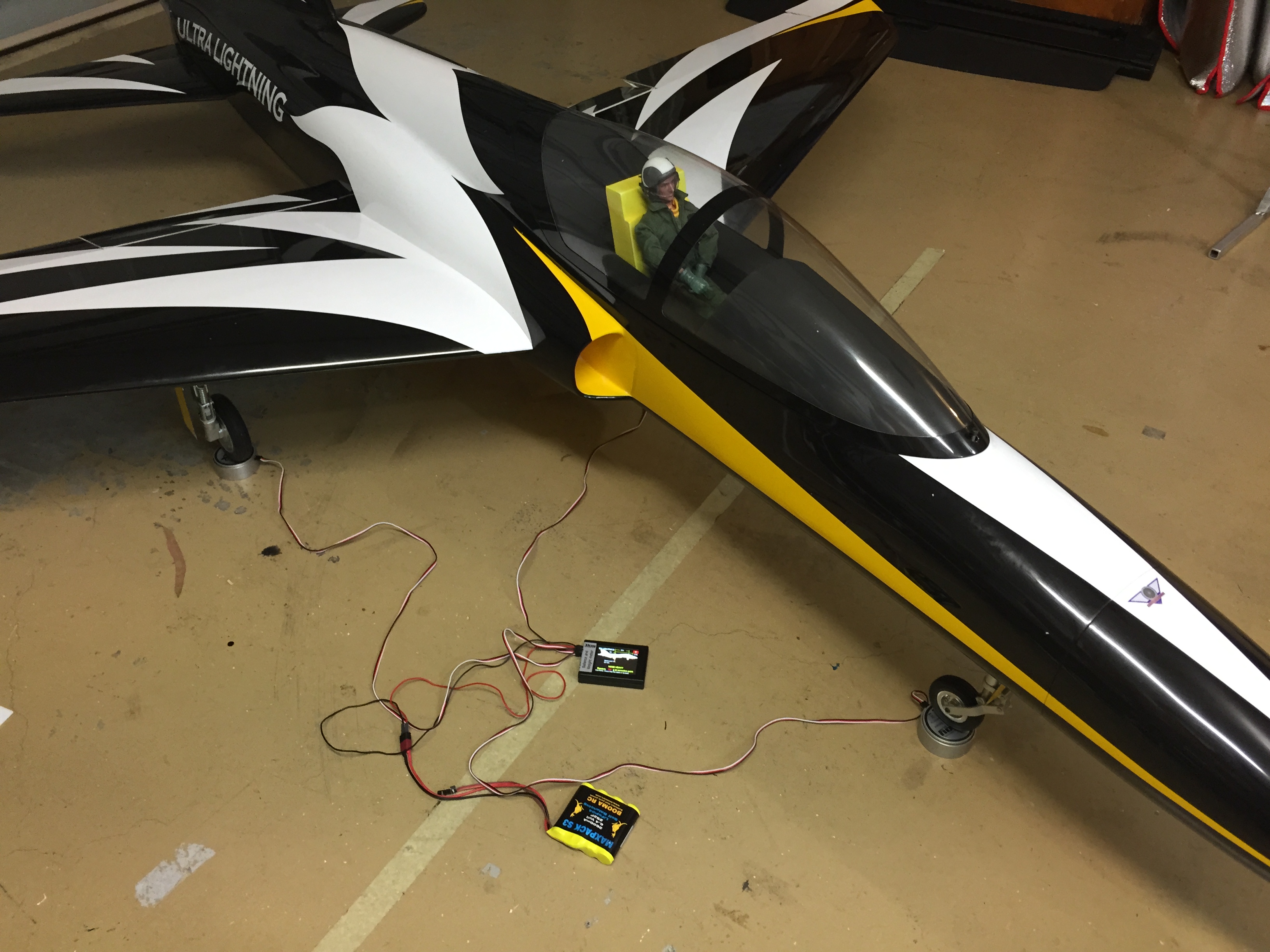

CARF finally got back to me and confirmed the 15mm back from inner gear door leading edge lip is with wings on and gear down. I did the COG the standard way first with wings off, nose gear down, on the wing tube. This equates to a wings on point probably 5-10mm forward of the 15mm reference point (as you can see from the Xicoy screen shot below). Given most seem to move it a little back from that point after flying, this seems right. For those that want to use the Xicoy unit for CoG the attached photos will give you the settings. I did the maiden flight today with it as shown below, and it flew beautifully. That said, I will move it back a bit from here.

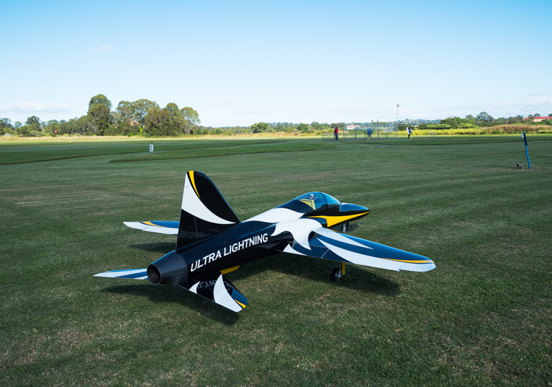

A few photos from my maiden flight today. The UL flys beautifully. I'll do a few tweaks for the next flight (more flap, more elevator compensation, and maybe more crow), but even as it was today it is an awesome plane to fly.

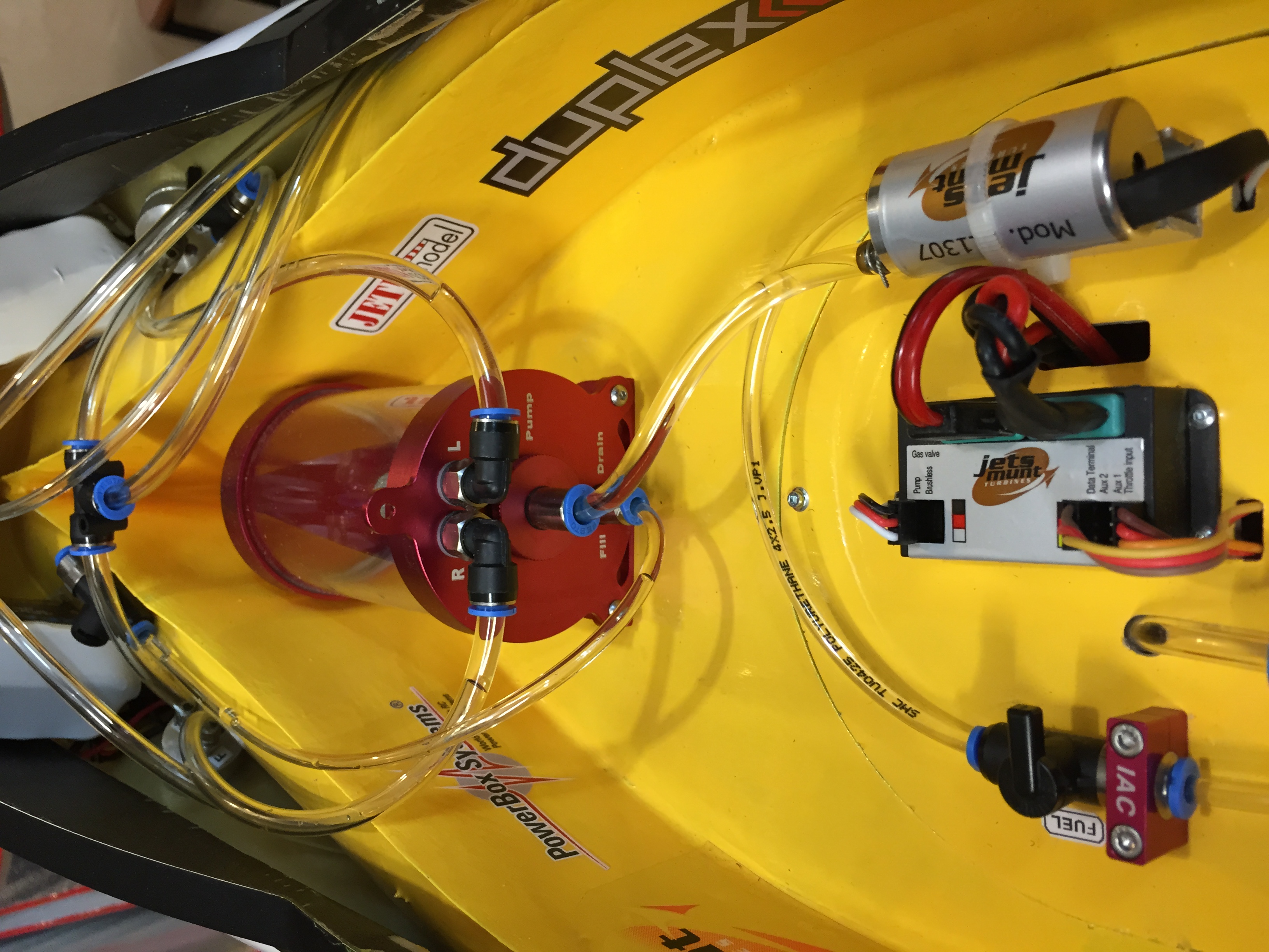

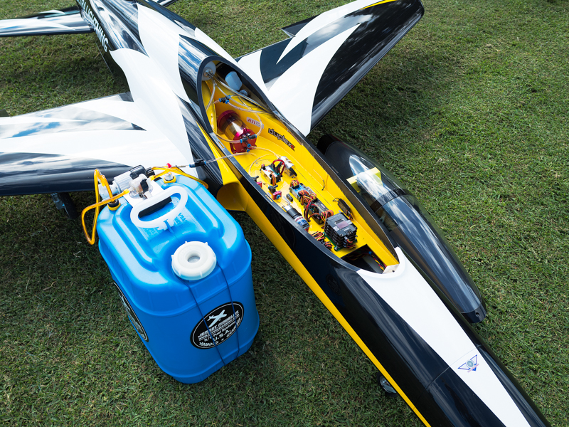

Hi Craig... thanks mate. I'm running a Jets Munt 200XBL (thought I'd try one of these rather than my usual Jetcat), Jeti RX gear (I've gone across to a Jeti DS-16 Tx from my Futaba 18MZ, still have the Futaba, but really love the Jeti system). Battery, Airspeed and ECU telemetry. Electron retracts, servo operated gear doors, Powerbox smoke pump, Intairco air trap (I'm using the standard CARF air trap as an air trap for the smoke).
Good point on the Festo fitting, well spotted. There is a bit of sideways on it (better photo below), but a solid fit and it doesn't feel like the connection is under any significant side load. No leaks at all on the maiden, but I'll take a closer look at it and make sure it comes straight out - maybe put an elbow on it.
