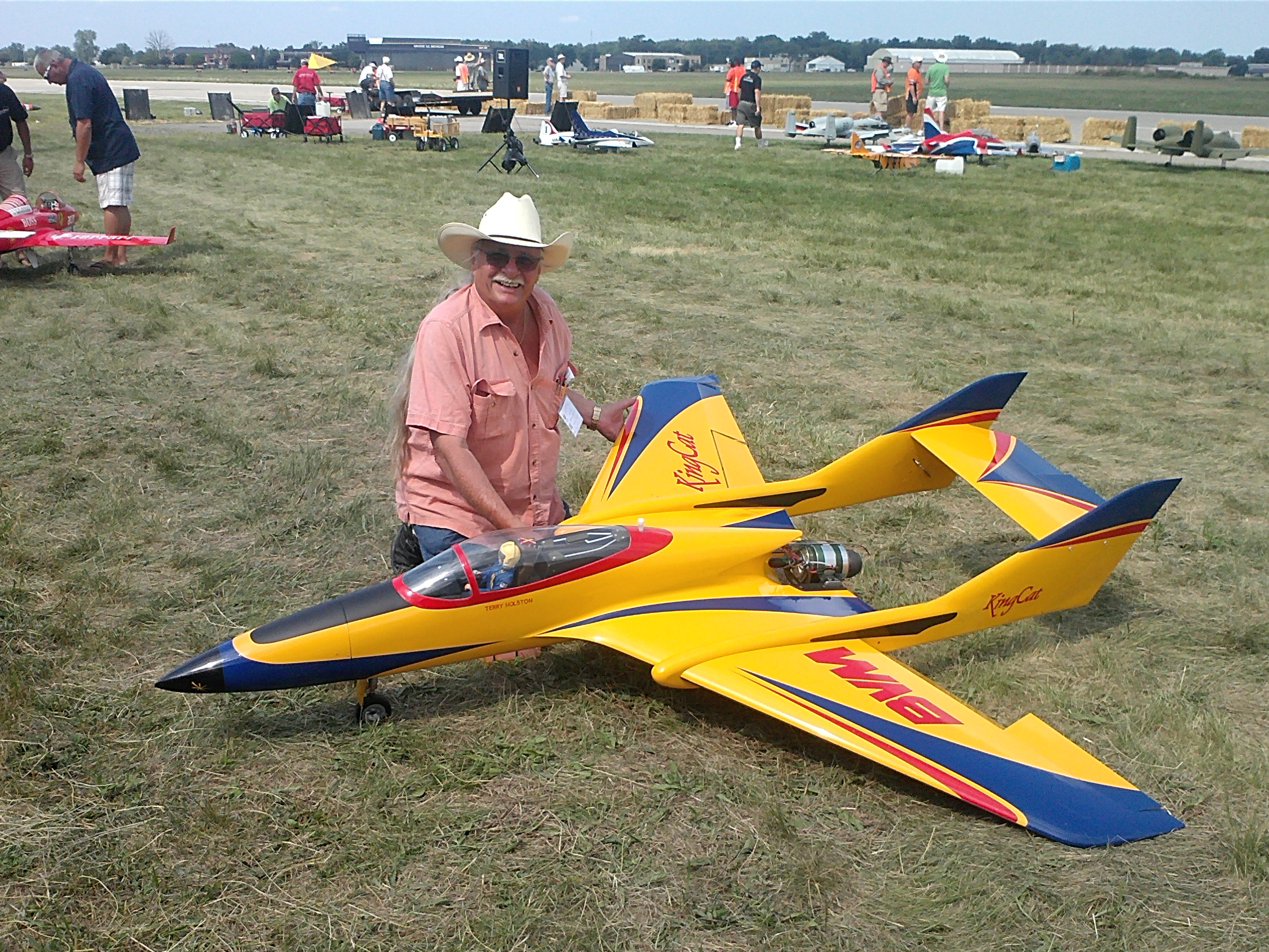

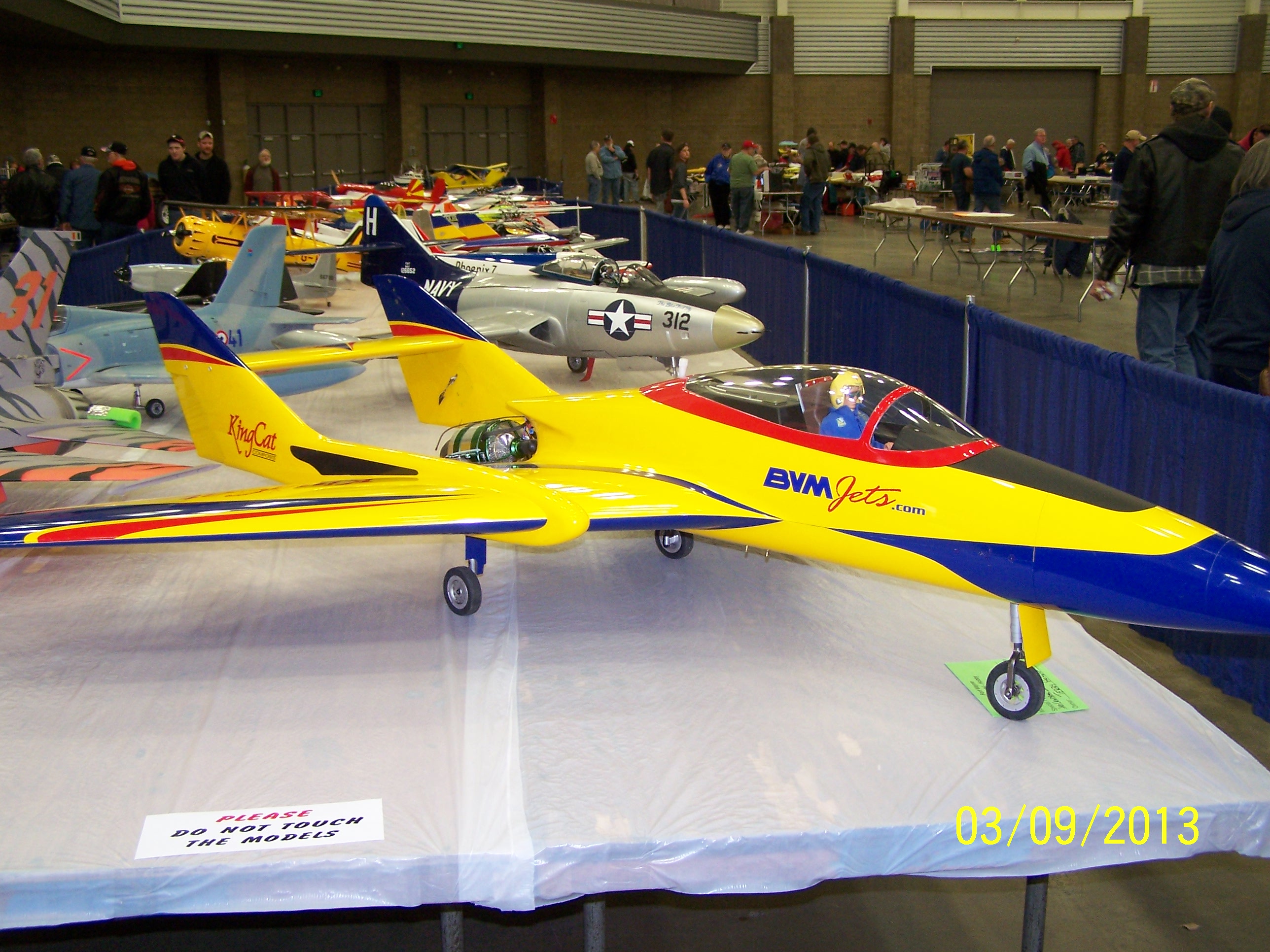

I repaired the booms on my Kingcat and fixed the paint with One Shot lettering enamel. I brushed it on over the repair and then lightly sanded it down with 600 wet or dry. After hand polishing with rubbing compound, very few people can see the repair even when I point it out.
