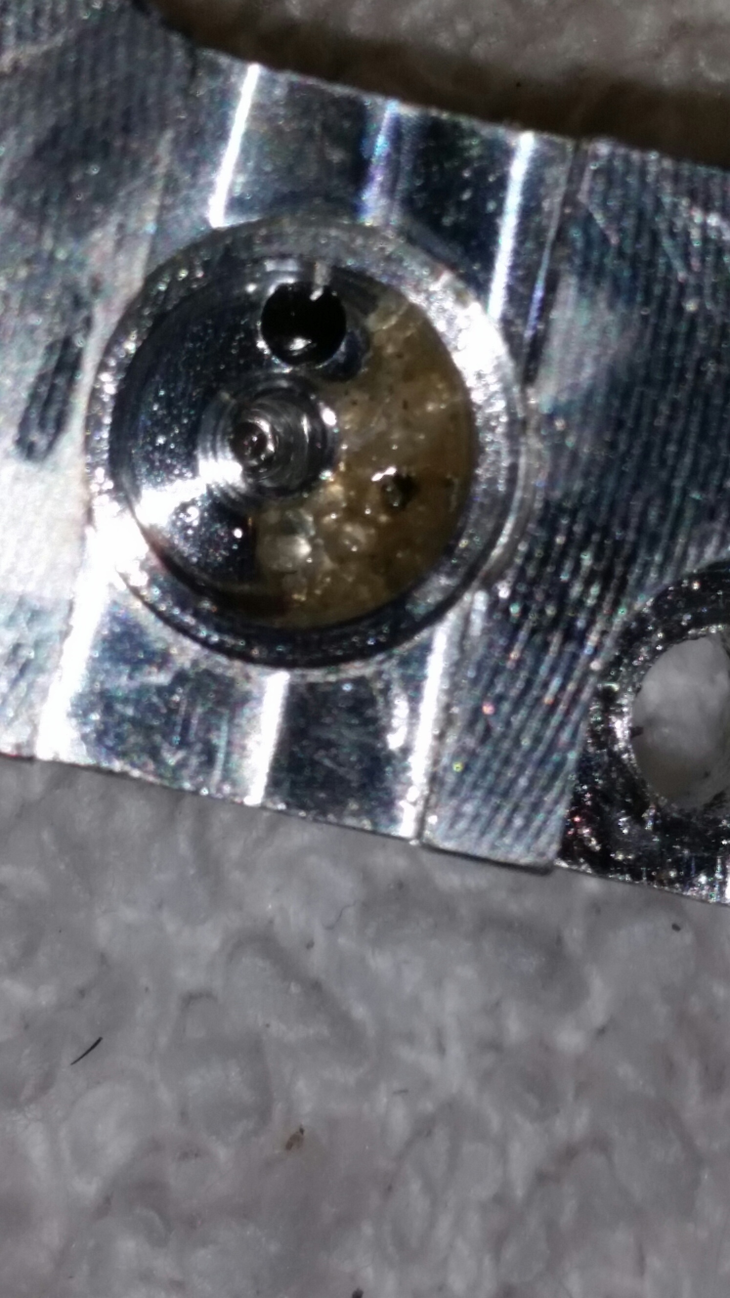

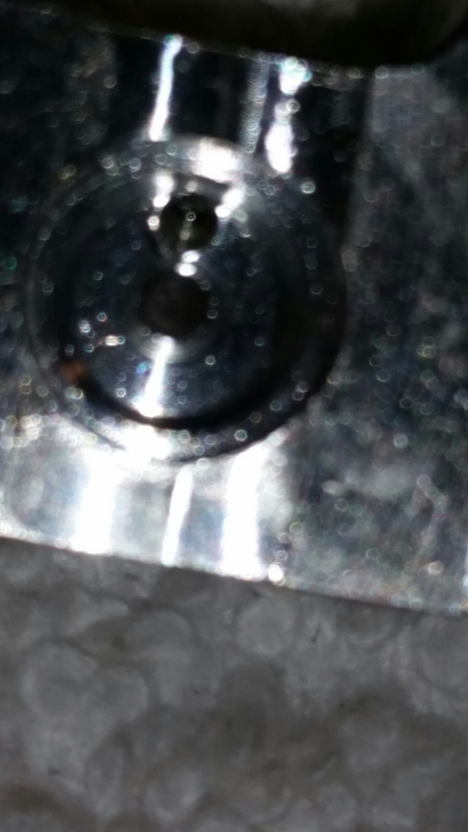

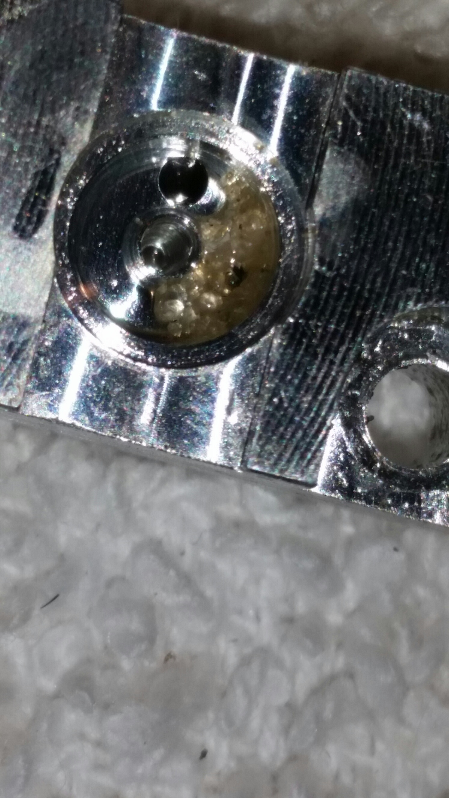

Like Flyinfool & Gary stated, I have seen many valves that were supposedly broken but actually quite the contrary, I have found slivers of fiber glass, fuel tube and most recently, appears to be algae goop from old bad fuel keeping the valve from doing its job. I know we all use fuel filters and I have no idea how this stuff gets past the filter, but I find debris all the time stuck in the valves.
