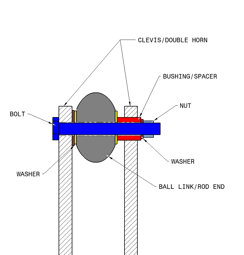

Fender you can cut and grind carbon with common Dremel tools, if you want to take that path. If you want to minimize control loss, use a slip fit bushing/bearing rod end.

Yeah, I have cut carbon fiber with a dremel before just hard to cut 14 pieces the same shape and get the holes drilled the same. Don't suppose you have a picture of the slip fit thing you are talking about. Im not understanding what you mean. I need as tight of fit as possible, im trying to get down to servo gear slop only. Which I had but apparently wasnt good enough, so im going with more mechanical advantage.

Here you go Keith. The control links in your AH-64 follow this design, and ironically.....my FLY EAGLE F-35 had this hardware included. Have never seen another model with stuff like this included.

The idea is, you dont want to load the clevis, you want to load the bearing. The bushing allows you to torque the ball link without preloading the bearing. This configuration works for double horns, which is what I think you are trying to do. If youre doing single....disregard, you can then use a servo eyelet on the horn side.

ahhh okay gotcha I thought that might be what you were getting at, yeah im using a double setup with the ball in middle.

Falconwings I don't get it. Is the ball supposed to be able to rotate, or are those spacers there just to provide clearance for the ball link? I don't see how torquing that bolt and nut would pre-load a ball link?

Matt, you only use one spacer on one side. When you tighten the bolt, it puts pressure on the spacer but the spacer slips inside the clevis ID, so it doesnt get preloaded. A preloaded clevis will lead to early wear of the bearing, deformation and eventually unwanted slop. So if you want ultra precise control and minimum slop....that's the way to go.
