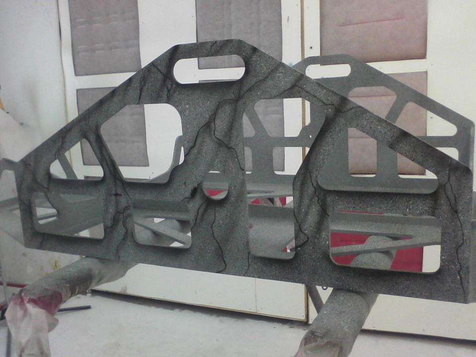

If you want to get really fancy with an airbrush you can do the grey, then black, then white speckles, go in and add some staining, cracking, and highlights for that stone look. This was a laser cut cradle for a comp arf tutor.

Thats pretty cool right there! I have always tried to save weight at the cost of the bling and pretty inside paints myself. That being said after my last two builds I am going to start doing this kind of thing to my builds. The weight cost is very low and it can really help make even the uglest installions look proffessional
Plus I would eventually like to start building and testing for folks so this is a must for the Jet connoisseur And thats okay in my book, what ever makes you happy is what it's all about! Have fun, be happy fly smooth!

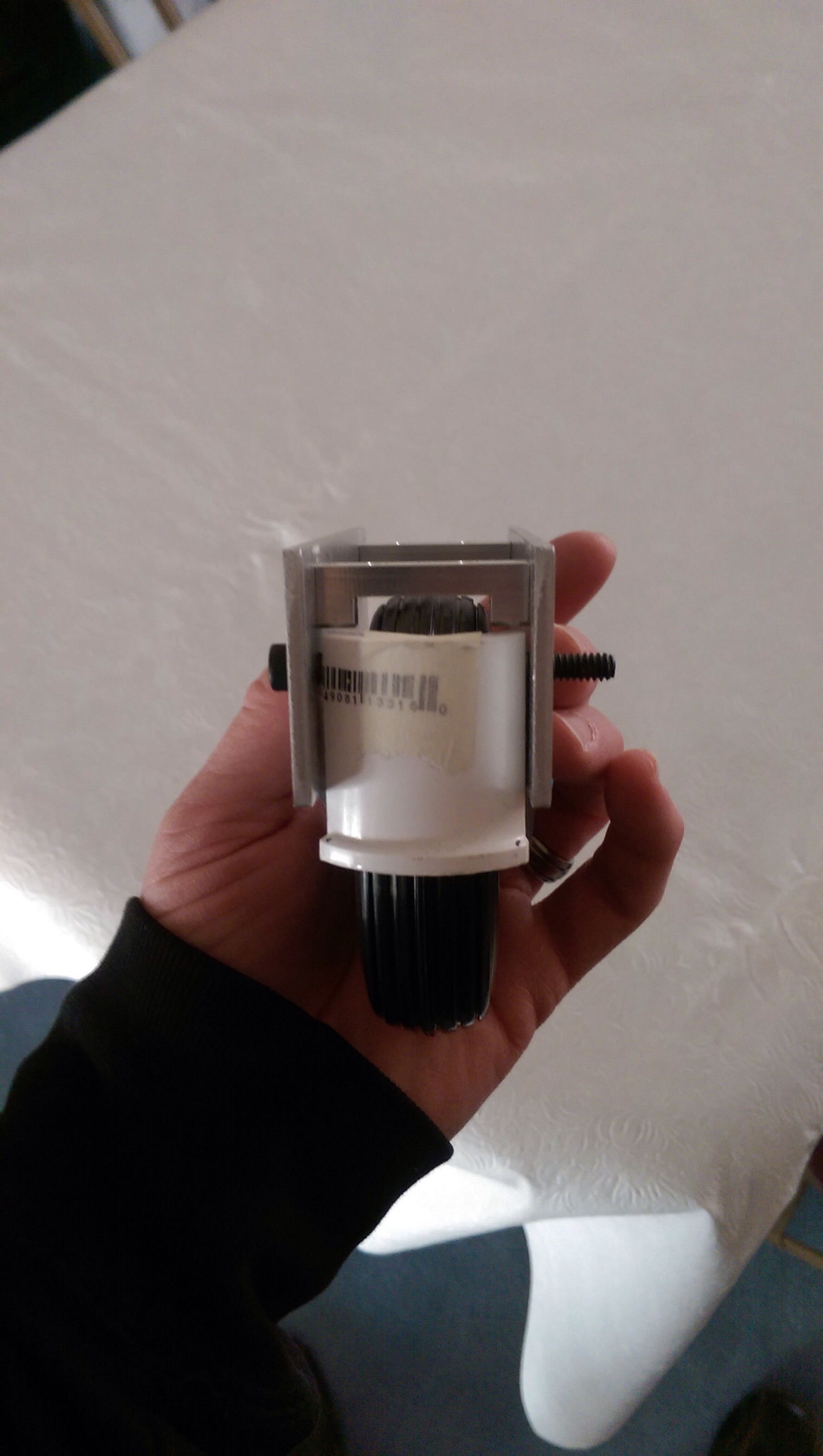

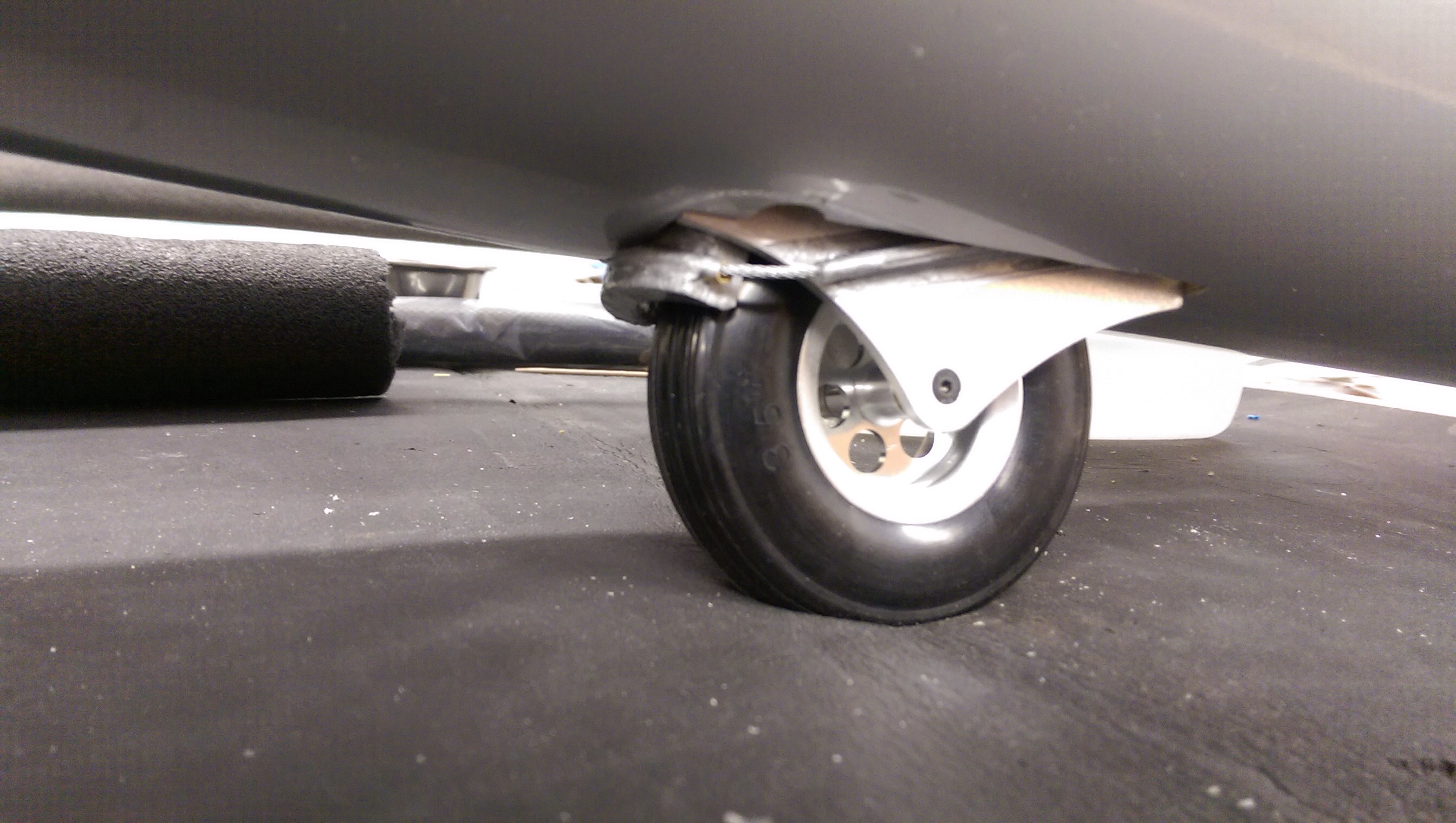

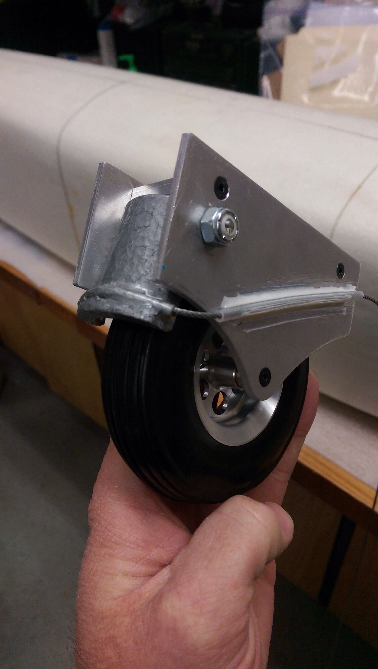

What about hammer paint? I have used this on the inside of my jets, but here it is on the home made brake on my Blanik.

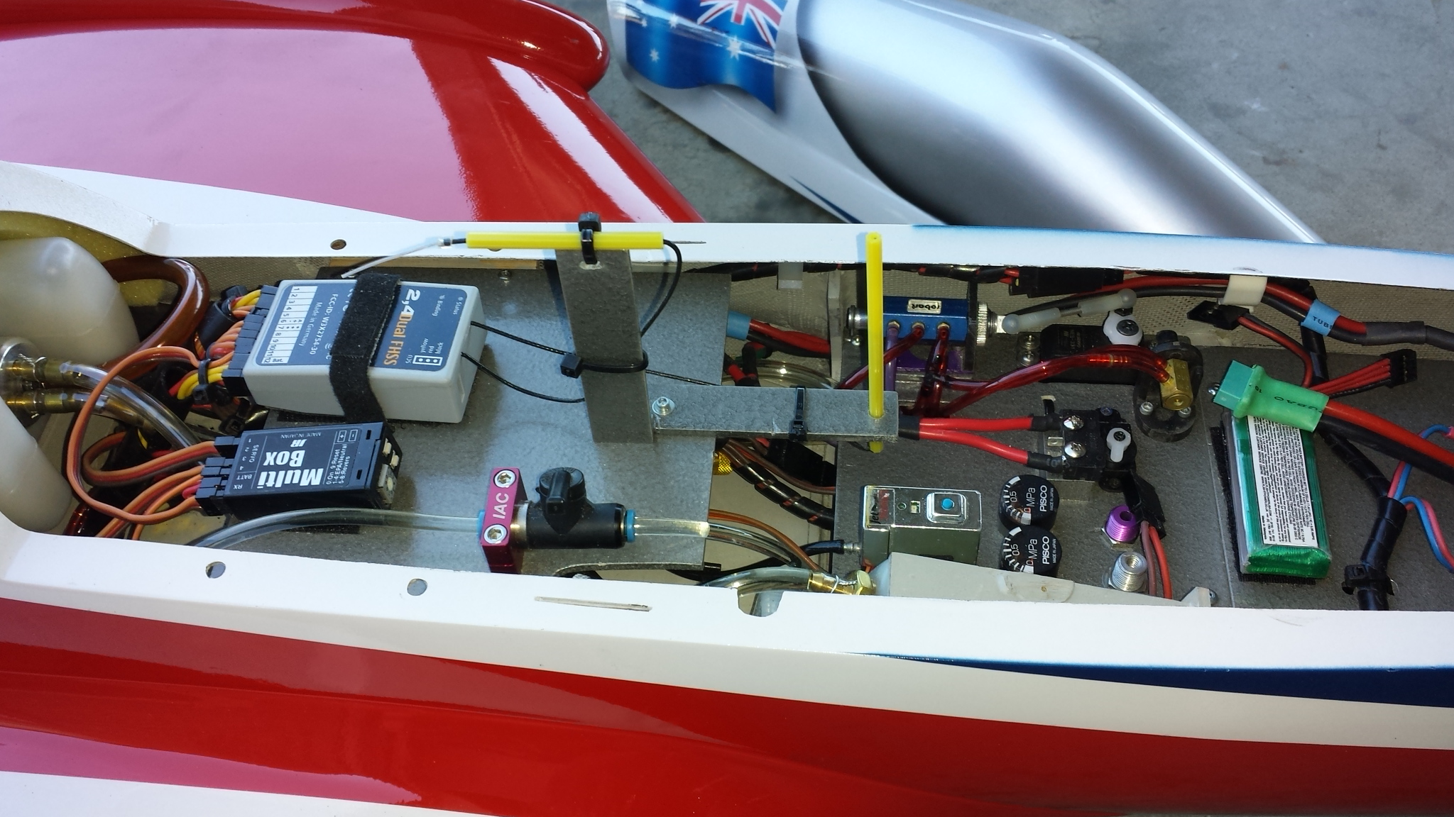

I used a "hammer" grey out of a rattle can, on my last build to finish the ply radio trays.. Came out great.
It is easy to apply, just prime the ply, sand with 400 and spray on the hammer. This paint hides all the grain and imperfections of the ply.
