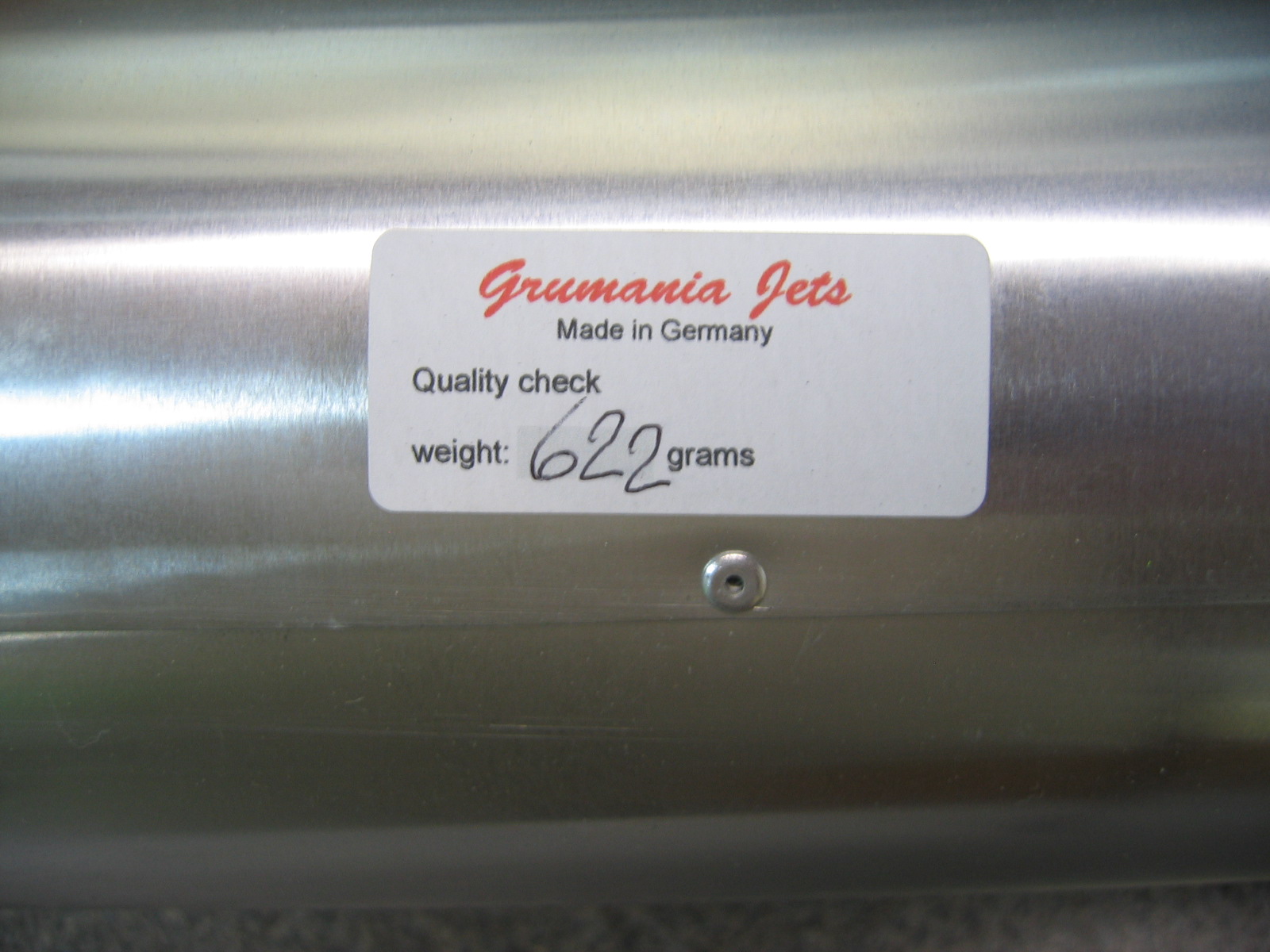

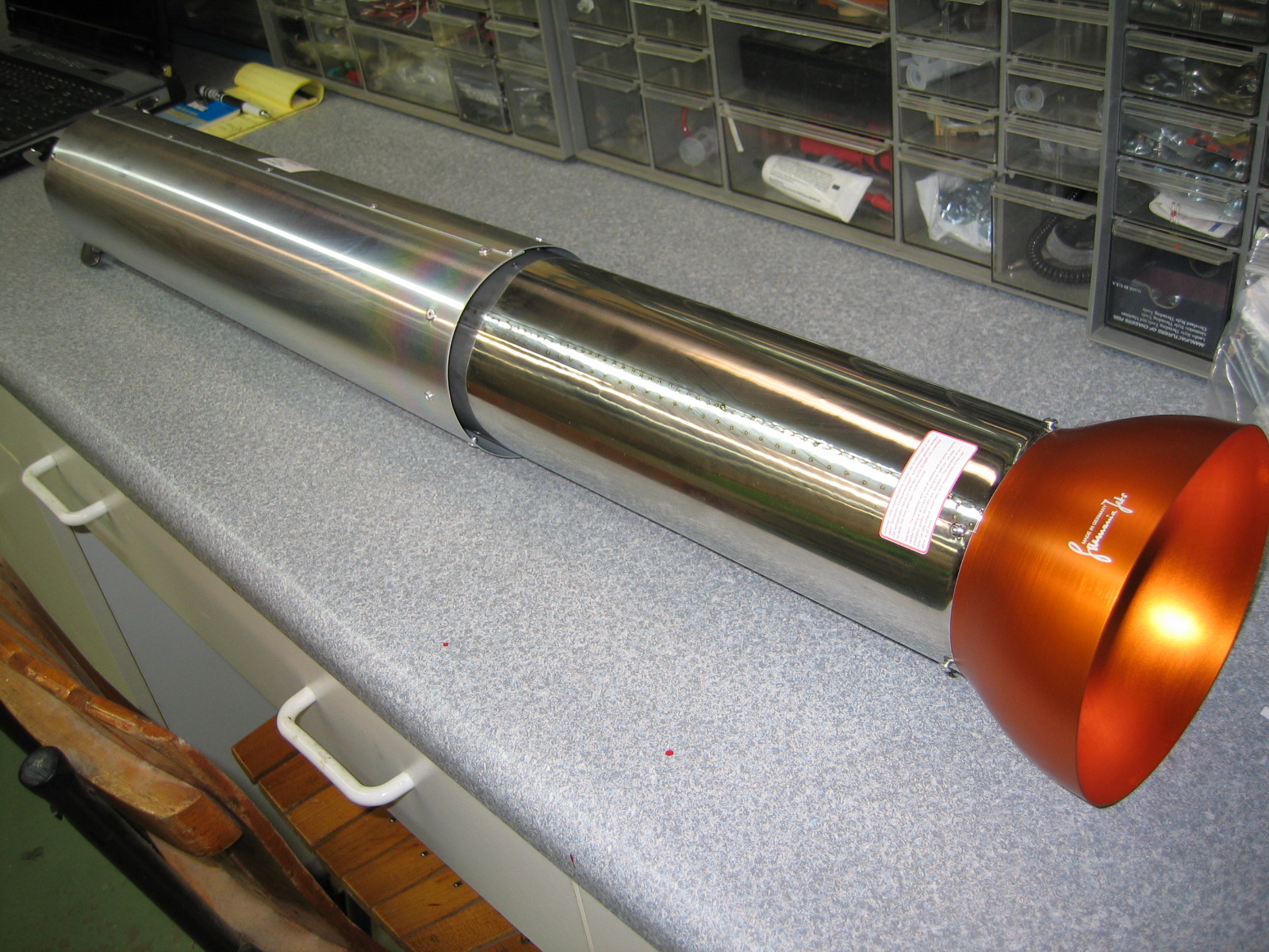

The pipe is a grumania pipe.
no one has done it yet.
scott

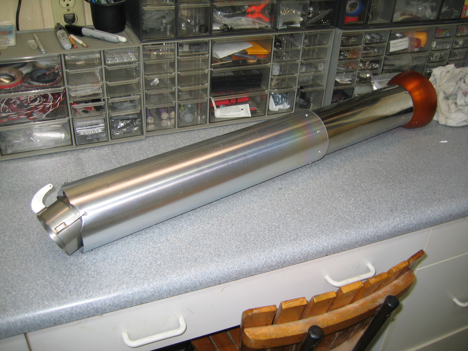

Old 10-31-2015 | 06:12 AM
rc4flying's Avatar
My Feedback: (21)
Posts: 685
Received 11 Likes on 11 Posts
From: Hermitage, PA
As Scott has stated, it is made by Grumania Jets. Very nice looking pipe.
What is the length of the pipe please. Have emailed Grumania all they have to say is order in shop with correct length and large vector pipe. Tks.
Old 11-05-2015 | 03:17 PM
rc4flying's Avatar
My Feedback: (21)
Posts: 685
From: Hermitage, PA
The pipe it self measures 31 1/2". the bell mouth adds 2 1/2" and the thrust vector nozzle extends another 1 1/2" beyond the pipe's length. So overall the the pipe assembly ready to install is 35 1/2" in length.

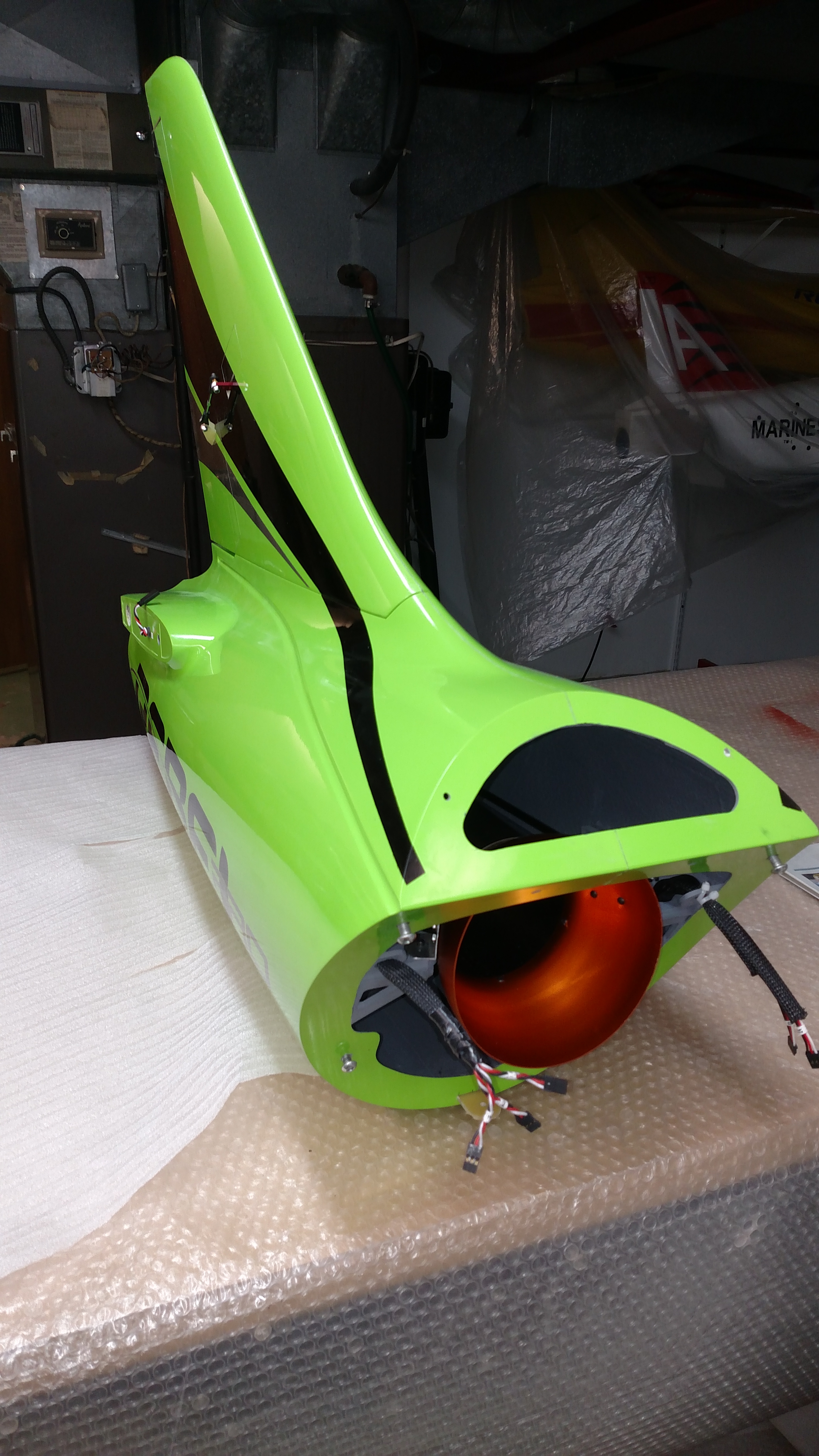

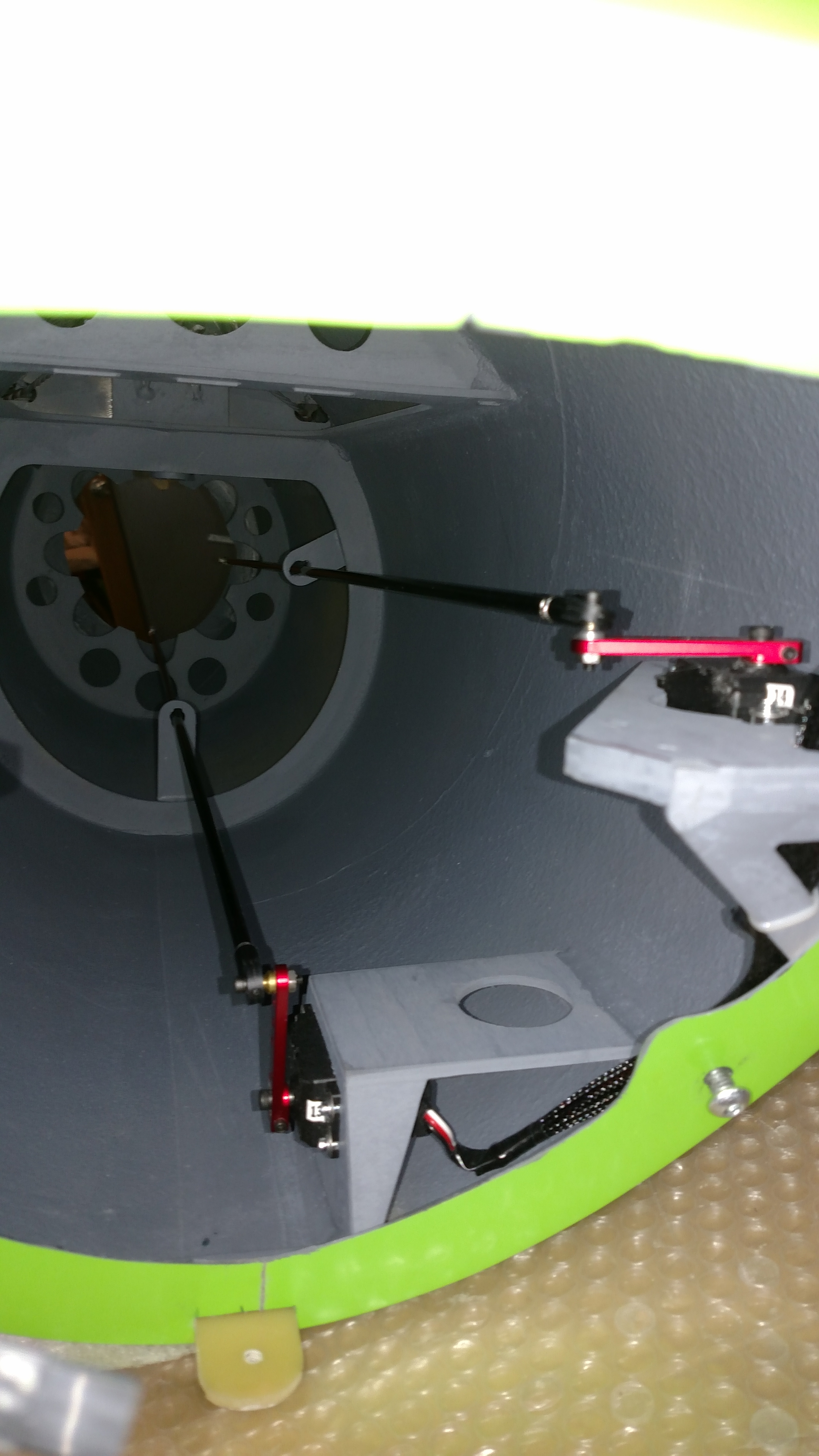

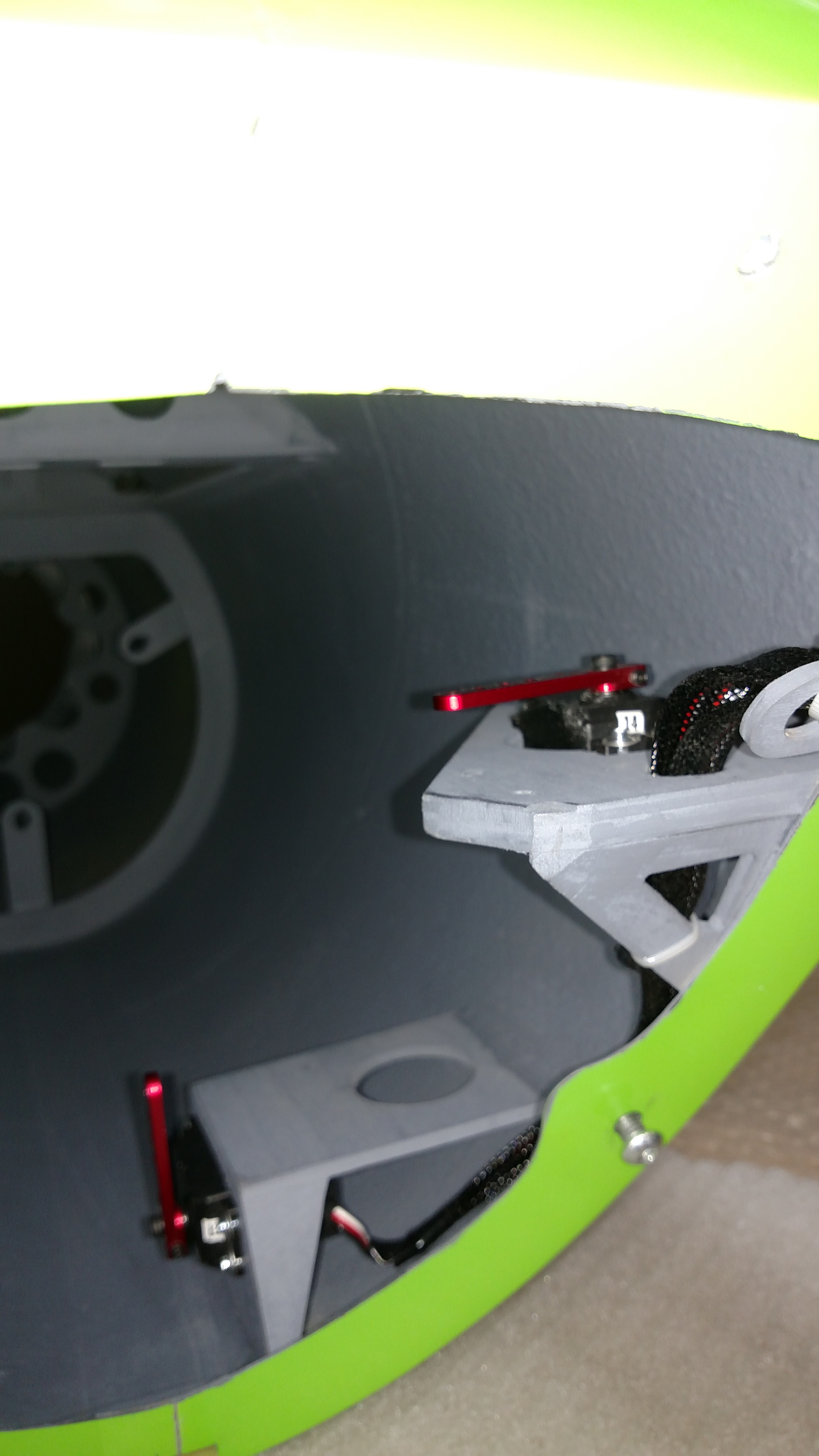

The build is basically done, but we are still waiting on a new motor to be shipped.

The first flight was cut very short because of a flame out. The plane gave the owner plenty of time to get setup and land safely. Problem was quickly diagnosed and we tried another flight. After some passes to trim the plane, he made a few more passes to trim the thrust vectoring setup. He made some attempts at a nose vertical but quickly found that between a lot of power with the 300 installed and an over responsive vectoring, we need some adjustments. The owner only had time for one more flight. He was able to get the nose high and was able to flip the plane 3 flips in a row before losing it, but he found that the plane easily recovered for normal flight with no bad snapping tendencies. He feels good that after some CG, gyro and vectoring adjustments, it will be good.
Just wanted to say that Pirotti and ourselves do not recommend a fast flat out flight with a 300. In my opinion, I think a 220 would do the job. We will just have some more time and flights .

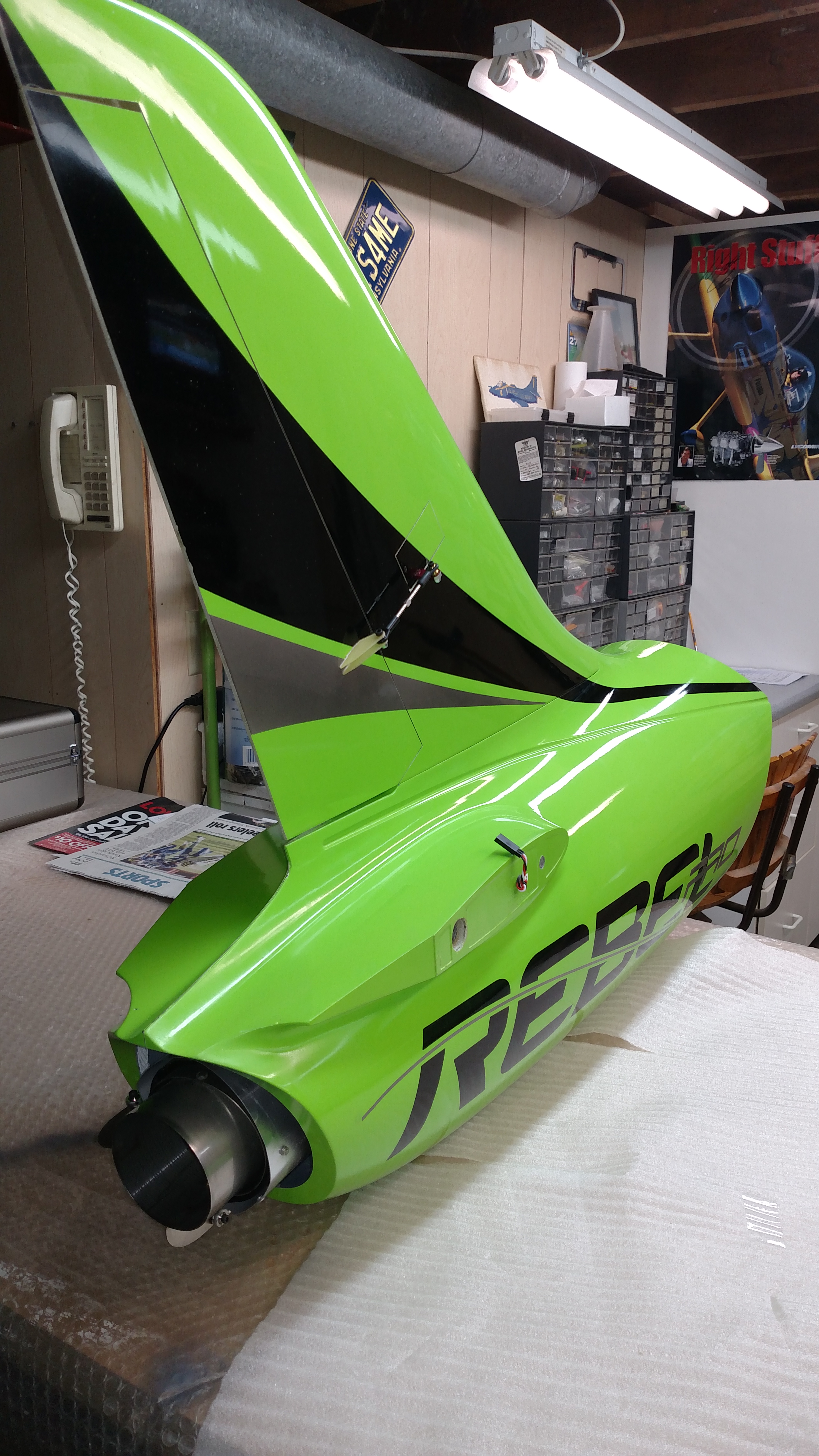

The green Pro has the vector thrust setup, and the yellow one is mine that was maidened also with a conventional pipe. This my second Pro because I just love the way this plane flies. Still have the first one too.
