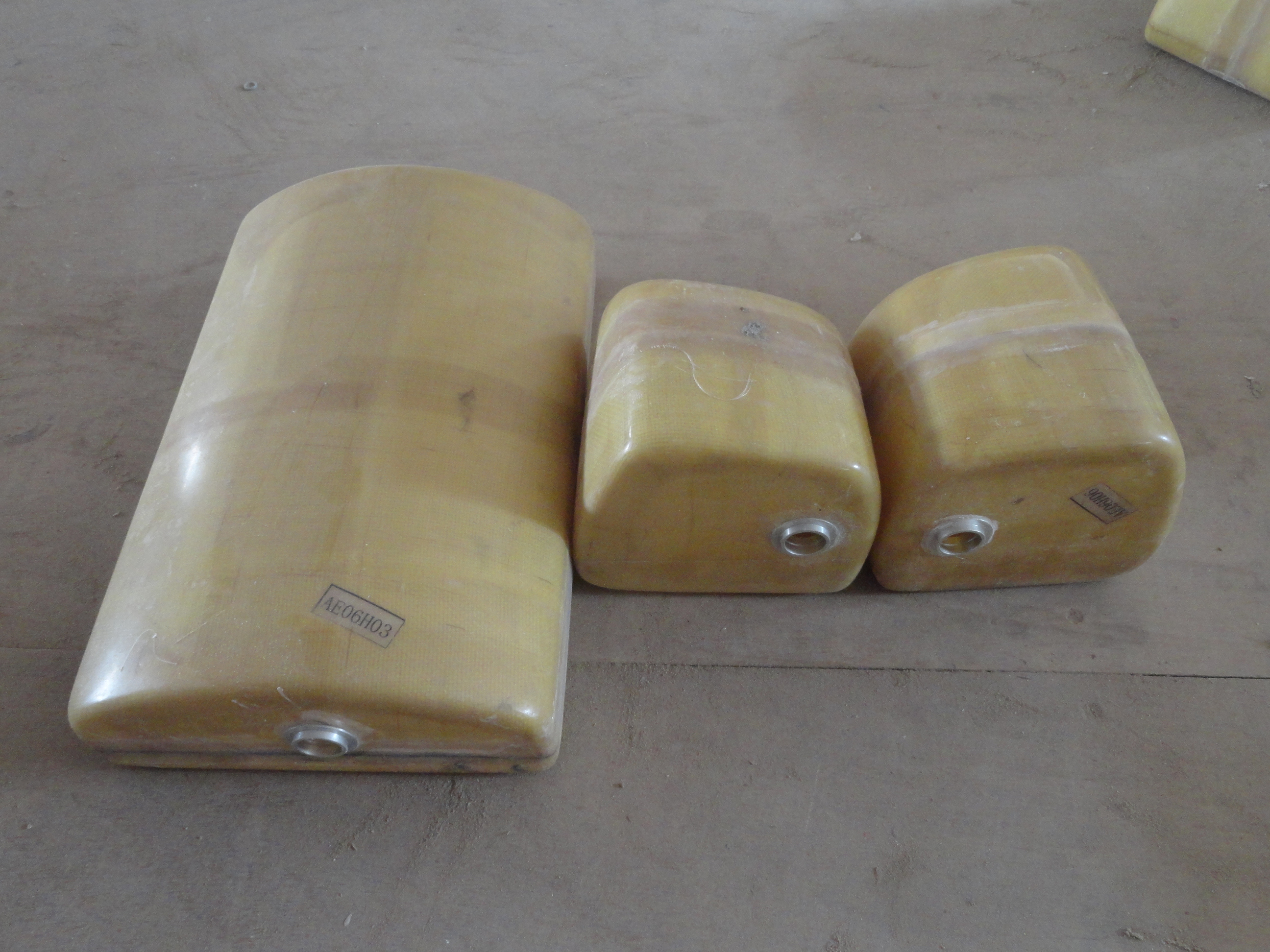

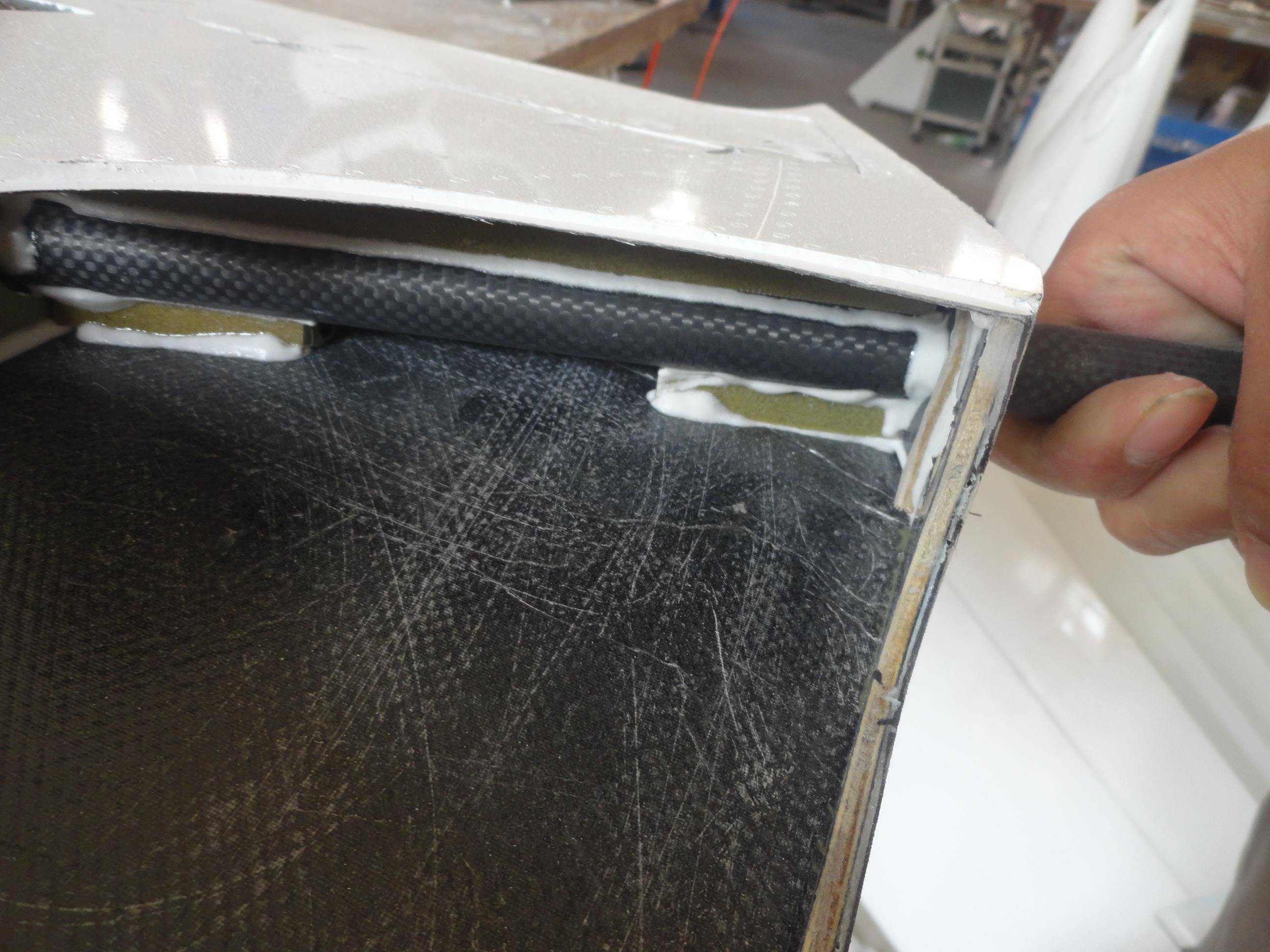

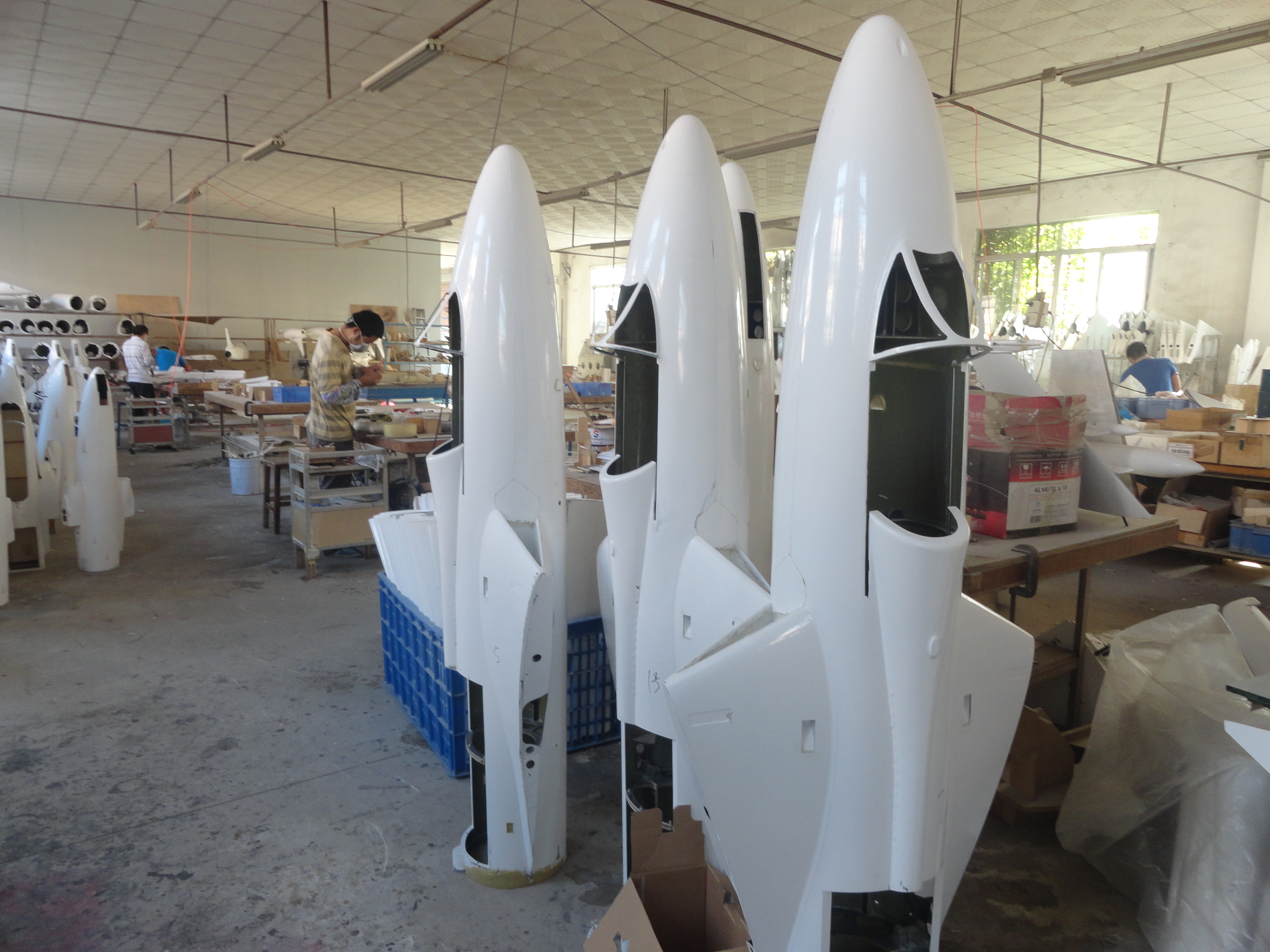

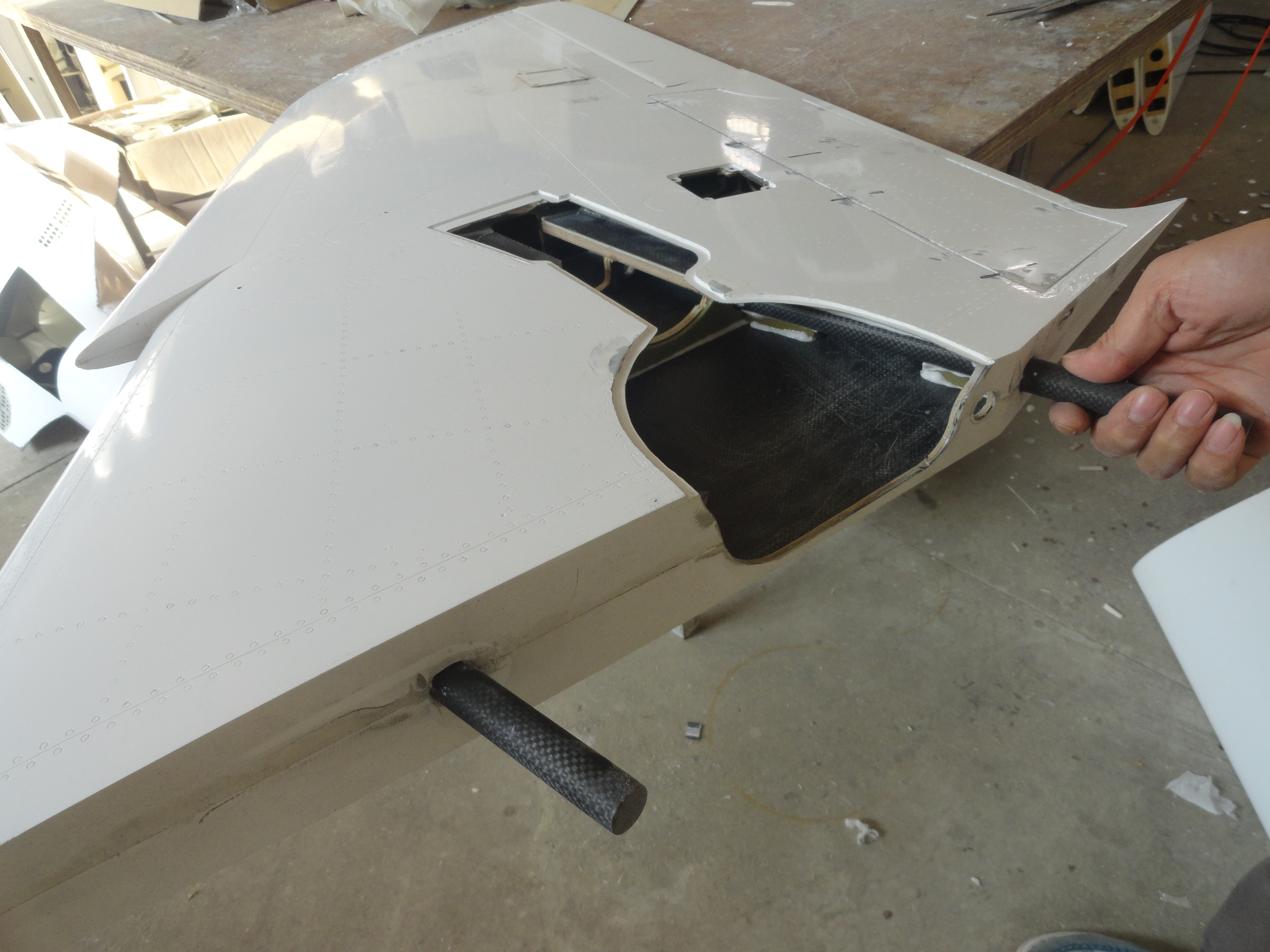

Ok fellows this is a little premature but I am going with it anyway. I have a new FEI BAO Hawker Hunter paid for and hopefully will be finished and shipped sometime next month. I purchased mine through Eric Clapp @ A & E Jets USA (formally JetCentralUSA). I know there are a couple of other fellows who have also purchased the air frame.
There is not a lot of info out there right now but I received some pics from Eric this morning and wanted to pass them along. I also thought this would be a good time to get a build thread started so we can get info all into one place.
I was also told fuel capacity would be 6.1 Liters.
More to come (hopefully soon)

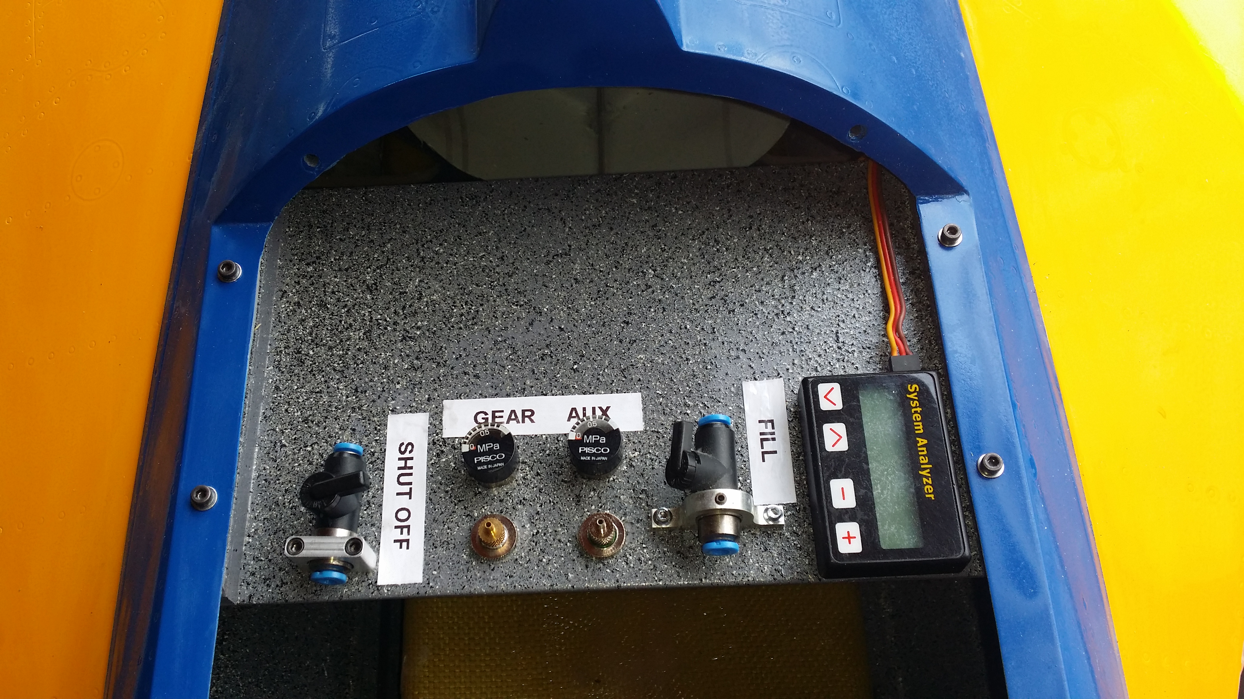

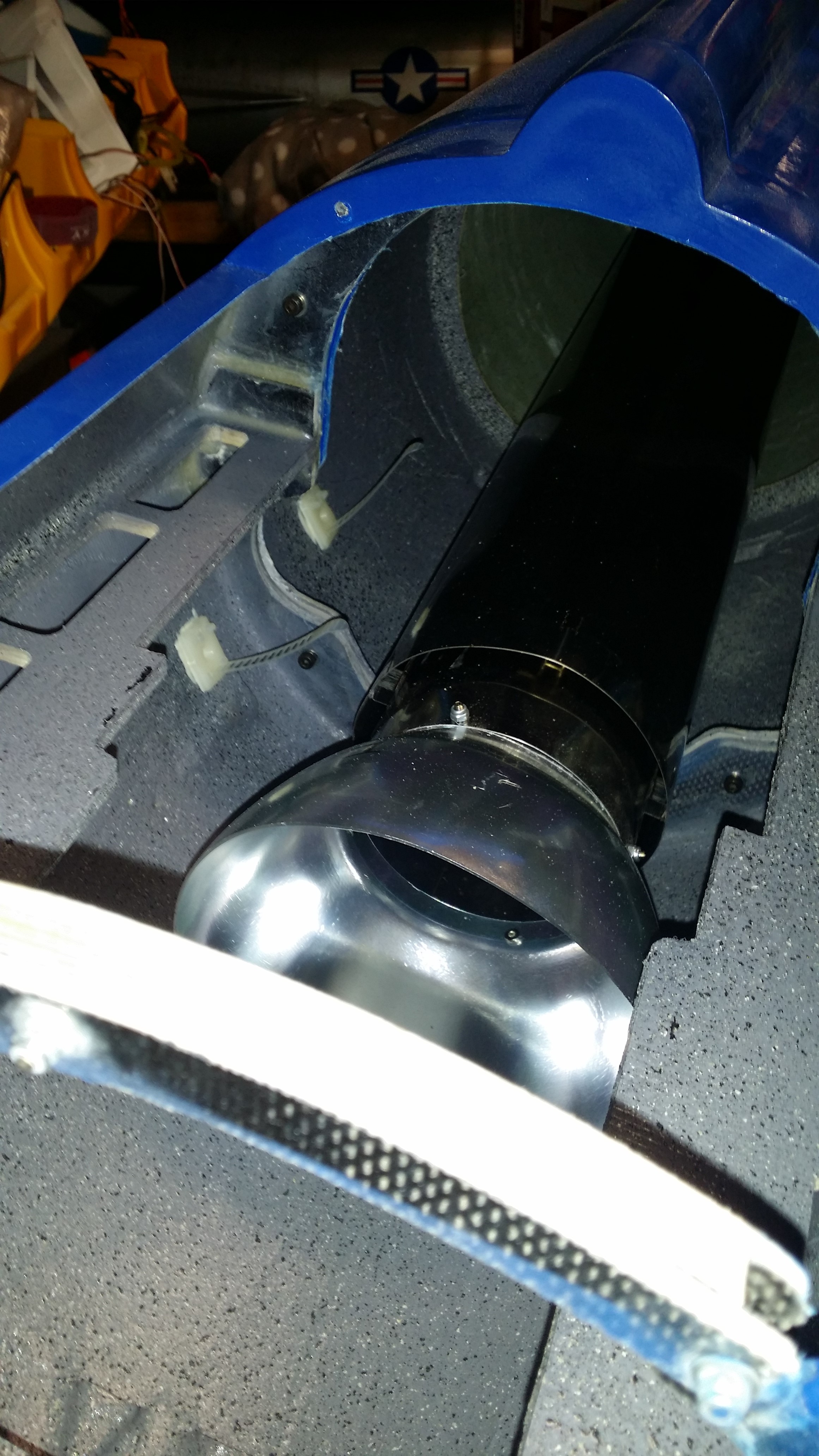

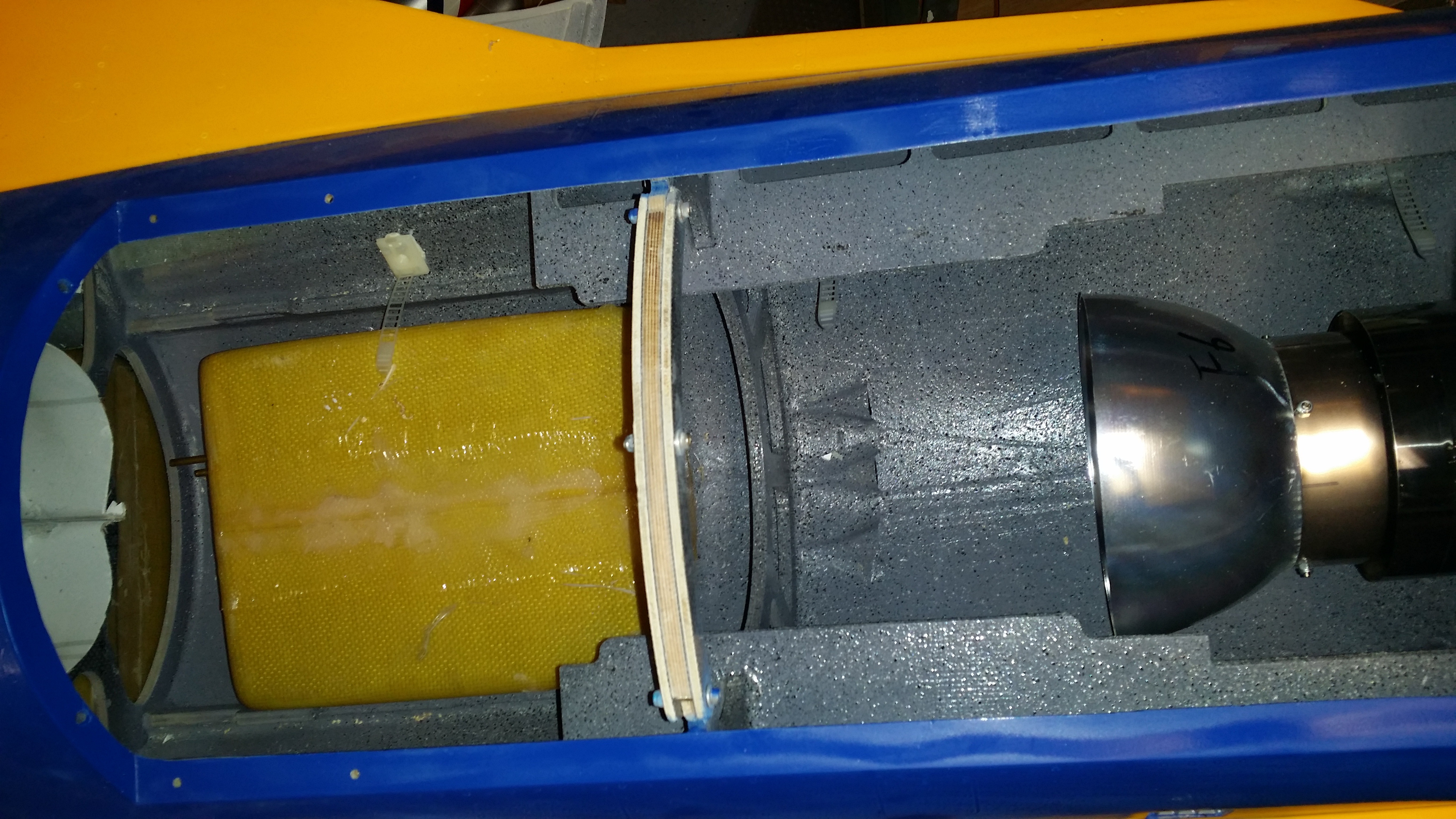

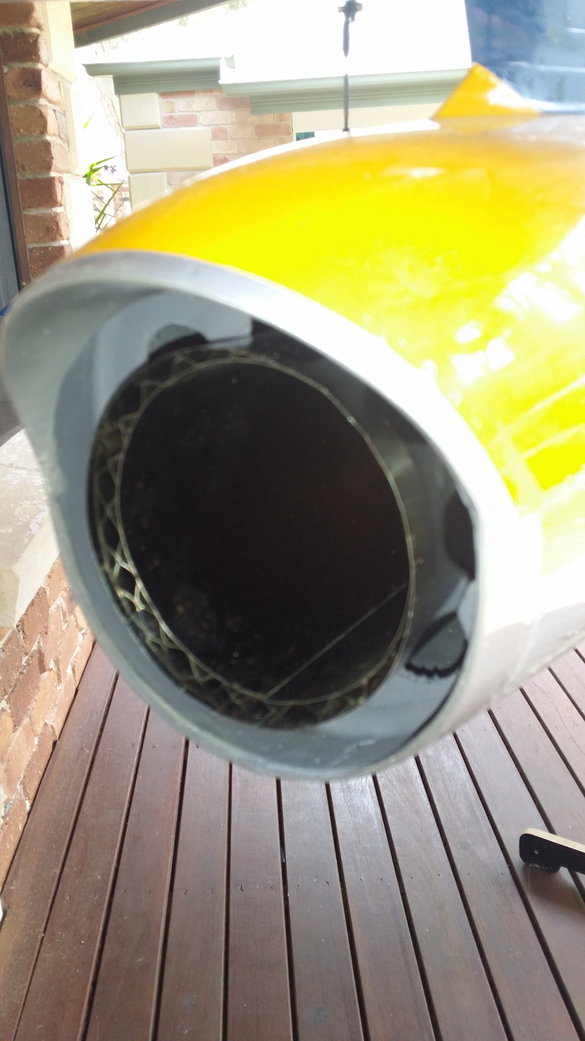

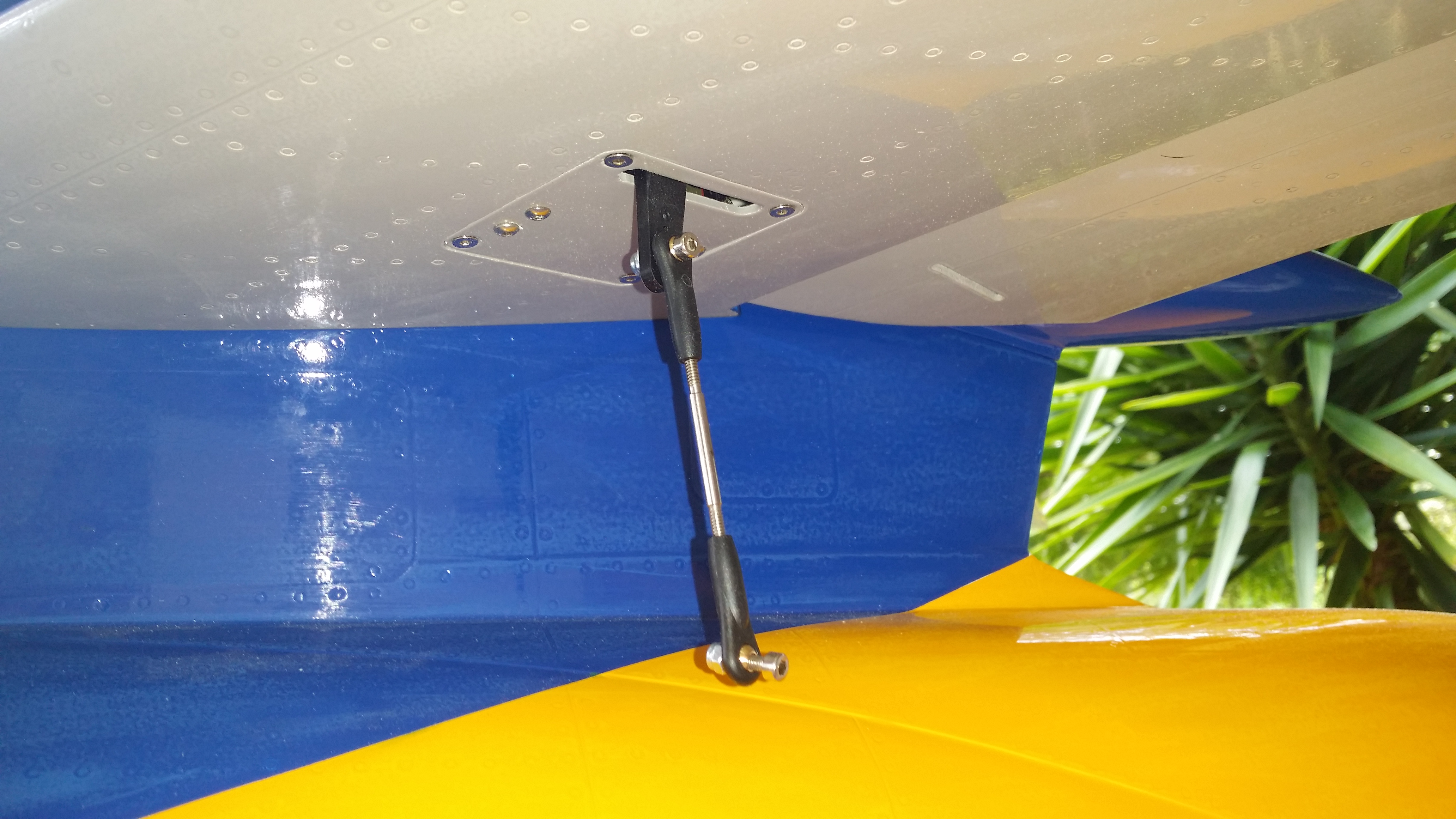

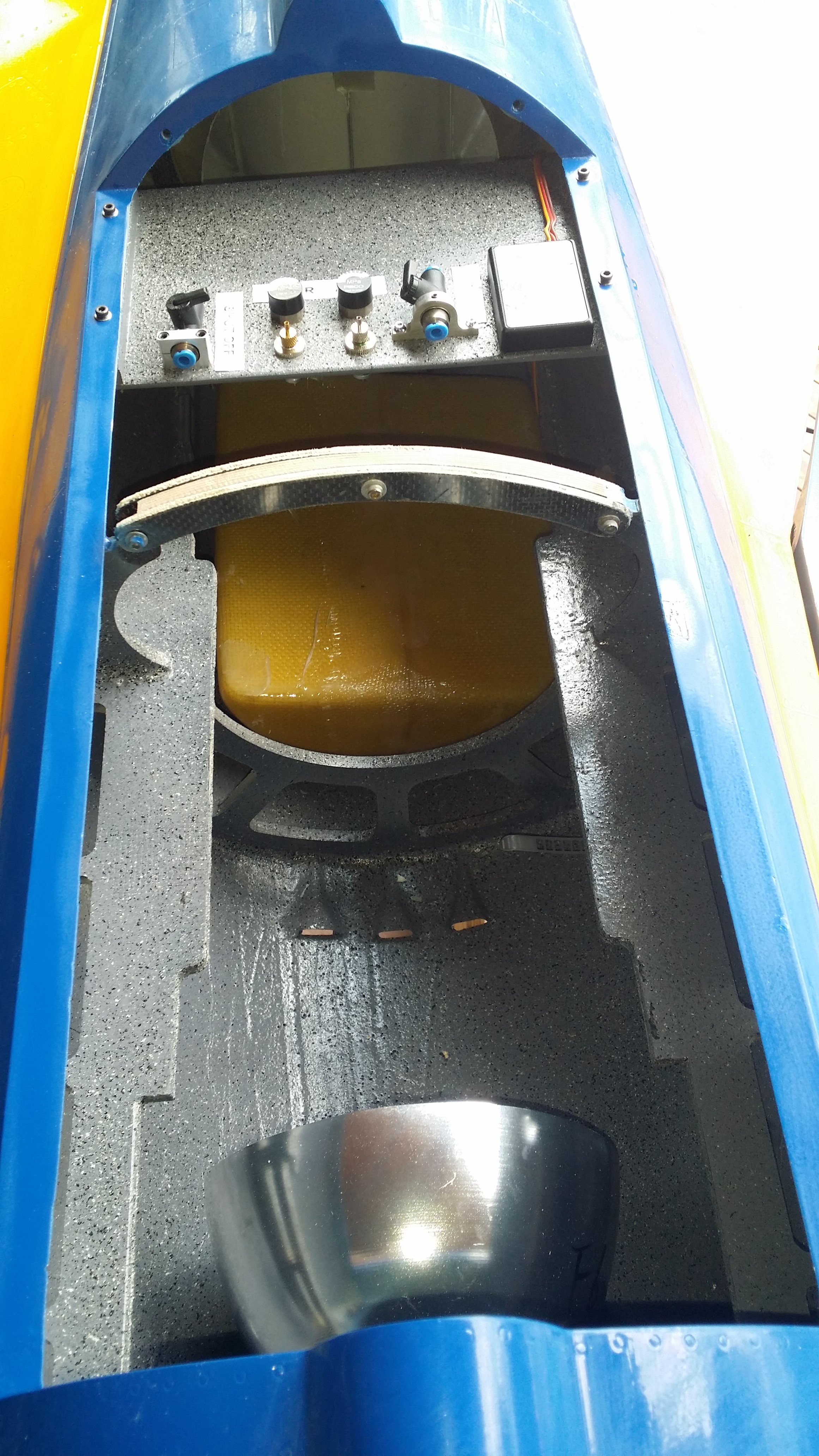

Hi Guys,
Thought I would share a few pics of the Big FB Jets hunter. Their product keeps getting better and better. This is one large jet. Over 3m long. It arrived a fortnight ago. Pretty much complete now and ready for me to finish the decals and weathering (my choice) before clear is applied.
All the servos hatches as is usual with the FB stuff are direct mounted with 3mm into t nuts on the surfaces so they are supper strong. There is a massive amount of room. Standard fuel tanks total just under 6L.
The main thing I was impressed with was the retracts and wheels. Fitted with great ball-bearings and working significantly better than some previous retract units. Some of the retracts out of China at the moment have very small tolerances, where a little more would generally nice, however these are supper smooth.
