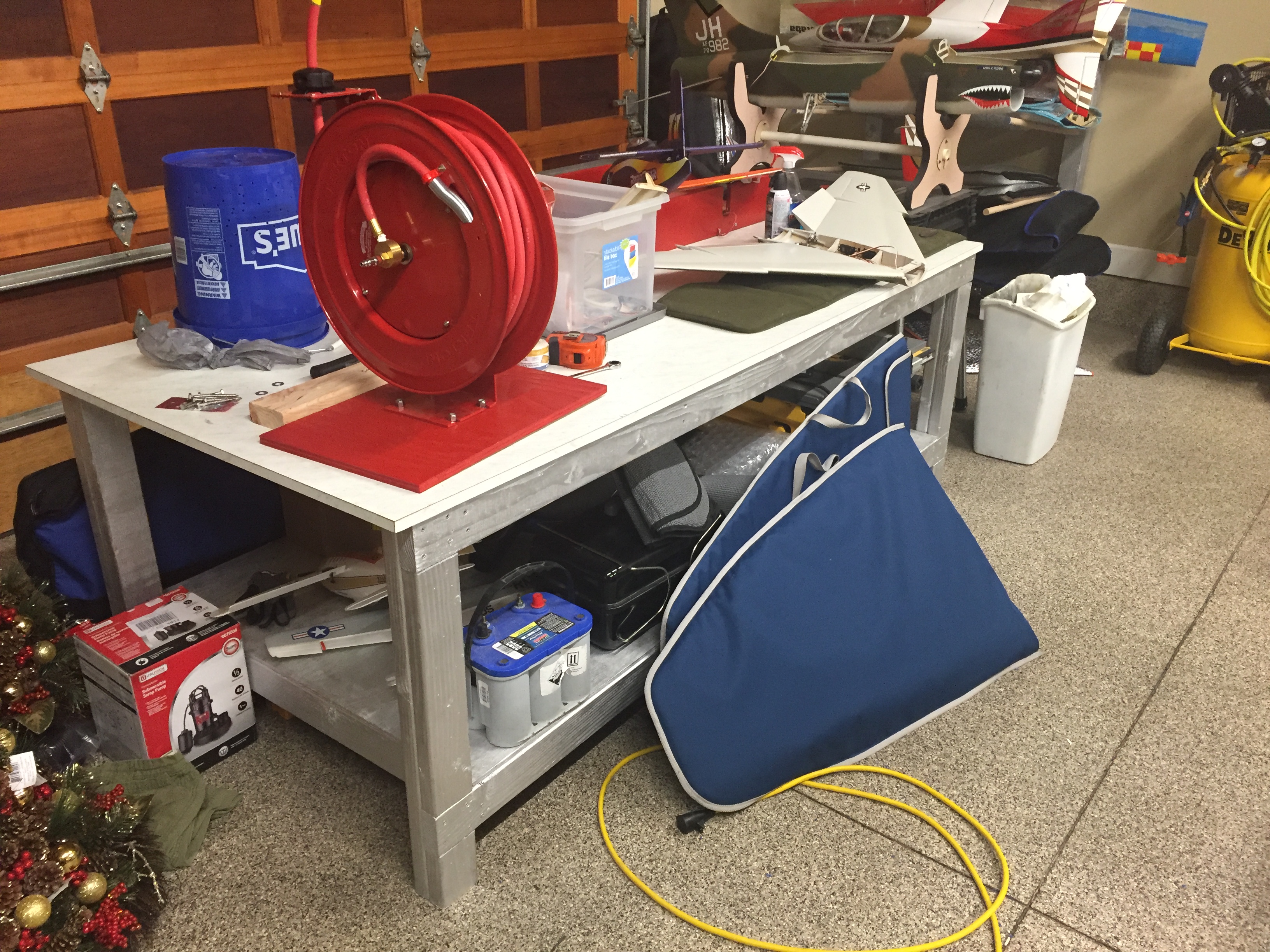

I've been building on my 3' x 6' "build table" for 20+ years. It's pretty much had it structurally, it's no longer flat or level AND it's just too small.
I've been looking around RCU and other woodworking sites to find ideas of how to build what I'd like to use. My garage is an oversize 2 car garage that is 20'x24', there is also a little side room connected to the garage where my shop sink is and I have cabinets and countertops from when our kitchen got remodeled. I just brought all the old stuff out and hung it in the garage. So, I can have a pretty big work table! Yay!
http://www.thewoodwhisperer.com/vide...ject&atid=2631
I'm into flying pattern and really want to get into jets again. With the new jet pattern contests I'm pretty excited to get started.
Models just seem to get bigger and bigger. Transport problems, size and weight regulations etc mean we've pretty much hit the size limit for now.
So so an average pattern plane is 2M square or 6'7" square. The width of the main landing gear is not nearly that wide but looking for a table that is at least 4' wide. Length is where it gets sketchy, where I don't have any plans to build a 40% or larger IMAC plane at this point, I'd like to have the option. The length of a 40% Carden Edge is almost 10'. The Elite Aerosports Shockwave is 8.5' long.
Having said all that we have to think about generally available sizes of materials. Pretty much plywood or MDF and many other commonly available materials for making the build table top out of are limited to 4' x 8'. We could always get around that by simply splicing or even butt jointing two or more pieces together, but do you REALLY need a build table bigger than 4' x 8'?
I've seen some build tables that I thought were some pretty unconventional materials. And by that I mean, "normally" you think of a build table as something you can put a pin in every now and again, however I've seen some incredible builds come off a granite cabinet top..... So let's talk various materials AND sizing for a new build table.
Anyone?

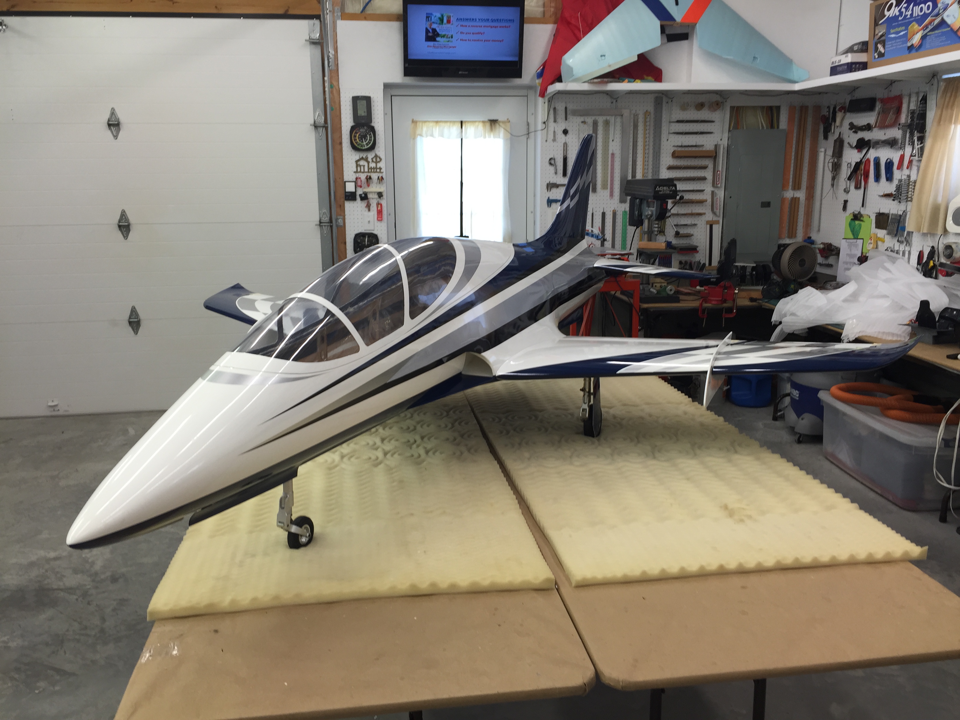

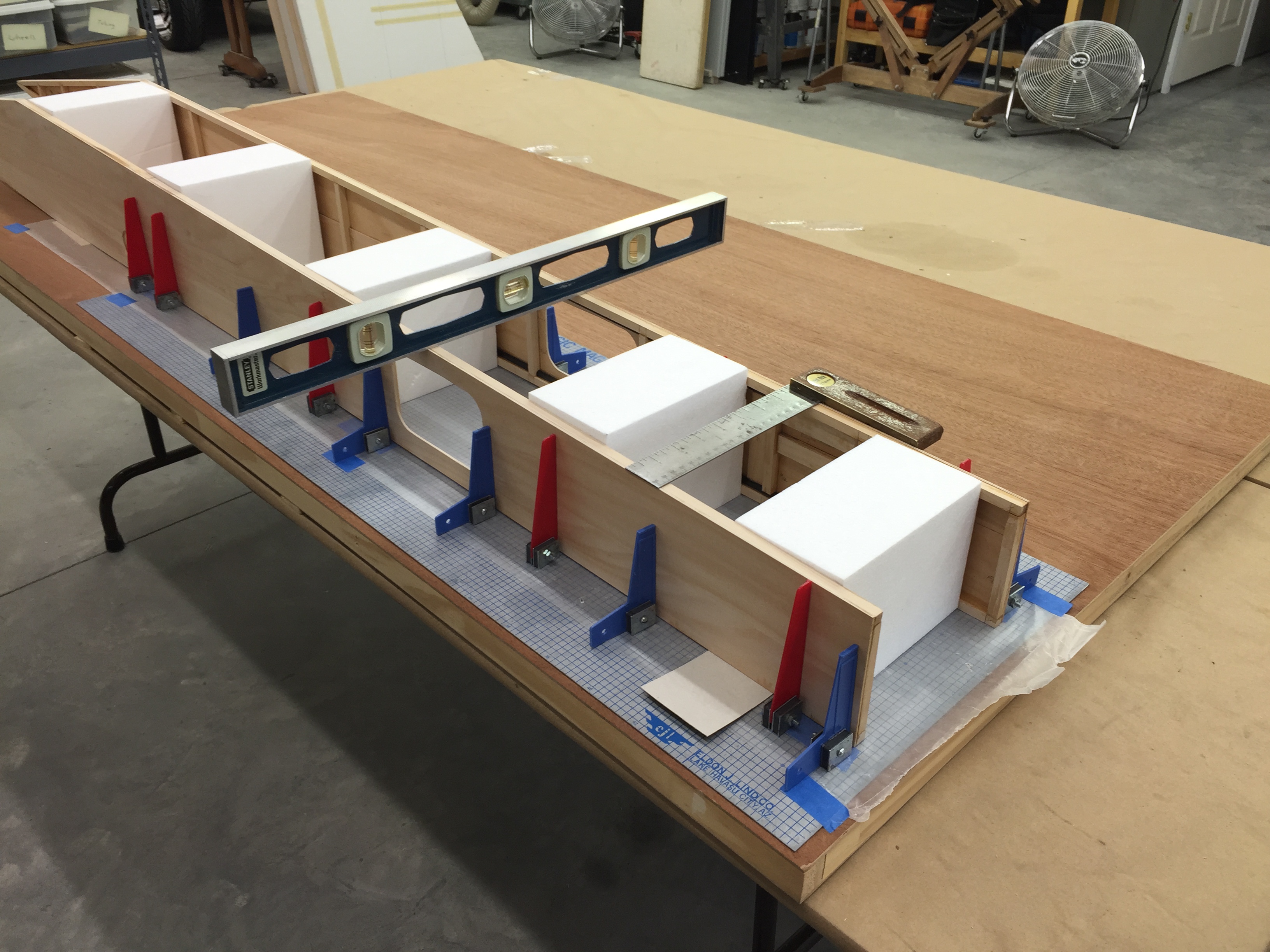

I use two 30" x 8' particle board utility tables from office store covered with brown paper for general work.
The are topped with egg crate foam mattress toppers for soft non scratch surface when needed.
When flat is important I lay two solid core door panels on top and shim to level with wood door shims. I check them with a 6' aluminum ruler and 48" bubble level.
They work as an island for all around access, two islands when needed. Can be a big deck with two doors or a huge surface by adding a 3rd door to the end of the first two. Great for sheeting, vacuum bagging, painting, etc etc. Height is 30" (I'm short), good chair height, or ok to stand.
Its modular, moveable, removable, versatile, easy, and cheap.
Tables with foam toppers, one door shimmed level, two doors shimmed level, three doors together

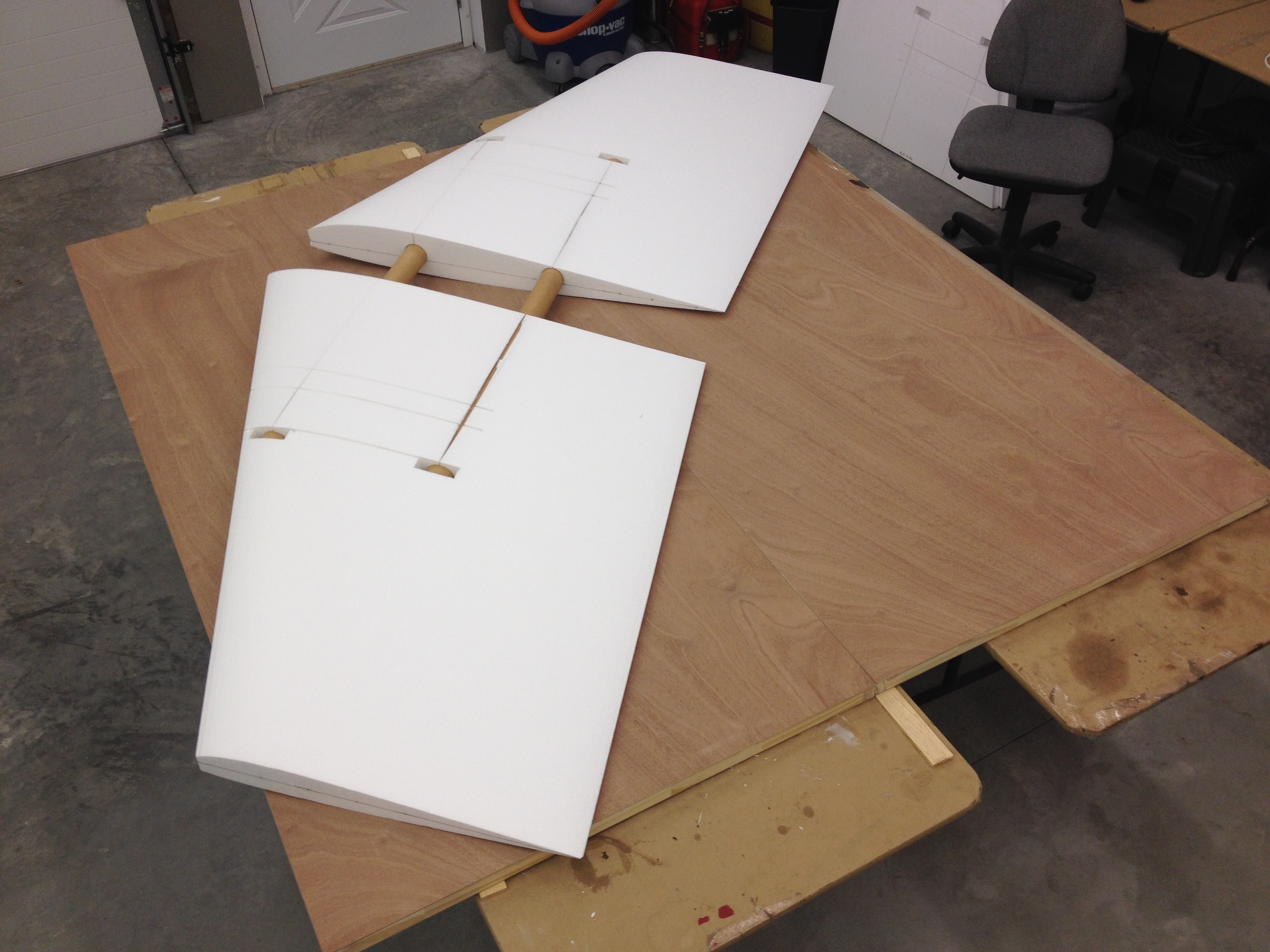

Here is something different.
An old bowling alley.....hardwood, 42 inches wide and as long as 20 feet in some cases. Build a heavy duty frame to set in on, cover with insulation board (if you like to build on a soft surface with pins).
Cover with glass if that is your preference.
Cover with a thin sheet of steel and use magnets to hold your work while you build.
My building board is chip board (osb) 4'x8' cut in half lengthwise. This serves as a top and bottom and are screwed to a 2"x2" frame to keep it square and straight. Then it is covered with insulation board and placed on a cabinet base or frame of your choice.

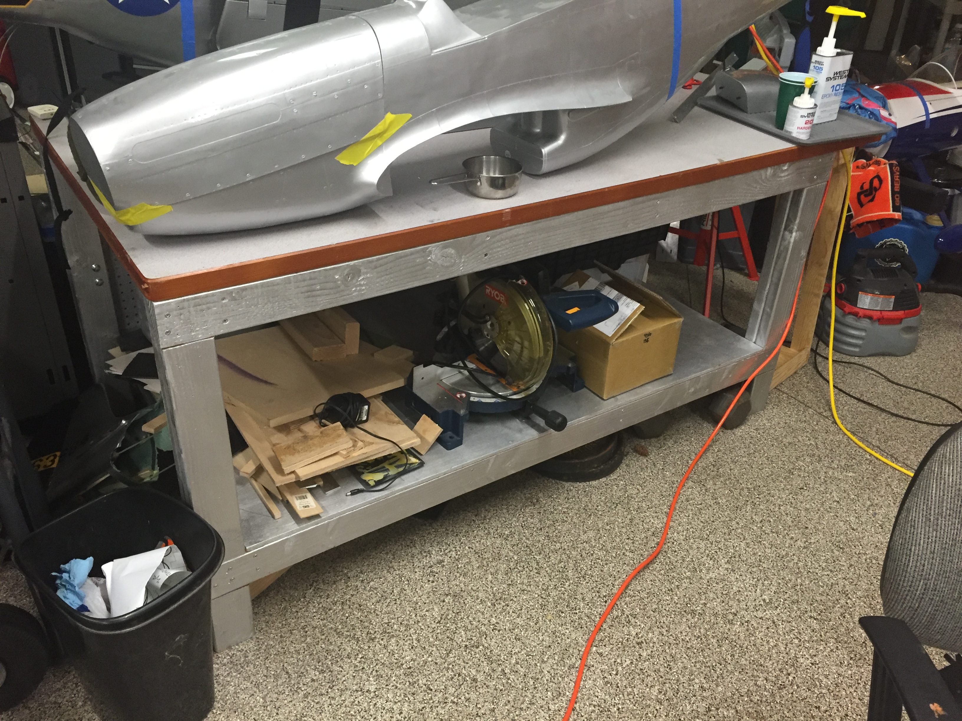

Agreed. I just moved last summer. Took 26x28' of the garage for my shop. I built two of the EAA tables and put MDF/formica tops on them. I massaged the sizes a bit. I think 40" is about as wide as you want to go IMO. I made a 7 x 40" and a 6 x 36". If you are going to sit at it, you could halve the bottom shelf. These aren't my primary work tables so I wanted the storage underneath. Lowe's sells butcher block tables that are very nice, but spendy. They're around $500 a piece. I put two end to end as my main work table. I'll edit with photos tonight.

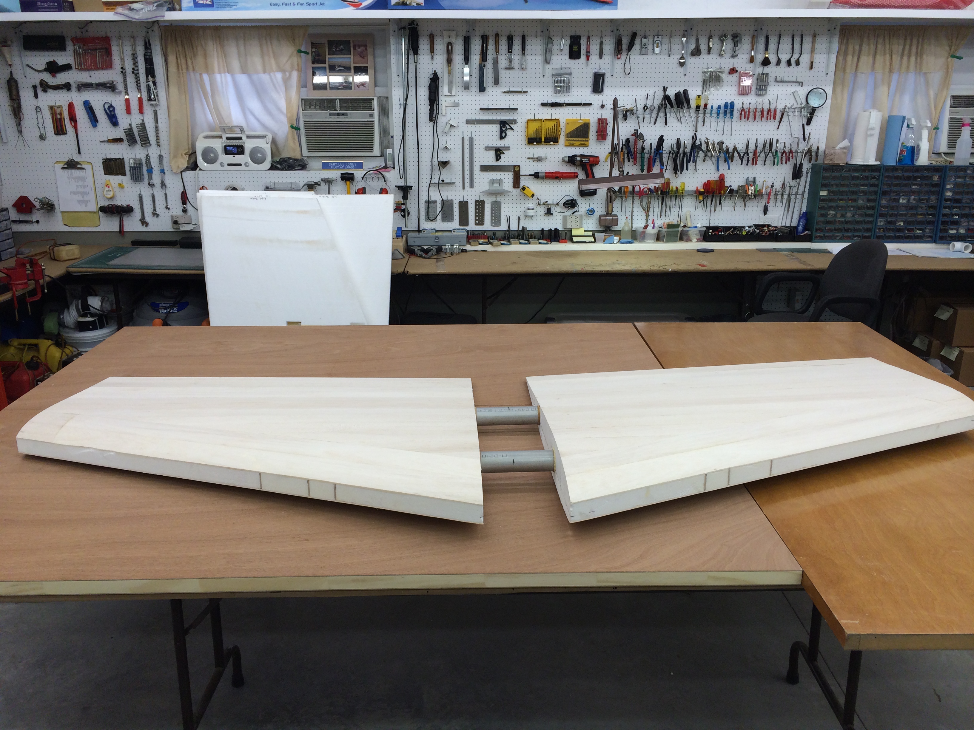

Size does matter…. ;-) Bigger the table, lower I would make it. I made the 7' one much lower, figured I would be working on bigger airplanes on it. One of the other ones, I put higher because I knew I would never sit at that bench and wanted the storage underneath for my radial arm saw and other tools I rarely use. My shop is almost done, once it was functional, kind of gave up on some of the final touches.

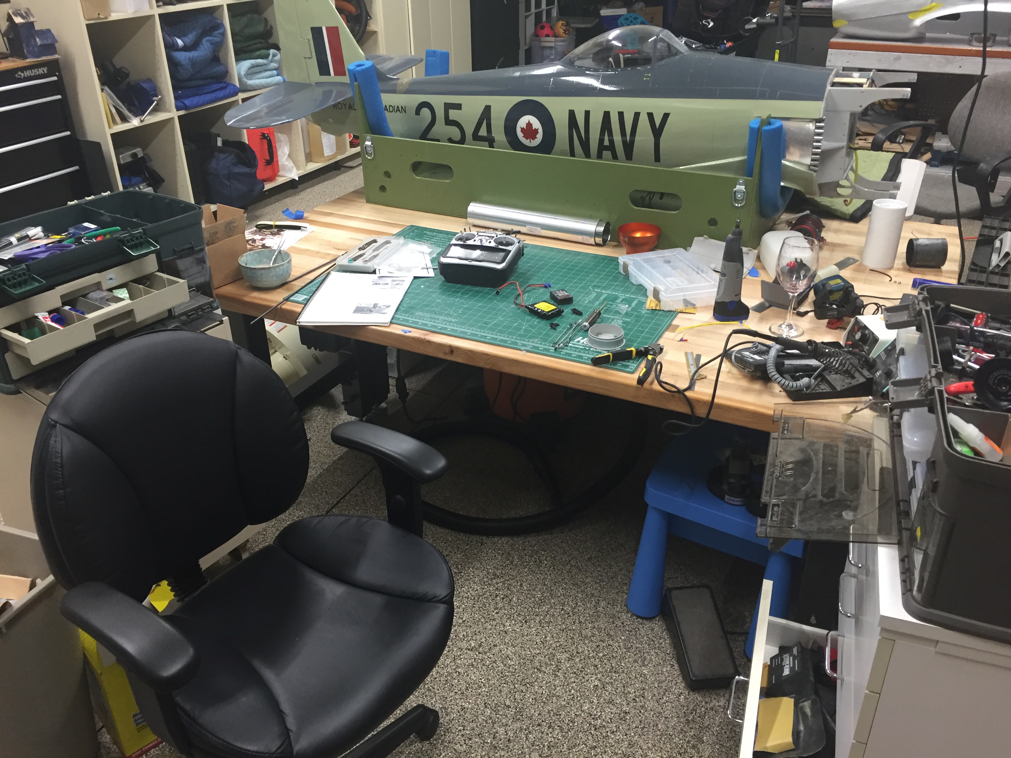

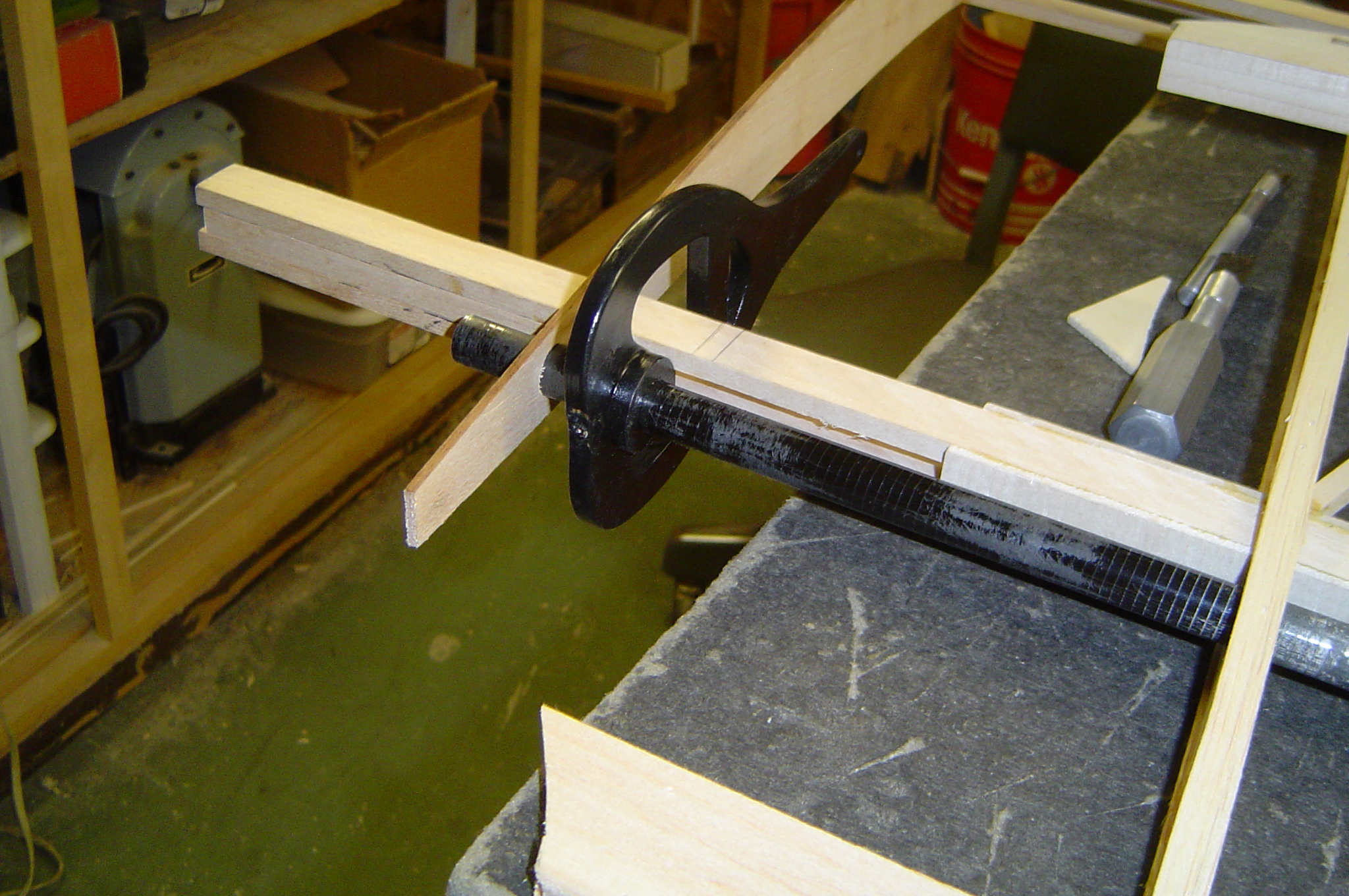

I use cabinet bases and a 4x8 foot 1 inch thick piece of MDF. On top of that is a 1.5" tick granite table top. Dead true and great for setting up any model type. Although a bit costly in the beginning $1200 for the entire table to include the granite, it is always perfect after ten years. Glue chips away, paint chips away, etc. I love it. Best thing I ever did. Cost me one less model in my stable but the rewards of using it far out weigh that.
