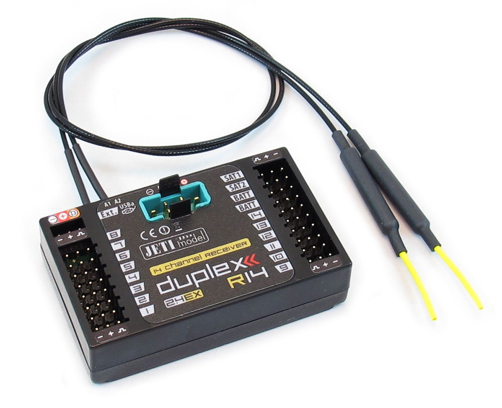

I would like to let you know that we have decided to add two more receivers and expand our offering.
Next month we will be adding new Jeti REX 7 and REX 7 Assist with 400mm long antennas.
This way we have smaller REX and REX Assist if anybody would like to add them to any of the Central Boxes.
Zb/Jeti USA
I am talking about this type of antenna.
