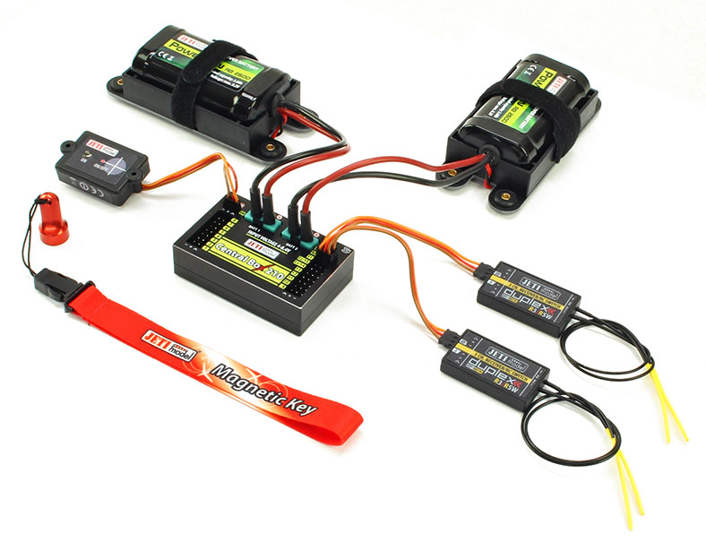

Pre-Orders are open for Jeti Central Box 210, production started first pieces are due in US early November.
Zb/Jeti USA
The new Central Box 210 is an improvement over the venerable Central Box 200. We have removed the overload protection at each servo output and designed an aluminum housing for those high power demand applications. The Central Box 210 features true Battery Redundancy, Ditex Servo Telemetry, Jeti EX Telemetry, and up to three receiver inputs (2x 2.4GHz and 1x 900MHz) with serial (PPM, EX Bus) output for complete Power & RF Signal Redundancy.
With Jeti Duplex 2.4GHz DC/DS transmitters, the full potential of the Central Box can be used, such as easy way to wirelessly configure the Servo Outputs, Ditex Servo & EX Telemetry, Fail-Safe Setting or Function Assignment.
Esprit Tech/Model 1.321.729.4287 - Search
Features:
- Control Management with Configurable Servo Output
- Power Distribution with Two Independent Inputs
- Heavy Duty Aluminum Case for Extra Cooling and Protection
- Firmware Updatable via Jeti USB Adapter and Jeti Studio
- Wirelessly Programmable Using DC/DS Tx Device Explorer
- Independent Receiver Signal Inputs (R1, R2, E1/R3)
- Up to 15x Standard PWM and Ditex Telemetry Servo Outputs
- Up to 3x Telemetry Sensors Inputs (E1/R3, E2/15, E3/14)
- Input for Included Magnetic or Optional Wireless Switch
- Input Voltage: 4V - 8.4V
- Output Current: 2x 20A Continues/90A Peak
- Dimensions/Weight: 65mm x 42mm x 18mm/59g

That´s good news ZB, though what happened to the optional overprotection ? I think this was a nice feature for jets in case of servo wir cuts/shortcuts in case of fires/turbine issues..

Is there going to be an option to buy just the CB210 by itself without the magnetic switch? I think a lot of us would like to just be able to swap out the CB and not have to pay for something extra like a magnetic switch.
I don’t see anything mentioning support for a stand alone Assist gyro, is that still in the works?
More options, some 3D and IMAC guys specifically asked to have option of not having poly-fuses.
Zb/Jeti USA
That's the E1/R3 port is for, we needed high speed EX Bus port for standalone gyro.
