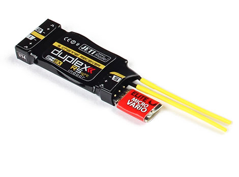

Old 06-26-2020 | 08:59 AM
  #1646
ZB
Joined: Jul 2004
Posts: 354
Received 10 Likes on 10 Posts
From: , FL
2g/$55.00 Variometer for Jeti Duplex EX, Multiplex MSB, Graupner HoTT, Futaba S.Bus2 (Due Next Week)
Excellent Solution for Automated Retract using Jeti Telemetry Functions
Micro Vario is a device that measures temperature and atmospheric pressure. Using the obtained data it calculates the Relative/Absolute Altitude and Rate of Climb/Descent. Changes in climb and descent rates are signaled as well. The sensor alerts you if any alarm setting is exceeded. Simply Plug & Play solution for your Jeti, Futaba or Graupner RC System.
The sensor enables an acoustic signal for the climb rate/descent rate or for exceeding of a pre-adjusted limit value. The acoustic signal consists of different tones (steps) for climbing and the same amount of steps for descending. The step width can be adjusted by the user. The climb signal consists of short interrupted tones, the descent signal consists of long permanent tones.
https://www.espritmodel.com/elite-te...ba-s-bus2.aspx
