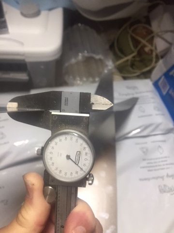

Stock sheet cover
Flashing metal used and will be two piece rear cover. The rear bottom cover plate fits without having to cut out for the engine.
Here are the pics of my sheetmetal mod i did for the rear. If i have to add angle to the engine then i may have to relieve it slightly but will see when the maiden happens.

Curious if smoknrv4 has flown his. I installed the same thin flashing on the rear but during my test runs it waved and distorted due to heat. I had large gaps between the fuse and sheet between each fastener location. Once done running and it cooled, it went back to flat. I have an idea so I’ll post pics if ir works.
