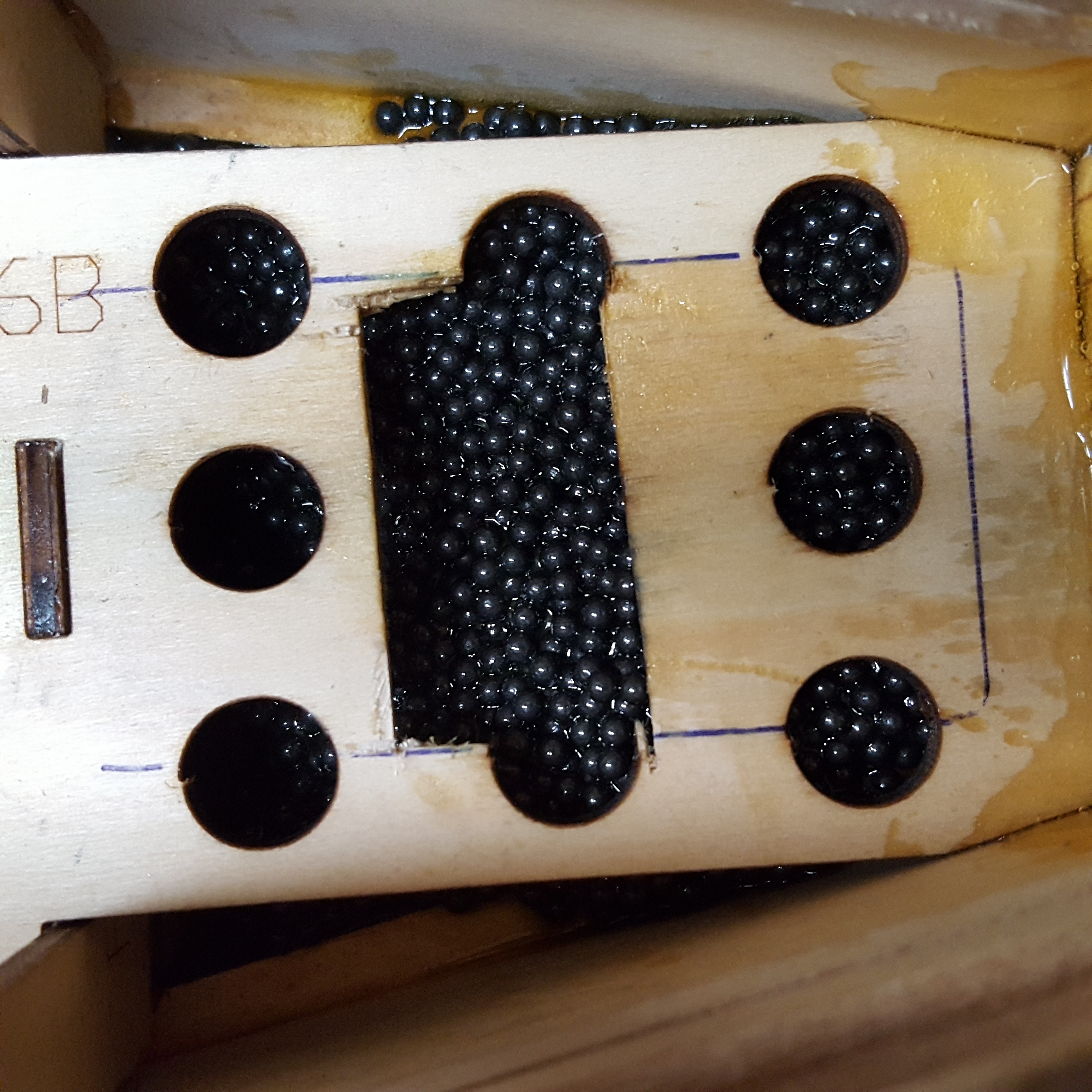

HI George, I am getting closer to having my Turbinator ready to fly, I did a balance test and I need 1lb 5oz of lead to get her balances at 7" on the CG, the batteries are a lipo and a life battery it looks like I will have 3lbs in the noise between the batteries and the lead to get her to balance out. I have the betties in the noise and the lead up there as well. It looks like you did not need so much noise weight. May I ask how you got the lead to fit in the holes you drilled out?
I melted the lead in a spoon and poured it into the holes I bored.

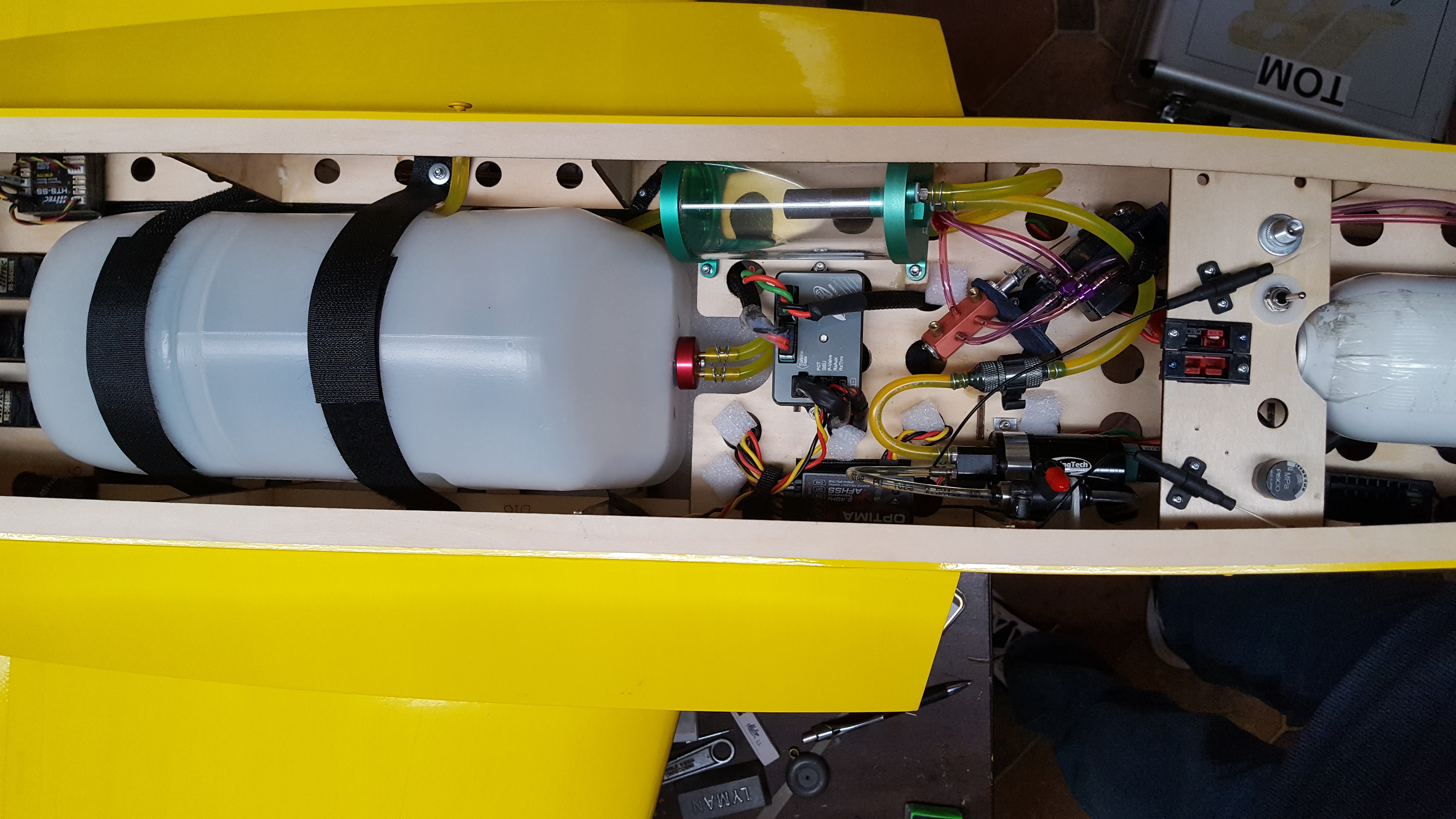

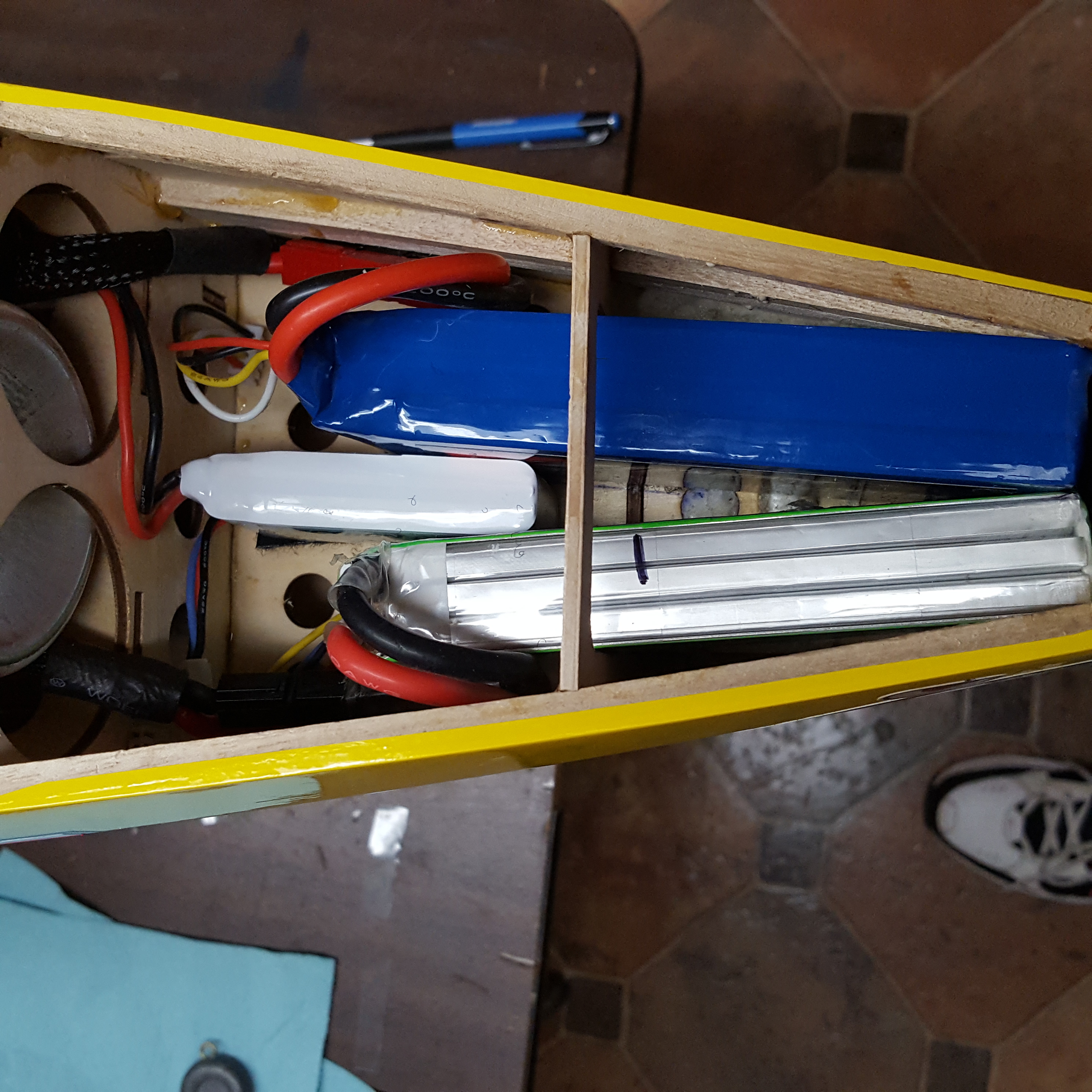

I am just wondering how much weight was needed to balance the turbinator including your batteries? I will have 3lbs 1.5 oz of weight in the nose including the batteries in that weight of 3lbs 1,5 oz, that seem like a lot of weight, I guess it is what it is. I am balancing it at 7" back from l e.

From: Berwick, LA
You might be a little on the high side with weight, but not way out. Mine has 28oz of lead along with two 2600 A123s, and a 2S, 4,000 LiPo pack and is balanced in the middle of the CG range. I'm running a relatively light engine (JC Rabbit) and took steps to put everything as far forward as possible.

Thank for the replay, I have a King Tech 120, the engines weight is all most 3Lbs I used lead shot and epoxy for most of the weight and I will use a stick on weight to finest the balance, so if in need to take out some weight after my first flight I can remove some weight. I added some great stuff foam to seal the epoxy and lead shot mix I had added to the nose.

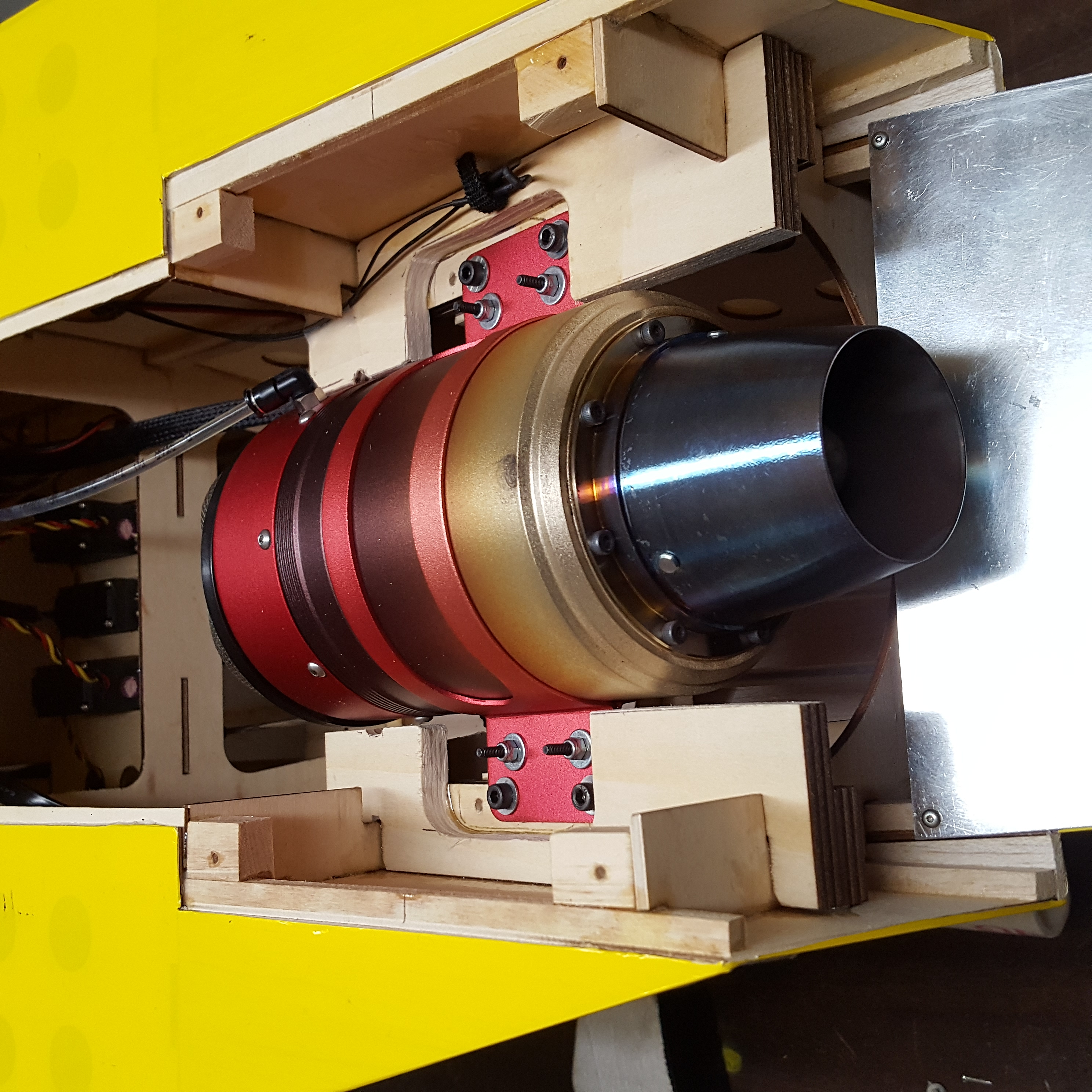

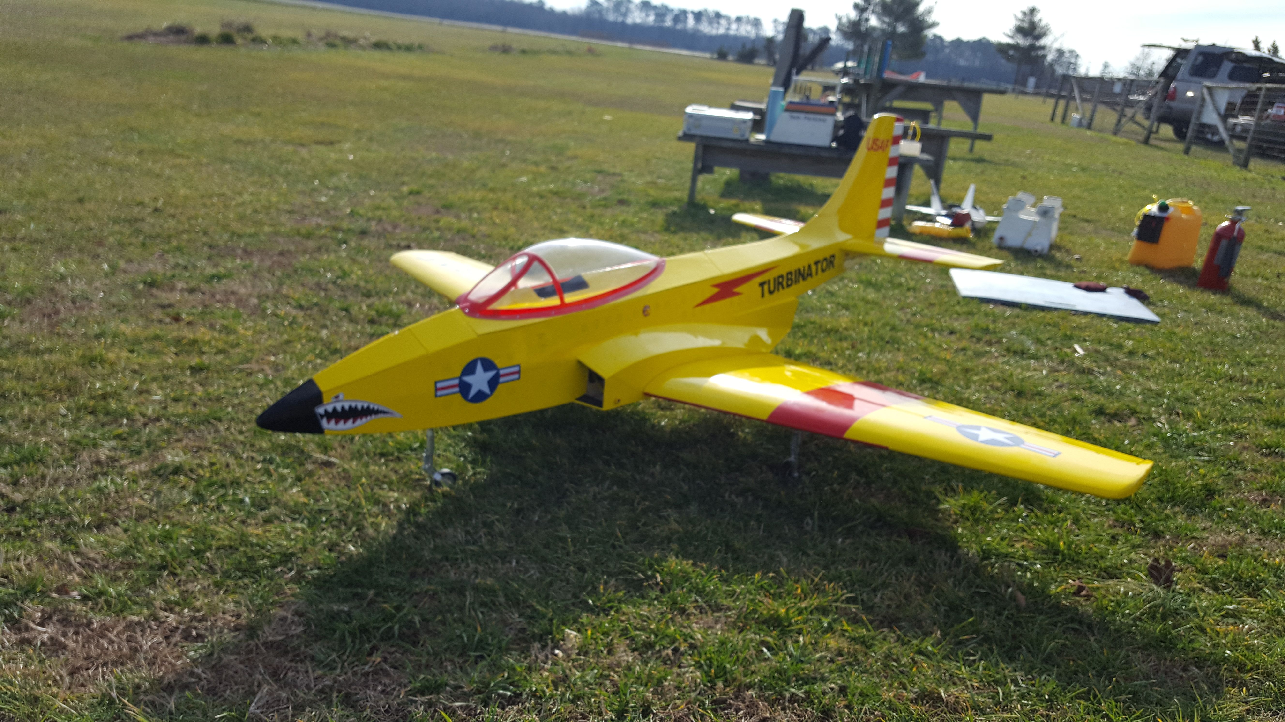

Up date on my trubinator. I was able to get my first flight in a few days ago, this plane flies great. I only added 6o down thrust to the engine. I flew her at a bit more then 1/2 throttle and some full throttle passes down the field and I did not see the plane rise up at full throttle, so I guess Larry from boomerabg rc jets was right no need for a 15o down thrush, for what ever it is worth. I have a 120 kingtech in her, nice engine.
Old 04-01-2017 | 12:07 PM
  #69
ltc
Joined: Mar 2010
Posts: 1,452
Received 19 Likes on 18 Posts
From: Mendon, MA
I believe the V2 had additional downthrust added compared to the prototype V1 Turbinators.
What is your total downthrust (including your 6 degree added)?
Can you make a measurement or post a picture?

I set up my jet on a stand and checked to make the wings were level, then rechecked engine mount for down thrust, just to make sure I was right about how much the down thrust is on my jet and yes I have it set at 6o total down thrust. I also check the built in down thrust and it comes with 2o down thrust built in to the engine mount . I am not trying to say any one is wrong about using 15o down thrust, but my jet files great with 6o total down thrust and she did not seem to noise up at full throttle. I set it up with the 6o down thrust after talking with Larry from Boomerang Jets, he has less the 6o down thrust in the one he uses for flight demo at the jet rallies he goes to.

Hi All, Has any one been flying there Turbinator ? I am sure all of the guys that have posted on here must have had some flight on there jet, how are you guys making out? I got my Turbine waver a couple of weeks ago, Andy Kane from Carf Models and Dennis Blades was kind enough to sing off on my turbine Waver at the Hurlock Md Jet Event, Yahoo. LOL
I have had 5 flights in so far and I am having a bit of a hard time remembering to keep the power up on landing, but I am getting there. I hope to hear back from all of you. Here is a link to some photos from the Hurlock Md jet event. Larry and Steve from Boomerang Jets was at the Event, Very nice guys. Larry brought a Turnbinater and was kind enough to buddy box any one that wanted to fly a Jet.
