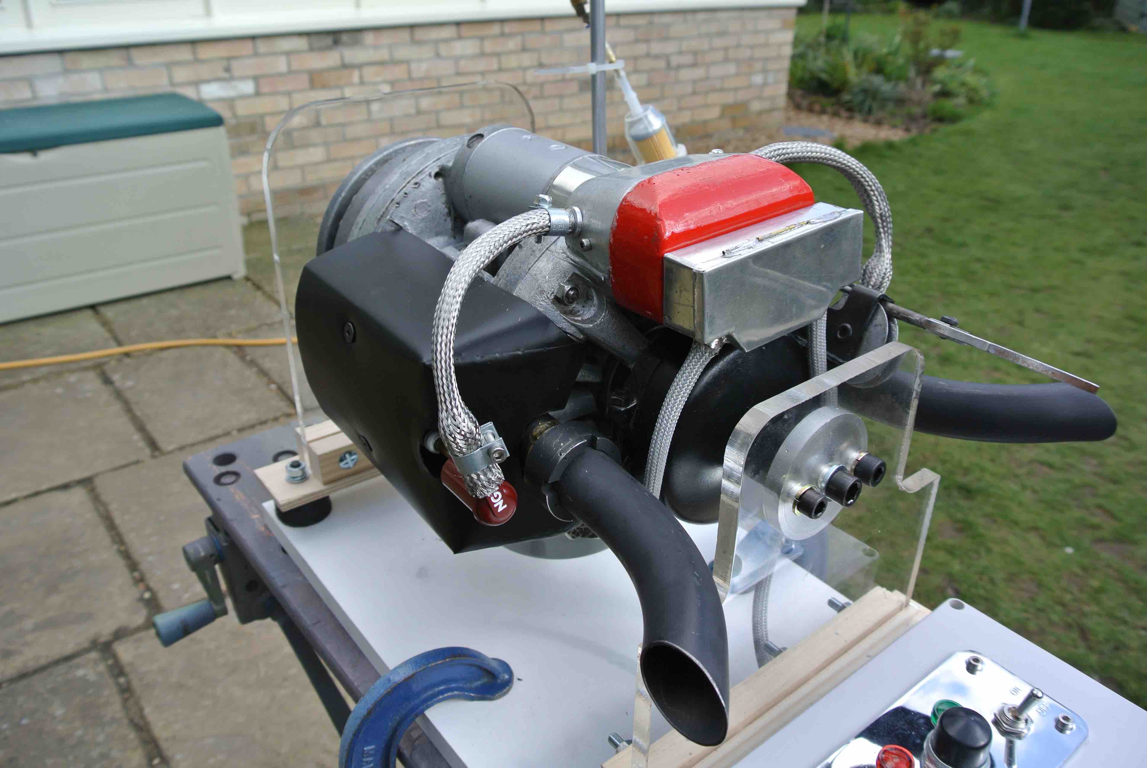

I know that this is full size but you may find it interesting.
All German WW2 turbine engines were started by the very small compact Riedel starter, a 2 stroke air-cooled twin cylinder engine sited in the bullet fairing of the intake of the jet. They made around 8000 of these little engines and they often ended up in museums and go carts.
The small petrol engine was started by either using the pull handle or by the 24v electric starter. This meant that the plane did not need a service vehicle to start the engine. The little engine uses case pressure to case pressure to push a piston backwards sending the dog clutch to engage with the front of the turbine shaft.
This is an amazing little engine and has many rolling surfaces with roller bearings. The electric starter motor for example has a simple ball race at the front but at the back there is small roller bearings and a very small epicyclic gearbox. The starter gear grabs onto the shaft by means of a one way sprag clutch. The flywheel has balls in galleries that are thrown out by centrifugal force and they exert force on the wet clutch to engage the rear gearbox which is also epicyclic.
Over a year ago now I managed to find a Me 262 starter motor from a motor bike dealer in the Netherlands. However it had many parts missing and it became obvious that it had been dropped early in its life and damaged and then robbed of parts. I spent many hours making the missing ignition system , the carburettor and the piston and dog clutch. I now have it all screwed together and have it running for the first time. The one good thing was the engine had hardly been run at all. There was no sign of wear in the bore of the one cylinder I took out. The bad part is that there is very high compression and it is quite a job to turn it over! I know nothing about 2 strokes and have learned a lot. Fortunately there is a Bernd Sobek who is the world expert in them and has several running who has helped me . Roger Emms also helped me with 2 stroke information and assist in getting it started.

Old 04-28-2016 | 08:50 AM
Joined: Jul 2006
Posts: 1,409
From: Norfolk , UNITED KINGDOM
Thanks Dave
I really enjoyed this one.
As finished and as received
The carburettor in pieces as machined and assembled
The pressure piston assemble and dog clutch

Fantastic project John, congratulations on getting it running. Very interesting mechanical design.
I went hunting on Youtube and found this video showing the original pull starter had quite the kick too!
https://youtu.be/oBH0ULVmsow?t=6m23s

interesting bit of film. The engine shown was much more free than mine. This appears to confirm that mine did very little running. It sure gives you a workout!
John

I wonder if the compression is so high because it ran on jet fuel not gasoline...

I've always wondered about these engines. What is the displacement?

The Ridel starter ran on standard petrol (gasoline). It has a separate fuel tank in the nose of the engine.

The engine has a bore of 70mm and a stroke of only 35mm total volume 270cc. The engine runs at 7,000 rpm with a full jet only so it reaches max rpm as quickly as possible. The engine has covers over the finned cylinders and these are used to try and deflect the cooling air from the front mounted fan around the fins to keep them cool. The engine was fully tested in 1945 by RAE Farnborough and that 27 page report is still available They found the engine produced up to 9 BHP. The cooling was not good and the little engine was only to be used for a max of 4 minutes. Power dropped off quickly was it became hot.

The 004B-1 produced a thrust of 2,000 lbf (8.90 kN) and ran primarily on diesel fuel. Gasoline was used for the two-stroke starter motor and for starting the turbojet. A combination of gasoline and diesel was used after starting and then to all diesel fuel.[SUP]6[/SUP]
However, Eric Brown records it also ran on 87 Oct petrol with 5 % oil mixed in.

The starter was also used for the He162 to start the BMW turbine. The pull starter makes a lot of sense because it was always possible that it would fail to start on the electric starter. Robert Riedel the designer even thought of building in a slip clutch on the Electric motor to avoid it being overloaded, but this has to be correctly set up. The pilot could start the engine from the cockpit using the electric starter. I did read one report when 3 planes were scrambled and only one was able to get the engines started.

Interesting question. I found a while ago that Ken Wallis, who has only recently died, adapted one to power a Slingsby Petrel glider and it seems that it made 10 flights or so. Here is a photo of it mounted on the glider. Ken Wallis was the guy who was famous for autogyros and made the Little Nellie for the James Bond film. The flights were made in 1949.
http://www.scalesoaring.co.uk/VINTAG.../Powered_2.png
There was also also a glider in Poland powered by a 4 cylinder engine made from 2 Riedel starter engines joined together.
