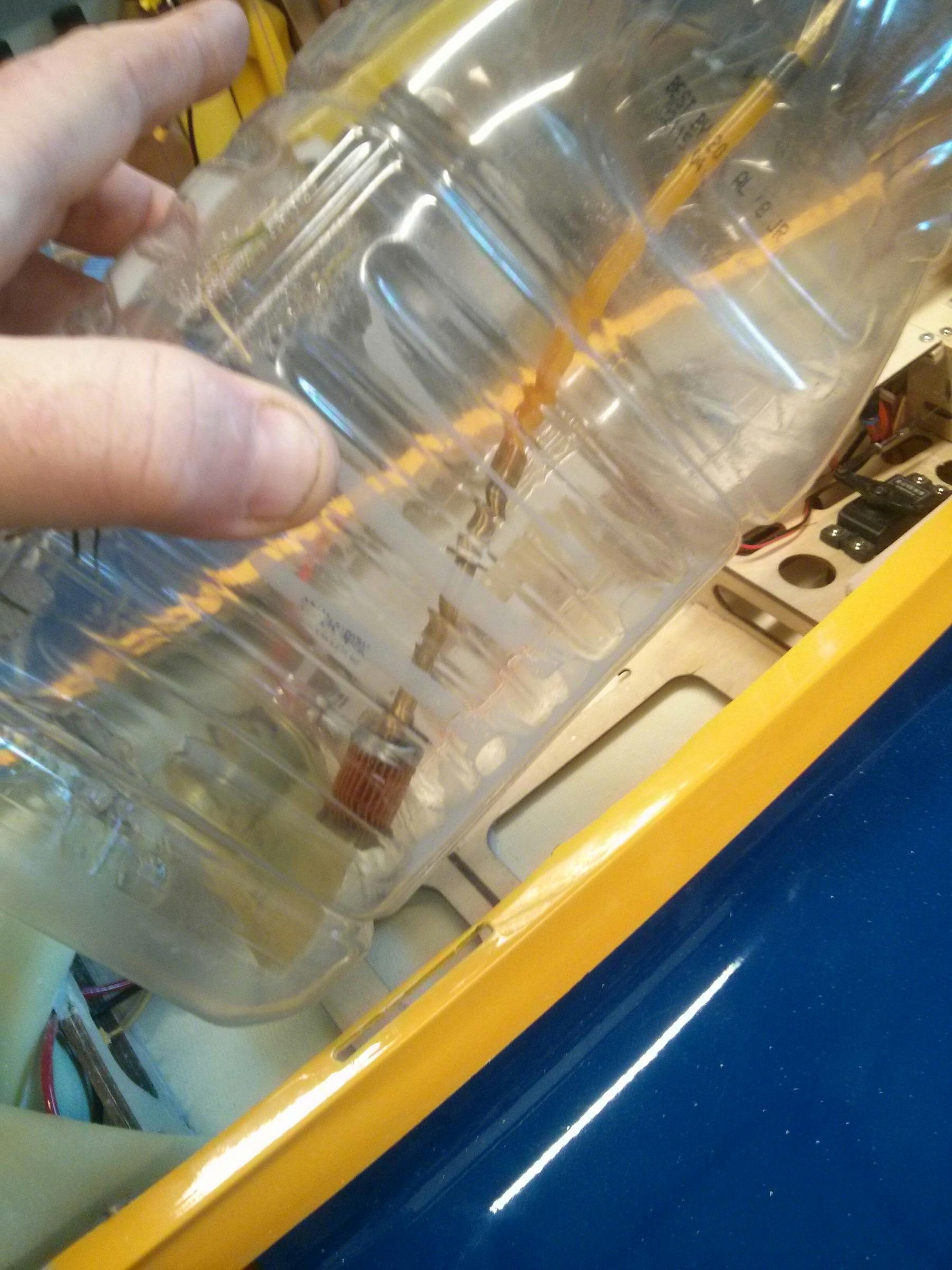

OMG.. Why do people put them selfs threw so much trouble! UAT's are the problem! Just dont use them and you will be much happier. I stopped using a UAT years ago and have never had a flame out since the last time the UAT leaked air.. Use a paper pleated clunk. Not sure where to get one? Pull it out of your UAT LOL

Not using a UAT will greatly reduce the risk of getting ANY bubbles....So why use em? There is a least 6 points that could develop leaks with a UAT.
But getting back to your post.. I did have a P-80se that ran for quite awhile with an airleak till I found it was the cap on the UAT getting loose and not letting it get full rpms
