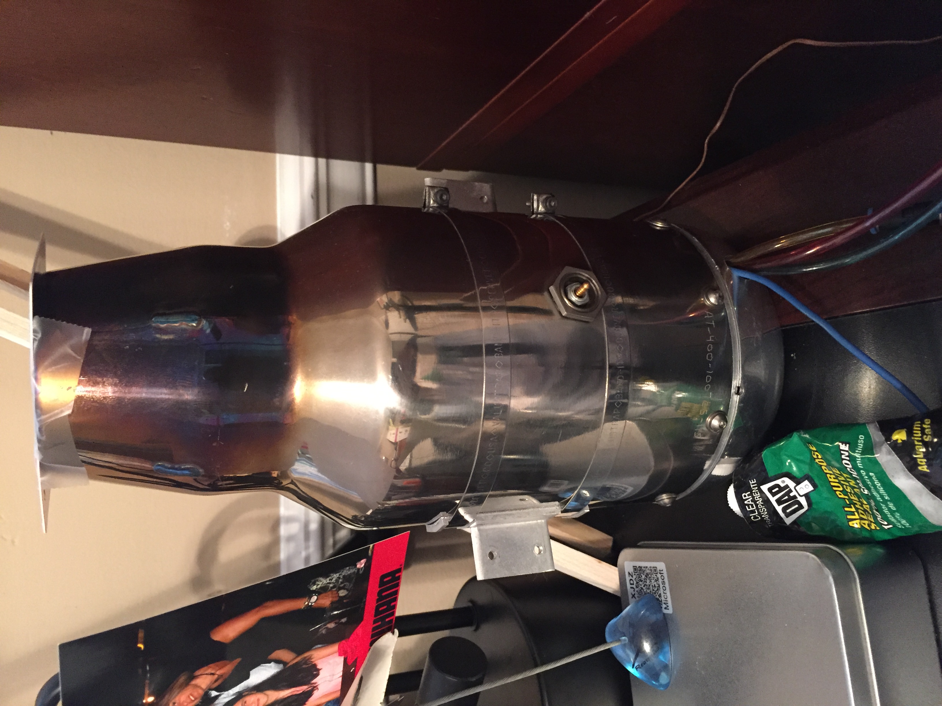

I have a 0 time AMT AT-400 that I won't use. Make me an offer I can't refuse!! Or we can do a trade!! I have a BVM Bandit built that needs glassing and paint and you're a great painter. Wanna make a deal?
My AMT comes with ASU as well

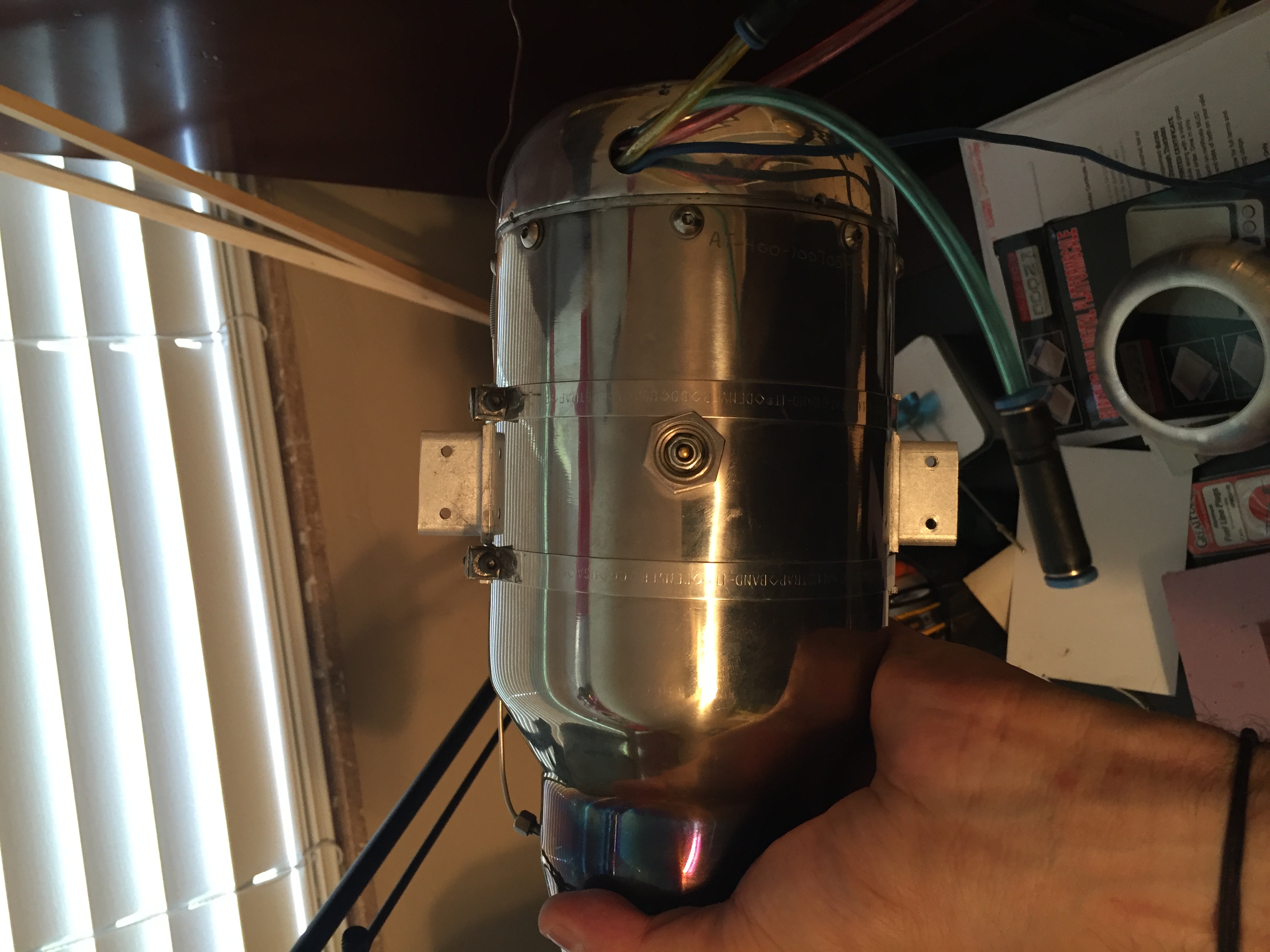

ID:	2175974   Click image for larger version

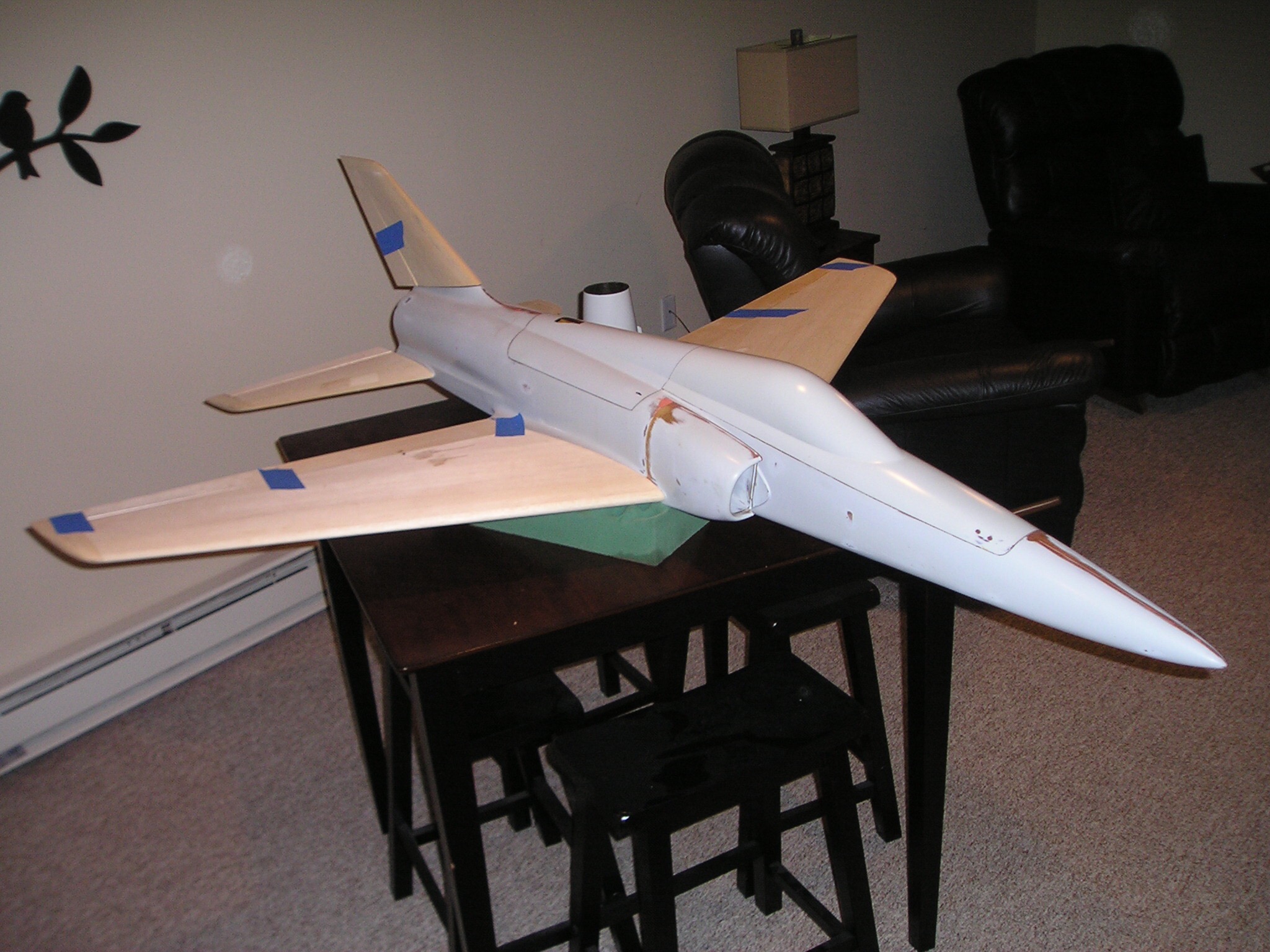

Here's my bandit
