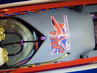

Hello Guys,
I need some help on how to connect my compressor to my aircraft to fill the tanks. I have 4mm Festo check valves in the aircraft, so how do I connect a 4mm festo tube to my air compressor? Here how I have it now, which is not very good.
There's got to be a better way. I would like to keep it with the Festo fittings in the aircraft, I am not a fan of the "screw in" type connection.

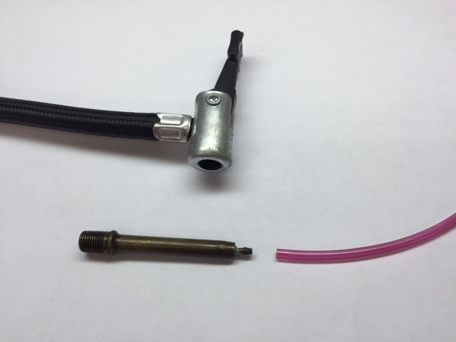

Many years ago I took the brass metal core out of a discarded tire stem. I cut off and then burned the rubber off with a torch. I then soldered a piece of brass tubing into the non threaded end. Been using it for 35 years.
Another option is to get a piece of tubing that will slide over the ball needle threads and a 4mm Festo straight fitting like a coupler. Then hysol the tube over the ball needle and festo fitting to hold them together. When cured screw in the needle base to the pump and attach 4mm tubing to the Festo fitting.

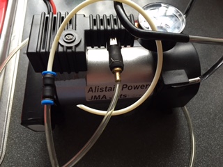

As David said, BVM fill valve, and a simple connection on to the air pump, all available from M&R
Alistair
r
ID:	2176391   Click image for larger version

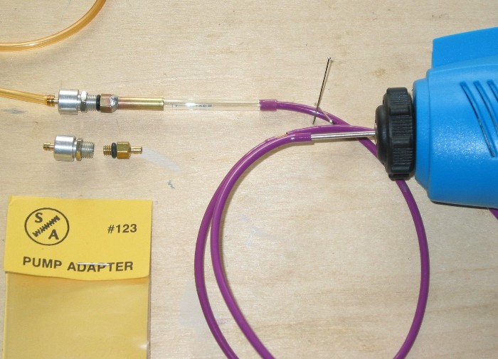

Or there's my tightwad version if you have a Springair fill valve and a 4mm socket. The screw-in connector complete with soldered-on socket stays put. Works like the BVM $$$$ version; push in the 4mm tube, switch on your compressor and bingo.
Name:	Pump Adapter 002.JPG

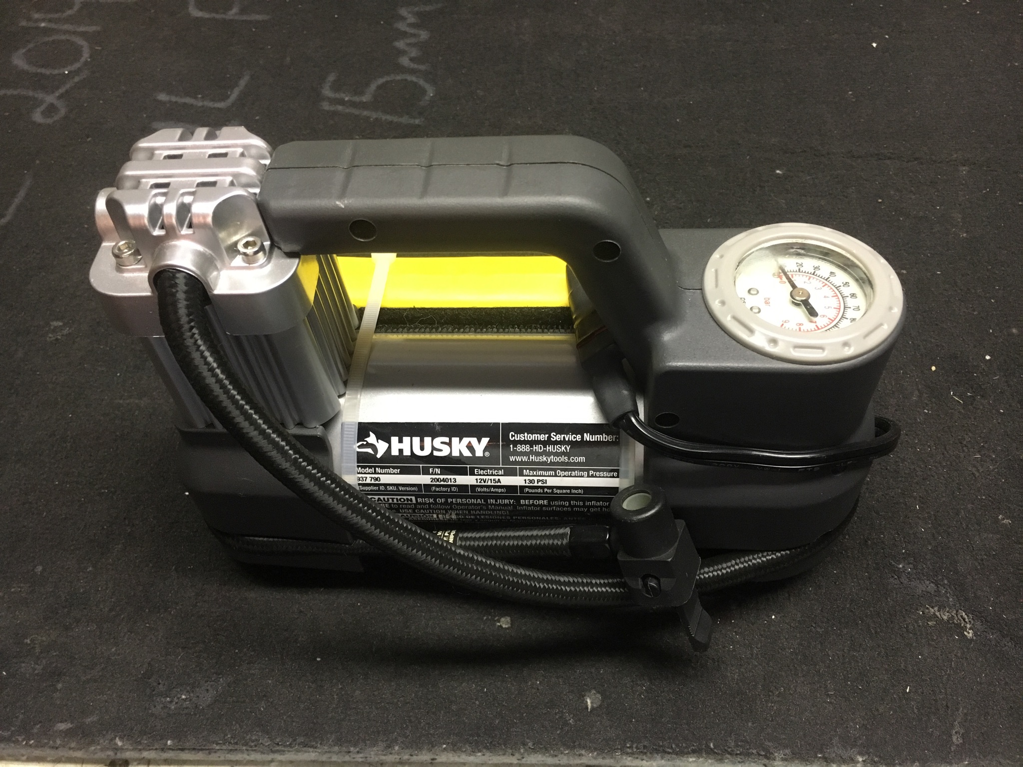

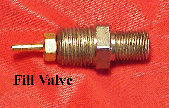

I'm with TT on this. I always thought that the tiny screw in fittings were a pain. I have Century Jets fill valves in all my planes. It's also a standard Schrader Valve and I fill it with an electric pump that has a standard tire fitting.
There's no need for overpriced fittings, adapters or tiny tubing. If a valve ever leaks you can fix it for less than $1.
ID:	2176764   Click image for larger version

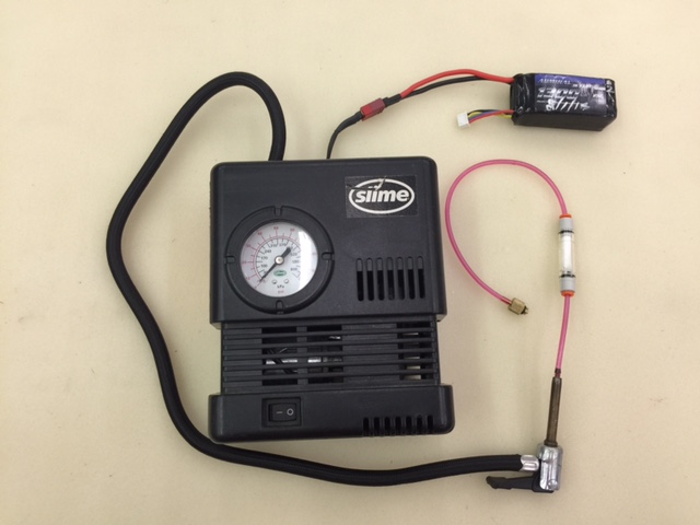

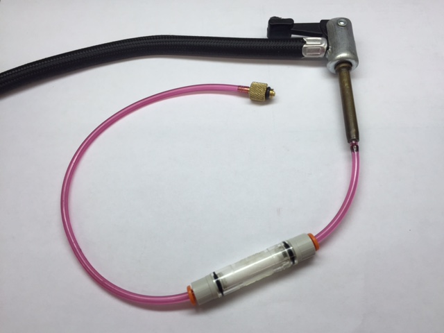

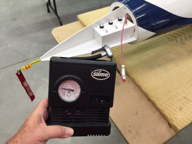

Old 08-25-2016 | 06:14 PM
Viper1GJ's Avatar
My Feedback: (20)
Joined: Oct 2003
Posts: 2,463
Received 345 Likes on 227 Posts
From: Saint George , SC
I was installing a water filter on my air pump today so I took some photos of what I use. The connection to the pump is an old tire stem with the rubber stripped off and a brass nipple soldered into the end. I use a 1000-1300 mah 3S LiPo battery. It all stuffs into the top of the pump and it is easily held in one hand. Compressor is a Slime brand from Walmart for $20.
Hope this helps,
Gary
ID:	2178282   Click image for larger version
ID:	2178283   Click image for larger version
ID:	2178284   Click image for larger version
