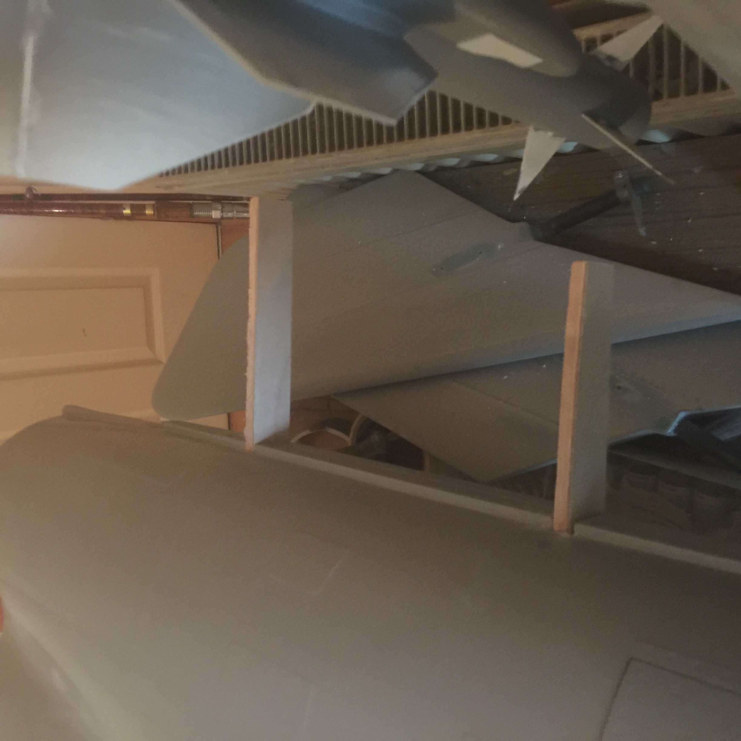

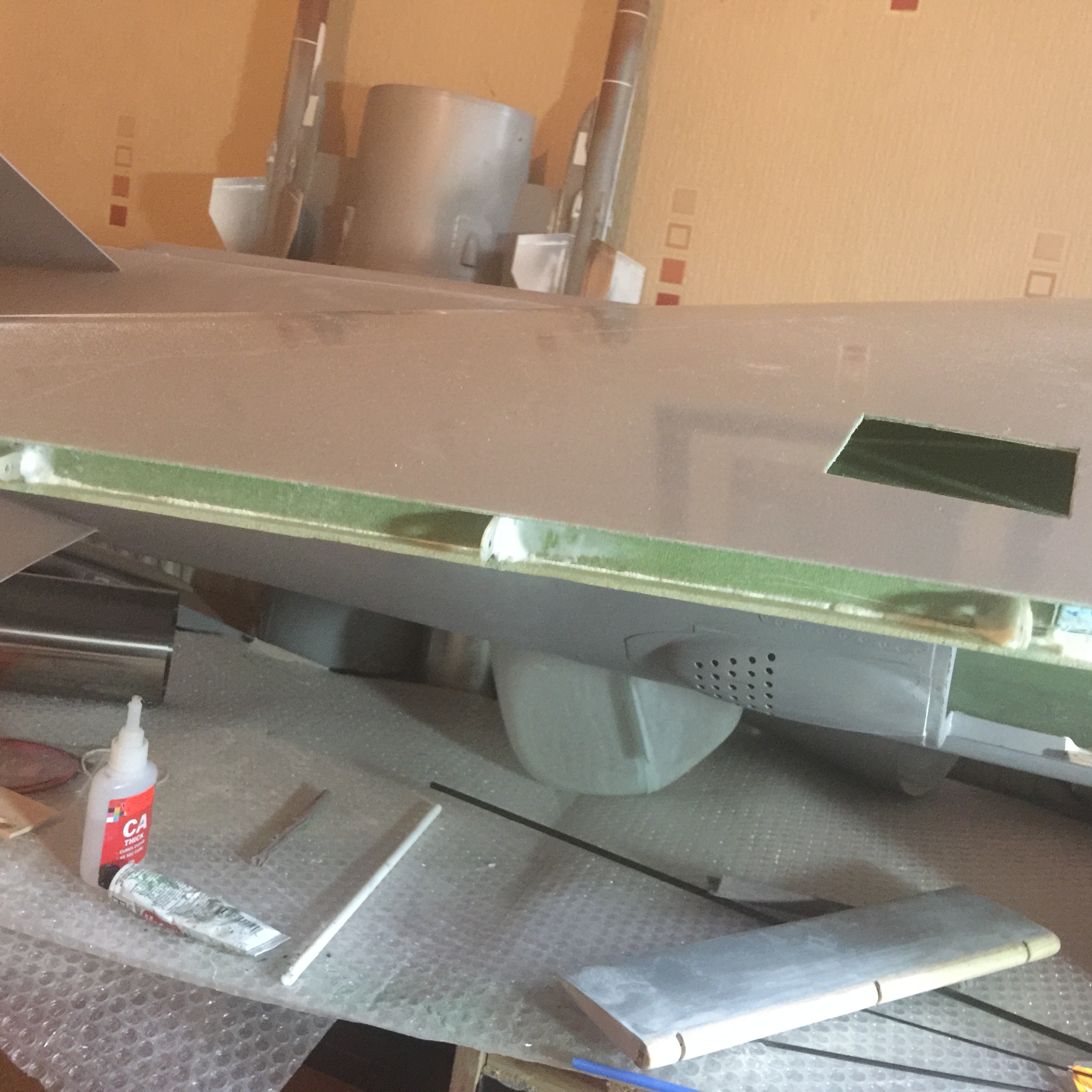

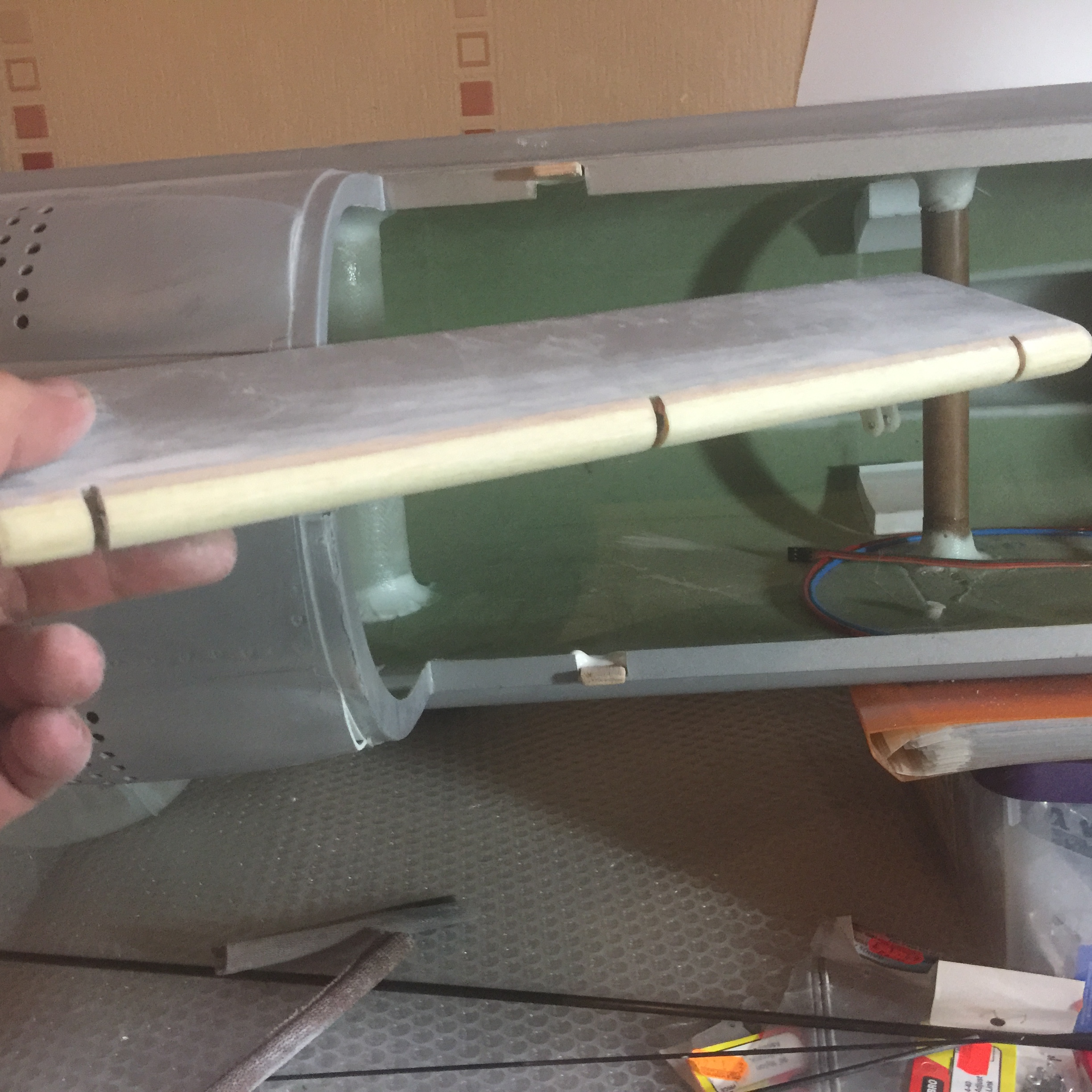

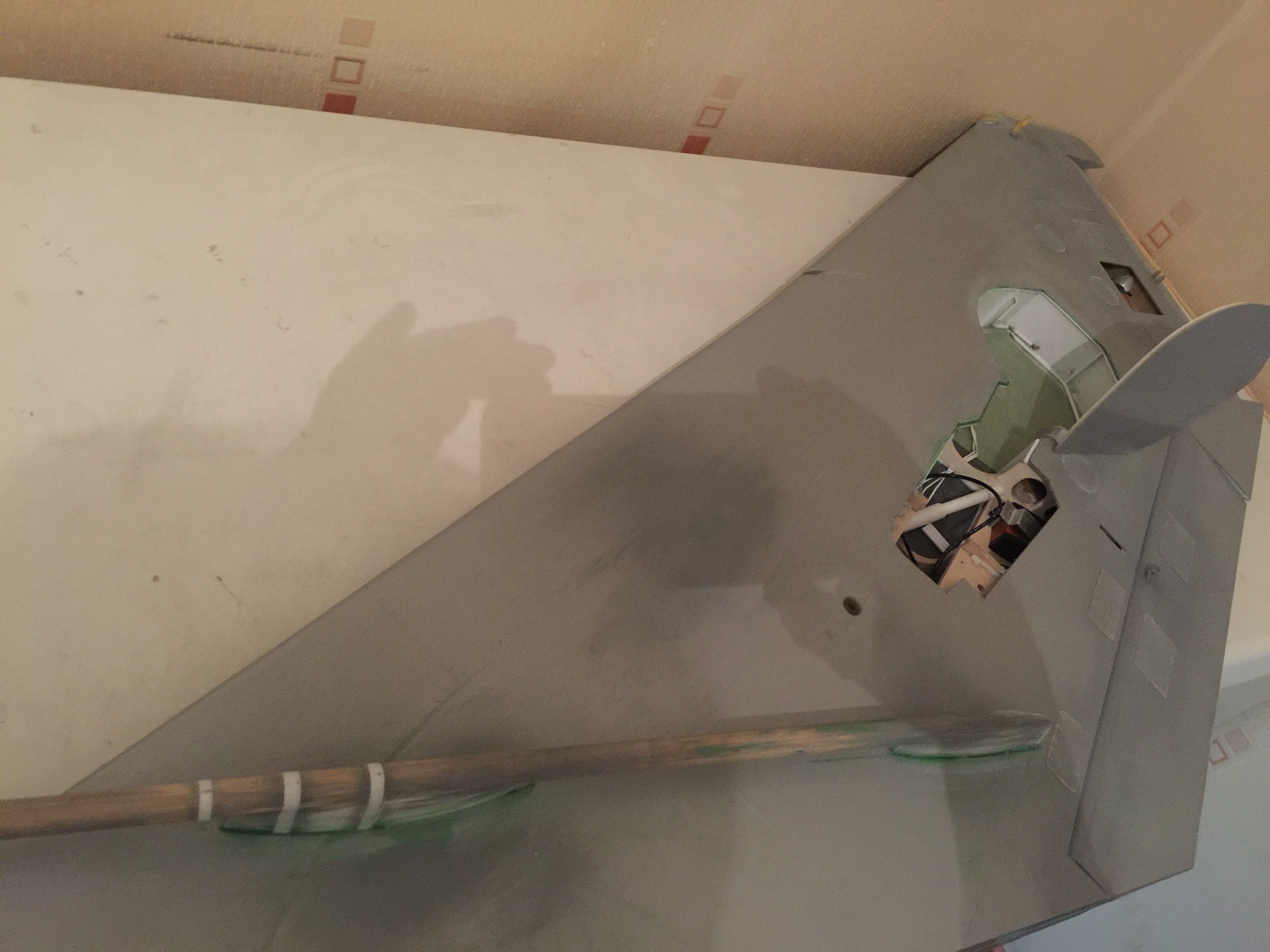

Ok so this weeks update, tail fin is added permenantly with some strengthening formers and spars added to make the mounting properly solid, scale fuel tank master has been made, needs a final polish before I make a mold to do some lightweight epoy ones, - also almost finished my own build/ design of thrust tube and afterburner, just got to add a couple of resistors to the 4 blue ones that aren't lit in the pic, this should add the tint of blue you get looking up pipe on a real aircraft aswell as the orange and yellow...

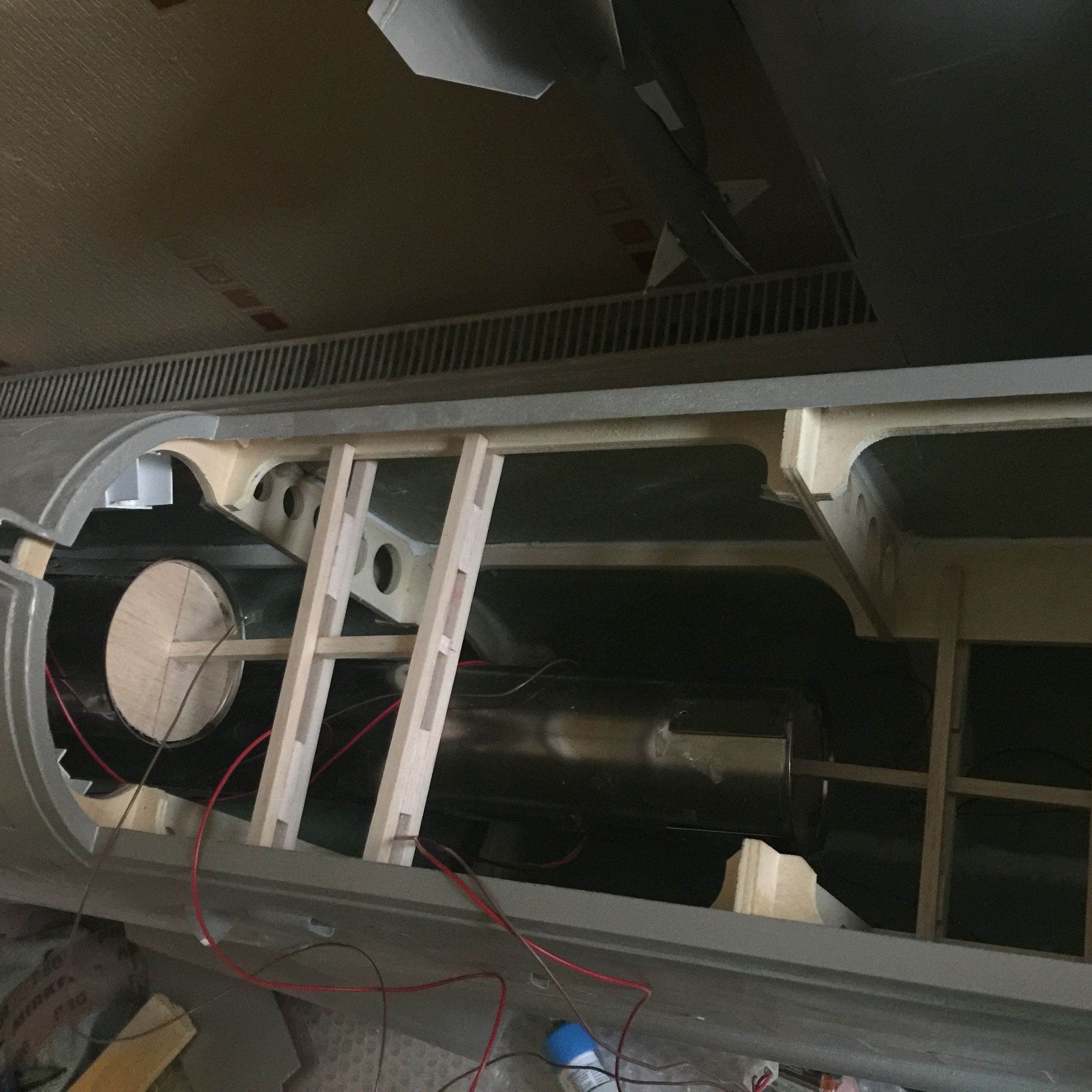

The fin has been glued on already but basically the kit fin involves a rudder post and a former that runs parallel to the leading edge, I basically added 2 fuselage formers that had fin extensions in it these were bonded into the fuzz leaving the extensions protruding out of the top, the fin then slid over these and they were bonded to the skin of the fin with the rear one meeting the kit spar inside the stab.
im definitely going against all advice and fitting 2 engines so didn't have much vertical height to play with in the fuzz unlike Trond who only had an engine in the bottom position.
if you look inside the fizz you will see what I assume is part of Airworlds answer to securing the fin, in the form of a cut out in one of the rear formers,i wasn't happy with just that amount of load transfer from a fin that size though to be fair, it is a very small rudder.
cockpit is built from H.I.P.S sheet(plastic card) not ABS as abs is too trick to join and I like using Plastic weld to build.

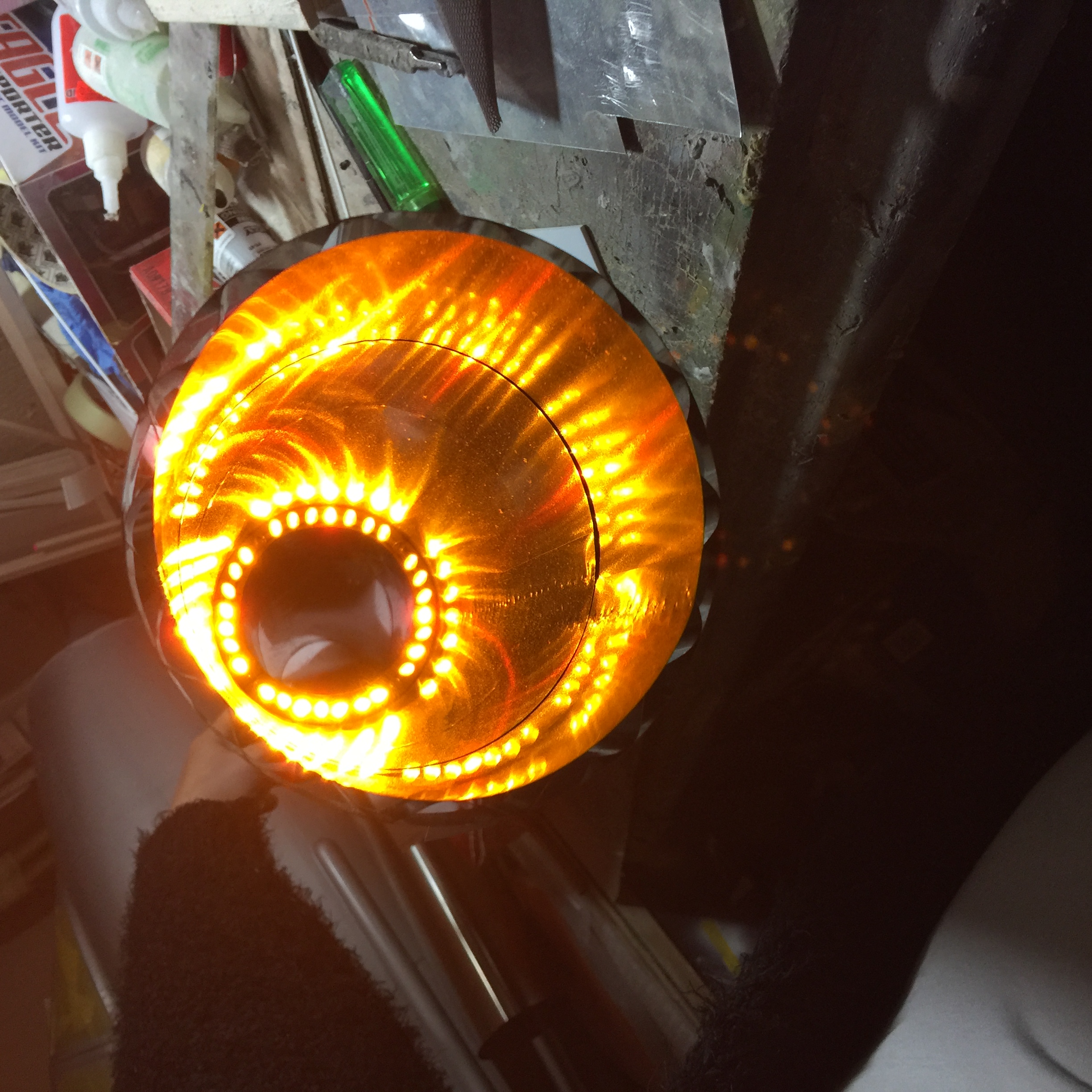

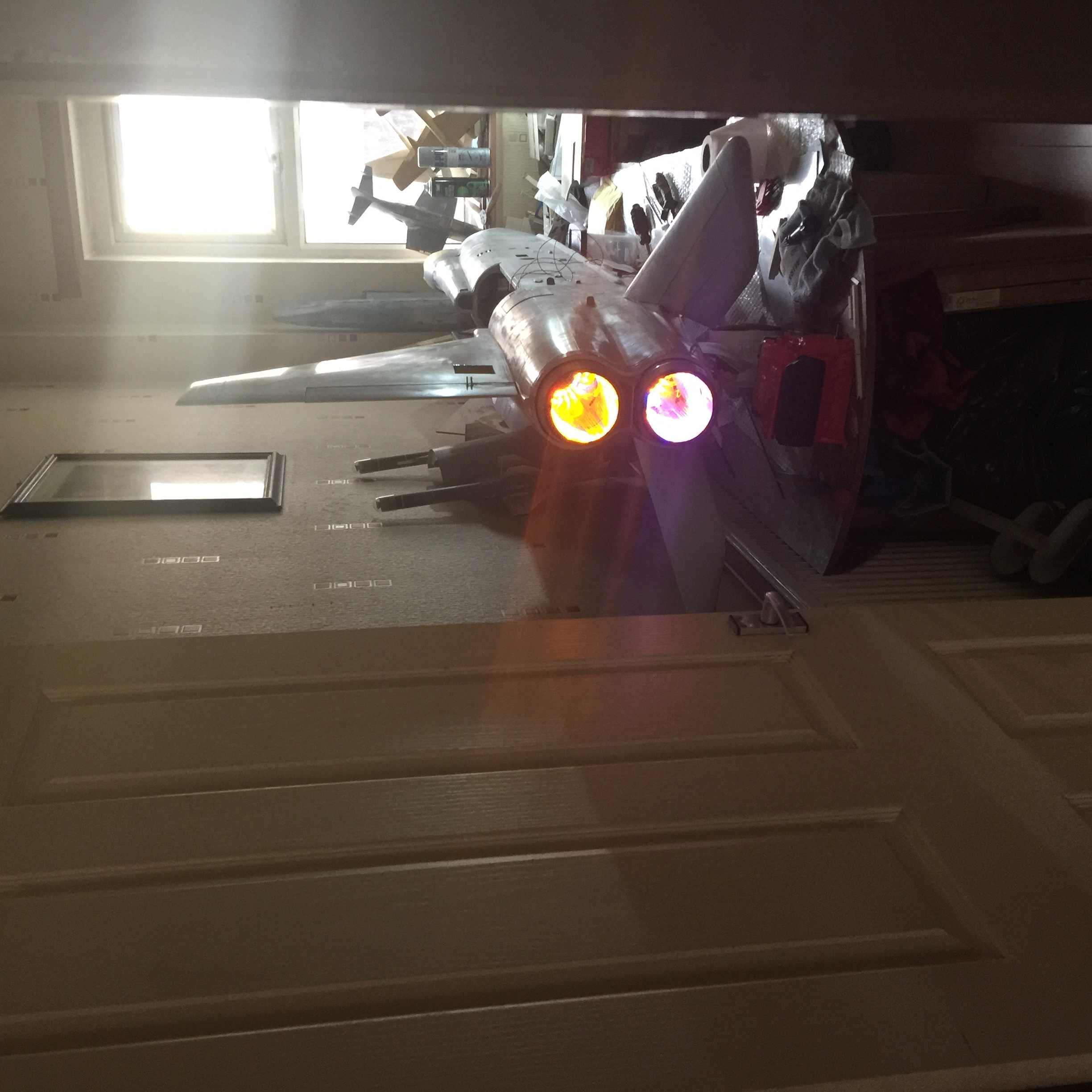

I am wondering how you have fitted the LEDs. they look as if they in the tailpipe itself?

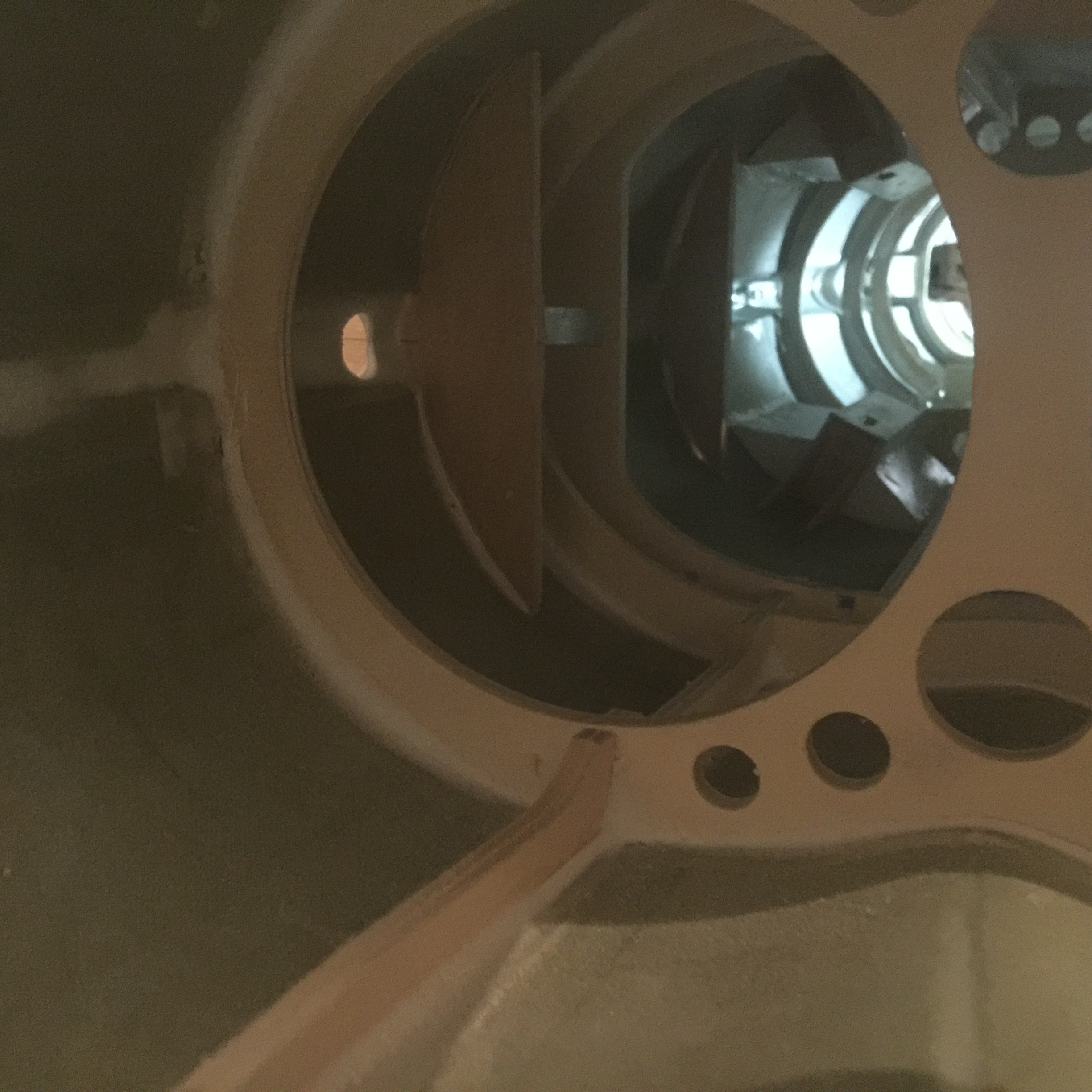

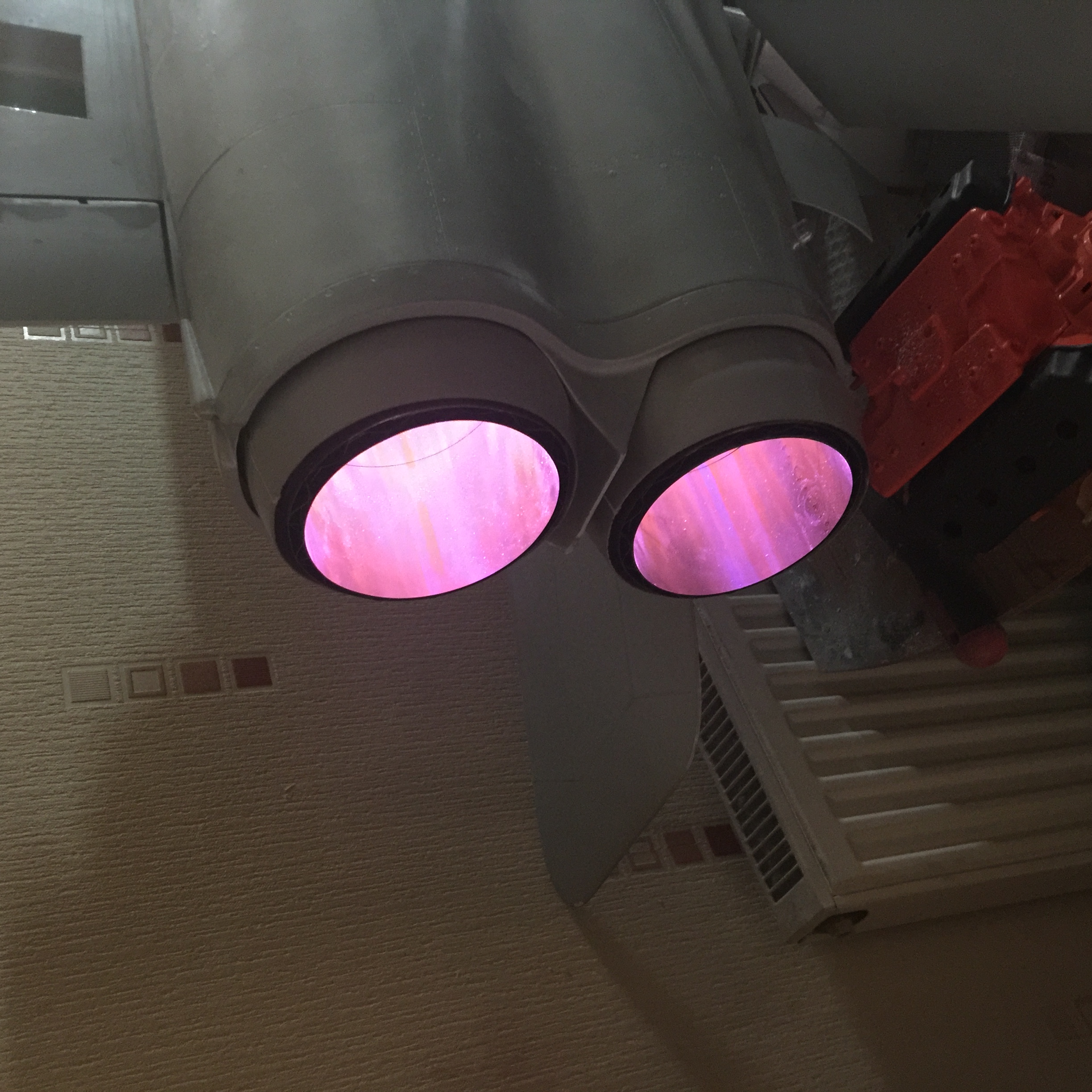

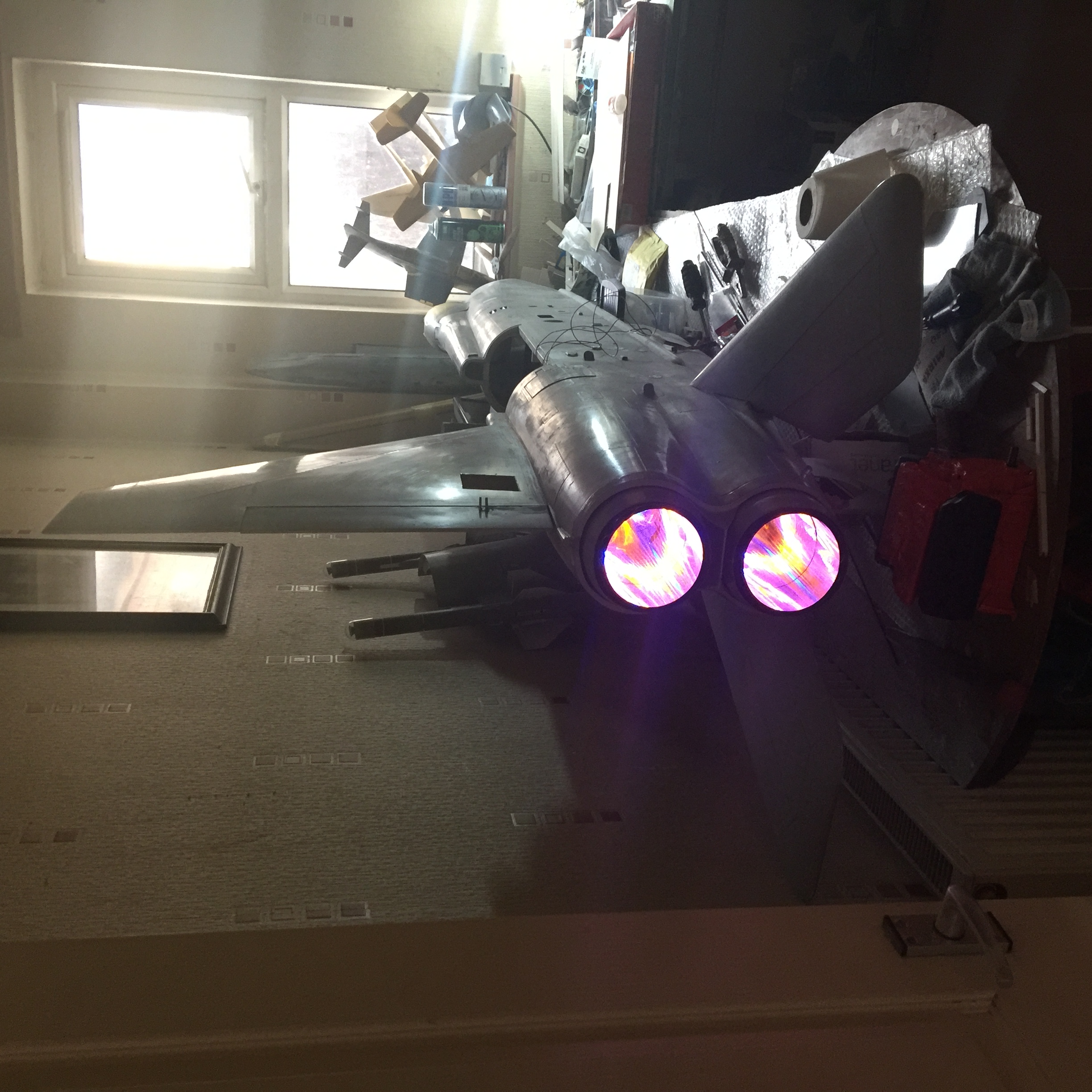

The pics don't really do it justice but you can see the temporary jig to ensure thrust tubes are central etc and the effect of my experimental lighting system for the homemade afterburner

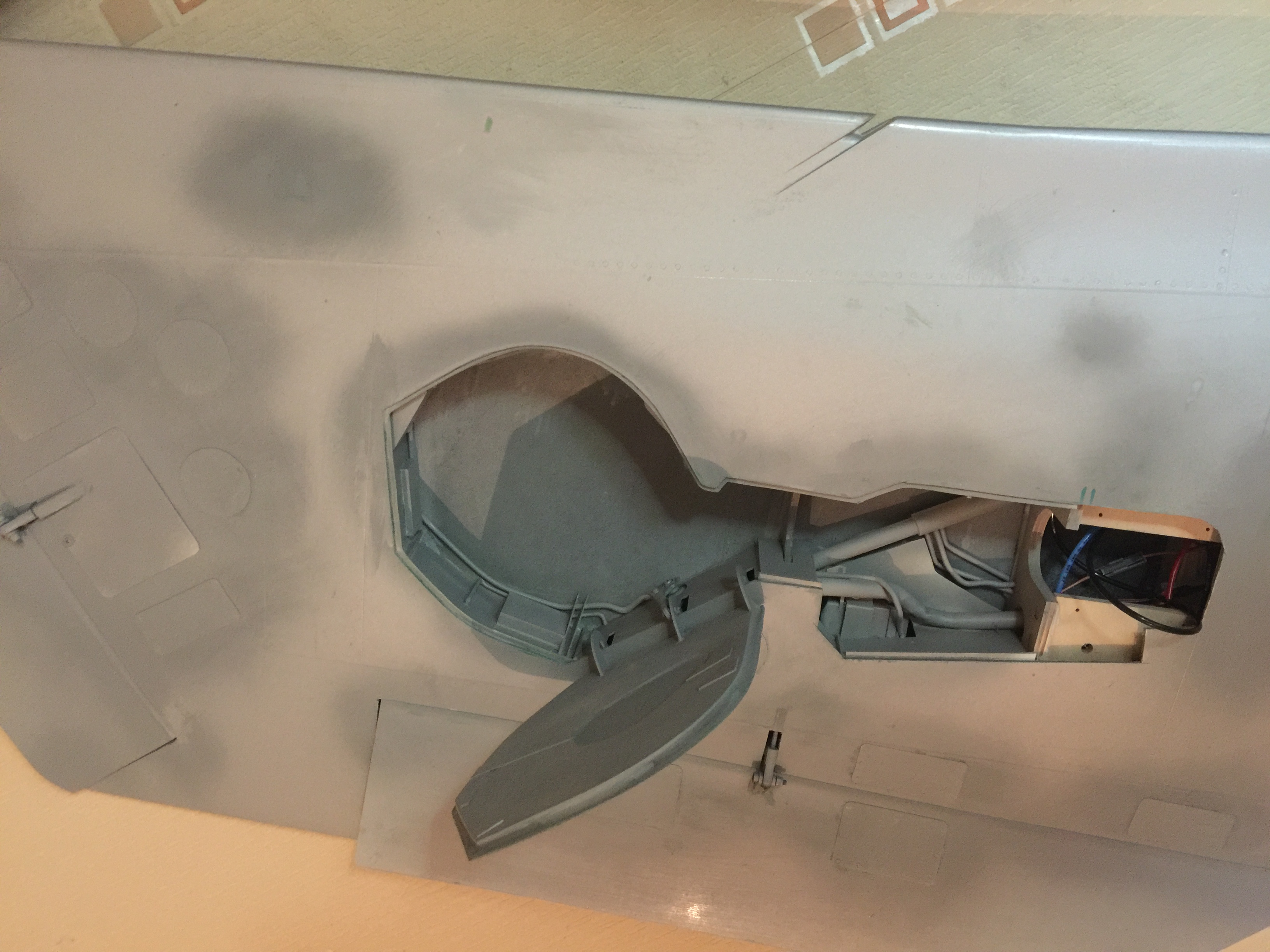

the Work continues, have installed and centred all servos and in process of connecting them up, got an electronics board sorted that is slowly having stuff added, it slides in and out of the top hatch for simple access, will post pics when complete, , gear bays are detailed as much as I can and overwing tanks are complete and fitted( and removeable) am really stuck now waiting for the main retracts from the idiot terrible customer service people that are airworld, , I got an email saying another 6-8 weeks and I'm going to hold them to it, ,I will be able to paint the airframe shortly, and be able to test run the engines prior to installation , hopefully that will take most of the 6-8 weeks , if anyone wants to lend me a set of mains or temporarily sell me a set for test fitting .....

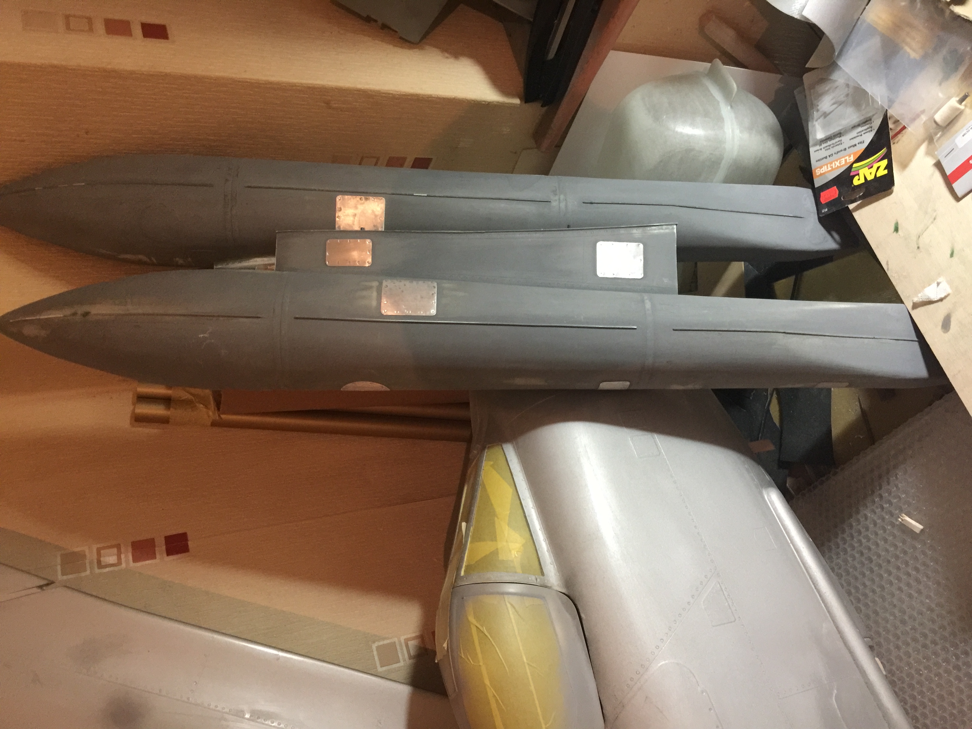

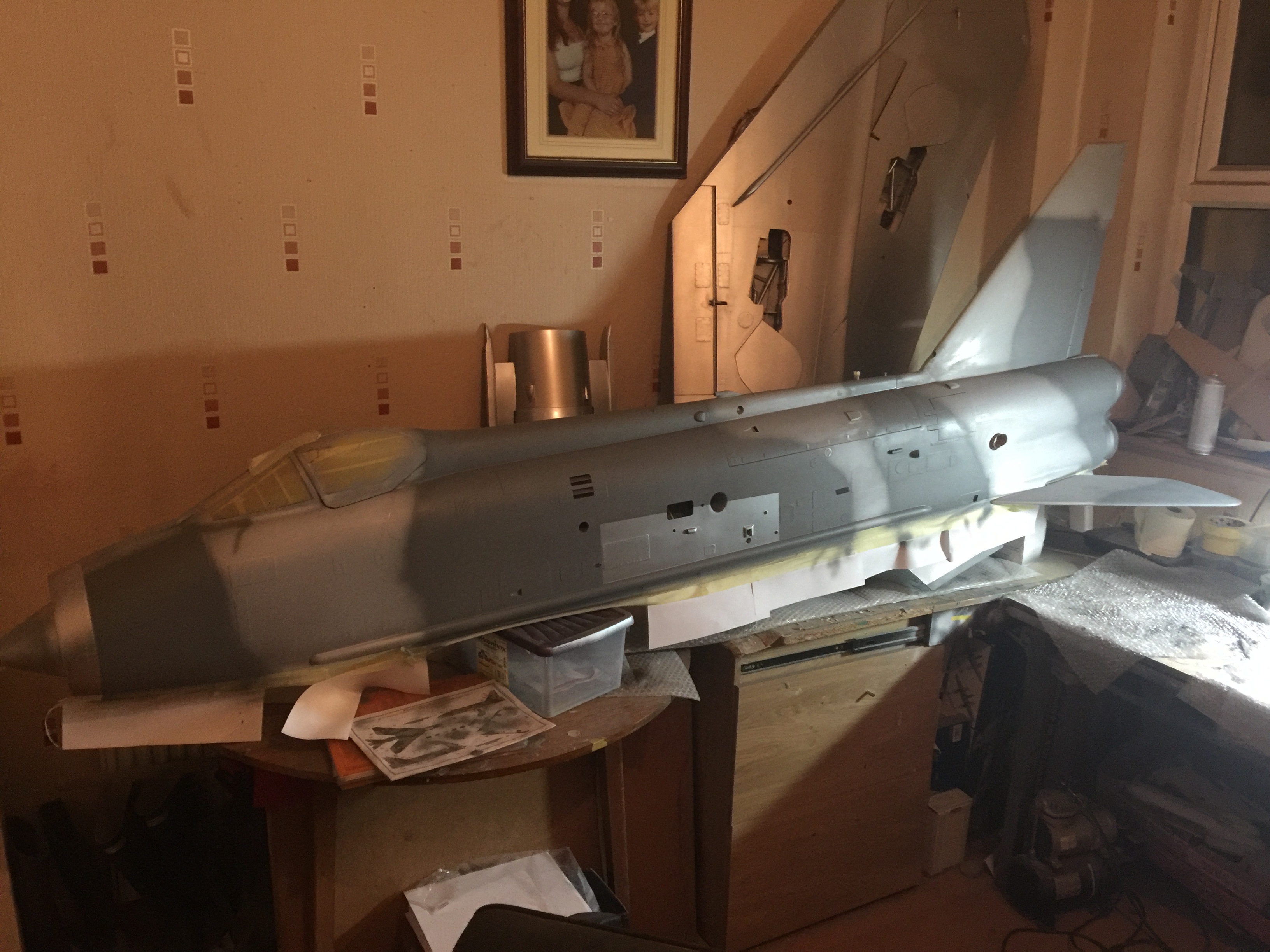

Painting begins.. few minor jobs left to do inside and main gear and engines still need installing

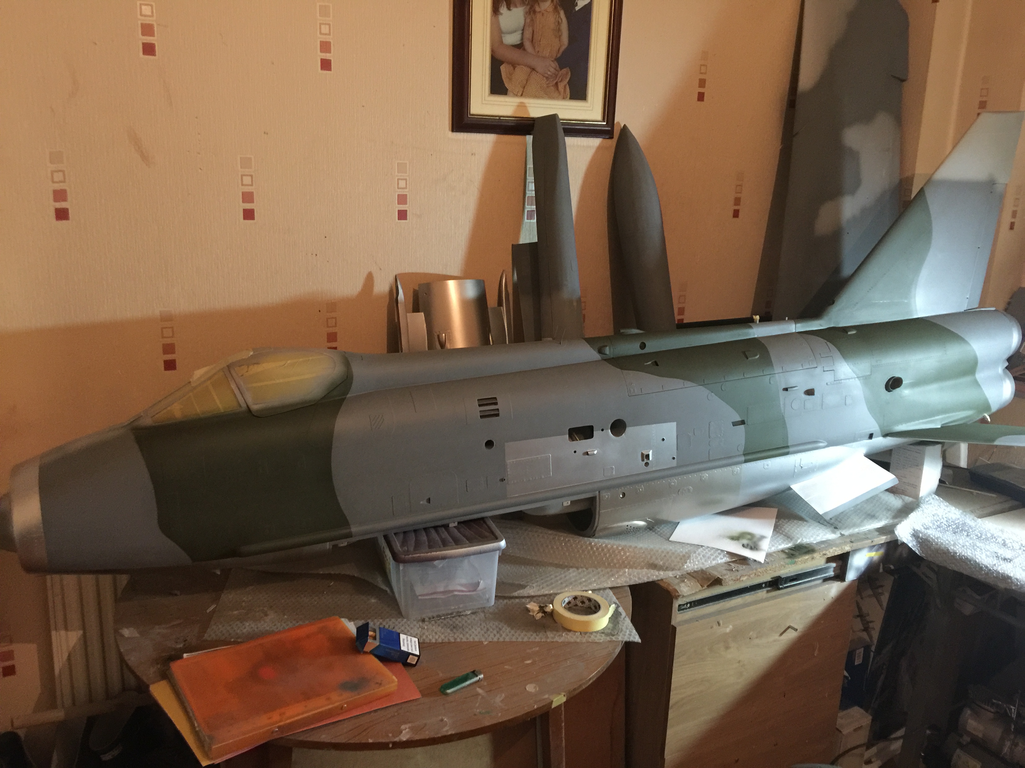

Basic colours on fuselage

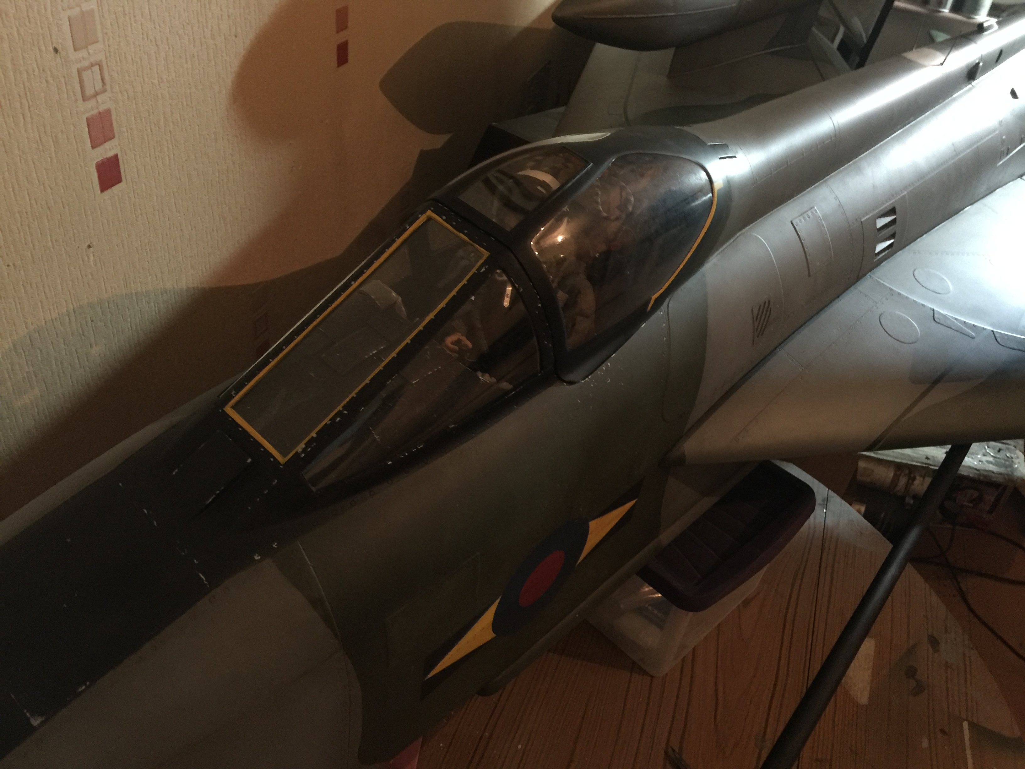

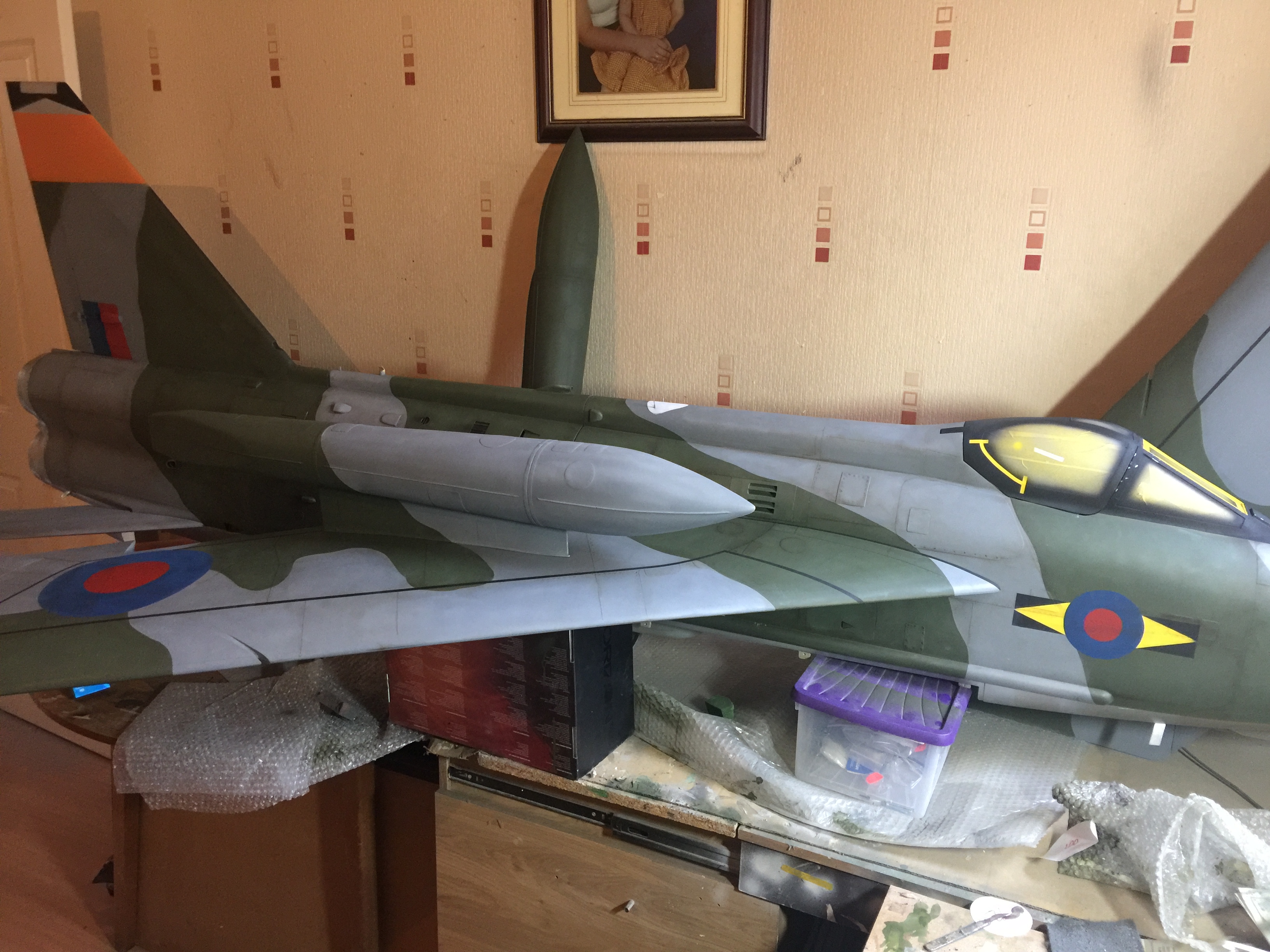

Weathering begins, love tired old aircraft that have worked hard for a living, trying to mimick a couple of shots I have of a very well worn lightning...

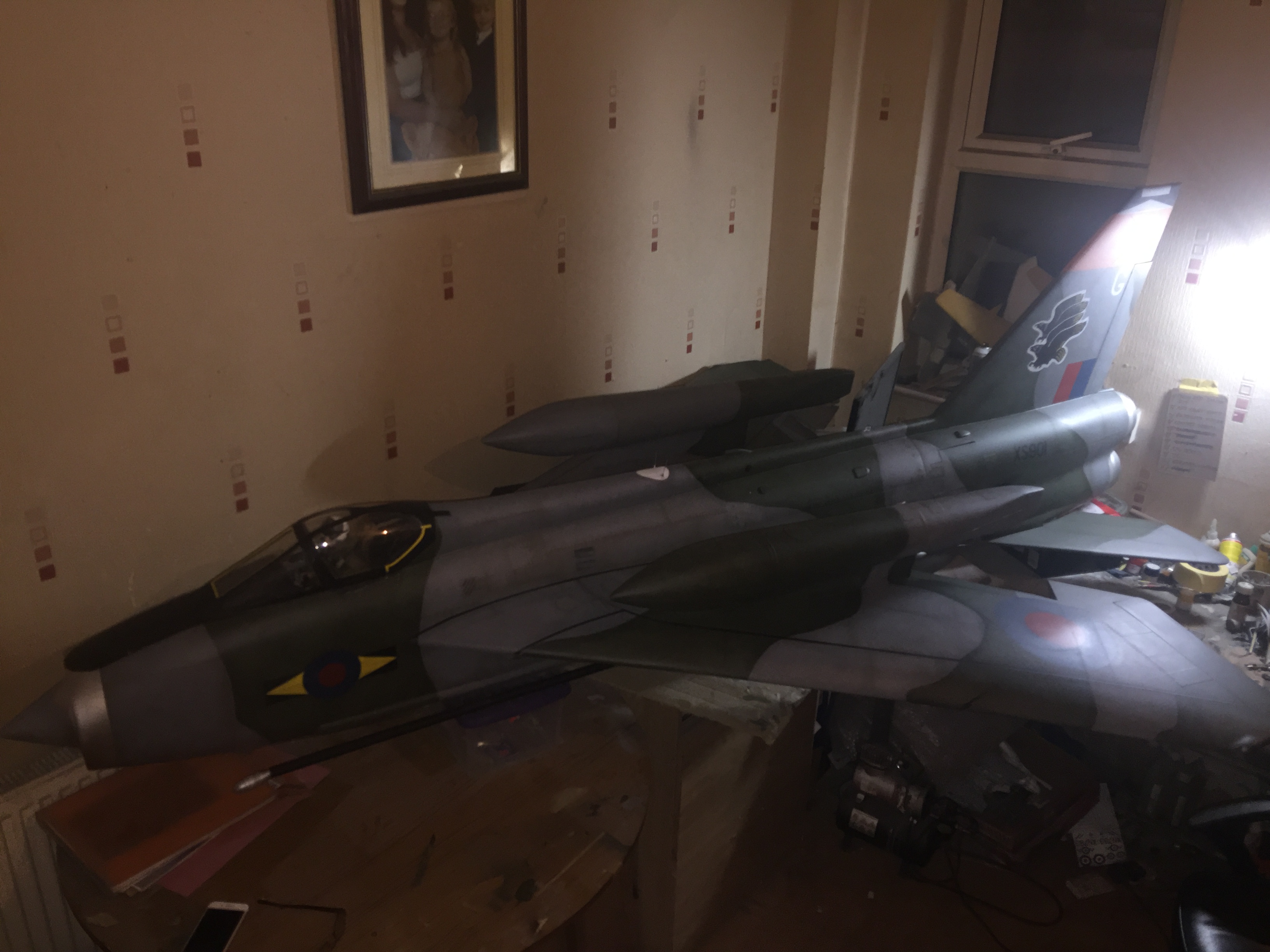

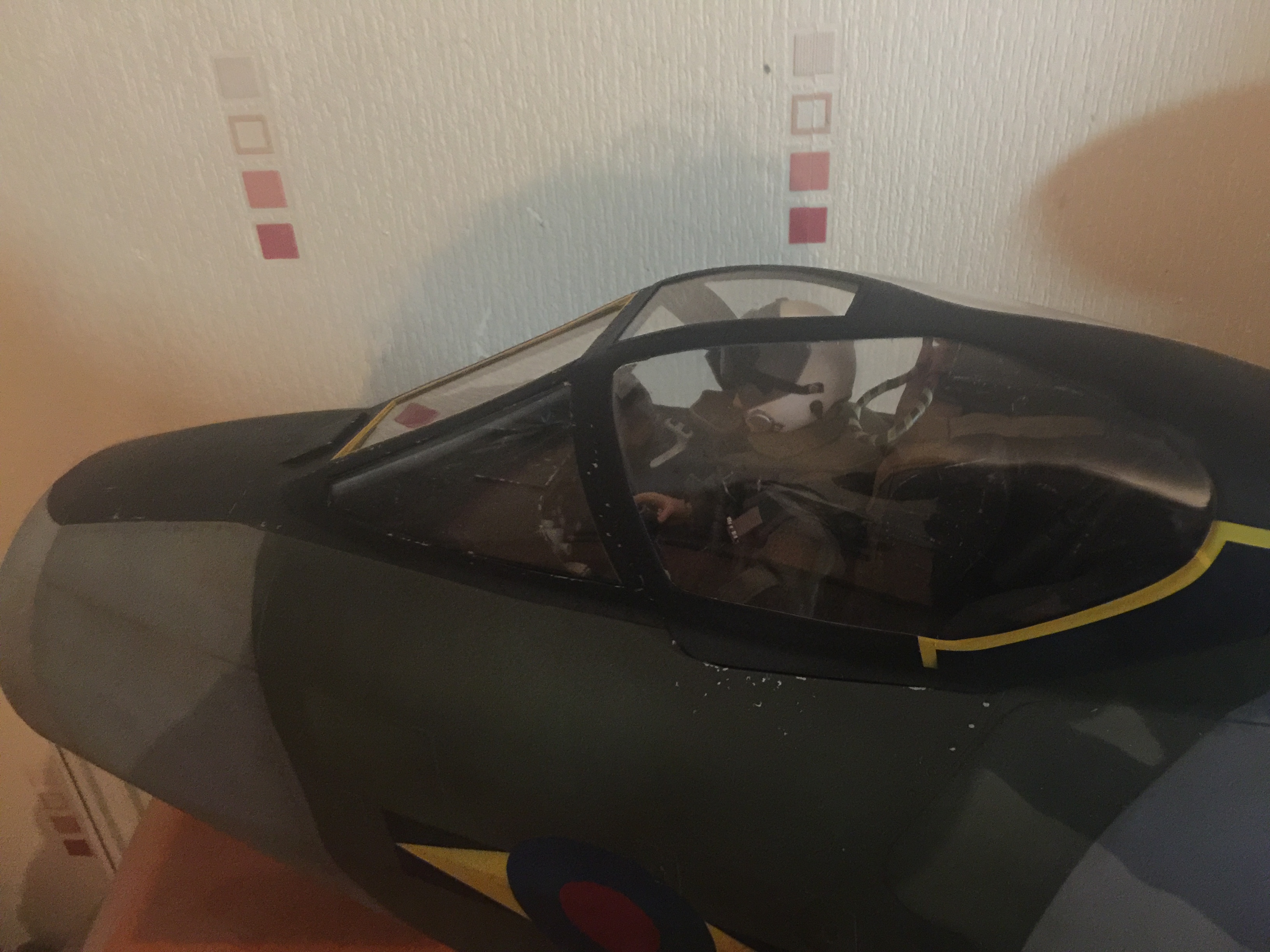

Test fit to ensure came lines and weathering weight match, a way to go yet but it's starting to look like a lightning

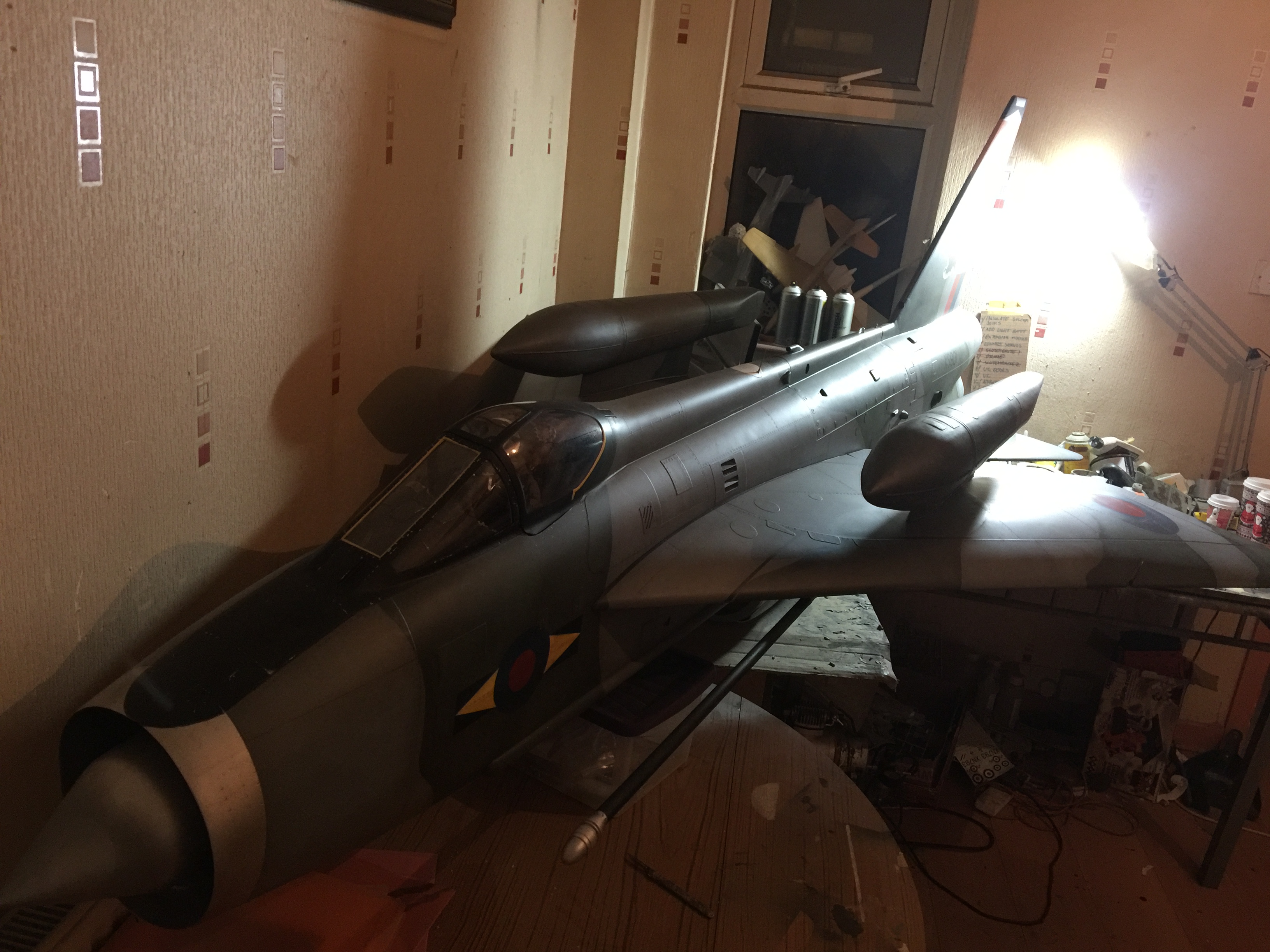

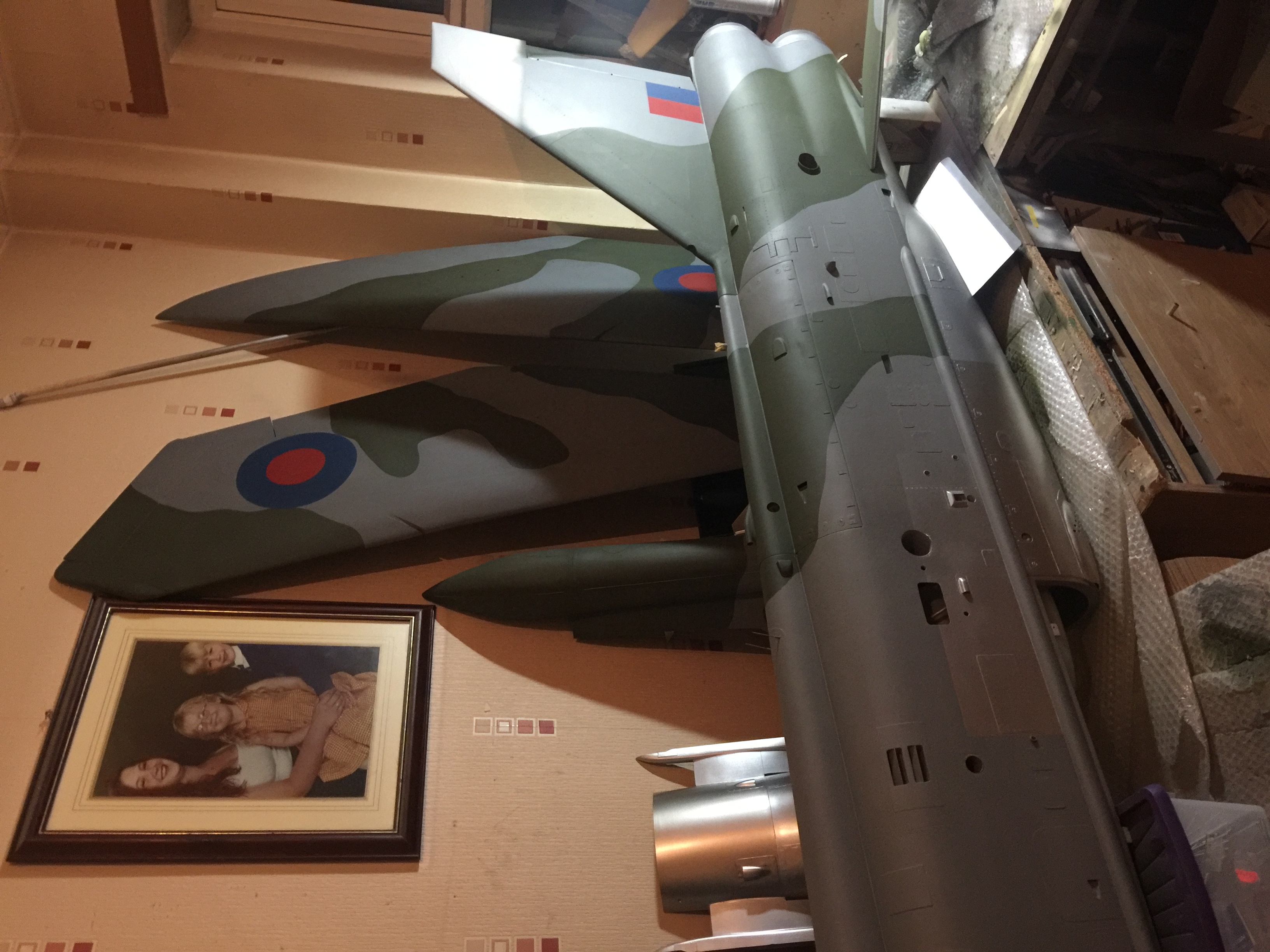

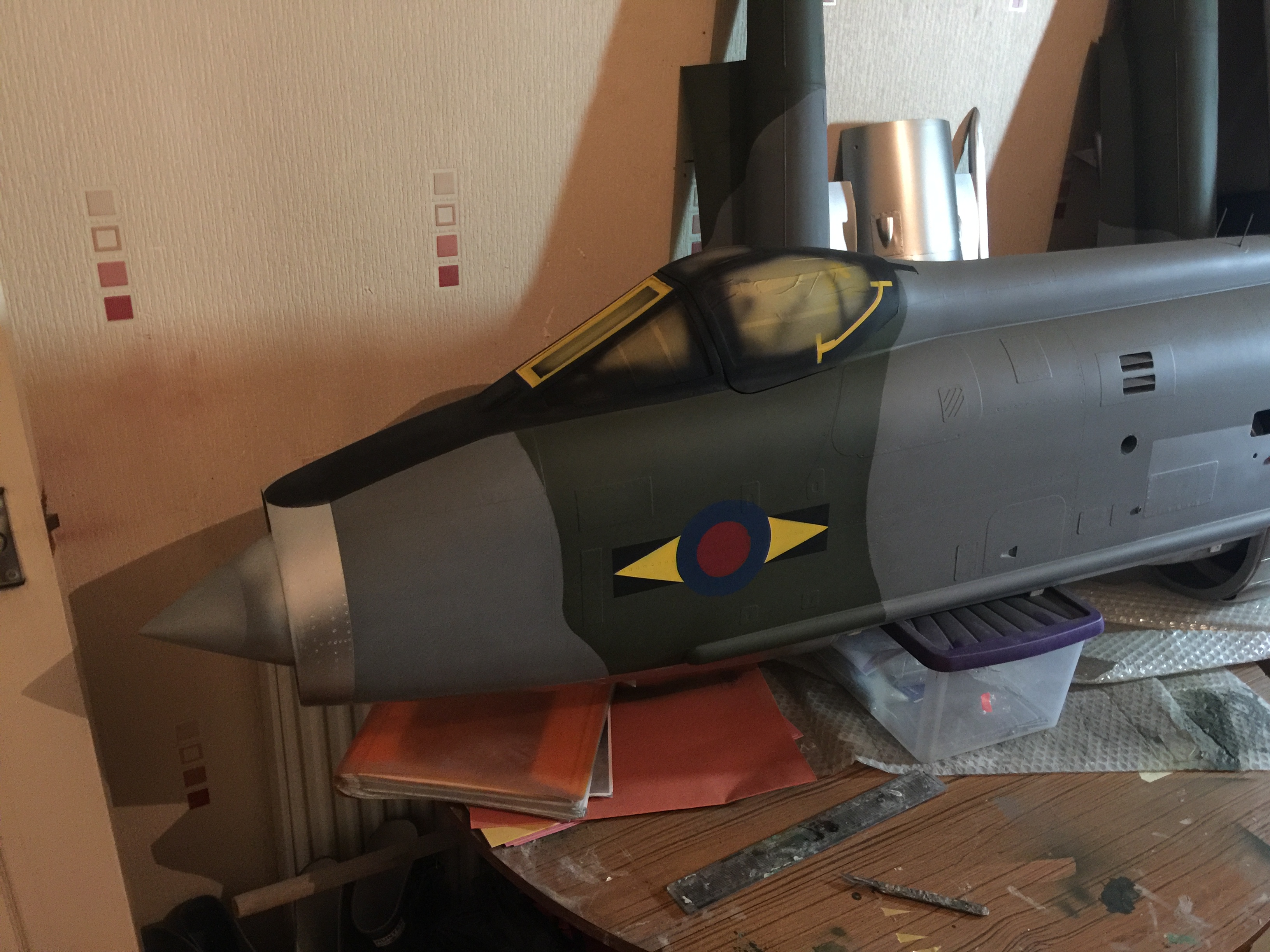

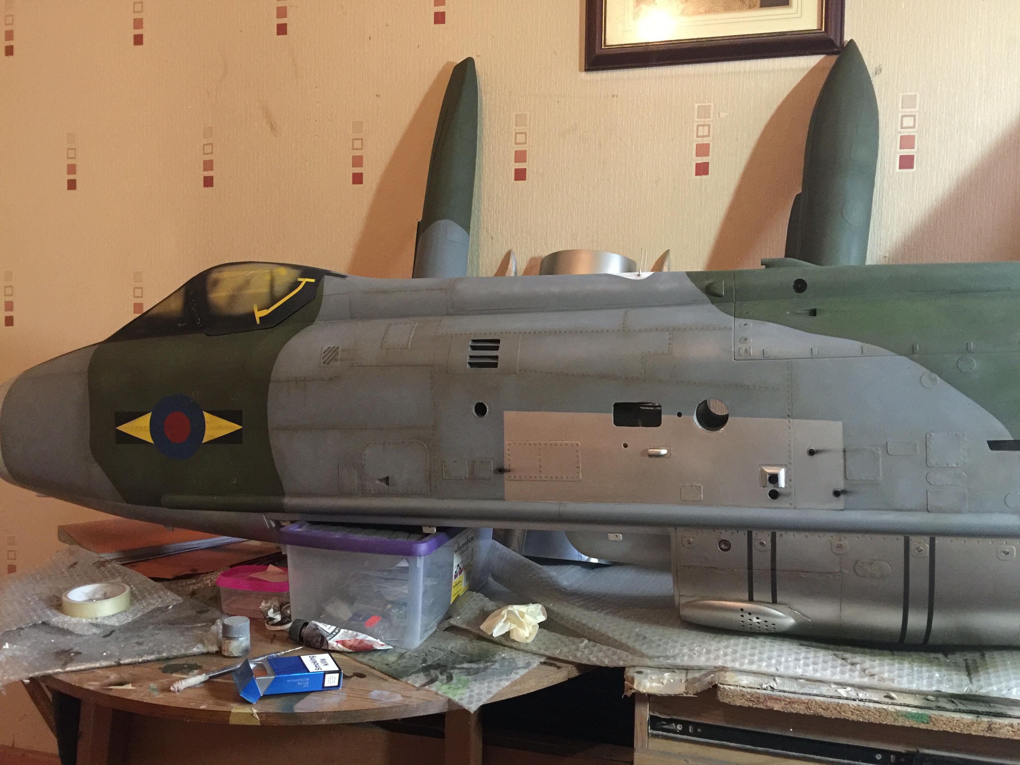

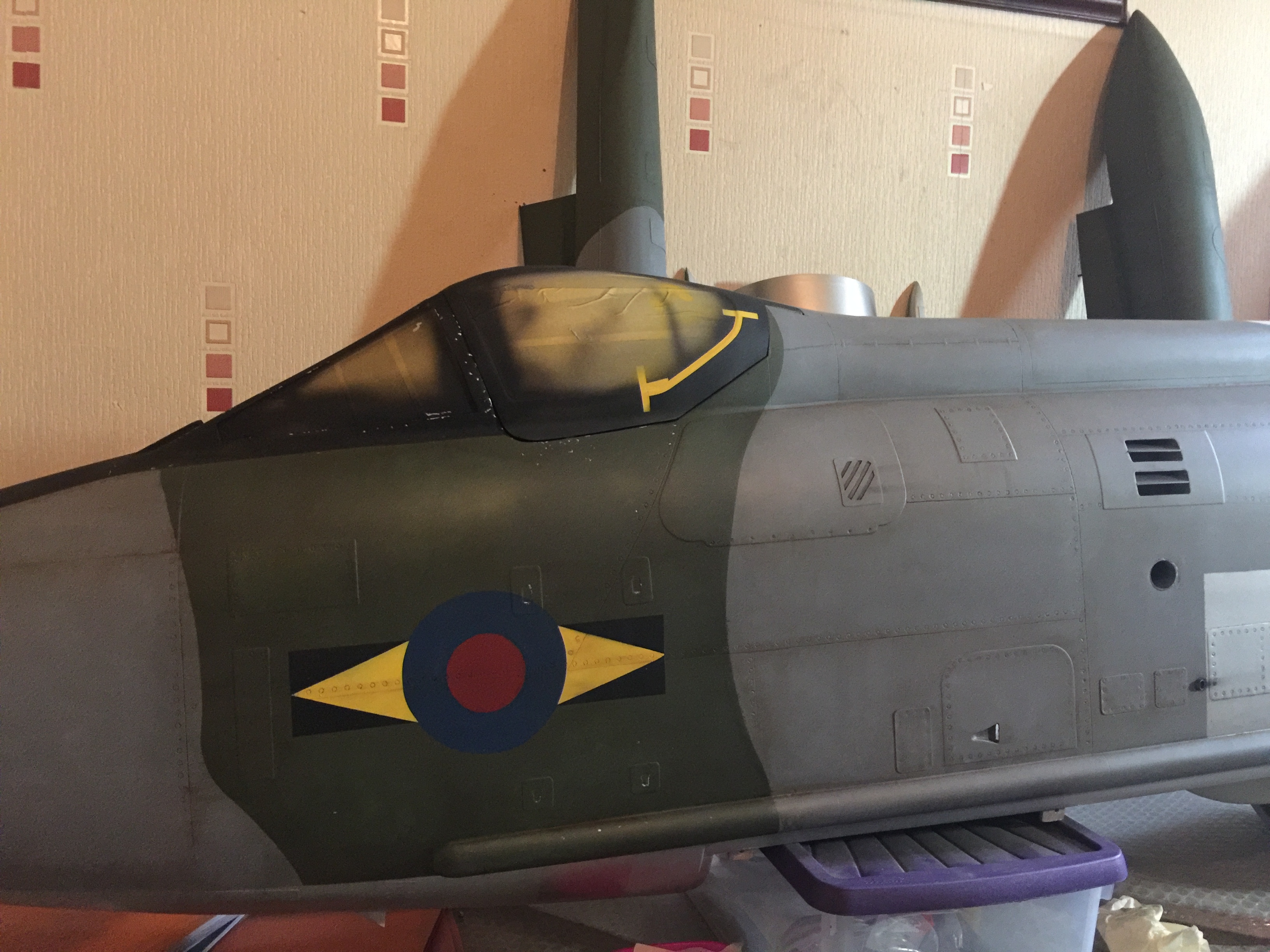

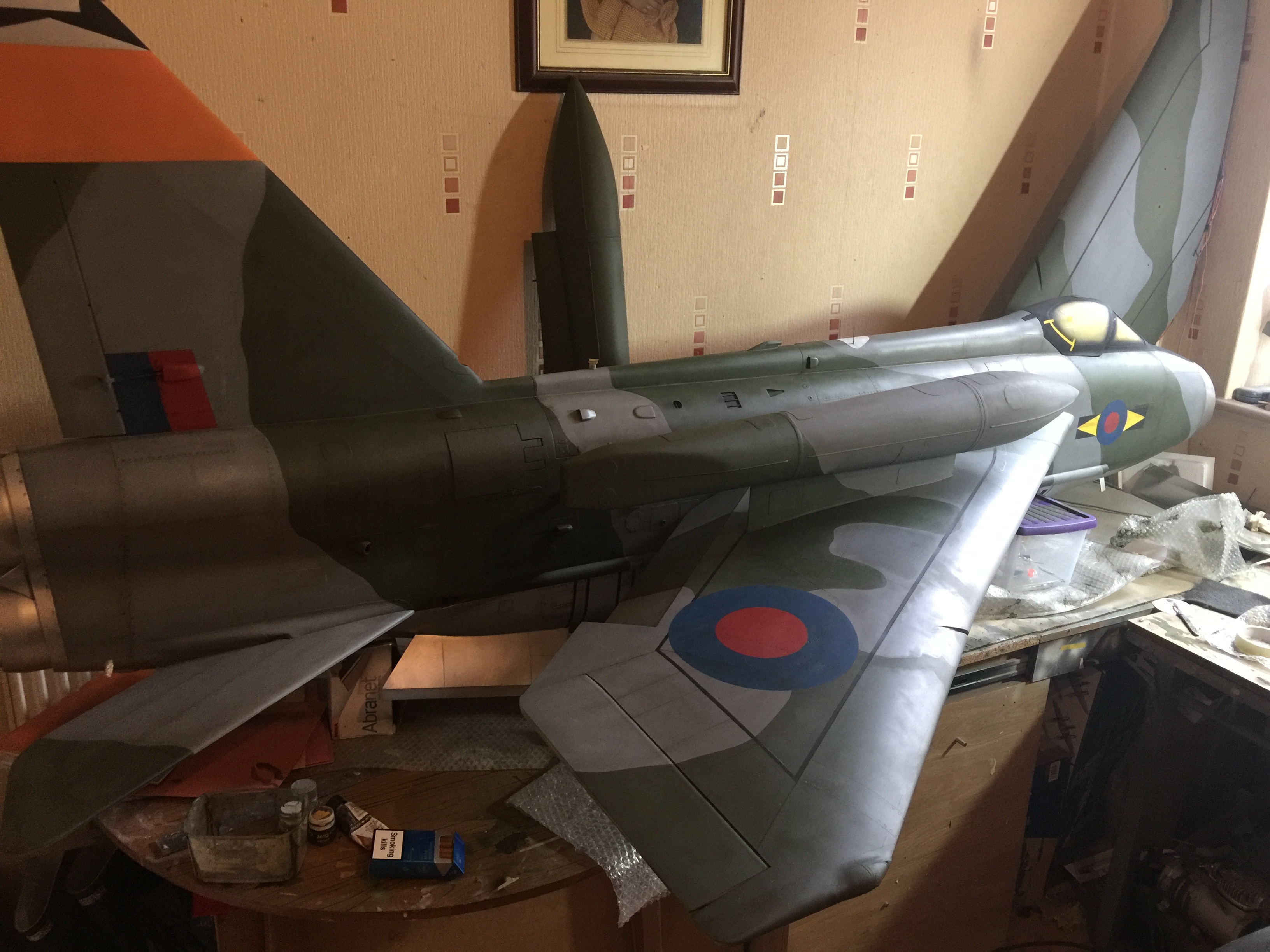

Painting more or less complete, have left intake bullet incase I have to drill a hole in it to add nose weight, anyway, final stretch now, need to finalise all electrics, install engines ( xmas ) and do a few small internal jobs , oh and just complete the gear leg doors when I get gear.
