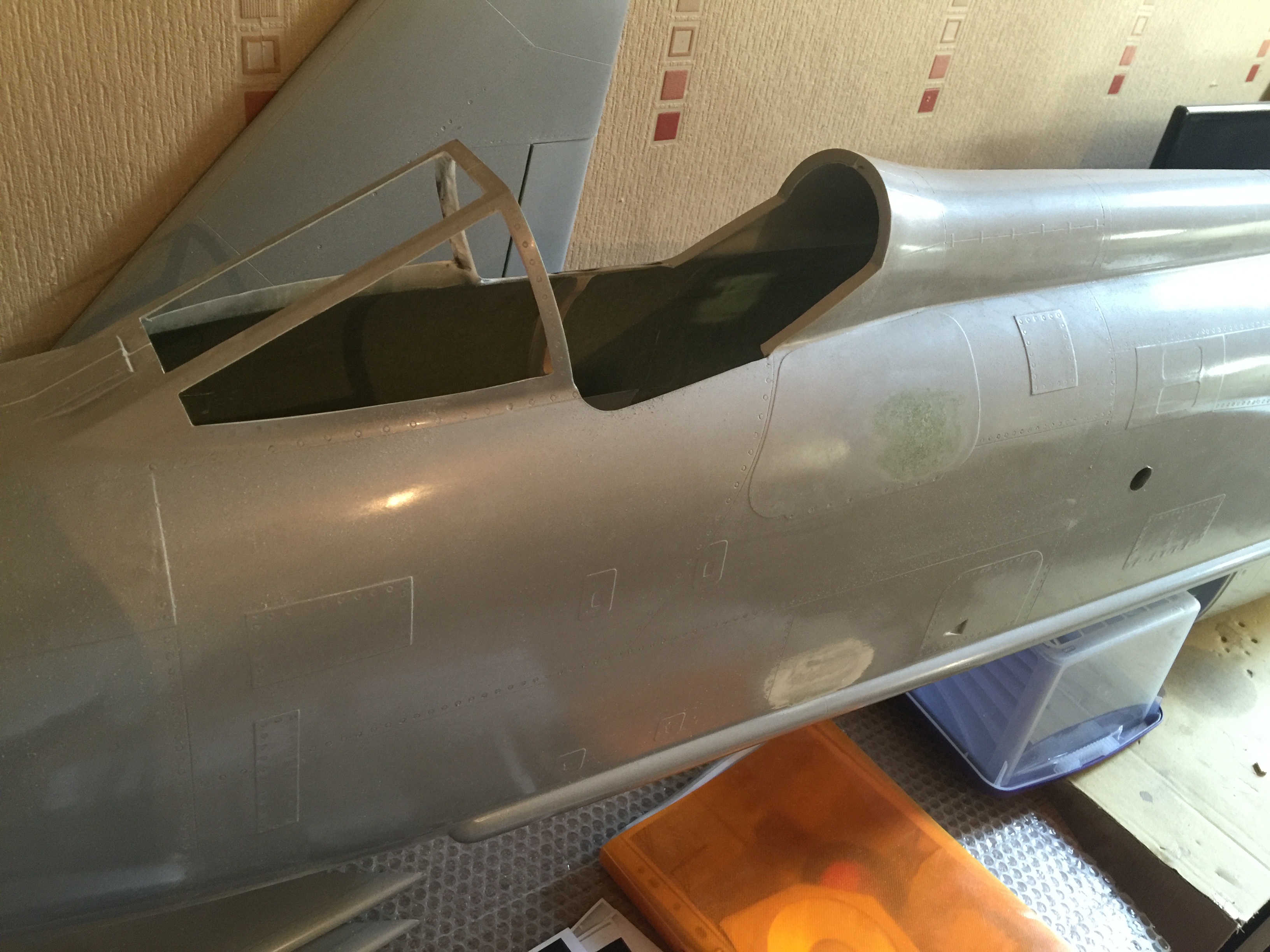

I realise that Airworld has done it for effect, but the Lightning does not have all those raised panels as they have done on their moulding. It was a Mach 2+ interceptor and was as smooth as possible.
Old 08-18-2016, 03:11 AM
GEEBEER3FLYER
Join Date: Apr 2015
Posts: 77
You are quite right, I've removed a few last night that are actually wrong and am skimming the edges down a little to avoid them looking 'stuck on'
I want them raised a tiny nit to help with painting/weathering but not the depth they have them, the wings are fine with engraved lines, its the fuselage only that suffers this and needs tweaking.

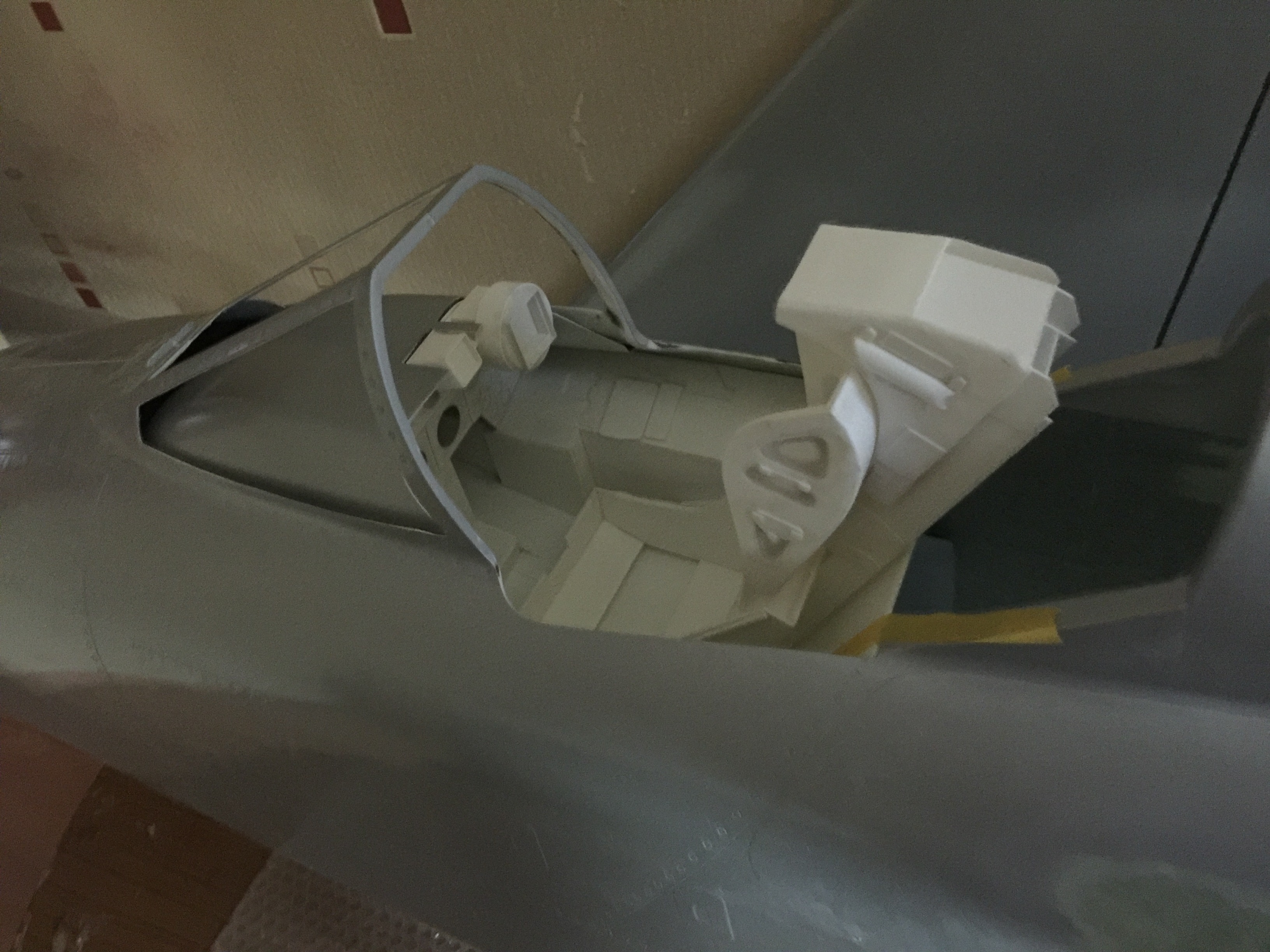

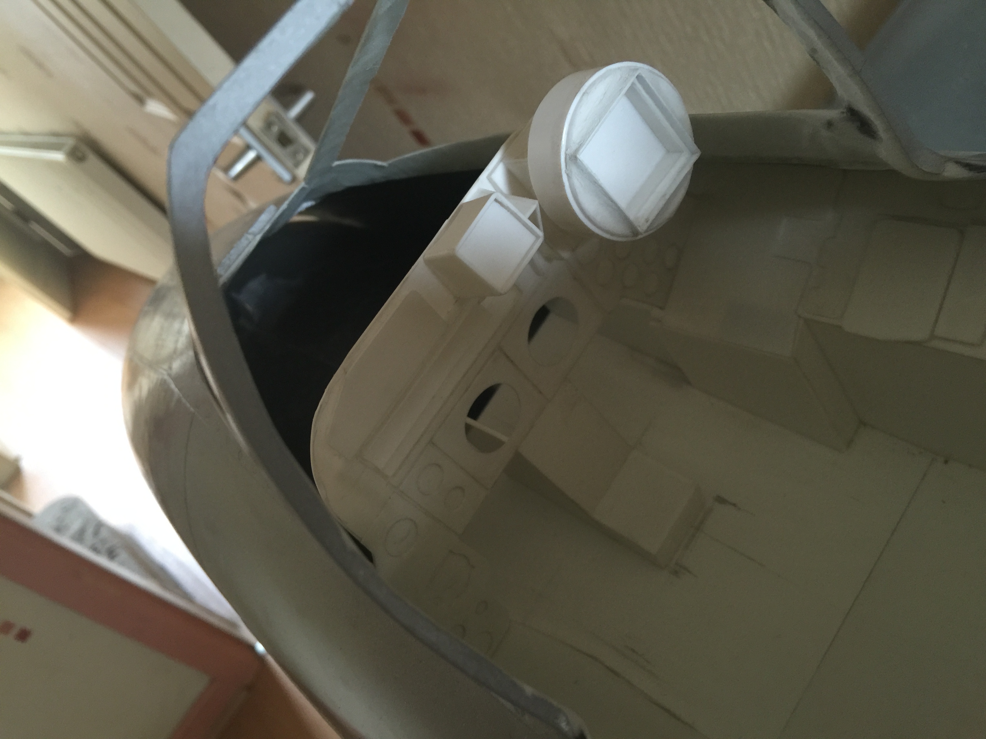

Old 08-18-2016, 09:21 AM
GEEBEER3FLYER
Join Date: Apr 2015
Posts: 77
As you can see. Trimmed out and thinned cockpit framing, removed some incorrect details on the skin and trimmed back intake in order to fit full depth cockpit, the intake will take a lot of work .

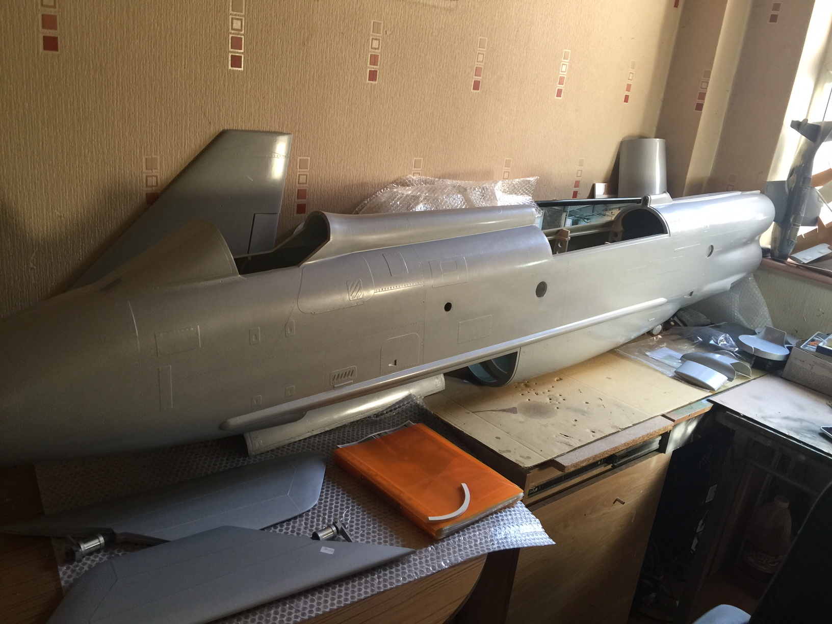

Old 08-18-2016, 11:57 AM
GEEBEER3FLYER
Join Date: Apr 2015
Posts: 77

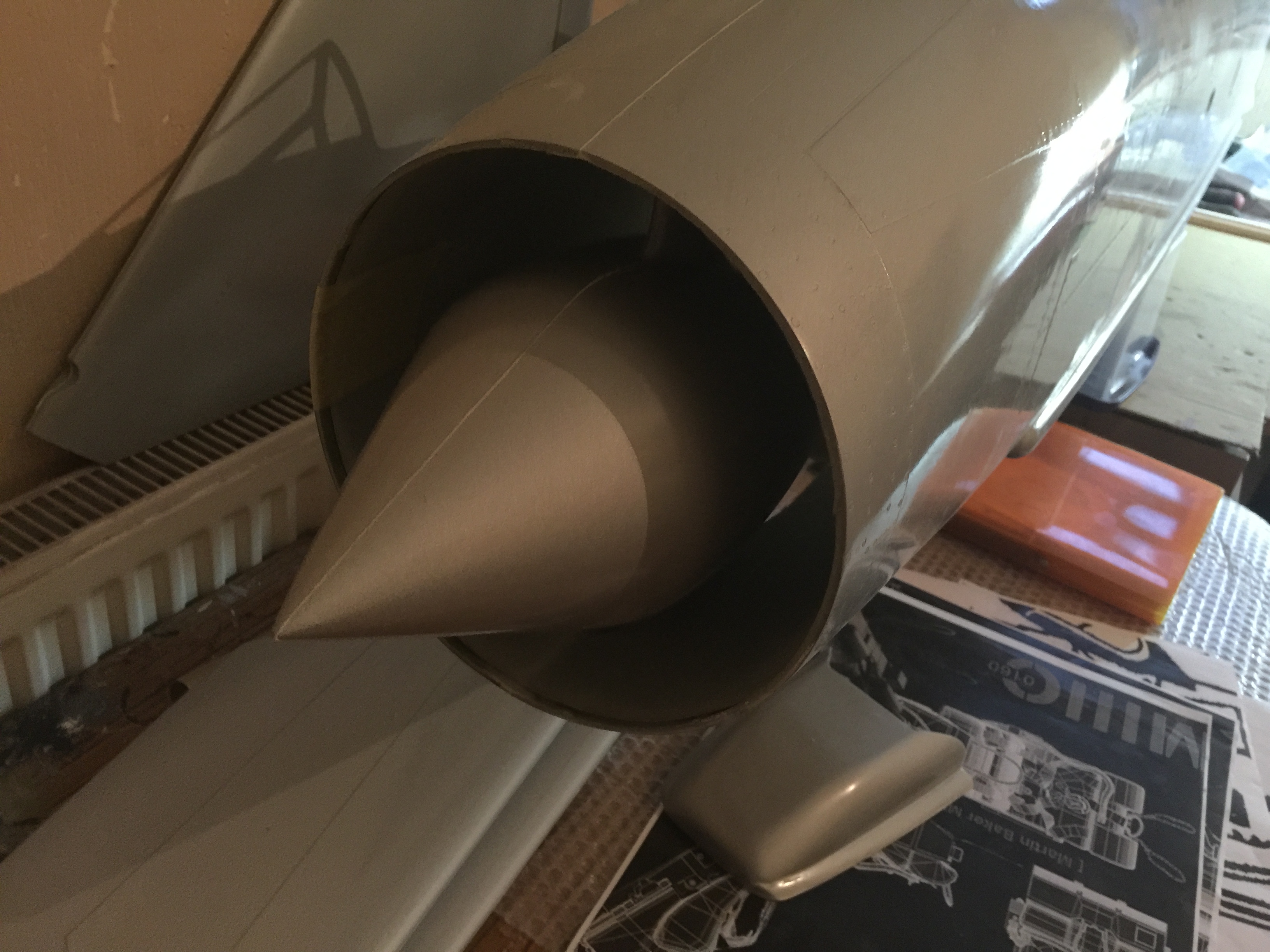

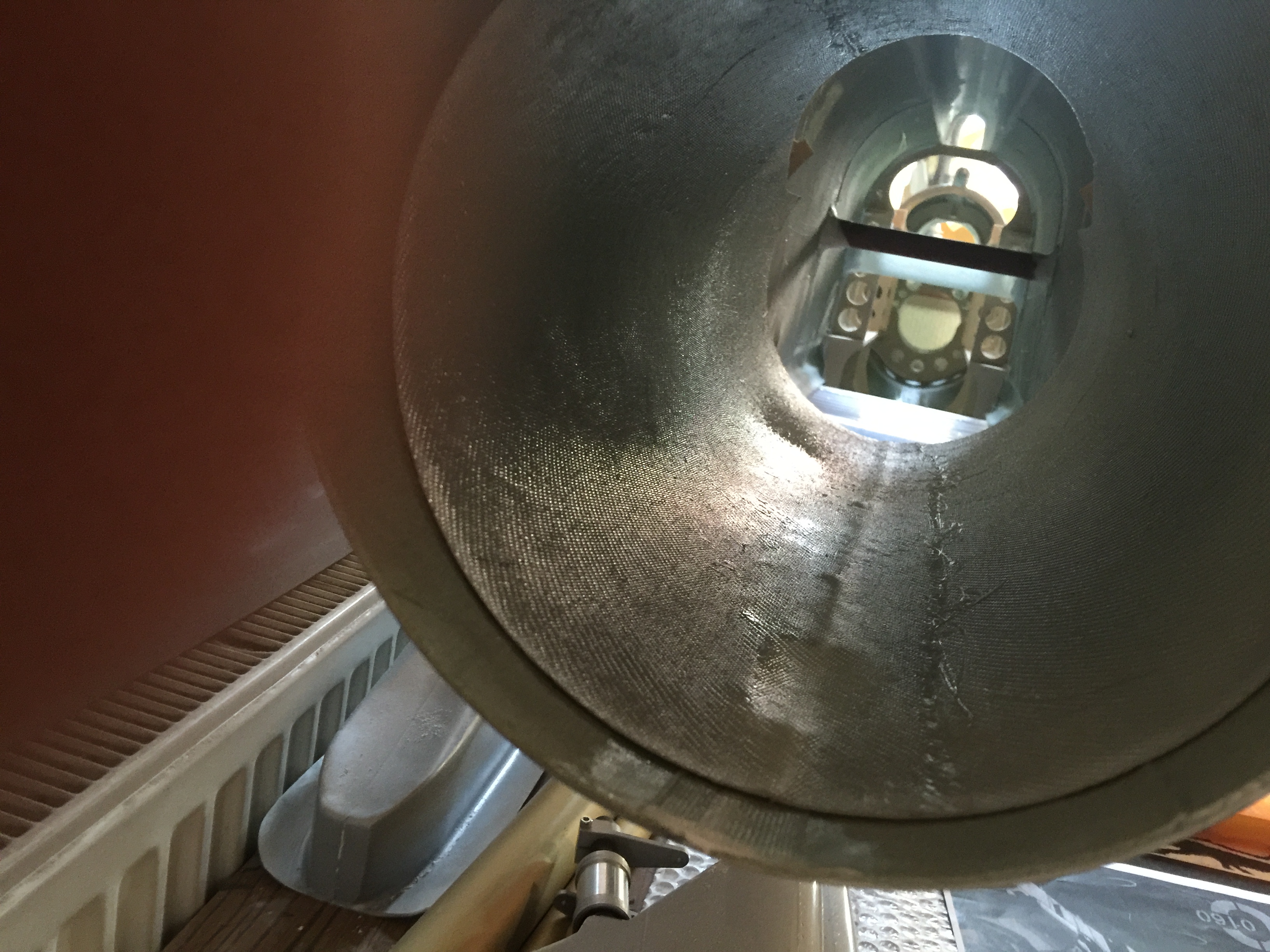

Looks a bit more like a lightning after a bit of dremeling around the intake bullet mount points, not convinced the length of the undercarriage bay is correct at the front , partly as on the real plane the gear is up in the back of the bullet fairing and partly cos they FORGIT TO INCLUDE THE BXXXXXY RETRACTS!!!
anyway, going well so far, btw the 'instructions' they supply on disc are as much use as a chocolate fire guard , my suspicions were aroused when I opened the first photo and it was a stunningly good shot .... Of a Buccaneer, then about 30 of the next 40 were T5 Lightning close ups or F1's 20 of the build shots were of the prototype in flight with the aircraft tiny as you would get on a normal camera, and most of the build shots were beauty shots of the finished model......as I alluded to before, the kit is a great blank canvas with huge potential but that's Inspite of Airworld, not because of them

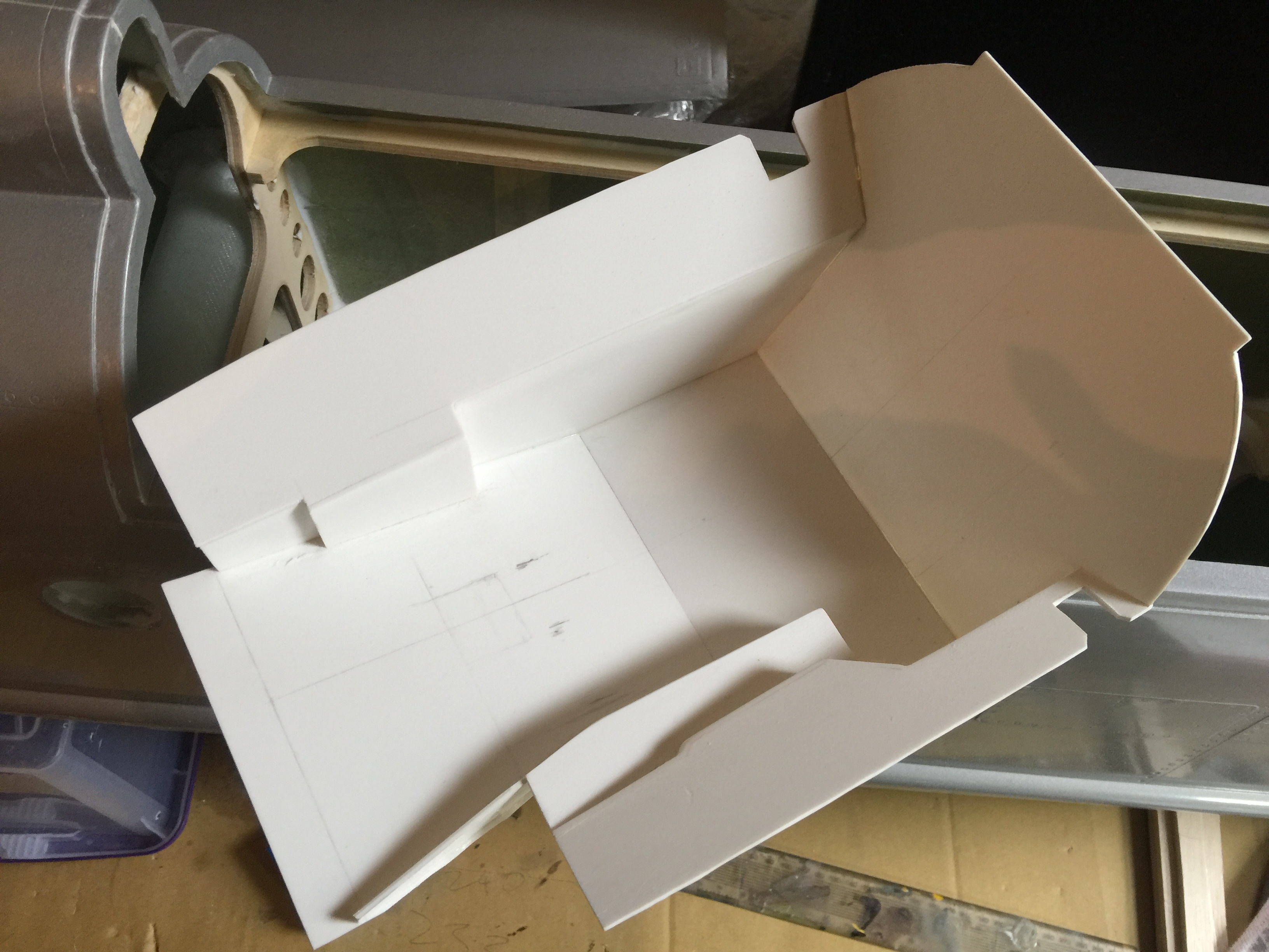

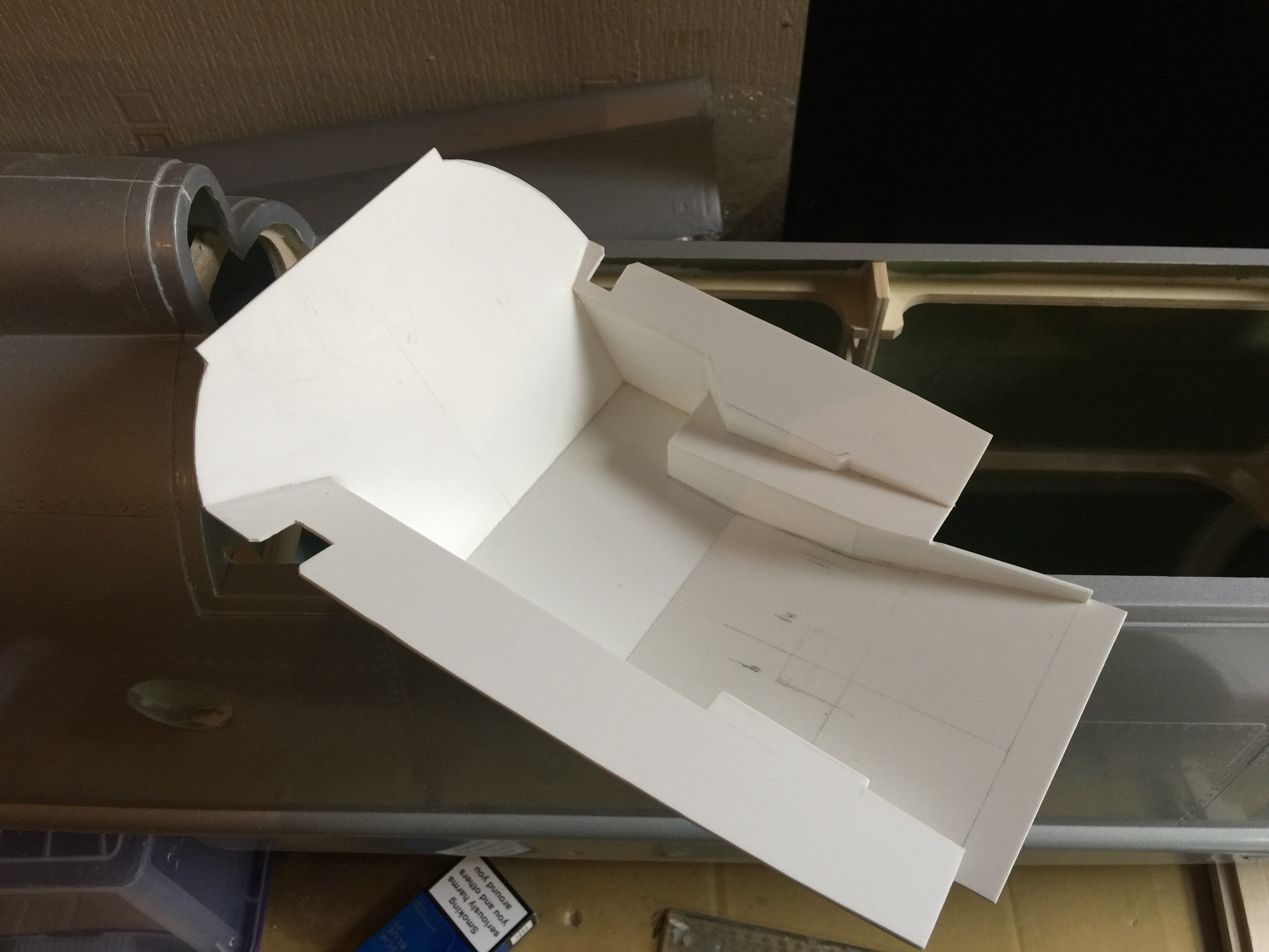

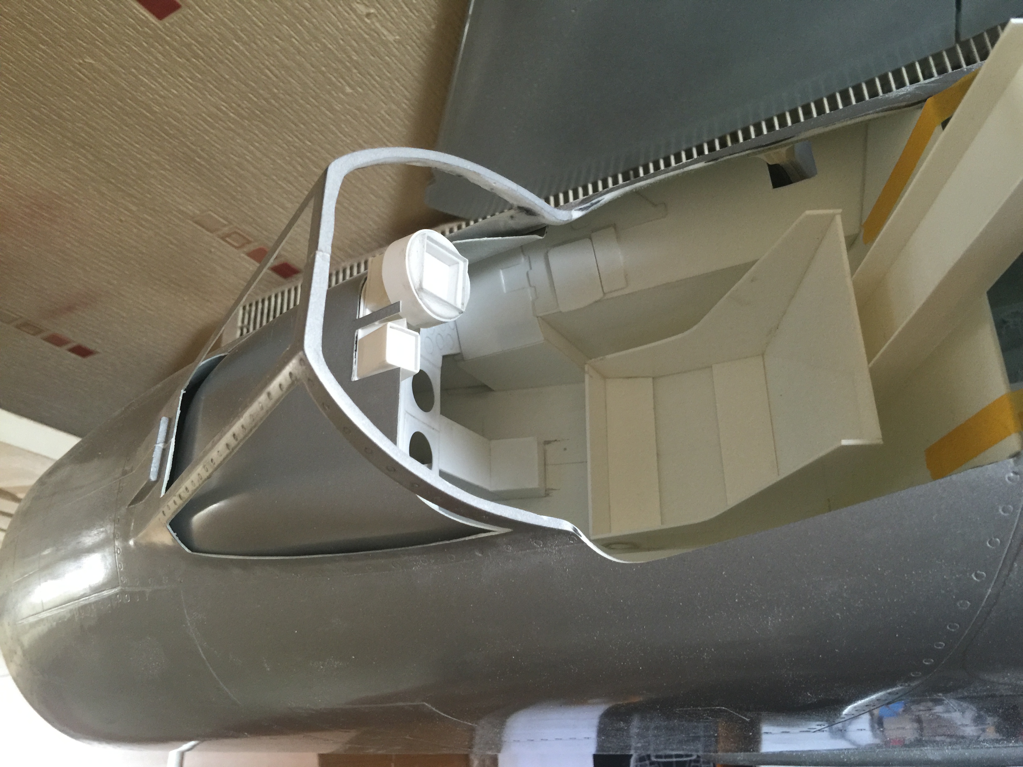

Scratchbuilding begins, it's taken a few hrs and a lot of offering up and checking to ensure this base assembly fits well and accurately, the former airworld have added don't make life easy but it will be hidden due to features in the cockpit, it's a very strange shape the Lightning cockpit tub, took a lot of reference to get it right

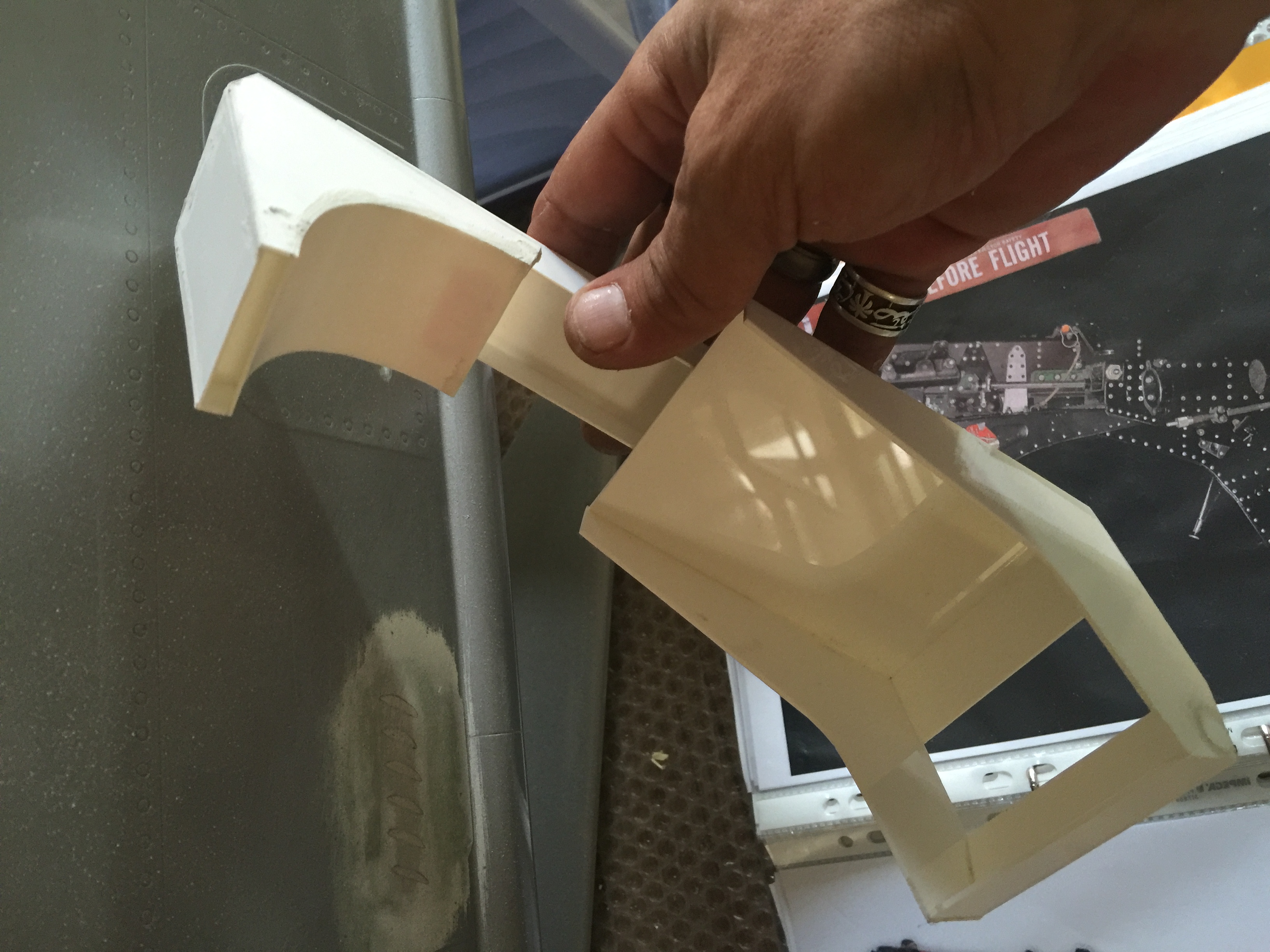

Little more work done today on basic shapes, few tweaks as I go along to ensure everything is as accurate as possible

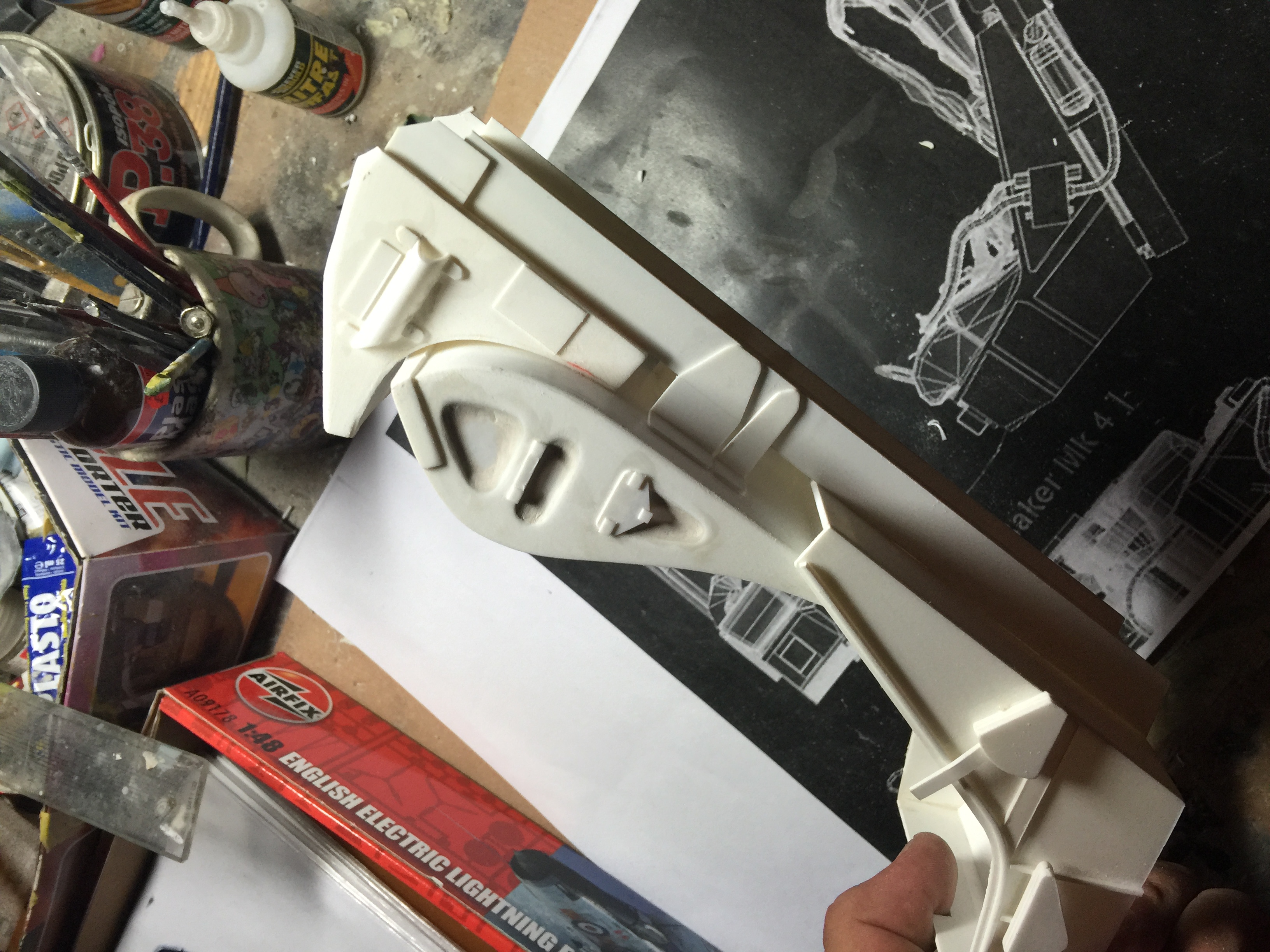

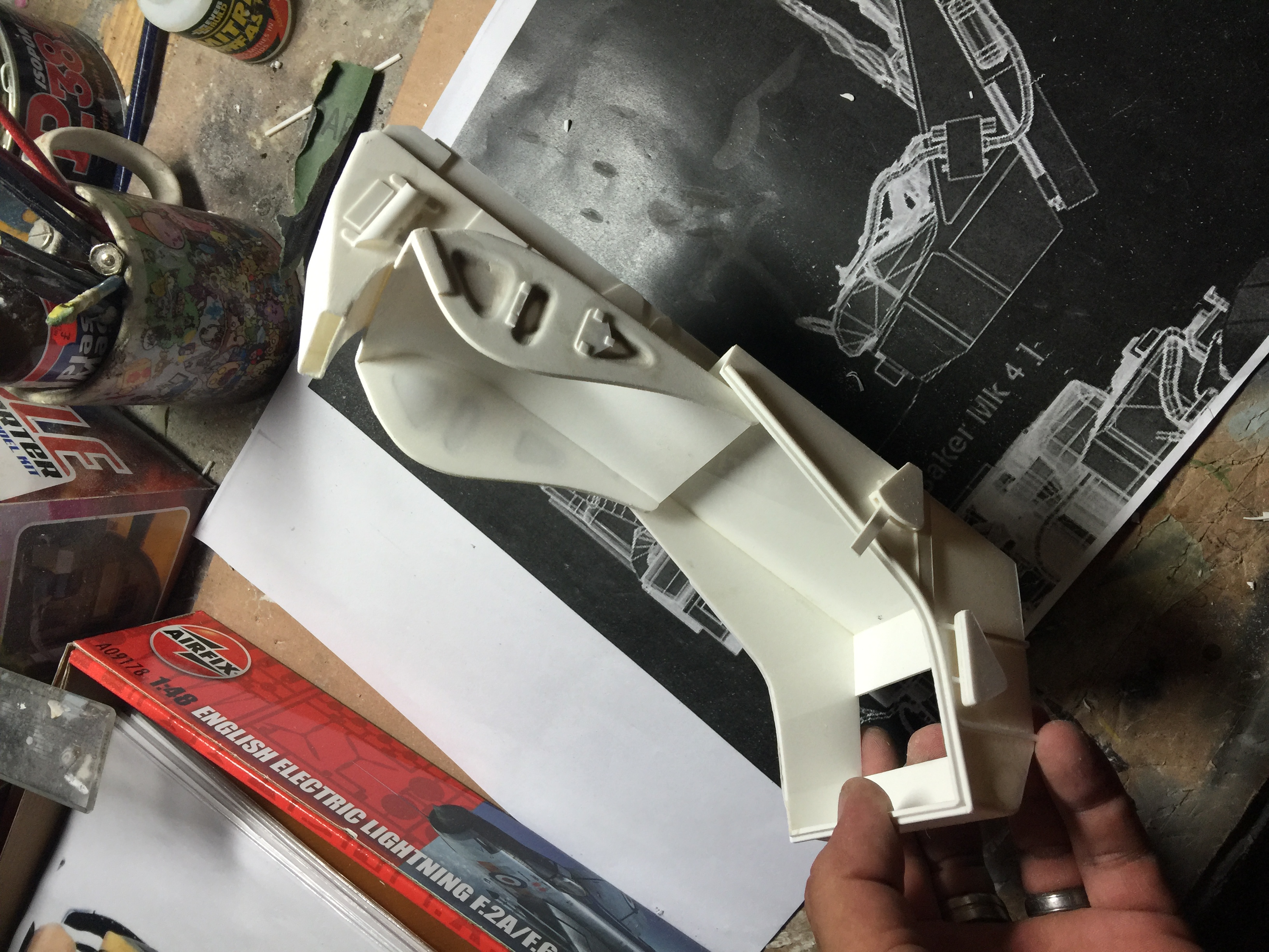

Join Date: Apr 2015
Posts: 77
Work progresses on getting cockpit shapes right and detailing as best as I can from references long long way to go on seat yet but basic block shapes are there more or less

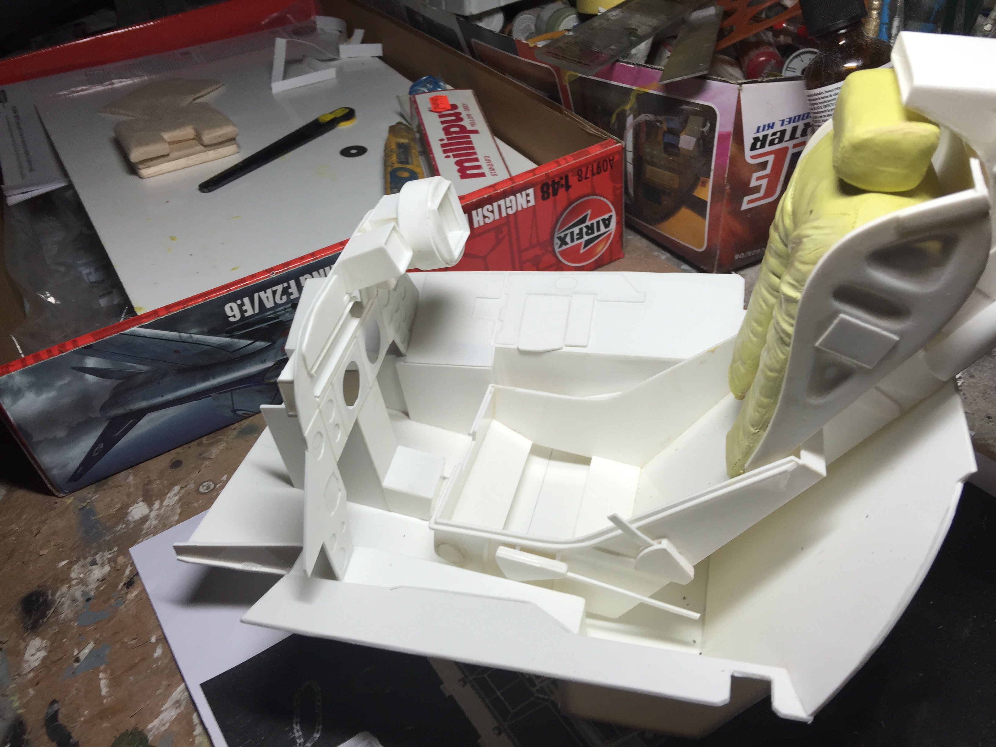

Old 08-23-2016, 12:36 PM
GEEBEER3FLYER
Join Date: Apr 2015
Posts: 77

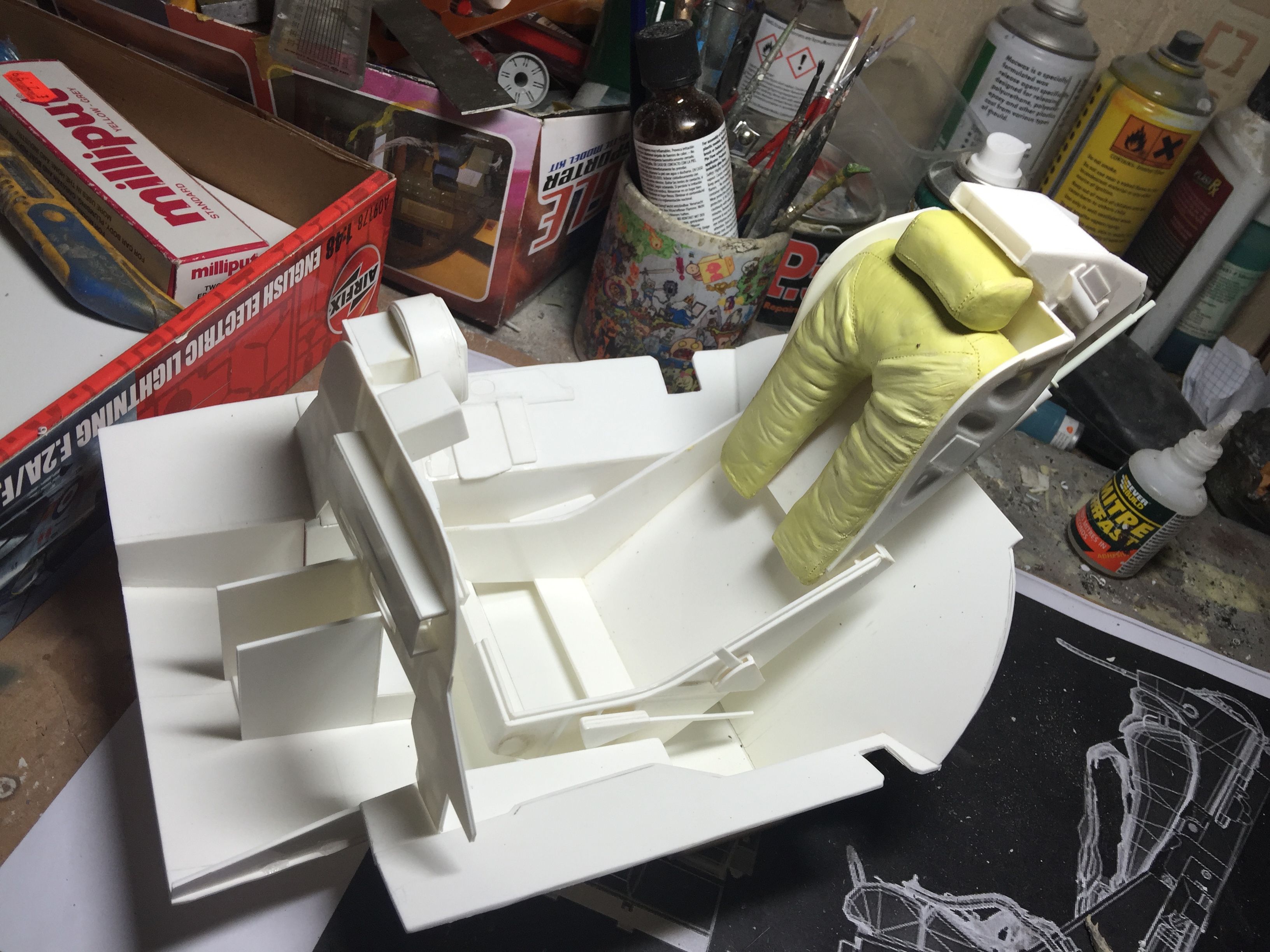

There's belts to go over the seat cushions I have done and more cushions to add, aswell as a pilot but what's there should look ok when finished with a pilot sat in it, it's hollow balsa about1/8 thick with a millimetre of milliput sculpted over it
