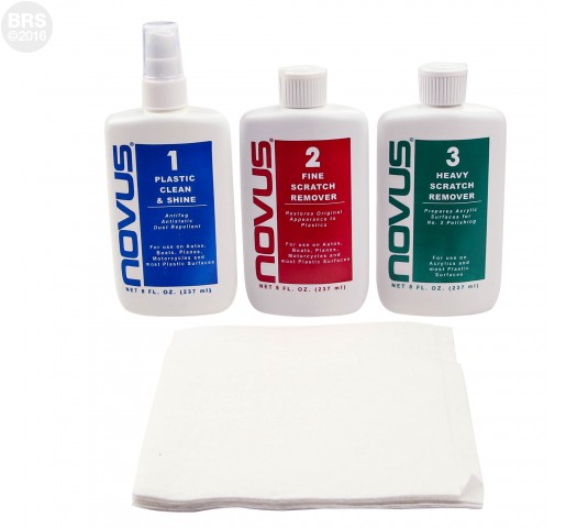

I got some debonder for CA glues on my clear plastic canopy. As you might expect it left an area of very clouded plastic. Canopys for this older discontinued airframe are hard to come by. If possible I would like to restore this one if possible. Thanks

There is a three step plastic cleaner that will fix your canopy, you can get it at chef aircraft.

I assume you have used it with good results ?

Yes I have restored canopies that got beat up from gluing canopy frams with CA.
Best stuff for buffing out scratches, CA burn and overall dullness.
TB

Just to be clear. The debonder attacked the plasitc somewhat and that is why it got cloudy. With this in mind I will certainly try that product if you are still pretty sure it will work for my situation. It sounds like a good product to have around as I have a couple canopies that just dont look like they did when new. They could use a little pick me up so to speak.

It won't fix melted plastic or cracked plastic but if anything can bring a canopy back from the dead this stuff can and if you have any planes with clear canopies then this stuff should be in your box.

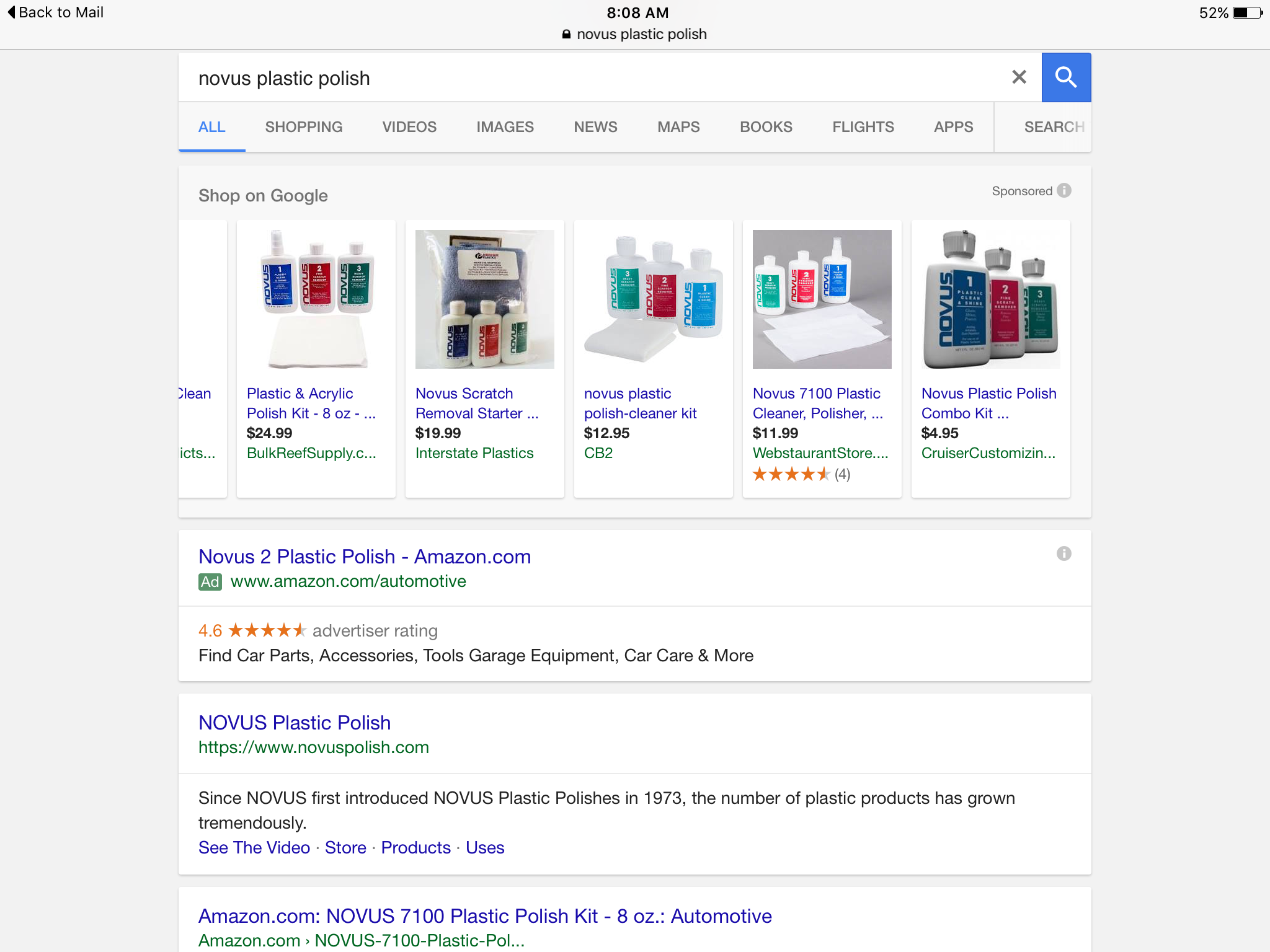

Can you please provide the link to the exact product on their website? I got lost looking for it, they have so many different products. Thanks. I recently damaged a canopy CA debonder that is no longer available also.

I found it almost instantly on Amazon. Just typed "NOVUS" in the search window. Placed my order and will have it by Wed..

Google it!

For removing the dulling from the CA debonder, would you need more than Novus part 1, "Clean and Shine"? I don't have any scratches to fix.
You probably would. The CA debonder, like the DEET, I think, melted the surface of the plastic. You need to remove that material with a more abrasive solution and then polish out the scratches that the abrasive leaves behind.
For deep scaring on canopies (and my car headlights) I have used 1000 and then 2000 grit wet sanding followed by the "Novis" type progressive system shown above...
Same technique as for removing scratches in automotive-type paint finishes - wet sand and then polish, polish, polish...
Bob

Part one is just a cleaner like windex but plastic safe, part 2 and 3 do all the work. Part 1 will finish it of and give it that shine.

I got my Novus kit today. I took a scrap peice of canopy and purposely put some debonder on part of it. I was able to get it looking better but certainly not to an acceptable level of appearance. Next I will try to sand as you mentioned. I take it you were able to get a fully restored look with sanding followed by Novus without the need for a clear coat paint application. I would like to avoid the clear coat if I can.
