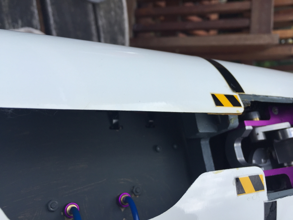

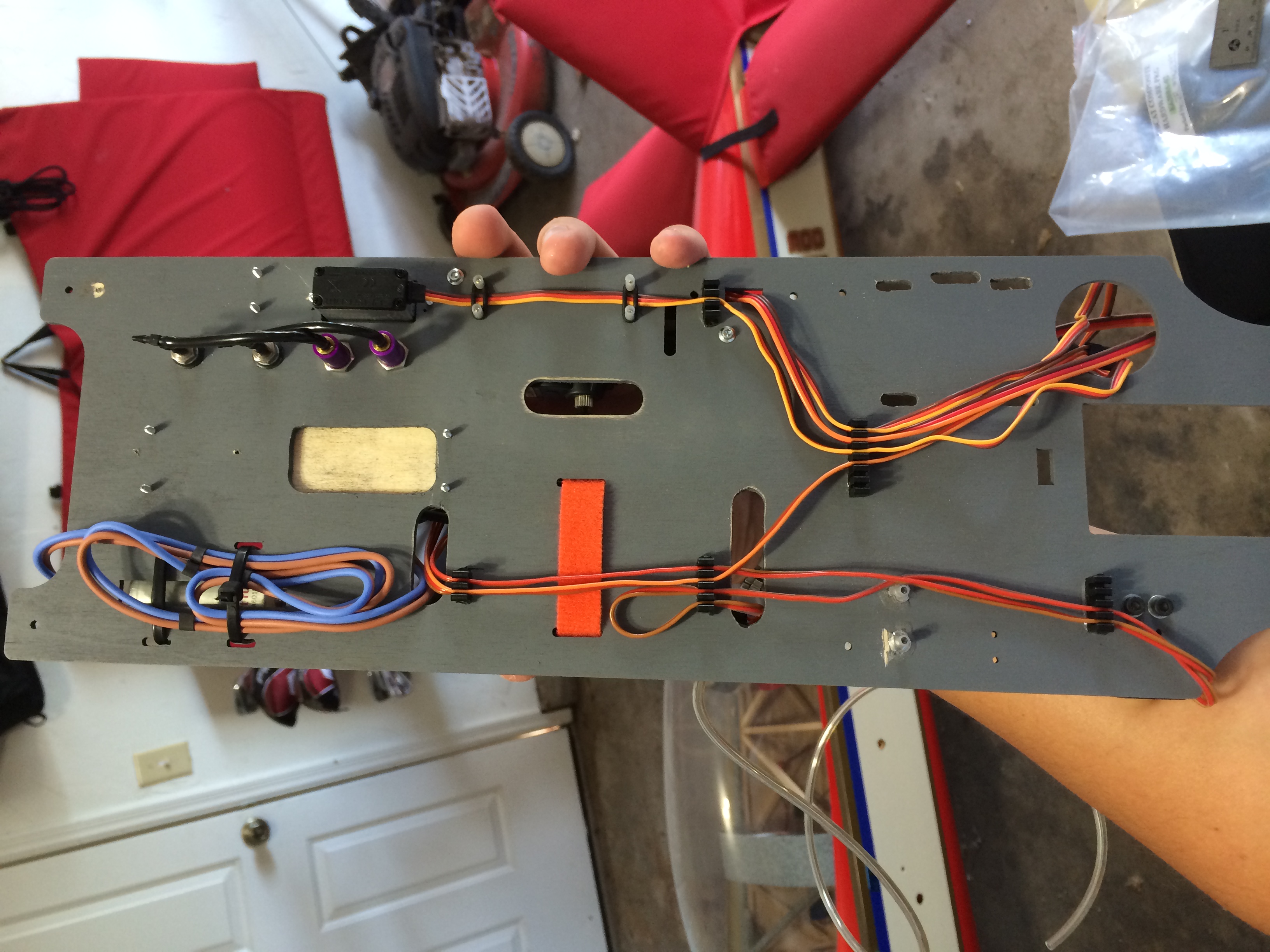

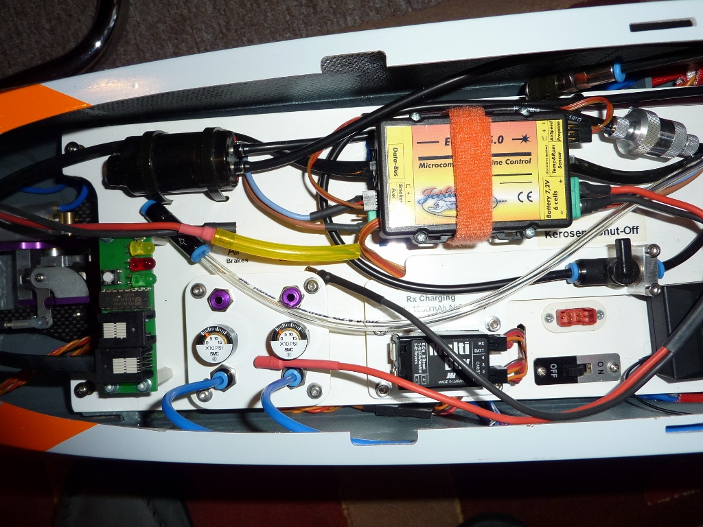

Hey guys,
Does anybody have any install photos for their composite Bobcat?

Here we go:-

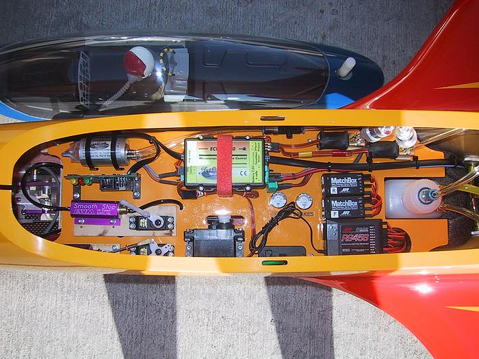

Thank you very much.. Anybody have a picture using smooth stop, and retract valve?

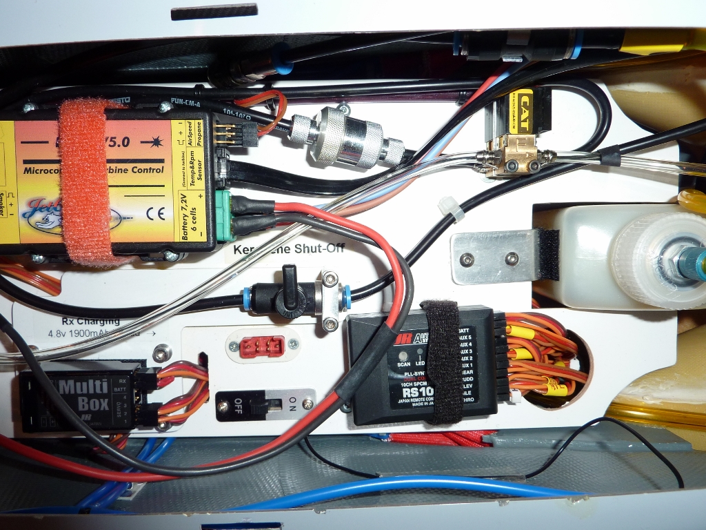

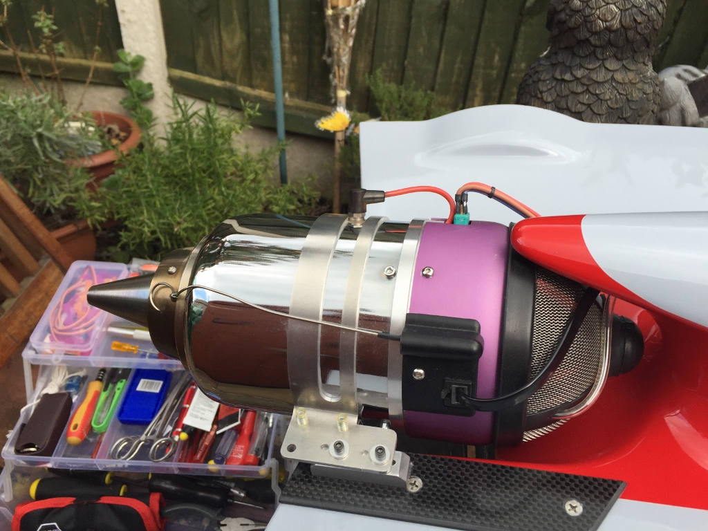

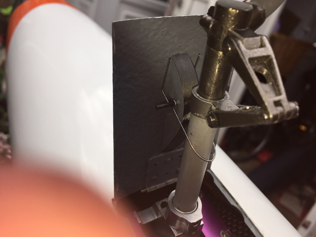

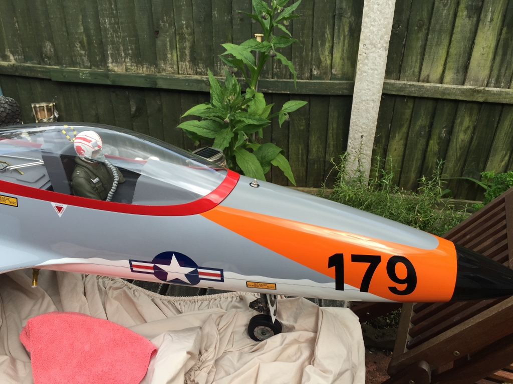

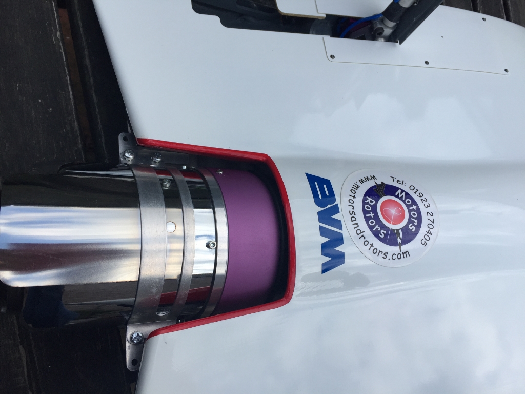

here is a few more

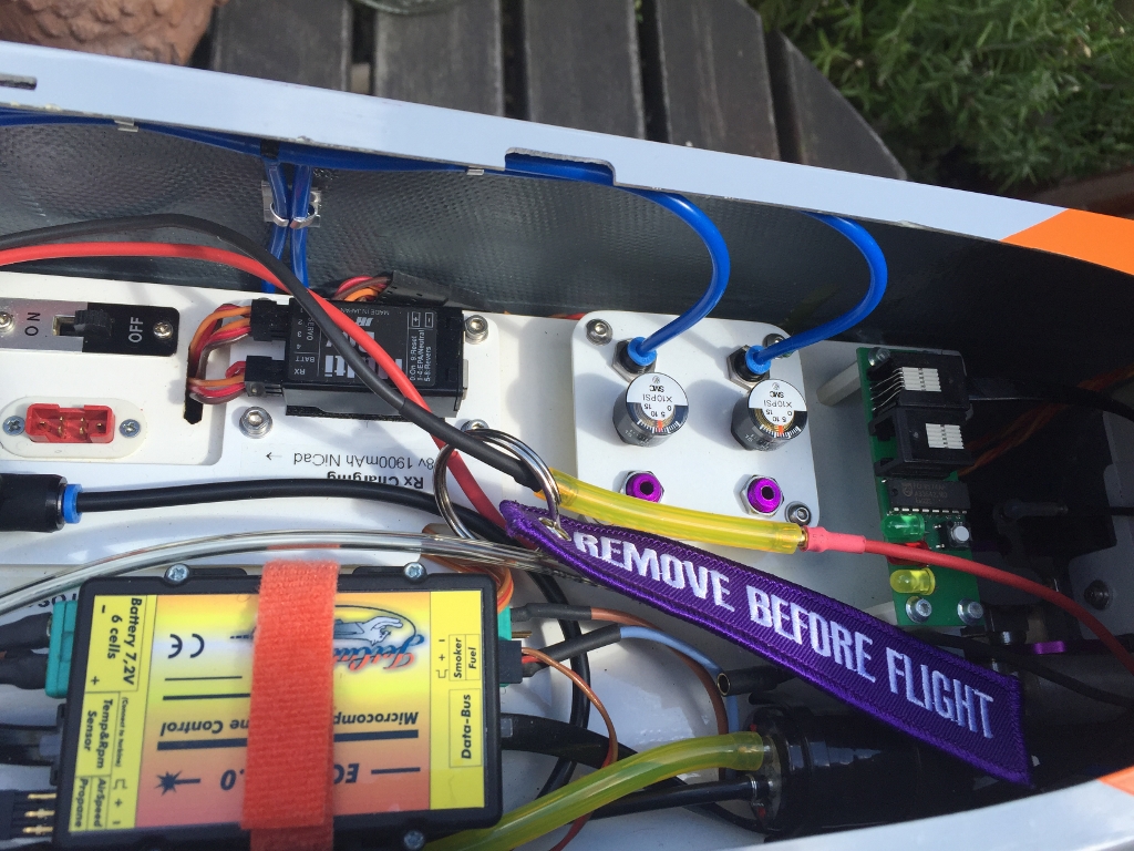

Old 10-18-2016 | 02:05 PM
Joined: Aug 2010
Posts: 29
From: birmingham, UNITED KINGDOM

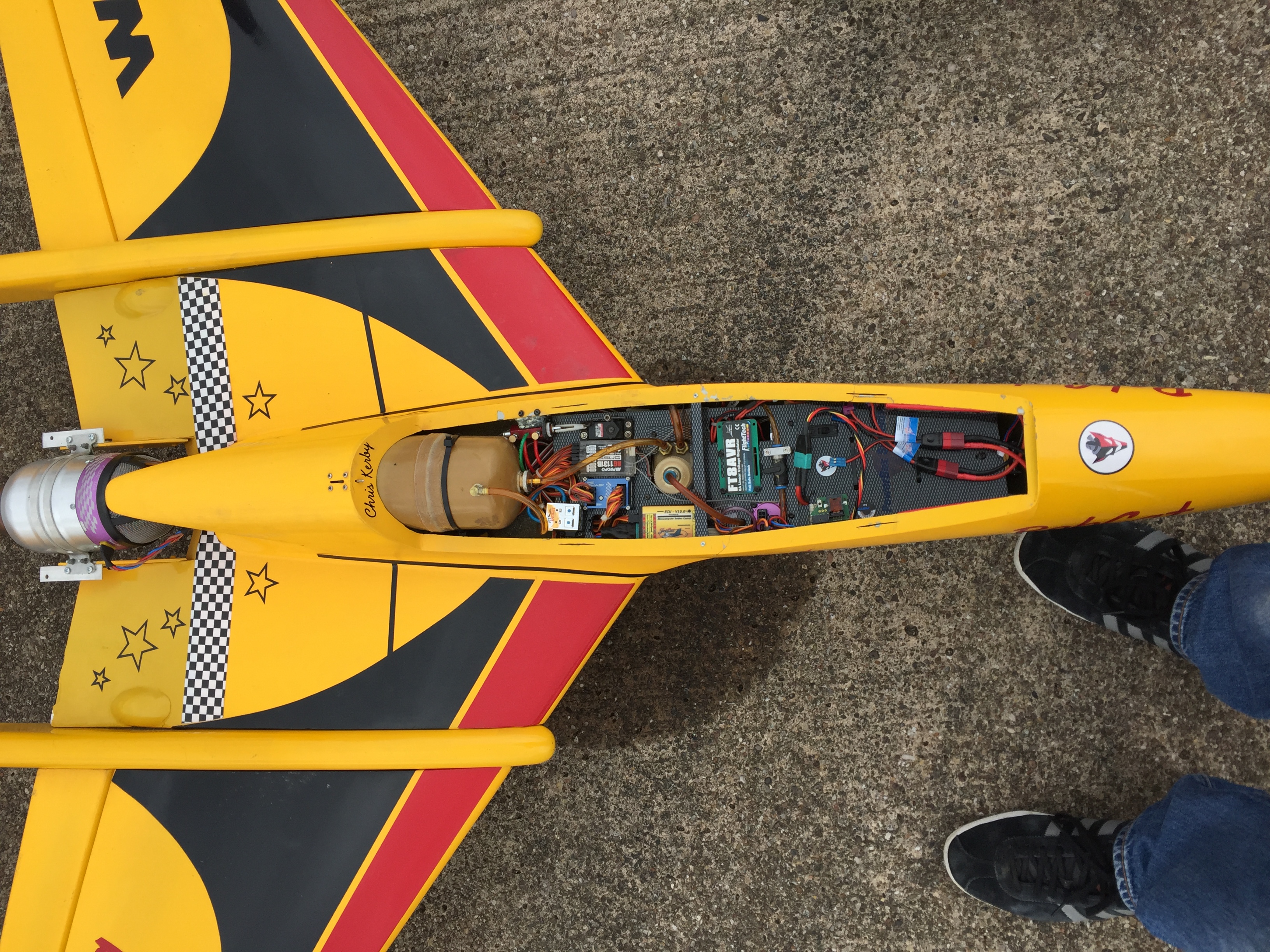

Default XL

Do you have the cockpit with pilot on yours? If no, consider making two levels of equipment trays. Could make things a lot less crowded. I'm redoing mine now after 150+flights. Going to make some sub trays to hold stuff with a larger tray on top for the rest.
Old 10-19-2016 | 01:19 PM
RJE's Avatar
RJE
My Feedback: (13)
Posts: 186
From: Chico, CA,
Unfortunately I am using the cockpit with a pilot.. Seems to be getting a little heavy. Stacking does seem like a good idea. If you have some pictures I'd really appreciate it. Using a 12120, smooth stop, BVM retract valve, 2 air fill valves, 2 pressure gauges, 2 solinoids, Etc.

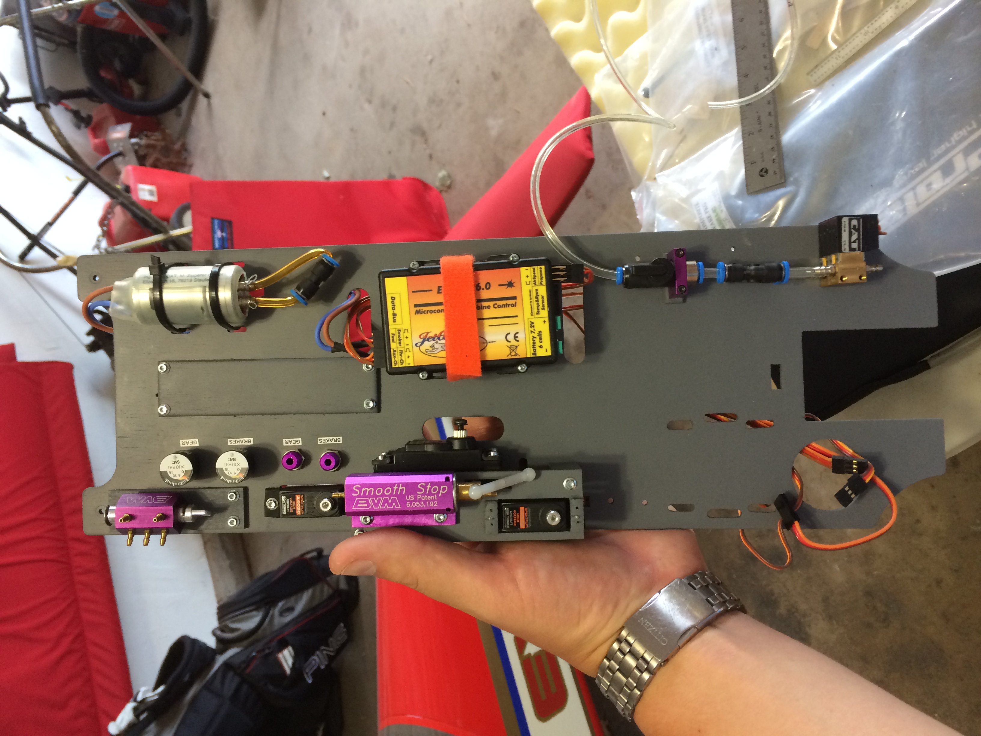

Old 10-20-2016 | 05:33 AM
My Feedback: (80)
Joined: May 2005
Posts: 248
From: Norman, OK

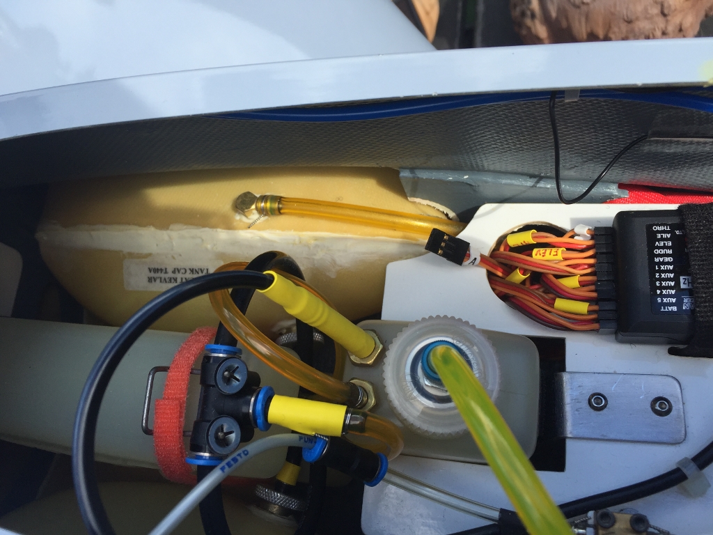

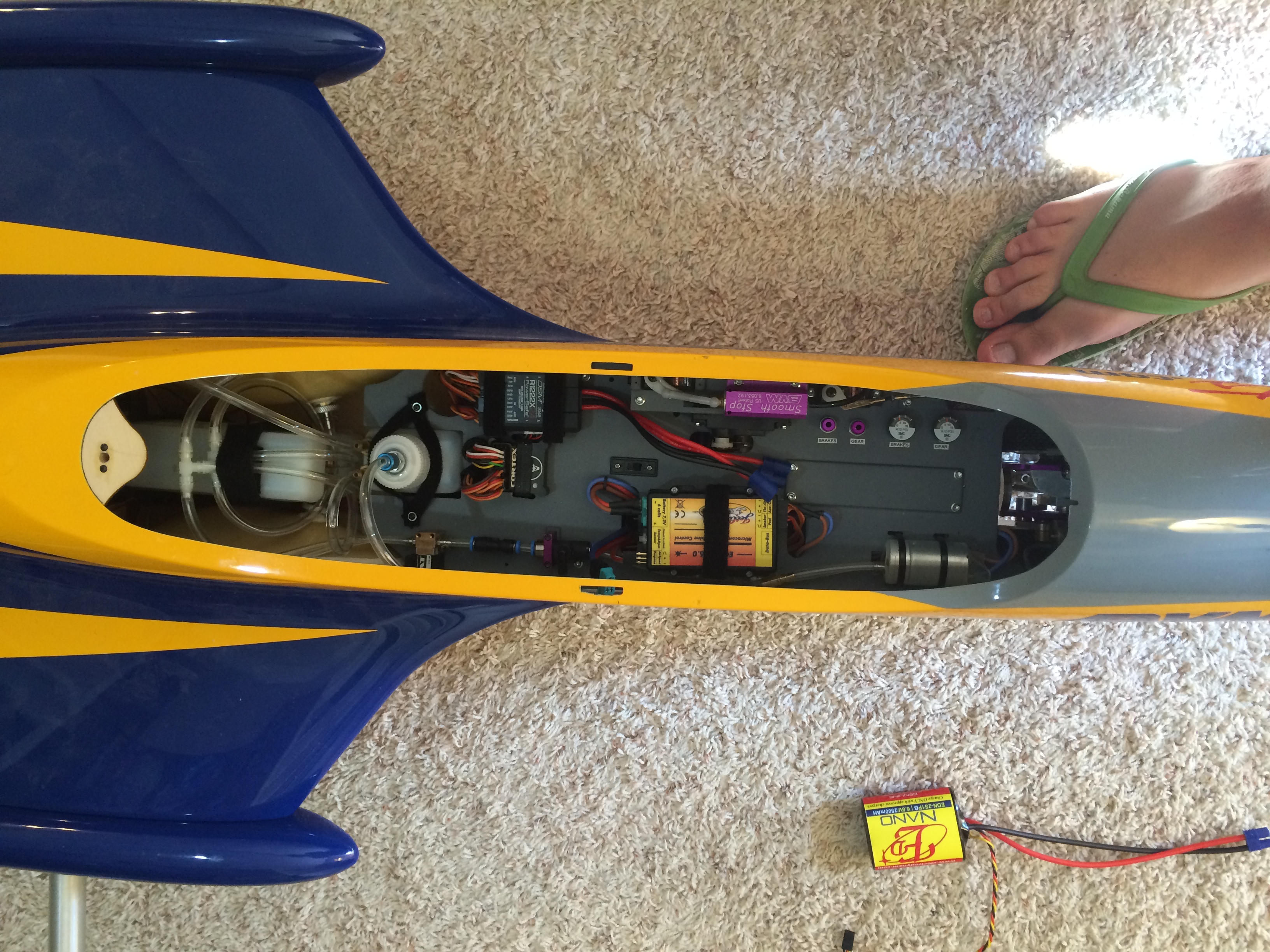

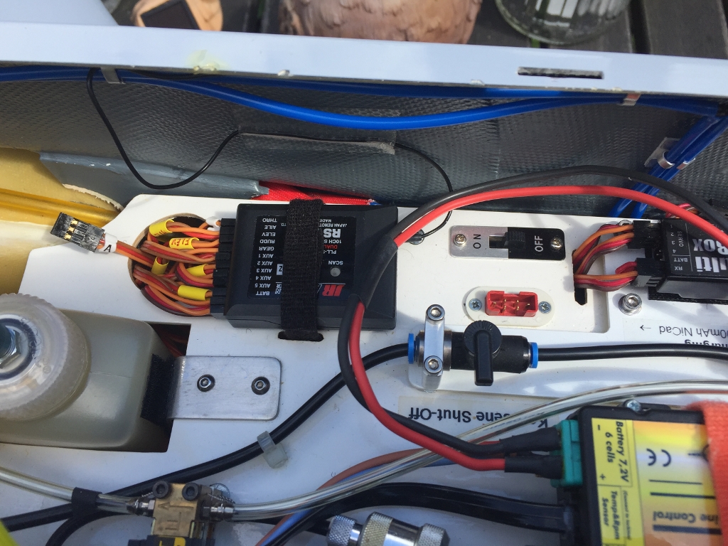

Here's a pic of an install I did a couple years ago

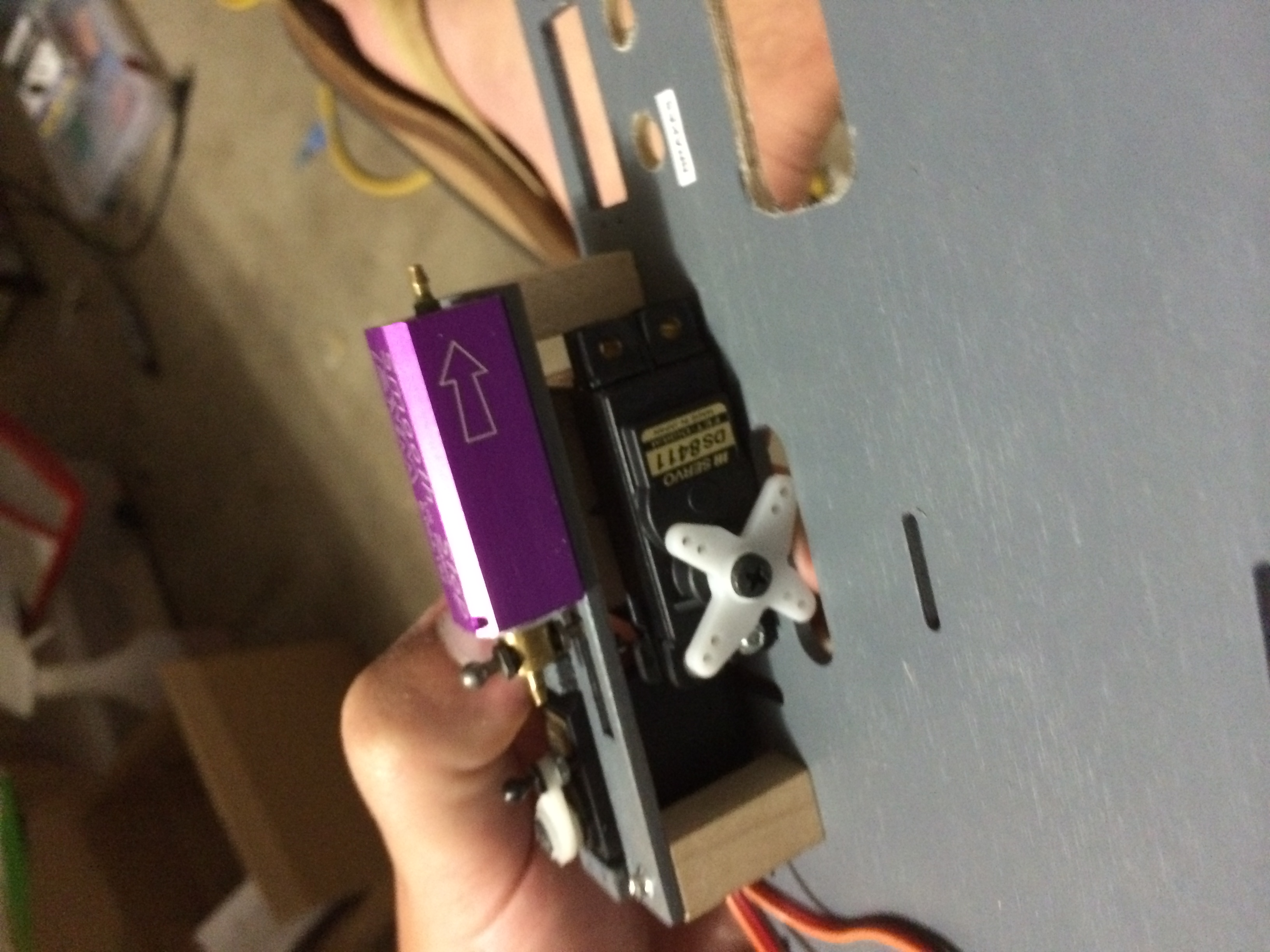

Old 10-20-2016 | 05:43 AM
My Feedback: (80)
Joined: May 2005
Posts: 248
From: Norman, OK
That bobcat was setup with the pilot and clear canopy. The 2 solenoids are stacked on top of each other with a festo Y fitting feeding them. The smooth stop is mounted on two short standoffs that allow it to sit above the nose wheel steering servo. Everything is accessible on that setup and easy to maintain. I had a P-80SE on it. That plane flew sweet. I regret selling it and plan on building another soon hopefully.
