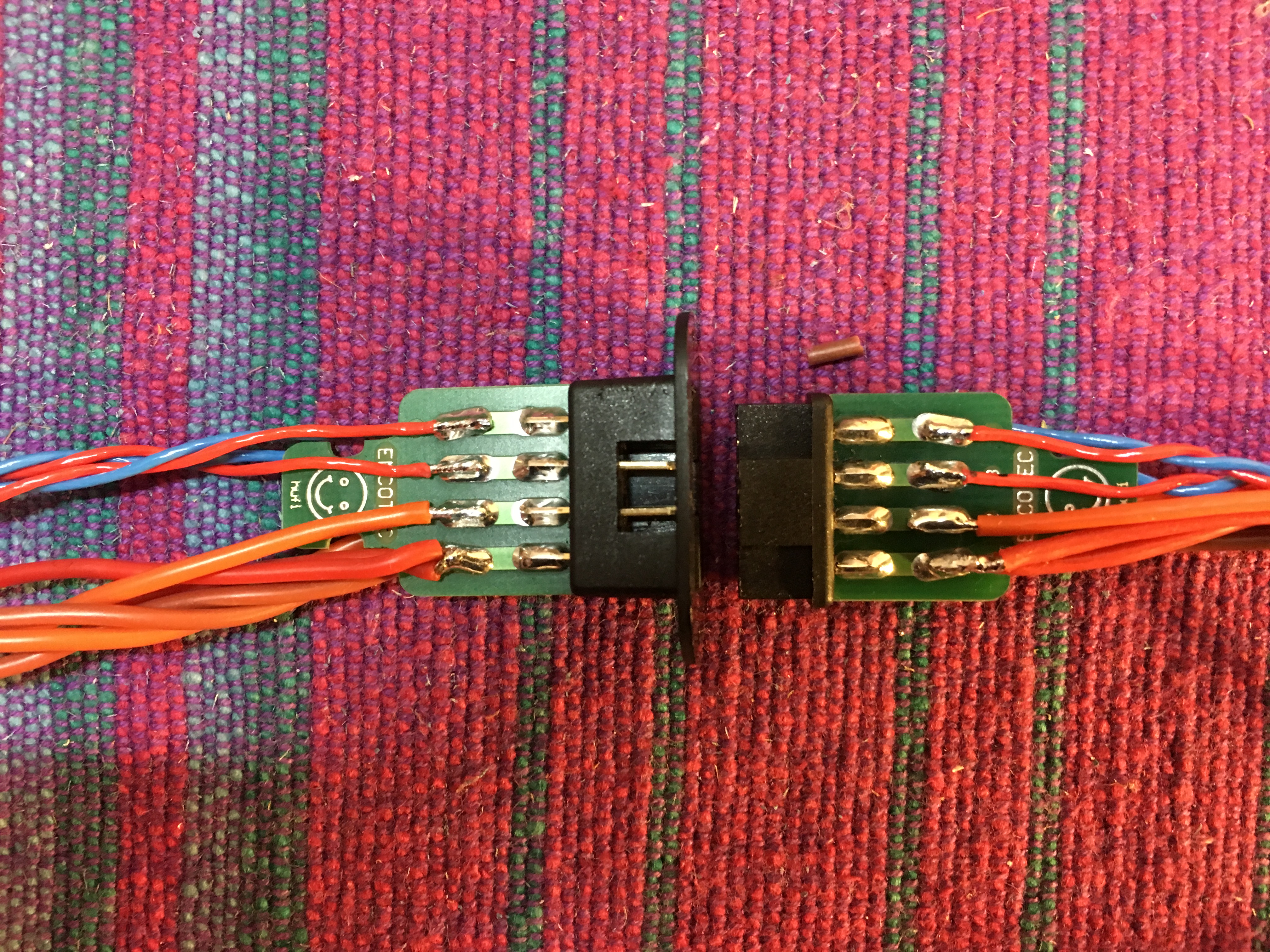

Hi Guys,
Got these 8 pin connectors from emcotec for my rebel pro, so I can have ailerons, flaps, gear and brake on one connection.
Maybe I understood the Emcotec guy wrong or am I doing something wrong.
The + of ailerons and flaps are joined together on one pin and the - of ailerons and flap are joined together on another pin. The signal wire of both are on 2 separate pins.
The + - of gear and brakes are simple.
The problem is when I hook up everything the ailerons and flaps seem to work fine for around 15-20 min then the servos start to gitter.
wires are all new and heavy gauge.
Need help as this is the first time I am going 8 pin.
Thanks.

Yes that is correct, they can share the same positive leads, and the same negative leads, the signal wire for each servo is on its own pin. Your solder connections look great, and the connections must be correct, or they would not work at all. I hate to ask the simple, but,,,are the batteries fully charged
And what servos and voltage to them are you running

Thanks Raron,
First thing charged the batteries after the servos glittered. Batteries are new Liion 3000mah from emcotec, no luck.
Just for test used a 7ch spectrum RX with a PB sensor switch, eventually a PB Mercury will be used.
Thought initially the servo leads may be a bit long, but simulated similar length direct to the Rx bypassing the 8pin connector and all is fine.
servos are JR 8911 and 8511.
scratching my head on this one.

Guy, changed one male connector on the servo end and problem seems to have gone.
Broke open the male Muldental connector from Germany and found the pins are soldered not crimped, is this acceptable? Or should I just go ahead and crimp all male ends.
Thanks for all your inputs

Soldering itself has been no problem. What I am asking is if it's ok to have a servo connector pin terminate with a solder joint rather than a crimp, just because of the surface area and point of contact being reduced

Eletrically solder is better than crimping since the metal is all amalgemated together. The caveats are that the soldering must be done correcly. Otherwise you will get a bad joint.
Secondly you must provide strain relief to a sloder joint as flexing of the conductor can cause failure.

A good solder joint is electrically superior to a crimp. A cold solder joint is a source for a potential intermittent connection and/or a high resistance circuit both of which you could be experiencing, as well as other problems. A cold soldier joint typically can NOT be seen. Use an Ohm Meter across the connections to measure it or put a voltage across the connections. If there is a voltage drop across the connections there is an electrical problem with the connection.
To test a Rxer, put a Servo tester capable of reading Rxer resolution output on the Rxer's output on the affected channel. If the Resolution is not rock solid with no Rxer input from the transmitter, then the RXer is good. If the resolution does not smoothly transition as the transmitter moves the channel, then there could be a transmitter or Rxer problem.
To watch the voltage at the load, plug in a Y down by the Servo. Plug in a Voltmeter in parallel with the servo. Using the transmitter, Move the servo and see what kind of drop you get. Also, if there is a voltage issue at idle over time, this too will show up on the voltmeter located at a load.
The only time I have had digital servos start to act up when they are in parallel is when the voltage got too low.

Thanks Guys for all the help, connected everything on the bench with the actual setup, PB mercury and 2 into 3000 mah emcotec lion batteries.
Ran it for over an hour and everything seems rock solid. kept moving the sticks with 2 8511 and 2 8911s connected .
Voltage drop the PB showed only around 0.1 drop everytime i moved the sticks. Except for the heat sink of the 8911s turning a bit warm, all else looked good.
