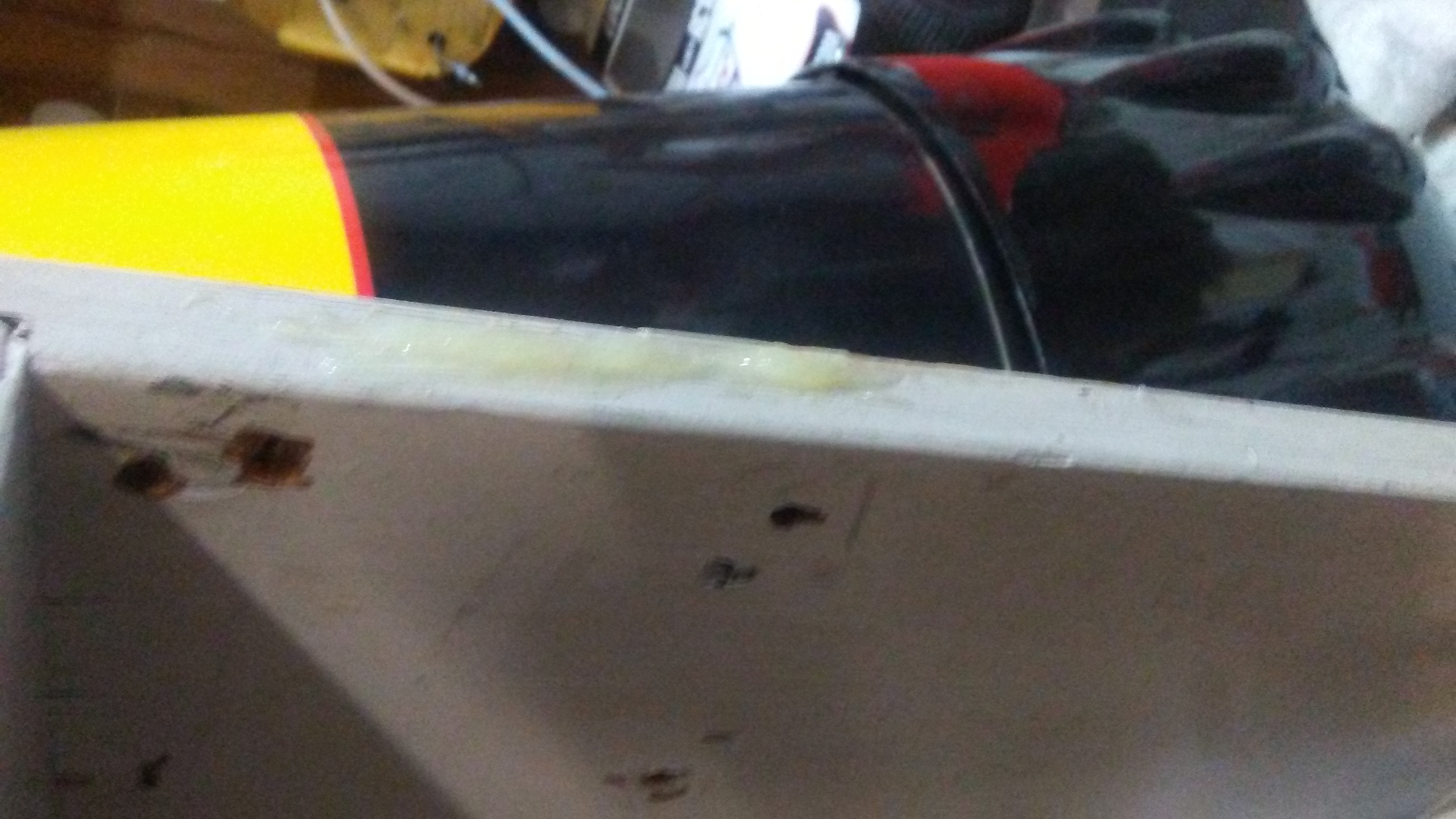

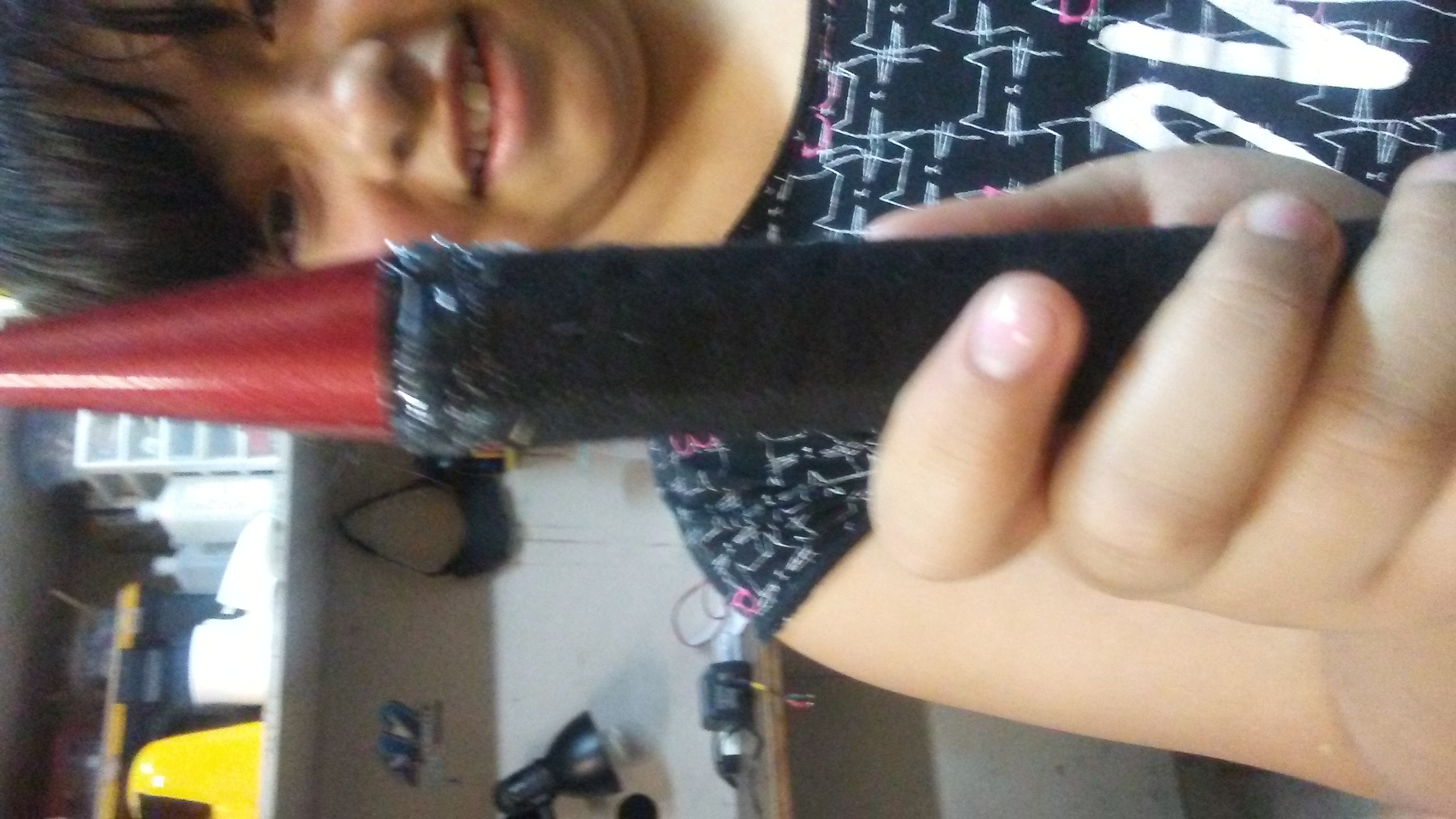

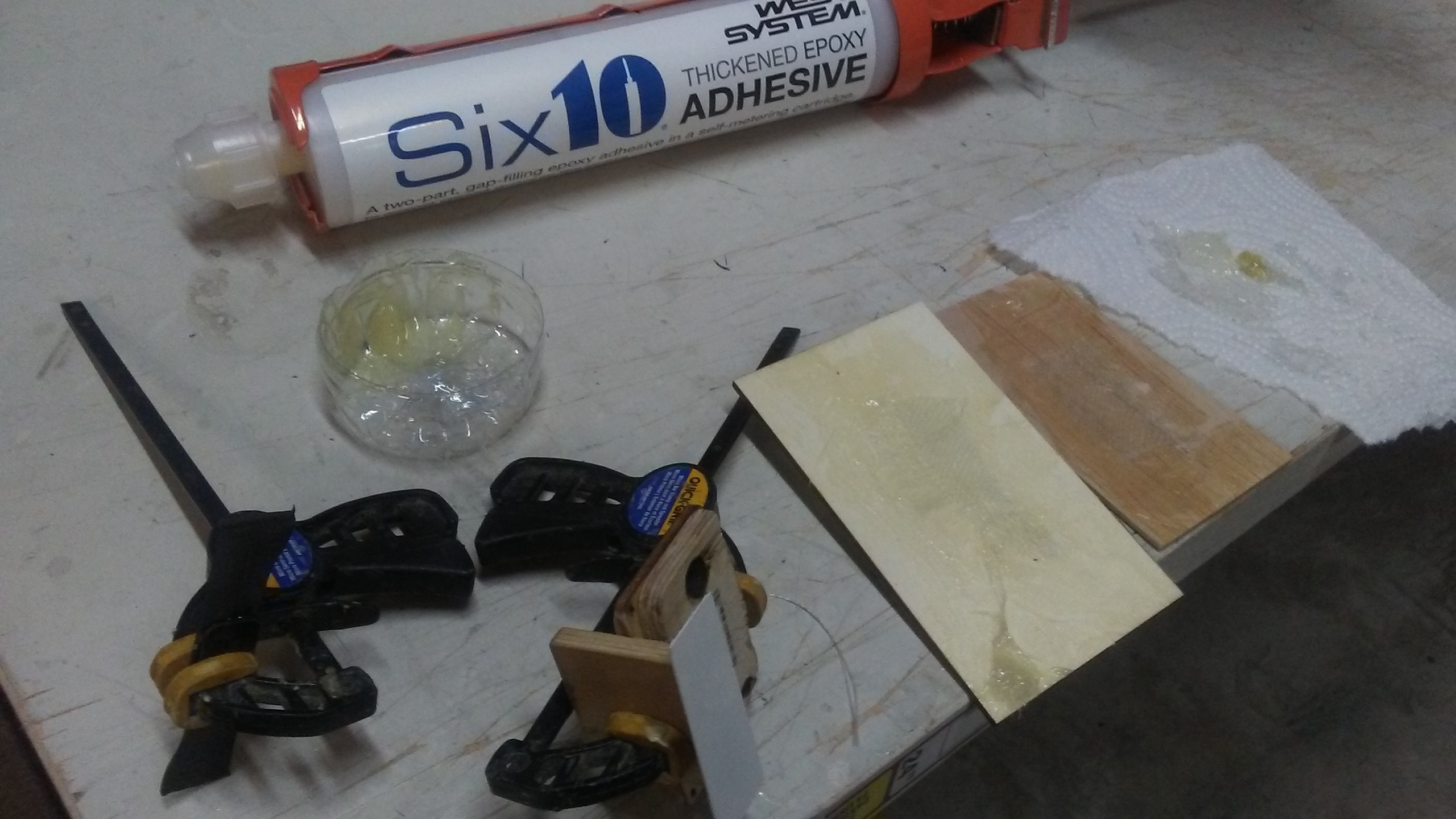

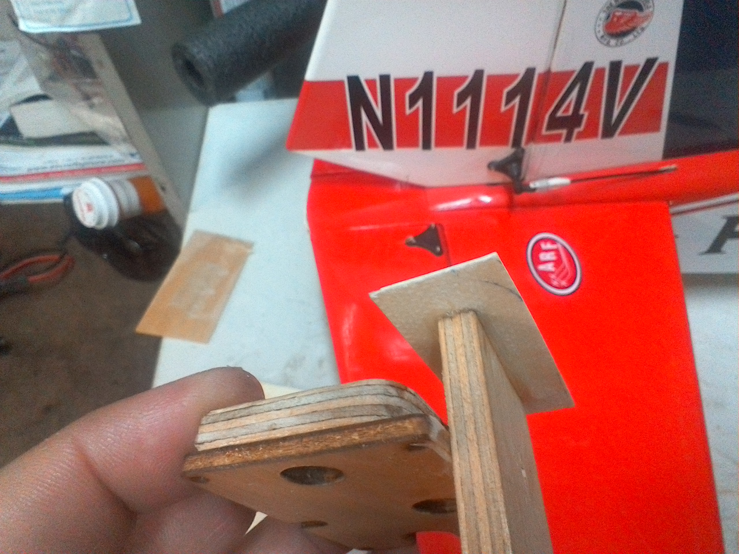

Im putting it to the test in these different materials, wood to wood, wood to fiberglass, carbon to carbon, fiberglass cloth to light ply and balsa wood and on the side of my shelf to see if it stays or runs while drying, cure time around six hours, room temp around 68 degrees right now, it was released in 2010.
It could have the same application as Hysol.
My daughter just used the last of the mix on her Wimbledon racket ( in her own way )

I just looked at the videos, same drying time but it looks like Thixo is directed to the wood boats usage, it looks like both products are of equal quality and have the same applications.

I've been using it since it first came out. I've never used the mixing tube and just squirt and mix. The mix ratio is 2 to 1. It reaches full strength after about 24hrs. Not sure but I think the Thixo is a little more flexible. I snapped an exacto blade on a fully cured blob of six10 and barely scratched the surface.
Plus you can wet out fiberglass with it.

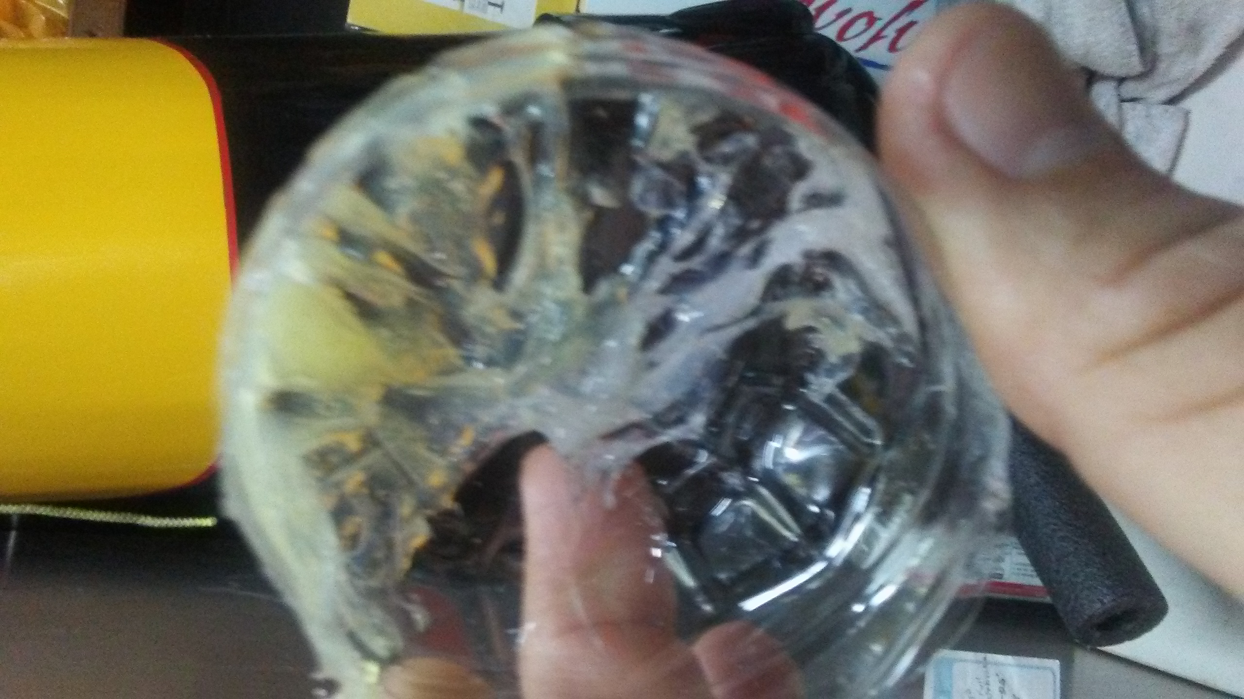

I have used the thixo on every application that I have used the Hysol 9462 on in the past and it has stuck to everything and cured rock solid. You can shorten the drying time by adding a little heat I usually stick one of those clip on drop lights shining on the glue joint and it dries even faster. I also never use the mixing nozzles just spread a bead out on some scrap cardboard and hand mix it. The only negative with this big tube is its hard to just mix up a little dab without wasting some so I keep a tube of hysol 9462 handy for that.

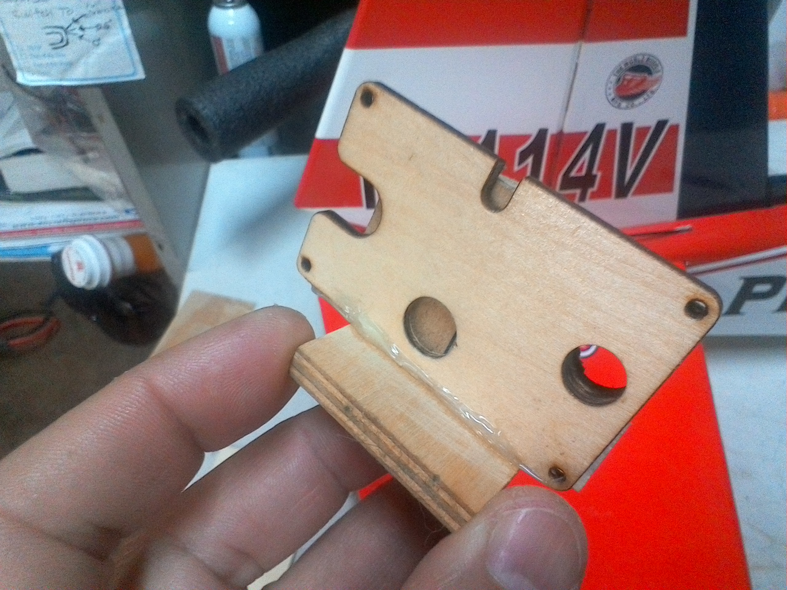

That's what I'm getting at, a lot more for the price of two Hysol cannisters and it gives the same results.
Going to the garage now to check on my test parts after 24 hrs.
Looks good on all glued parts.
