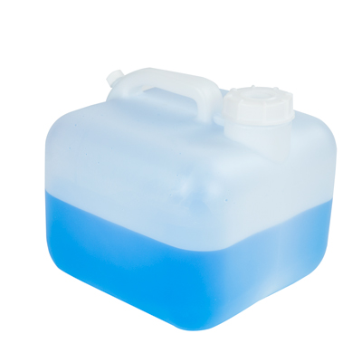

Check with Grainger I got one that is about 2 1/2 gallon with a wide mouth for filling that is a wide short can. I'll get a picture nest time I go outside
I'm currently using this one with no problems after over a year.

Check this site: http://www.usplastic.com/catalog/default.aspx?catid=816 this is where I bought the last two that I purchased from .
Patrick

The amazon link doesn't seem to work and the us plastics says it is not for fuel and oil.

i sent them a message at Us Plastics I have been using the one I posted above for over a year now with no ill effects

http://www.usplastic.com/mobile/item...lickid=popcorn
