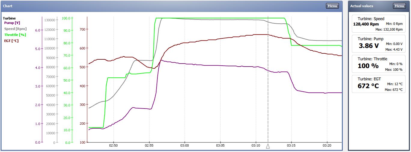

I installed a new Merlin 140XBL in my Ultra Flash late last year. At first it seamed like a fire-breathing monster, but I soon adapted to it (Wren SuperSport was installed previously). However, recently I have had the feeling that it is not as potent as I was expecting, and especially so on the last couple of flights yesterday.
On checking the telemetry logs (Jeti DS-16) at the field, I noticed that the max rpms were in the mid 120,000's range, not the 130,000 maximum expected. On doing a ground run and watching the ECU status it showed that after applying full throttle and the ECU running through the calibration function, it was reporting that the pump was maxed out, even through the rpm's were in the low to mid 120,000 range. Suspecting a fuel blockage, I stopped for the day.
Checking back at all previous flight logs, I noted some strange behaviour, even from the first flight of the Merlin 140. See data plots below for a number of flights.
After initial application of 100% throttle, full rpms are reached and then starts to fall as the pump voltage increases. At times it looks like the EGT is climbing up and reaches a limit of around 700C. Subsequent full throttle during the flight does not reach 130,000rpm.
I'm not sure of the explanation - I've flushed my fuel system and no blockage was found. I'm running a MAP Air Trap with a paper filter just before the fuel pump.
I don't know if the pump is going bad, or if there is some FOD in the pump or engine.
Any ideas from the experts?
I plan to e-mail Gaspar to get his thoughts also, unless he responds directly to this thread post.
Paul

Sounds like you may be hitting the PUMP LIMIT.
What is your Pump PW at full throttle? Compare that value to the PUMP LIMIT parameter.
The recommended procedure is to set PUMP LIMIT to 1020 (no limit), run the engine to full throttle and note the Pump PW. Then set PUMP LIMIT to 10 - 20% higher than what the pump runs at full throttle.
Joe

AJP,
Thanks, and that is exactly the suggestion I got from Gaspar this morning. He is suspecting pump cavitation on the inlet line, so he suggested starting from an external tank direct to the pump, and then start adding back in the shut-off valve, the UAT and the a/c tanks one at a time to see where the problem is.
As this is a brushless pump, the Pw adjustment is not available. It was topping out at around 2600, which indicates differently then the old brushed pump motor Pw readings.
Hopefully I can get a chance to try later in the week.
Paul

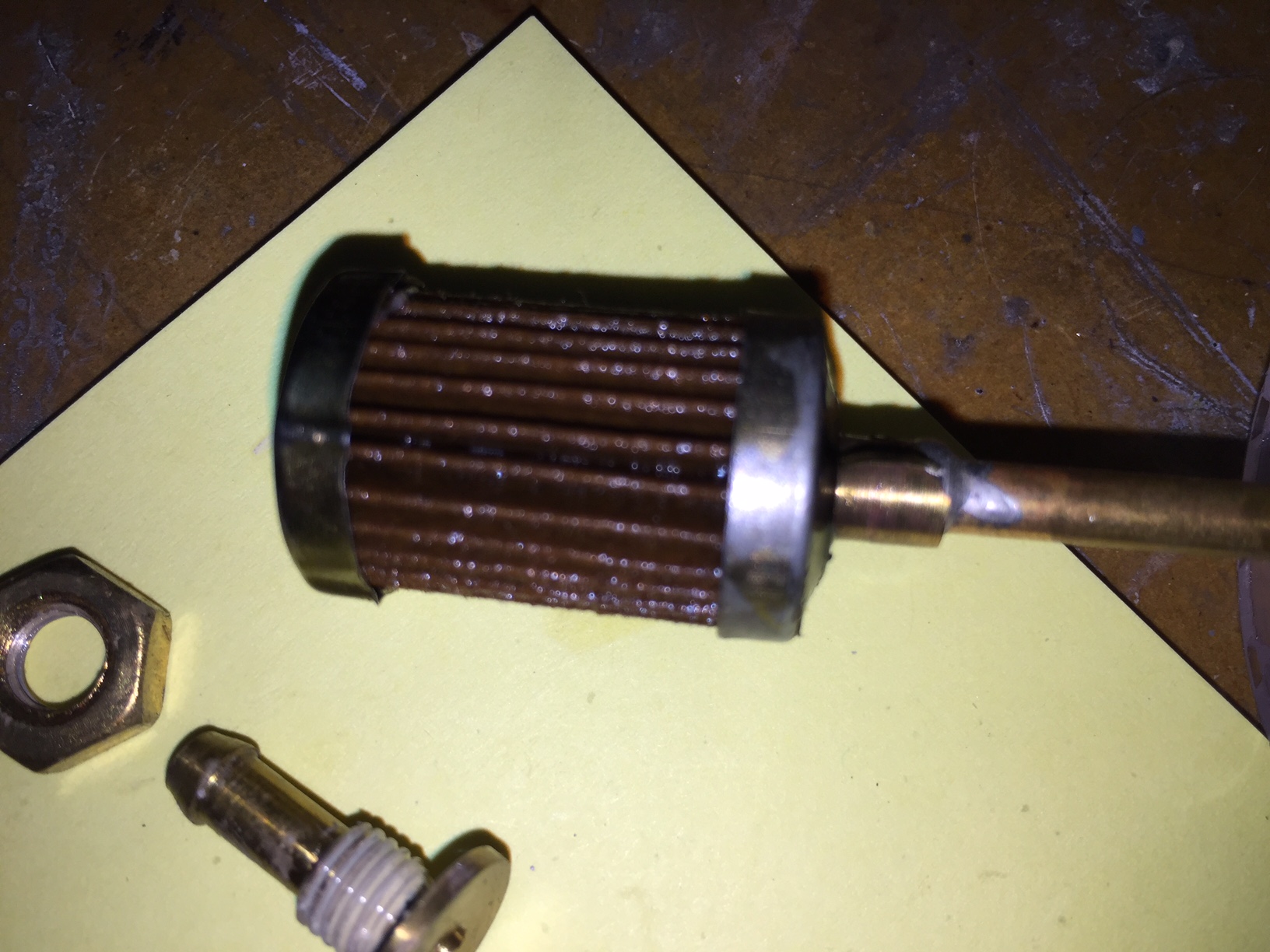

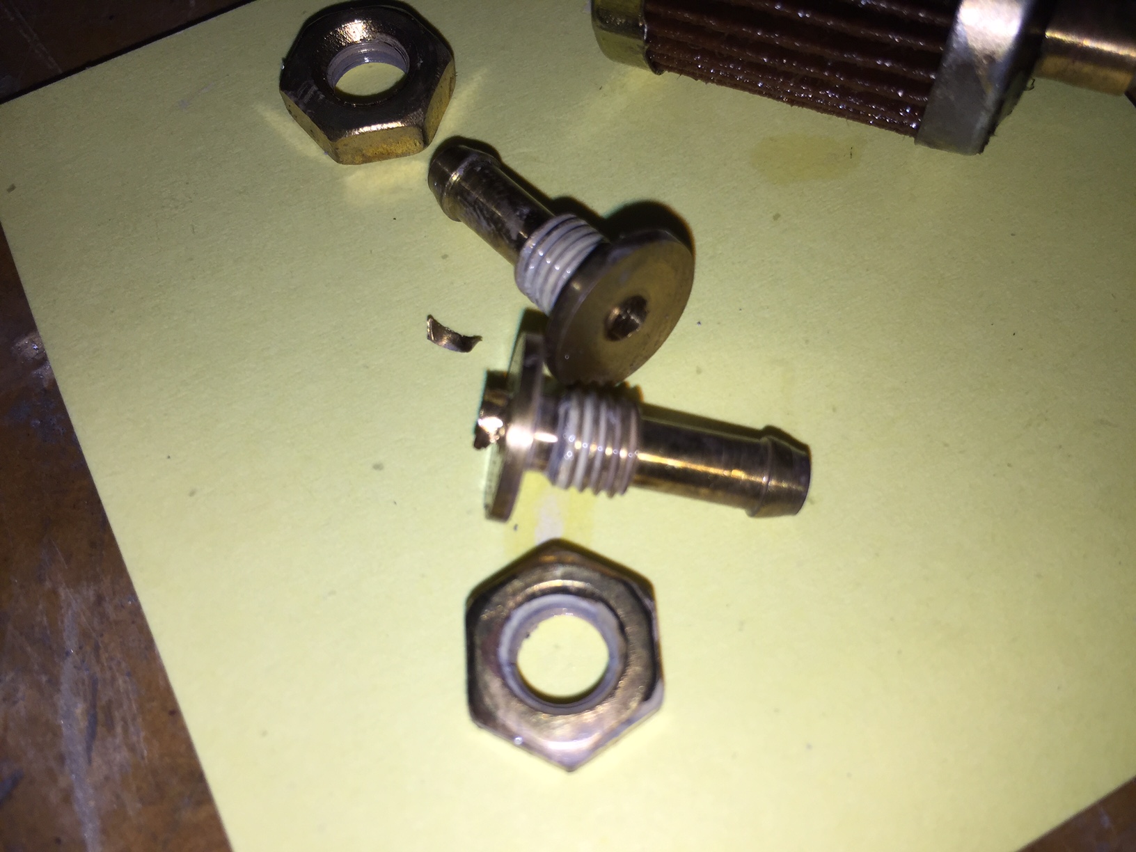

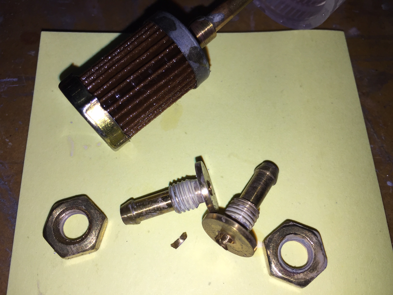

So, it looks like Gaspar hit the nail on the head.
I removed the Air Trap and ran the main fuel tank directly into the shut-off valve then to the pump. On running the engine, the Pw dropped by half, to around 1300 compared to maxed out at around 2600 when pulling fuel from the Air Trap. It would hold 130,000rpm continuously.
This Air Trap has had 70 flights on it, and on dis-assembly it had no sign of slime or anything unusual on the paper filter.
My second 140XBL also runs a MAP 40z Air Trap with no problems, but it has half the number of flights on it.
I did notice that the brass fittings had some significant shavings remaining on them which could cause line restrictions, although the filter would prevent them getting to the engine.
I have another MAP 4oz Air Trap on order.
I'm considering setting a Pump Voltage alarm in my Jeti DS-16 to indicate when the Pump Voltage is approaching the maximum (6V) as an alert to fuel restrictions. Normal ops is around 4V, so that should give plenty of headroom.
Paul

Ew, these pictures are really scary.

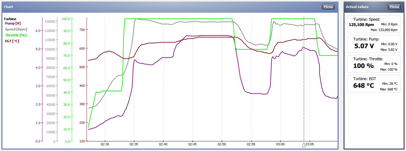

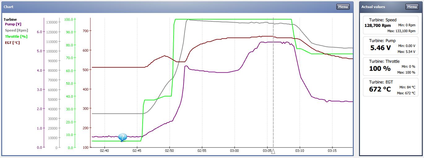

Well, there's more to this than I first thought.
Where I thought I had found the issue, as Gaspar suggested, I installed a replacement Air Trap and performed a ground run. Yet again, I observed the rpm drop after initially reaching 130,000. After confirming that this was repeatable, I removed the air trap, and ran my overflow tank directly to the pump using 6mm fuel line all the way, for minimal flow resistance.
After holding 130,000rpm for approximately 10seconds, I again observed the rpm decay to around 126,000. I confirmed that this effect was totally repeatable.
I did observe that whilst running at 130,000rpm, the GSU would show ‘MAX’, but as soon as the rpm started to drop, this changed to ‘Running’. Pw stayed at approximately 1300 throughout at full throttle, both at 130,000 and 126,000rpm.
Even though the logs show 100% throttle, I performed a radio calibration, but it had no effect on the rpm drop after approximately 10seconds.
It is though the FADEC is automatically throttling back uncommanded,
I have sent the Jeti TM data and the FADEC download data to Gaspar for further advice. I am out of ideas.
Paul

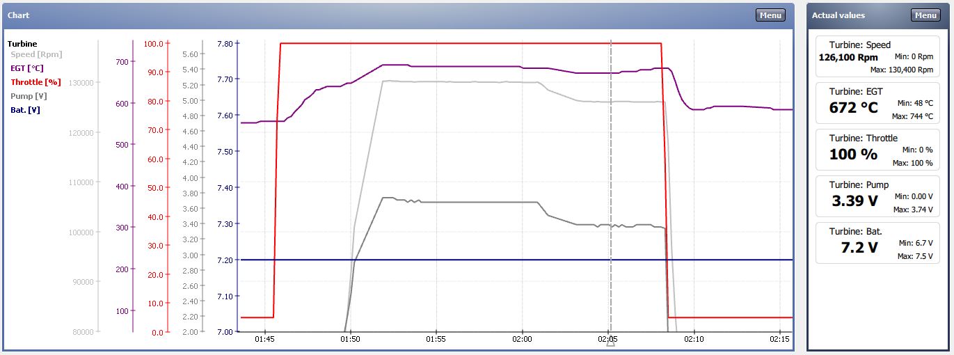

Thanks, for the update, please keep us informed as you move further into trouble shooting. I only ask in case i have an RPM issue when i get things up and running again.
Robert
Robert
Jeti 5200mAh Li-Ion, sitting at 7.2V during the run as shown in the plot above.
I can get at least 5 starts and flights from it before needing to recharge. This run was fresh off the charger.
I have exactly the same battery set-up with my other M140XBL, and it holds 130,000rpm indefinitely.
Paul

Right, just noticed the plot has that now, never seen these new ones and old ones did not show voltage.
Looking at the plot, it seems like the ecu is actually commanding the pump to slow down for some reason, so I wouldn't be looking for restrictions or pump problems. Seems to be either a software issue or some failsafe mechanism kicking in. Is that temperature level normal? It seems a little on the high side, but I don't know the m140 numbers. KT engines display 200 to 300 deg less than that at full throttle, but 700 is not that high either... When you figure it out let us know what the problem was!

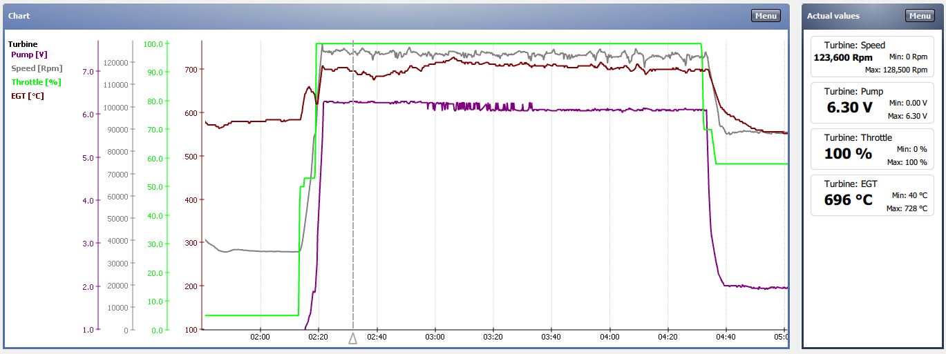

Status update on the troubleshooting.
After sending Gaspar both the Jeti TM logs and the ECU data download, he suggested that there may be an issue with the ECU, so he shipped me a replacement ECU via 2-day UPS. On receipt I installed it, but no change, still getting the rpm drop exactly as before.
I then hooked up an external fuel tank, new receiver and ECU externally to the model and ran the engine, trying to isolate any installation issue and I saw the same rpm drop. Next, I swapped the turbine for another M140 from another model which I know runs fine, and again saw the rpm drop. At this point, the only remaining common item left was the fuel pump.
After sending Gaspar this latest information, he agreed that the pump was most likely the cause, and he shipped me a replacement pump, again by 2-day UPS from Spain.
Well, tonight, I swapped out the pump and did another ground run. No change!!, still getting the rpm drop exactly as before.
So, in desperation, I made a test stand where I could run the engine away from the model. With the old pump and direct fuel feed to the pump, the engine ran fine, holding 130,000rpm indefinitely. At least some progress at last!!
I've started to add back into the test stand individual parts of the system as installed in the model and I have again observed the rpm drop when using the model installed radio system and ECU, connected to the proven good external pump and engine on the test stand.
At this point I think I can prove that it is a model electronics issue, but I have yet to isolate the actual source of the issue.
More updates to some - I think I'm getting closer to solving it.
Paul

After a couple of false leads, I ruled out any radio or installation issue, as I could reproduce the rpm drop on the test stand with a completely independent set-up.
Along with the replacement pump, Gaspar had sent yet another ECU, but with this one programmed with some custom modified settings. His suspicion was that my engine needed a higher fuel delivery pressure to achieve max rpm, and the pump was being current limited by the nominal M140XBL ECU settings.
So, after consistently being able to reproduce the issue on the test stand, I replaced the original ECU with the new, modified unit. That fixed it!!!
After running for about 2mins at max rpm with no sign of any drop, I replaced the ECU with the original unit and confirmed successfully that the problem returned.
I've now rebuilt my Ultra Flash with all the original parts except the modified ECU and a new Air Trap. Just now waiting on the weather to cooperate to fly it as final confirmation.
Many thanks to Gaspar for excellent customer service - he has gone above and beyond in helping me resolve this issue.
Paul
