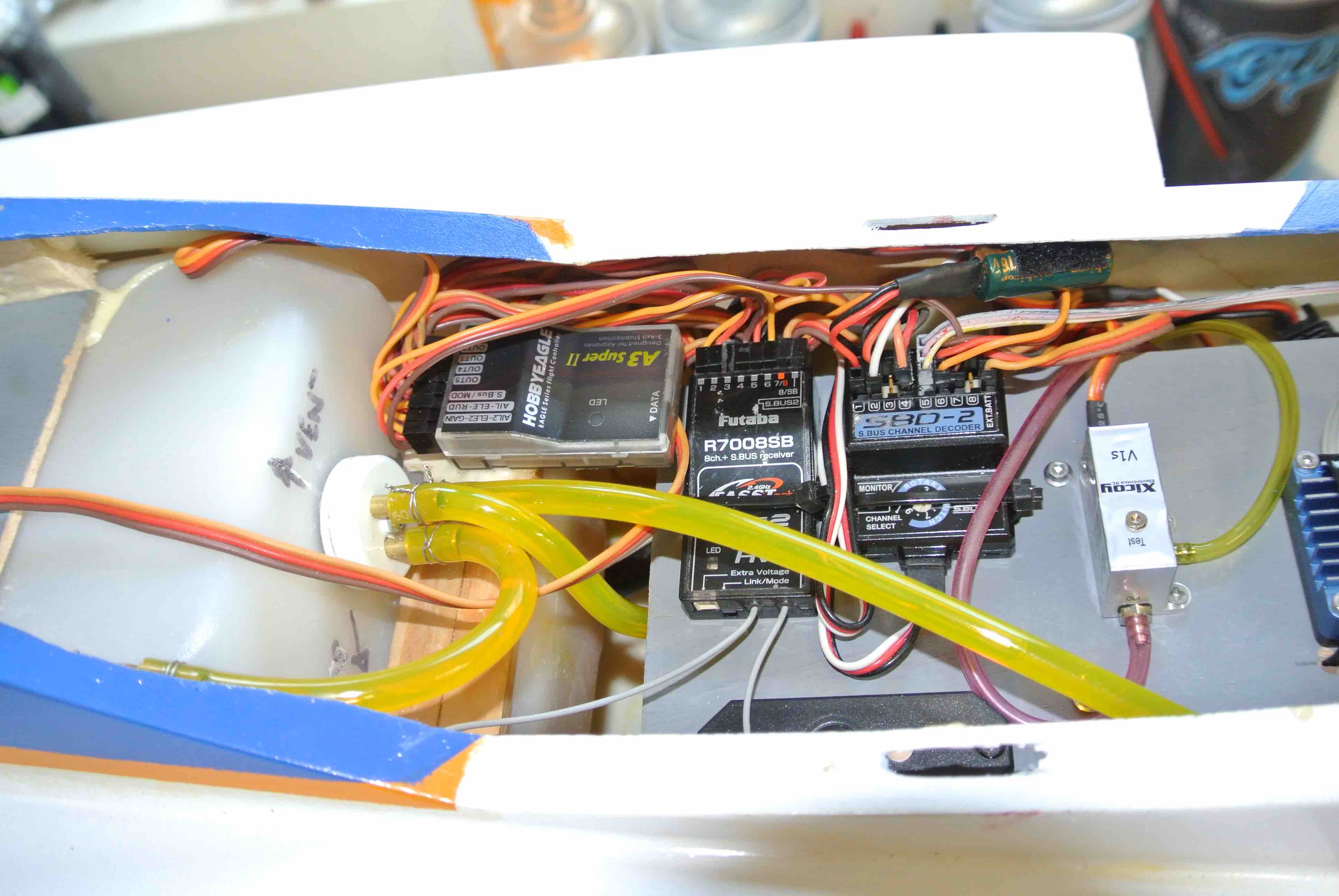

Now I know that some of you are very stuffy about Chinese products especially if they are inexpensive , but thought I should bring this to your attention.
I was needing a gyro for my latest 2 planes and after studying the literature I decided what I needed was a 3 axis gyro that had variable gain from the Tx and also if possible a switch to turn it off. I have planes with 2 ailerons and 2 elevator servos so this was also required.
I looked at the Very expensive Cortex gyro at £235 and the i gyro. Both are well known and well respected but seemed over the top for my small planes.
I then spotted the Hobby Eagle gyros and after seeing that they had the right spec and had a small controller to easily adjust the settings at the field I ordered 2 of them. The price was £35 for the standard package of gyro, leads, usb adapter and the display box. The web site for Hobby Eagle (HOBBYEAGLE - ?????????????) has the manual available for downloading. It is well written in good english and easy to follow.
The gyros arrived promptly this week and I immediately installed them in 2 planes and took them to the flying field today. We checked the gyros were in the correct direction and set up one 3 position switch with 3 modes, off, ailerons only and 3 axis. The first takeoff of the Sting was with the gyro switched off and we switched on and set the gain to about 1/4. (In the software I set the gyros to 80%).
Immediately the plane was noticeably better both with just ailerons and with 3 axis. The gyro does all sorts of fancy stuff like 3d and auto levelling, but I had no need for them.
Dave Wilde then flew the Huckebein I have recently acquired and the results were even more impressive. I cannot see that anyone else has tried this gyro on jets and wondered why. The gyro comes with a capacitor to hopefully avoid any brown outs and I fitted them to both units.
Here is video of the Sting flying in 10 mph cross wind.
This gyro just couldn’t be as good as one costing 7 times as much…could it? Any one else tried them?

I have a few of them in small foamies - EDF, 3D, and one Warbird. They work well. For example in my 63" F-7F Tigercat (Flightline Foamie) I have the airplane a little aft CG for my tastes without the gyro on. For flying with or without the gyro, I have programmed the usual mixes to make it fly like a pattern plane (rudder to aileron and rudder elevator mix) so it will hold true knife edge and slow rolls can be done accurately in spite of a powerful rudder to roll coupling tendency of the airframe. While I've set up the plane to fly true aerobatics without the gyro, such as described, I love what the little gyro brings to the consistency of the tracking and behavior in calm and in windy conditions (it's a light weight model afterall). It just "flies bigger". It flies well without the gyro and does not need the gyro for typical warbird flying but as a "pattern warbird" platform it is as responsive as it needs to be and yet as stable as it should be to fly accurately. I also have a small 52" long Mig-21 foamie that I love and it does not need a gyro. I flew several months without one, but when I fly it really, really slow and nose high... the wings rock quite a bit. Yes I know Deltas do that... but real Mig-21's don't rock back and forth at 120 Hz in slow flight and it makes the model look, well, like a model... So I put the gyro in to make the little -21 fly like a larger plane at high alpha and in higher winds. I've yet to be discouraged from flying this model in wind. The wing rock is gone with the gyro and she flies "bigger" but just the same, still - it's still a Mig-21, if you know what I mean. On 3D what I like is they give you confidence to get more aggressive and fly lower while pulling off the boilerplat maneuvers you'd normally only dare one mistake high. I've learned in 1 season what might have taken 2 or more.
I am not sure of their reliability over time... My experience is my experience but in terms of statistics, probably an invalid sample size! But for what they are, and the fact that you can get them for $20, and the fact that on my specific applications they have worked really well - I can not complain in the least in the applications I've chosen them for.
Bad Falcon (03-21-2023)
I wanted to add that what these cheaper gyros lack is a powerful setup took like the iGyro 3e and the Cortex has. I'll also say that the cheaper "pots" on the case are a potential point of issue that, among other things, could (probably) create gain "drift" a little in temperature changes or with inadvertent physical contact. While this is not such a big deal "all the time" - in a model where it's a bit larger, a bit higher performance, etc... it could be potentially be more noticeable or problematic. I'm also not sure what the failure modes are and if the failure mode is to stop servo movement, cause a hard over, or to revert to basic signal. Some of these things are more "known" in some of the more expensive gyros, while a lot is still admittedly "wishful thinking" in nearly all hobby grade equipment.
Still, these are potentially powerful tools for a powerfully reasonable price

If you check there are no physical pots on this gyro which is why I selected it. All the setting is done by directly addressing the chip. It can easily be changed on the flying field by using the small hand held display. You can use a computer if you prefer. If the gyro looses power then the plane will crash, the same as if a Rx looses power. If it has a momentary interruption of power (a brown out) would need 8 seconds to reset. I believe this is the same for any gyro regardless of cost. You should check the manual, I think that this gyro is pretty much the same in adjustments as the expensive gyros. You can separately set the amount of gain on each of the surfaces, set the sensitivity etc. If you have S-bus you can even display the servo settings on screen with the one wire connection and set end points dead band etc. I would be interested to know what differences there actually are between this and the more expensive ones. Not sure that 'drift' will apply if the adjustments are in the chip.
Nice to have some feedback from people that have used them. I will of course report back if there are problems. After seeing mine one of our club members was keen to order one.

I use them too. The later versions with autolevel are really good. Not sure if they hover a plane like the cortex, but they are good and easy to setup using the display or even better the USB interface.
A3's are great gyros. I've used them on both edf's and turbines. The A3 II are even better since they will take SBus single line input and with my Jeti, I can have a really clean install on my smaller edfs. I replaced one with a Igyro SRS and flight wise, I really couldn't justify the cost increase but I felt the setup procedure of the igyro gave you better settings. Currently I use A3, A3 II, Igyro SRS and an Igyro Mercury ( all for different reasons). Also, a friend of mine has been flying a3's down at Georgia Jets and now more members are installing them. In my opinion it's probably one of the best gyros for the money.
