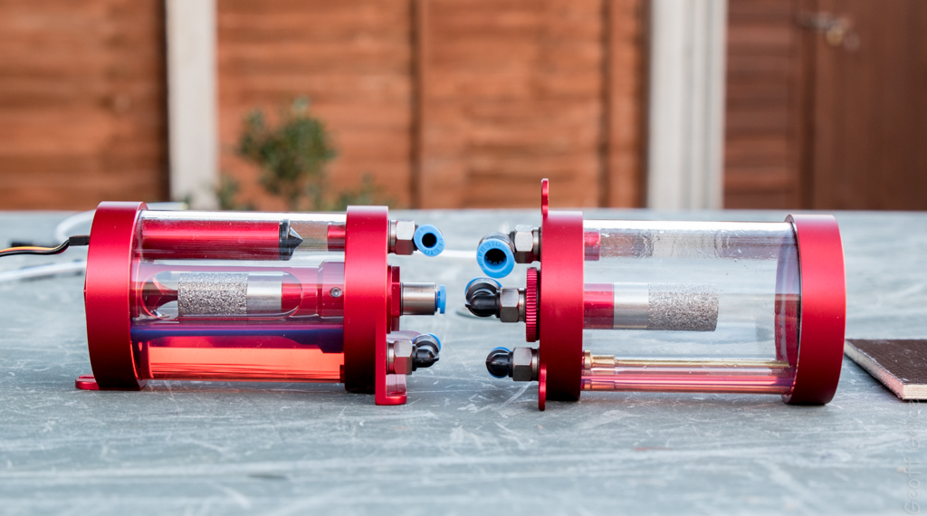

If you're landing with air in the UAT then it sounds like it's doing it's job and trapping the air that's coming from upstream. Can you show another picture of your fuel filter? some of them have the direction arrow facing the wrong way and that could be back siphoning air.
If you're interested in peace of mind maybe worth checking our Intairco's new iTrap - it has a pressure sensor inside that triggers when it detects an air pocket - I'm putting one in my Rebel now..
On the left in this picture, the sensor is at the top and you can see the signal lead exiting to the left

I have intairco air traps in 3 jets and with each of them I had some air leaking until I replaced the thin rubber washers on the fittings with Orings. No trouble since.

If you go the "O" ring fix as Bob did, some "O" rings don't like kero or jet fuel, they will swell. Put the O ring in some fuel and let it soak for a bit and see if it will swell. Viton O rings works best and will not swell
