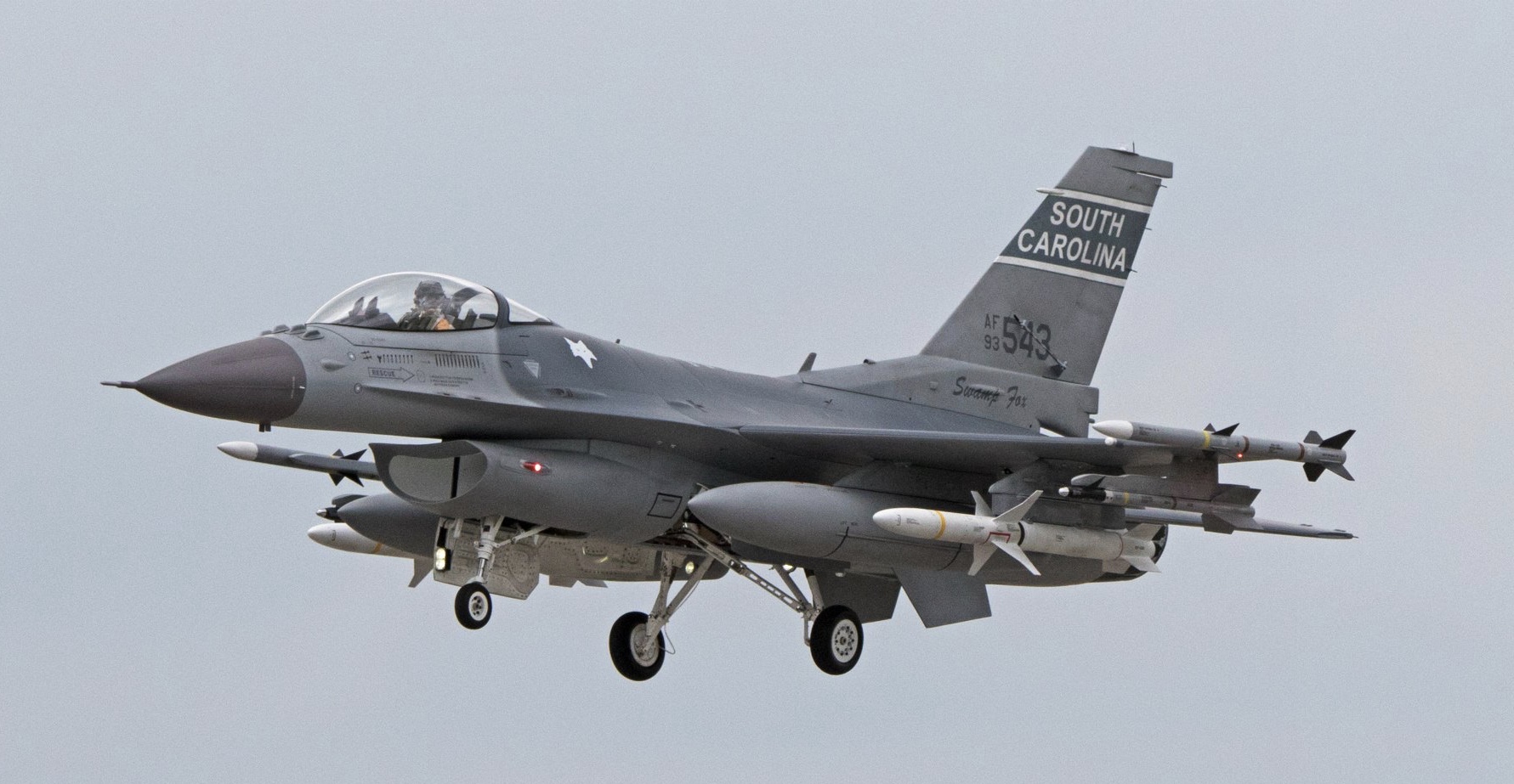

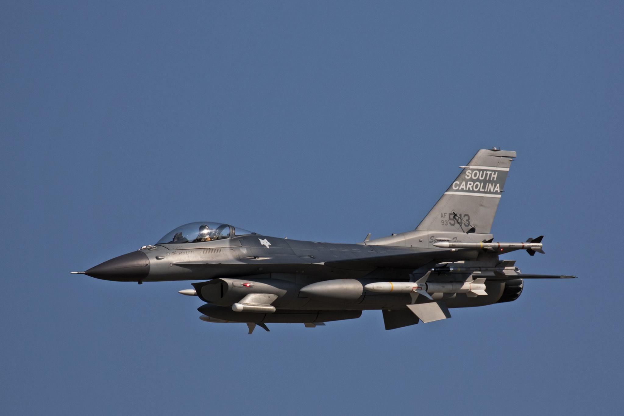

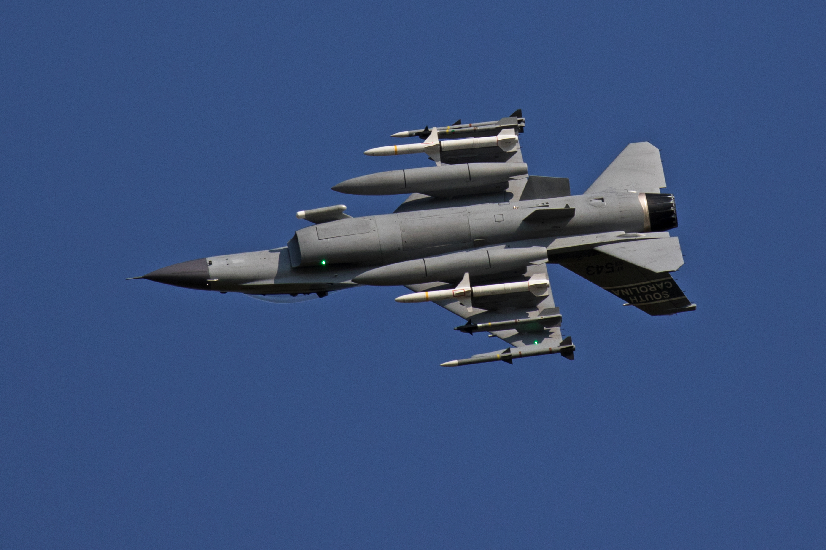

You mean these?? JS 😜

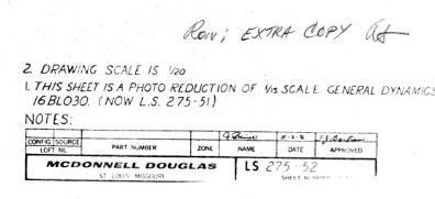

Originally Posted by FalconWings
why in the world would McDonnel Douglas have Block 30 drawings? LOL
btw I still use McDonnel Douglas flight controls design handbook.....the finest in the industry.
Not an expert myself. The drawing file name suggests block_30 but that is all I know.
Does the pic mean anything to anyone? Note the date.
