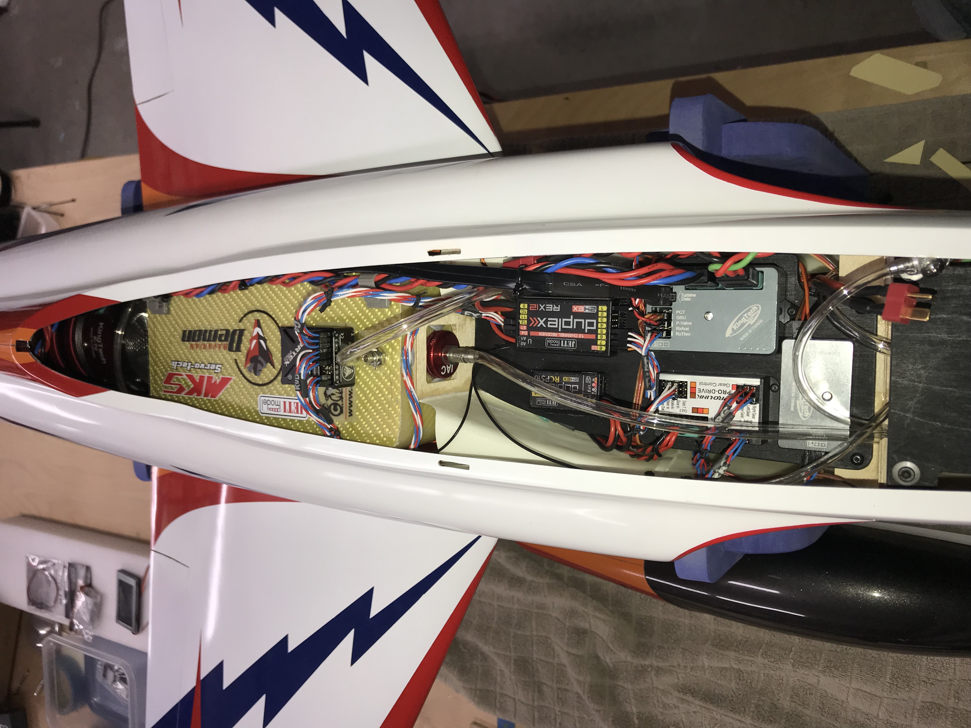

This past summer I refurbished my CARF Viper and this is what I came up with on my install. The front panel is held in by being wedged and simply using the BVM Hatch Latch, pops down and twist to side to get to the batteries. I have Festos connectors to undo and just the brake and retract valve to unplug, should I want to take it completely out. The fuel pump and ECU is under the carbon fiber panel with the Fromco Wolverine switch and Fromco regulator. The Demon is mounted on the fuel tank. The Jeti receiver is mounted on one side of the fuse with the UAT on the other side of the fuse.

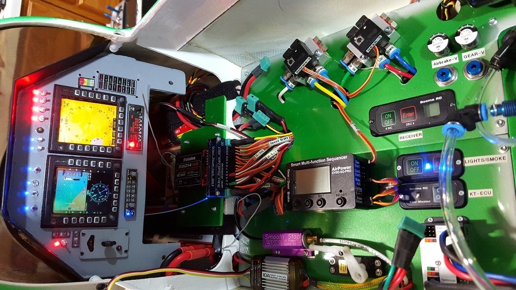

Just spent a few weeks doing the same thing on my F-18 when I had to tear everything apart to rewire some servos. First picture shows the access to the air lines and gear with only having to remove 4 screws and move the smart fly power system to the side.
