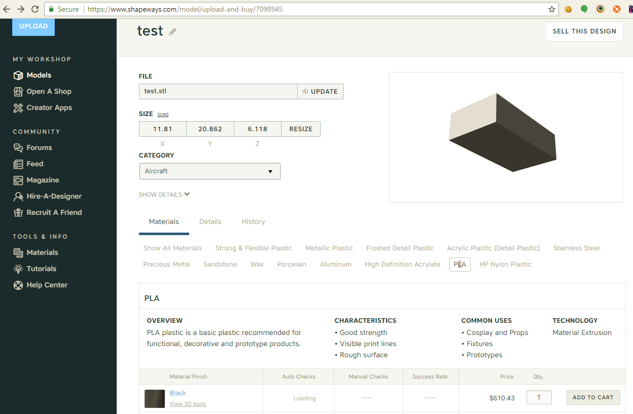

Hello, is someone know a place to order online 3D printing (plastic) for small SketchUp (STL) models (always under 6 by 6 inches, mostly under 3x3) with a reasonable price for just a few prints (1 to 4 units)?
(This is for small and not critical part, mostly for aesthetic components or for plug (molding) elements.)
Thanks.

Thanks, but I'm not sure I would call it reasonable price... 600$ for a 8 by 4 cube (see image)... ? Is it the price everywhere ?

That's about the going rate. I've had many prototypes 3D printed and they have always cost me between $1500 and $2500. It's all size dependent.

For $1500 to $2500 you can buy your own 3D printer, a decent one at that.
I have used https://www.3dhubs.com/ a number of times. It is a world wide network of 3D printers and they will hook you up with someone close to you.
The last parts I had printed were about 1x1x3 inches and cost $7 each for 6 parts.
You can not just enter the overall max size as a brick. You are paying for the amount of material actually used. You must calculate the actual volume of plastic in your part. Their online quoting will do this math for you.

The cost is highly dependent on the technology you use. The term "3D printing" is not descriptive enough.
95% of home machines, and cheaper service bureaus use Fused Deposition Modeling (FDM), they squeeze heated plastic through a nozzle and build everything up like with cake icing. There are limits to the material you can use, the orientation of the part and the final level of detail. But the machines are relatively cheap and it you look around you can get things made very cheap.
Other more expensive machines and service bureaus utilize other technologies like Stereo Lithographby (SLA), Selective Laser Sintering (SLS), etc. These technologies have other limitations, but generally offer more detail and are used more often by professional customers. Much much more $$

That's for as many parts as you can fit in that cube. With a good technique you can fit lot of small parts.

The thing is you don't print a cube. You cut it with a saw.
3D printing is a powerful tool but the output is never better then the input. Even the cheap $200 printers can do amazing stuff if you know how to handle them and how to design part for them. Saying yes to STL files from a beginner need a really brave guy.

No, but its takes time! Att printers are individuals an need quite some fiddling to get going. I would buy the parts from shapeways, not that expensive if you really design them as 3D prints and for the technic you desire.
For example your box is a $600 piece if done solid. If using a home printer tell the printer to make the box sparse, 5% infill.... now it's a $20 print. Or if going SLS (powder) make the box hollow in CAD and a small hole in the bottom to drain the powder.(or make any form of honey comb 3D structure inside the box) Again back from $600 to maybe $40. Or just cut a chunk of styrofoam $1
