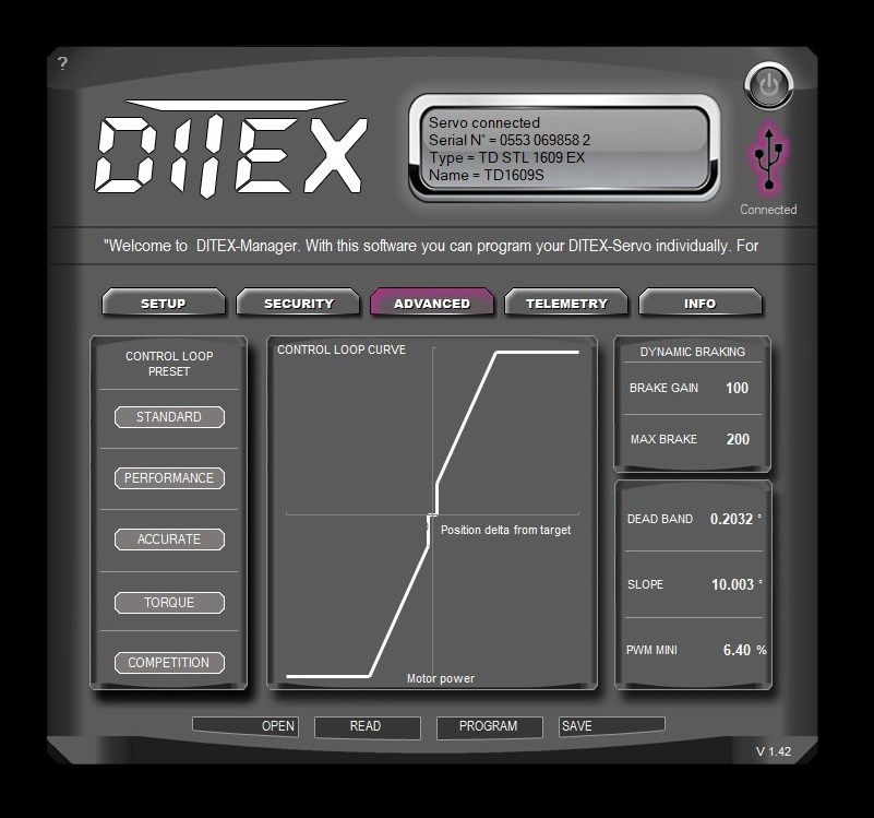

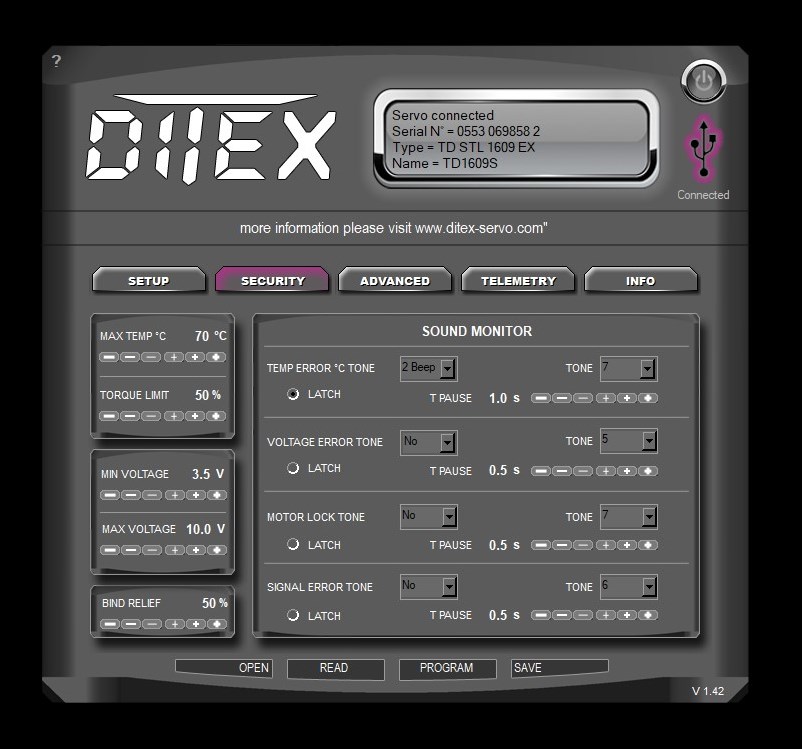

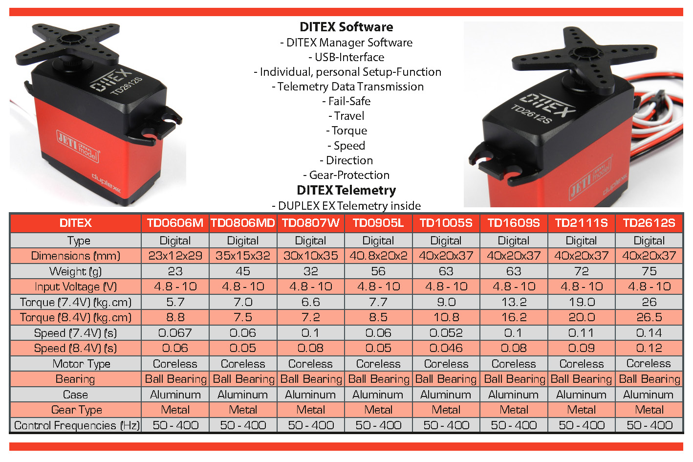

We would like to introduce brand new line of Jeti Ditex digital servos with Telemetry, PC Interface Programming, Data Logging and Full System Integration. Any radio system can use Ditex servos, but specially Jeti DC/DS-24 owners can really benefit from many revolutionary features.
In next two weeks we are bringing first 4 types, and next few months we will be receiving additional 4 to fill up most of our needs.
At the begging only the REX line of receivers (no Assist) and Central Box 400 will have full telemetry support capabilities. Also in the first half of this year we will be introducing two brand new Central Box 2xx/300 power distribution systems. Both new CBs will have full Ditex servo integration, unfortunately the existing CB200 does not have enough processing power required by additional telemetry servo functionality.

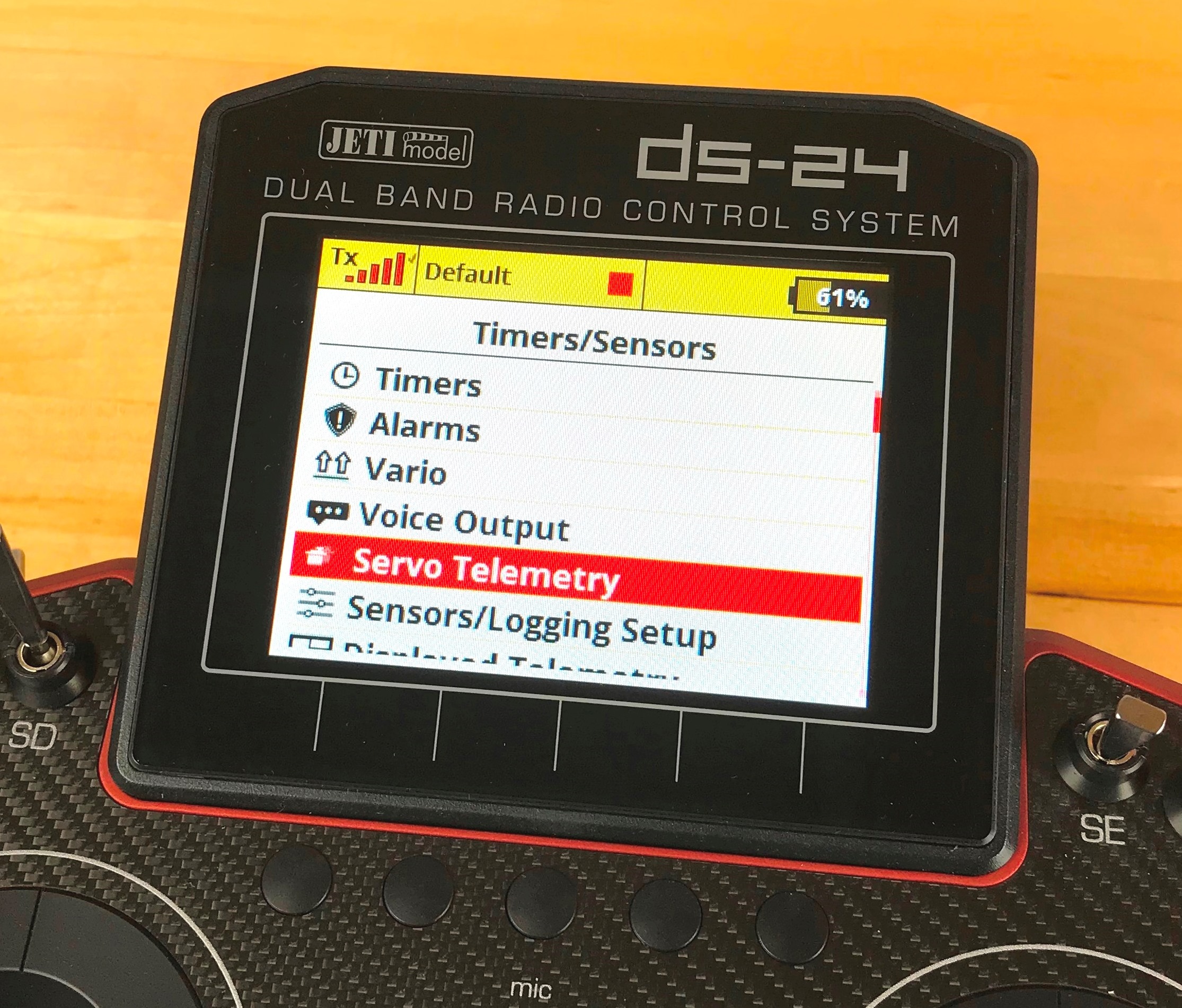

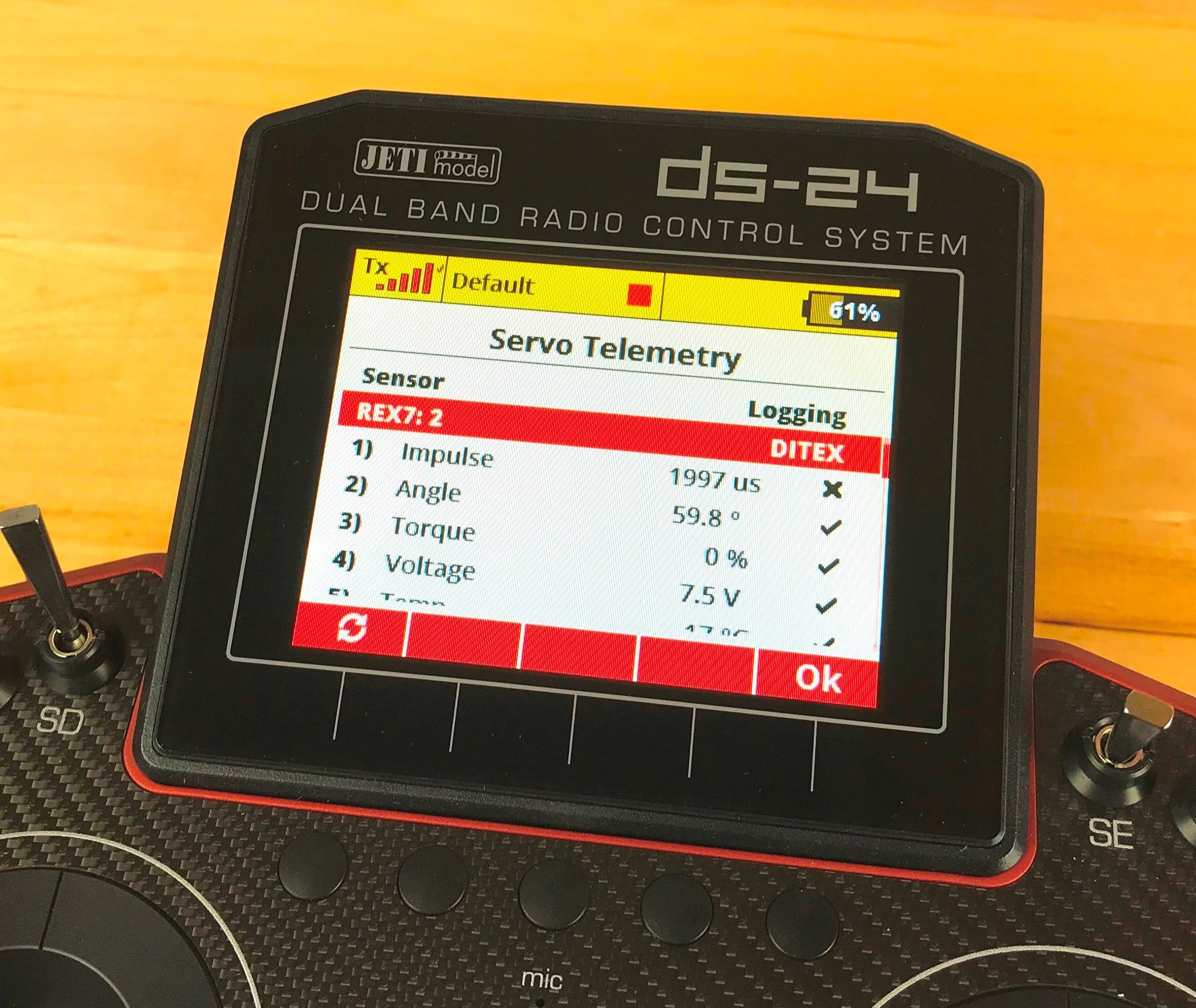

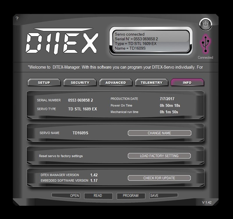

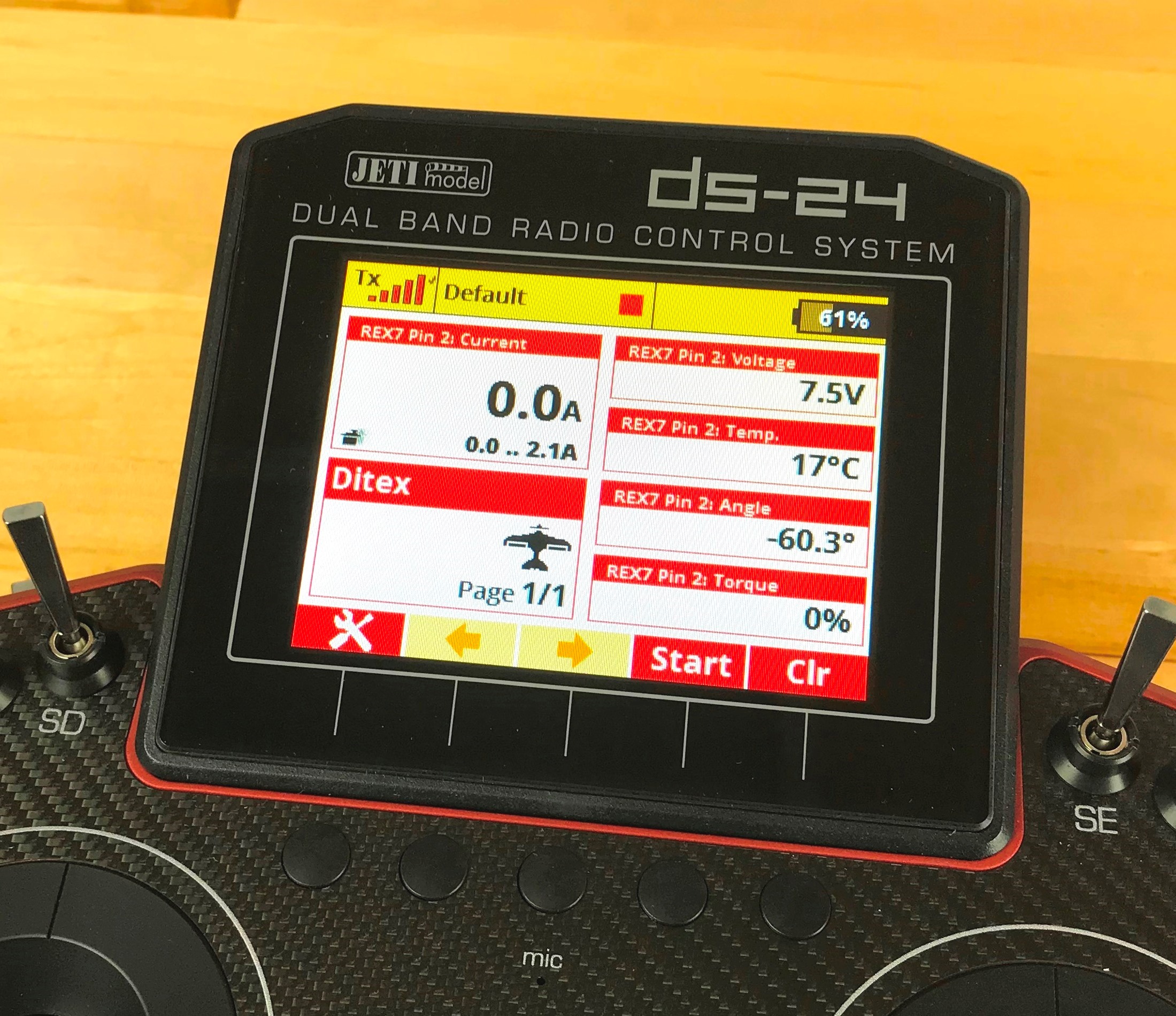

Servos will provide up to 10 telemetry data streams with data logging and telemetry alarms. If there is a problem with servo connection or performance system will generate instant alarm that will be displayed at the transmitter screen. Servos also record run time and power on time.
Some of the Features

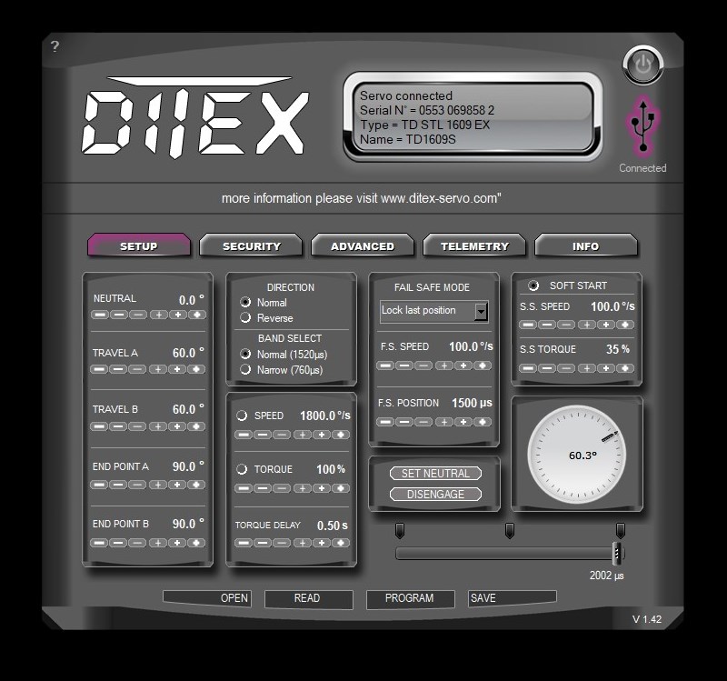

- Programmable center and end point
- Programmable Torque, Travel, Soft Start
- Programmable Impulse (Normal 1520/Narrow 720)
- Programmable Failsafe position.... and type of respond
- Programmable travel curve

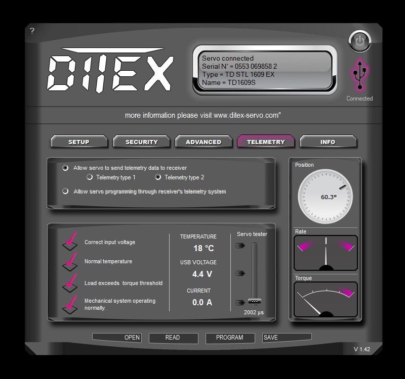

We are working on the video, another features that we love are supper cool. Create servo profile and copy custom setting to as many servos as you want, this way all servos on single surface are same. Ditex with Jeti Integration revolutionizes hobby.
Another cool feature, disengage spline when programming servo using PC, manually adjust center, click engage and BINGO new center for the servo is done.

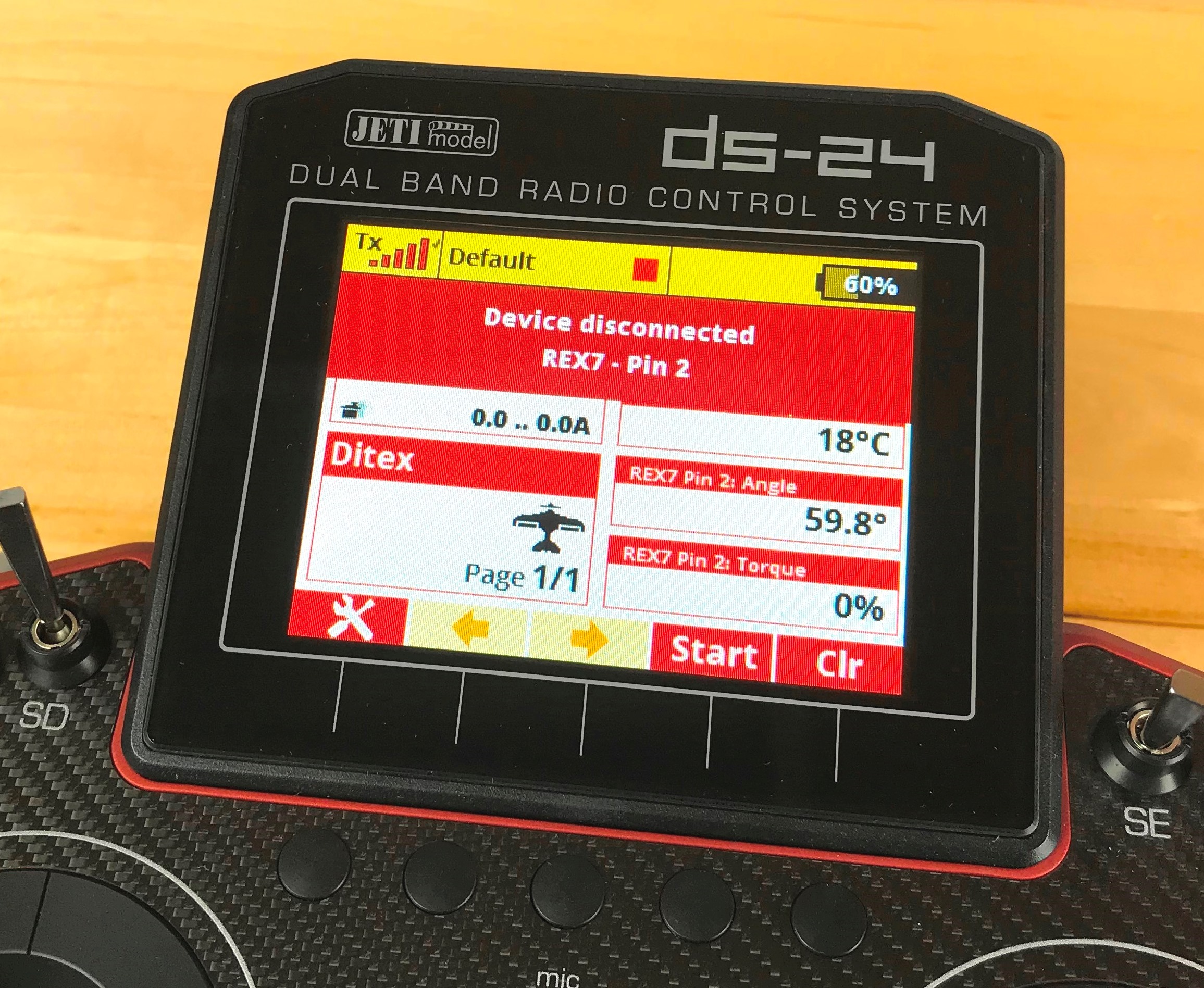

In the Rex12 Pin Config, I changed the output pin from servo to Ditex.
i keep getting a warning Device disconnected- Rex 12 pin 1. Or any other pin which I select.
what am I missing here?

Chatty, the Jeti gang may want to comment but I have seen an issue with the REX receivers periodically disconnecting from telemetry (I see it with the CB200 and CB400 .. it goes from "checkmark" to "x" in device explorer for several seconds from time to time). I gather that a new firmware update is coming that may address this. Perhaps you have the same issue?
These servos look really interesting, I got two of them to evaluate and while they are VERY nice, I was disappointed that only the receivers support the servo telemetry at this time. Until the central boxes support them, they are not really much use .. for most of the installs where their telemetry would be useful, it's a large or complex airplane that would not use a RX without a CB.
Any outlook from the Jeti folks for when this functionality might be coming? CB400 only? New CB200 follow-on?

You have the latest RX REX firmware.....and just to ne sure this is not a Assist RX?
You also need to update the Ditex Servo with the new software....it will pop up when you connect them to a computer with the Ditex Software...
No Assist, everything updated.
Strange.

This is the warning I keep getting with the servo connected or disconnected

Strange, while mine are on CB200 so no Telemetry yet......I did test them on a REX RX and it worked as advertised, so I don’t know....maybe a clean setup?

Infact in post No 1 ZBs pic has the same message too. Pin disconnect.
