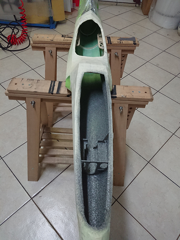

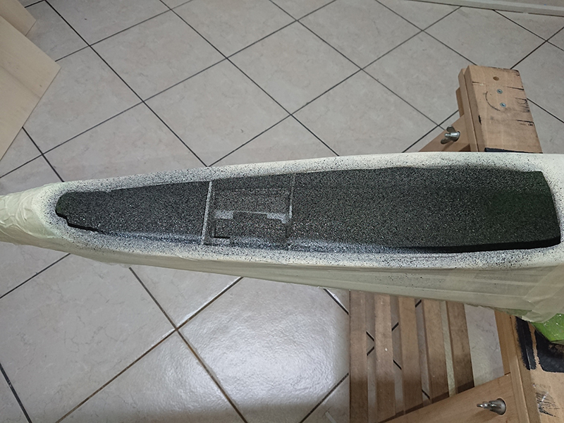

ok, work has start,
i have decided paint all inside with "duplicolor GRANITE"
After sanded inside, and covered the outside...
Now I wait 24 hours for completely dry.

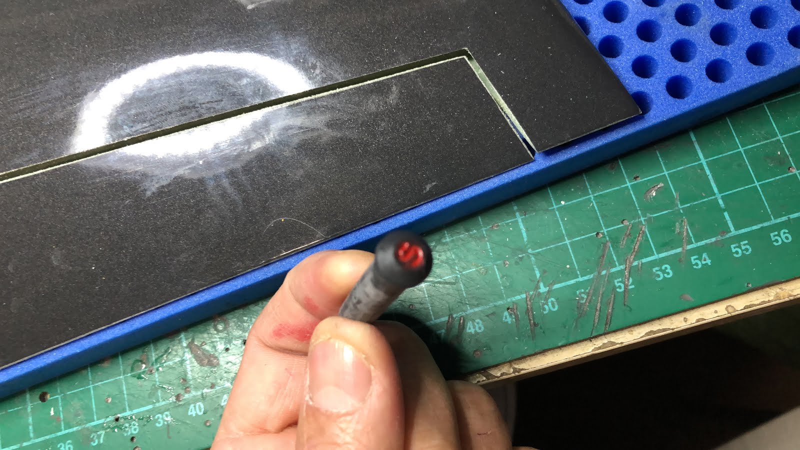

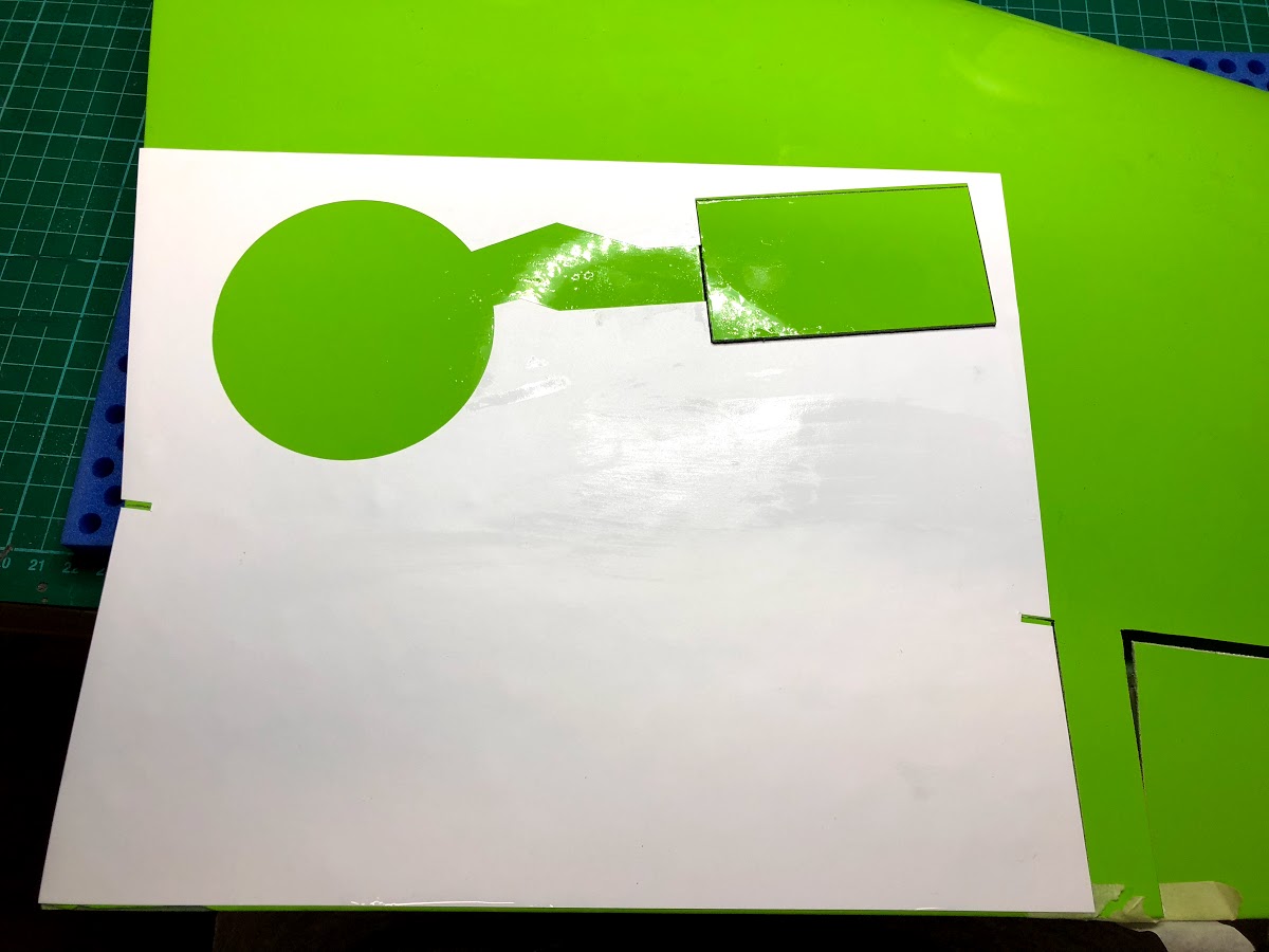

first I redesigned the templates for cut ( original printed on normal paper) and cut on adhesive vinyl,
then I redesigned and cut all new horns with 1.5mm carbon ( original in GFK without hole...)

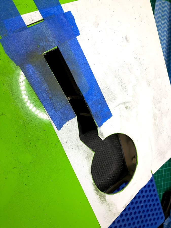

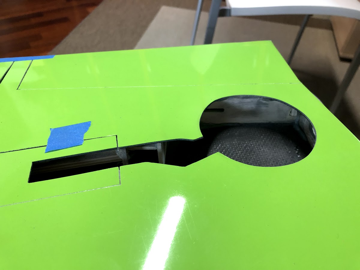

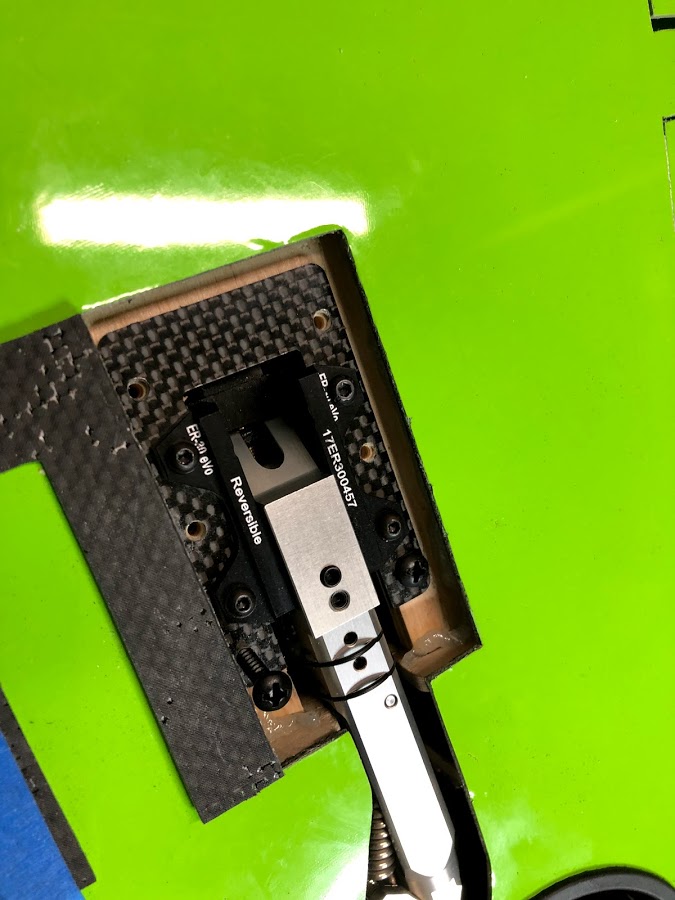

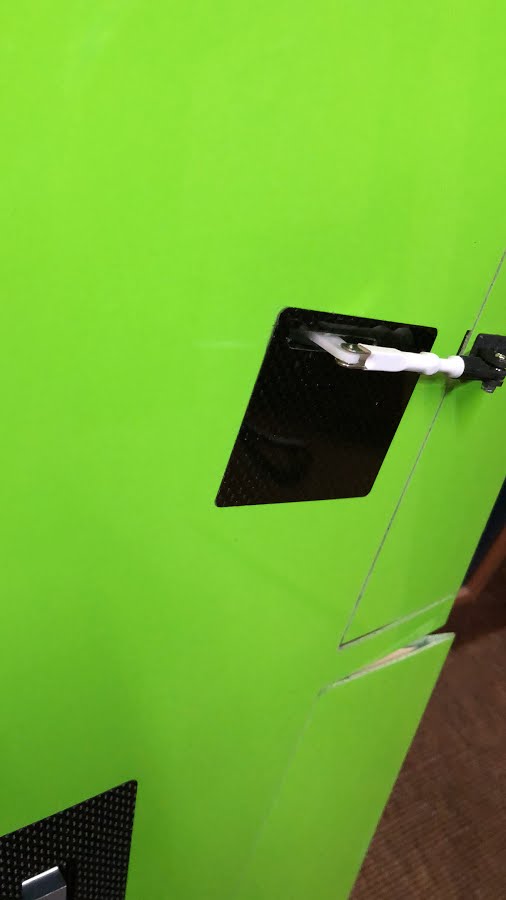

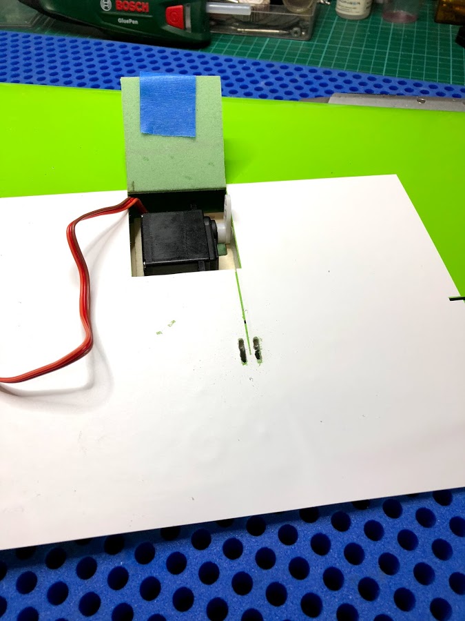

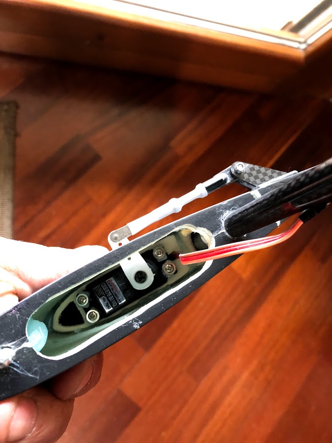

next, cut the wing for gear, aileron horn and flap,
ID:	2255964   Click image for larger version

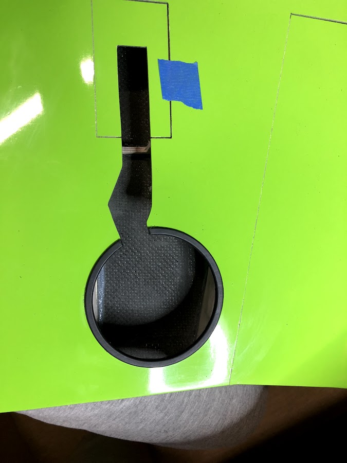

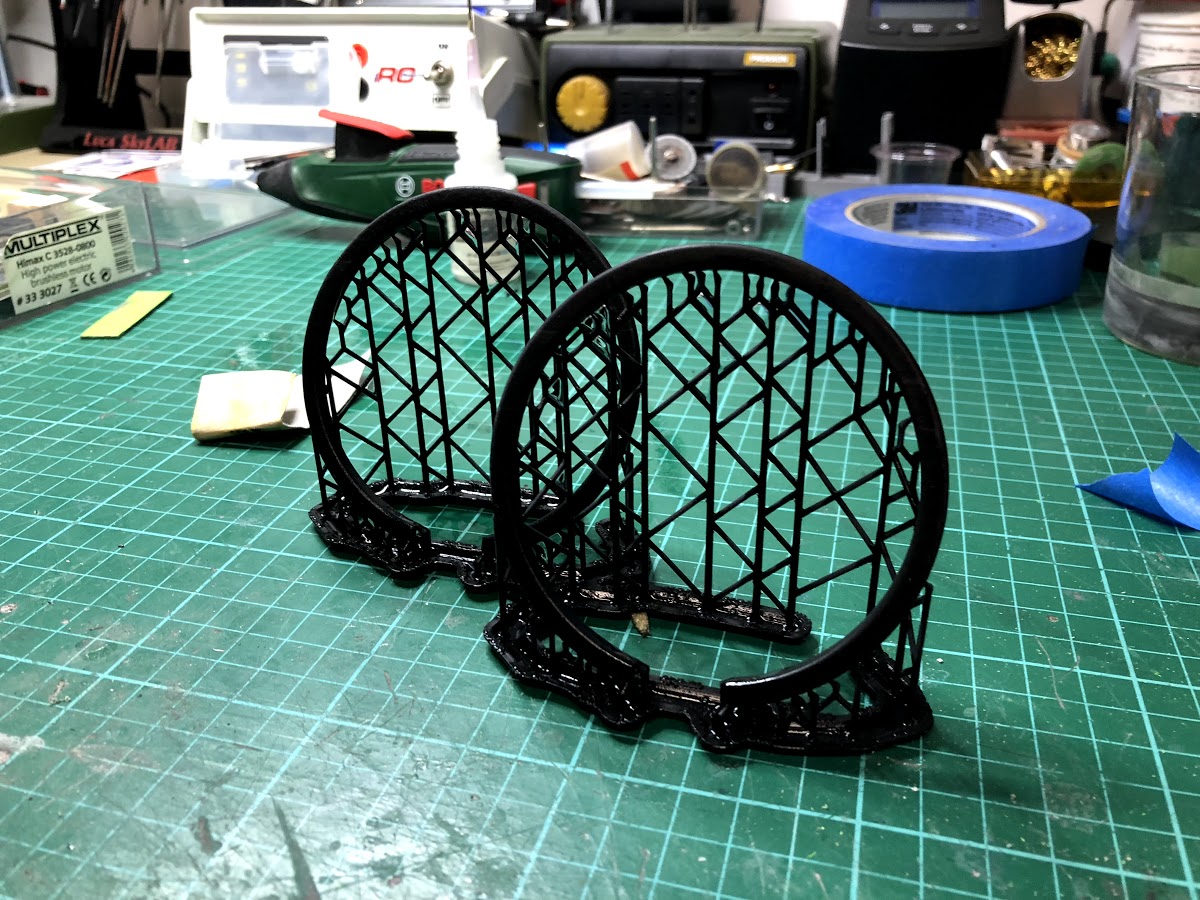

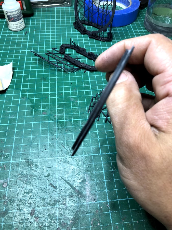

after, I decided to create a frame with 3d print for the wheel arch and another at the base of the horns.
very clean work... I m satisfied

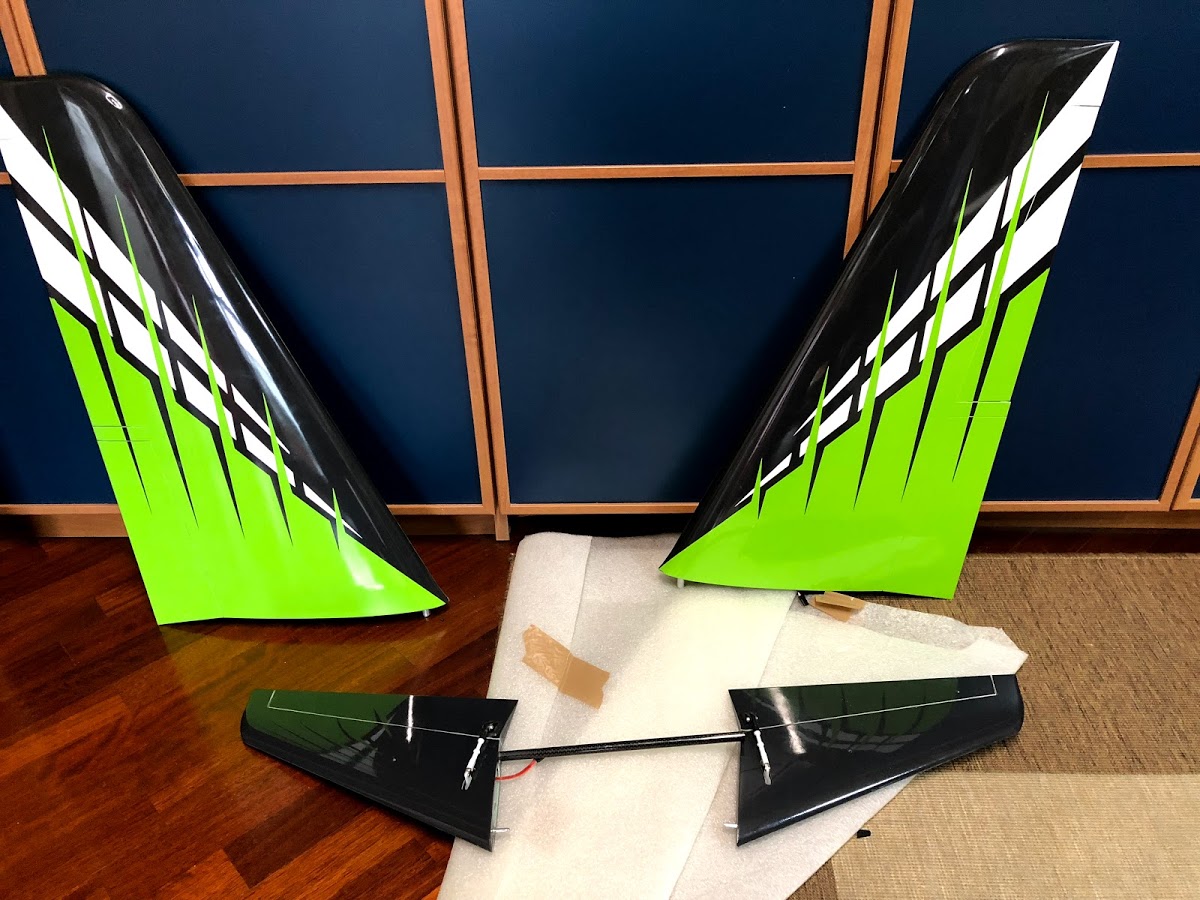

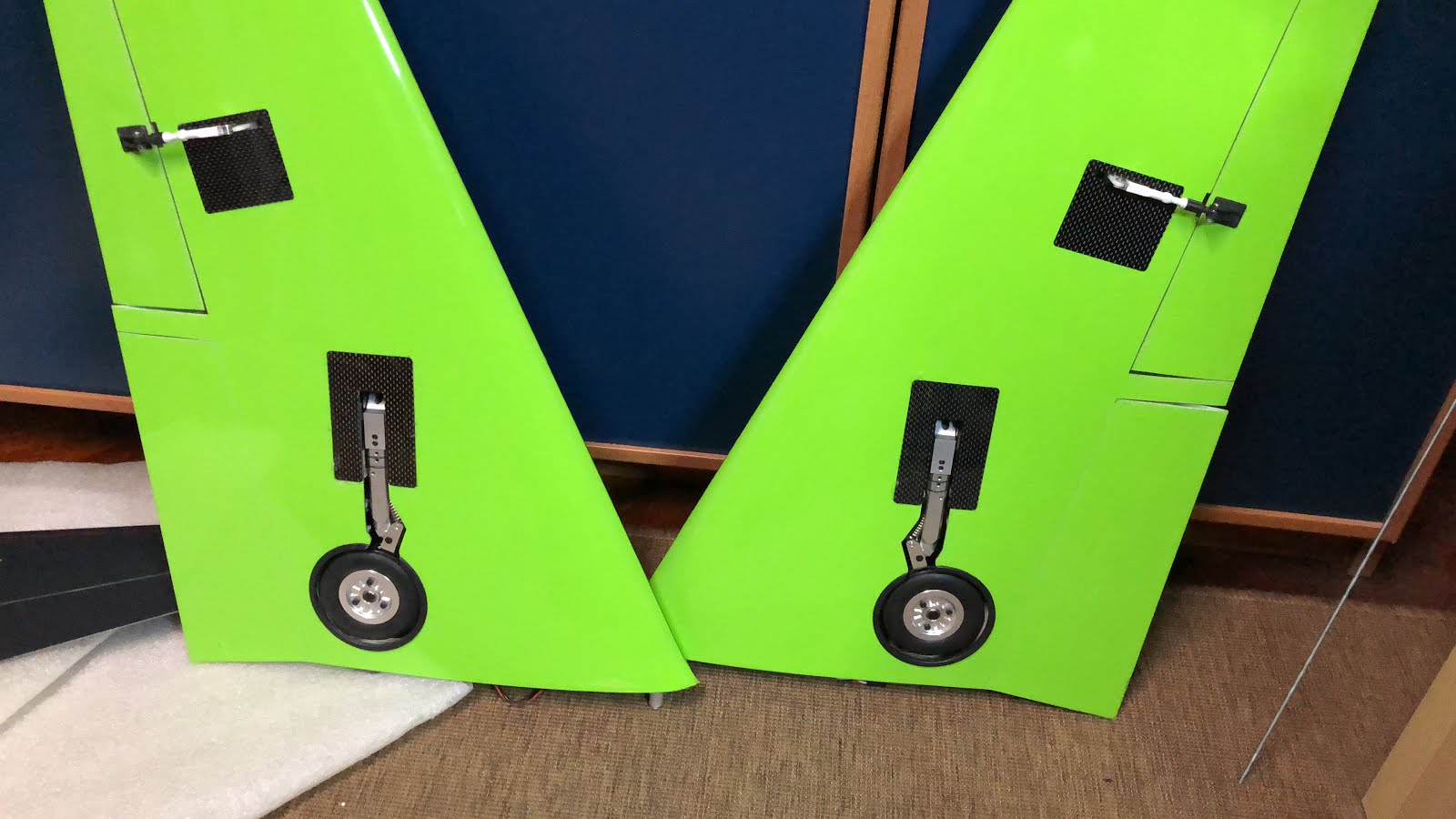

Hi,

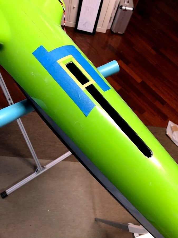

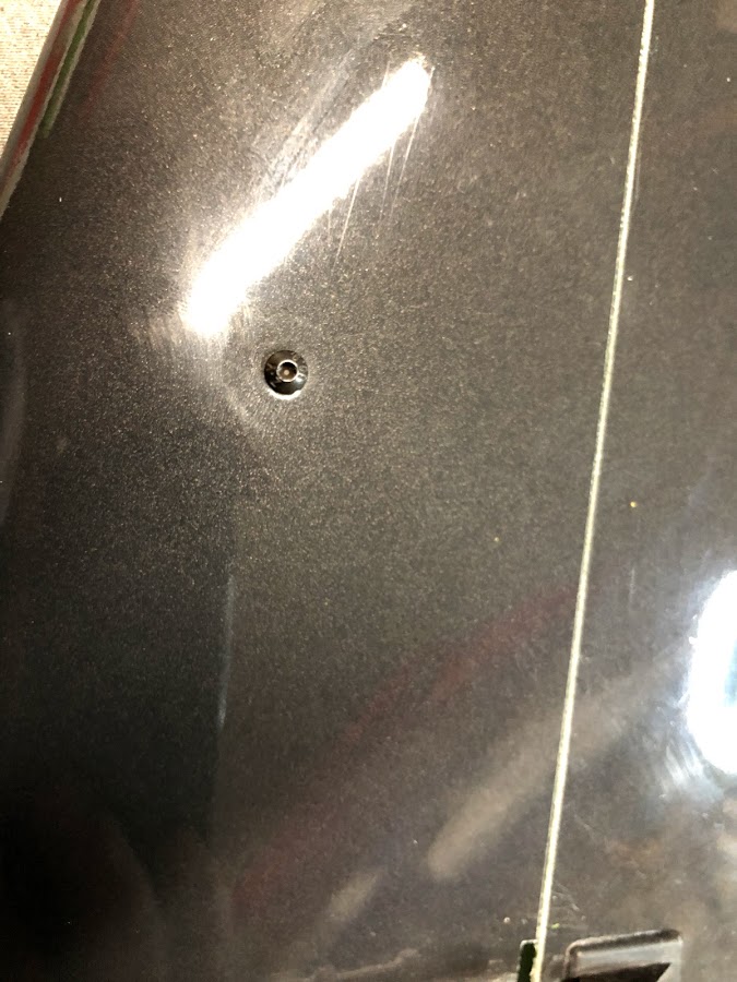

the wing, elevator and rudder is complete...
For the gear, it was necessary cut additional carbon support, because the hole is too close to the edge of the wood...

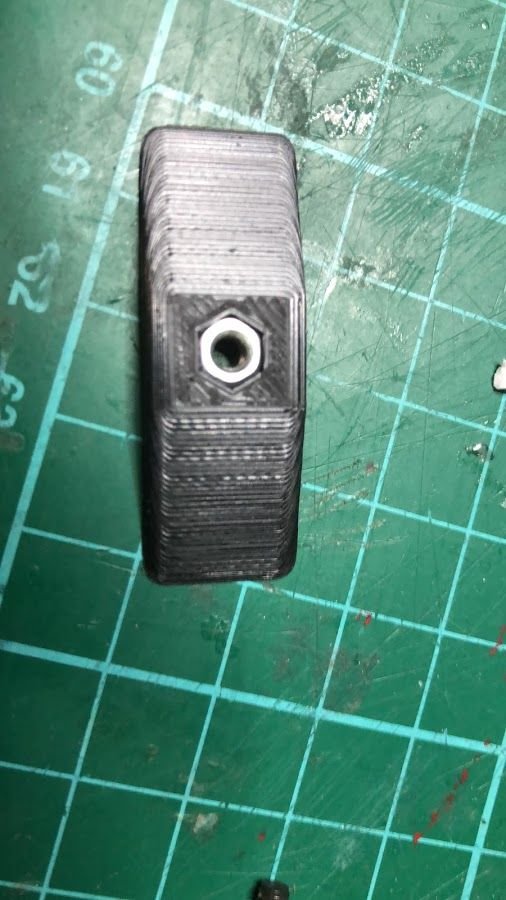

For lock the elevator and main tube, i printed two plug with m3 nuts inserted.
And in the end... I do not like the original cuts, with carbon fiber 0.3mm I cut new servo cover.
The overall quality of this kit, on a scale 1-10.......................is 6
I think because they are the very first model models delivered,
I believe that with time many details will be improved... I hope.

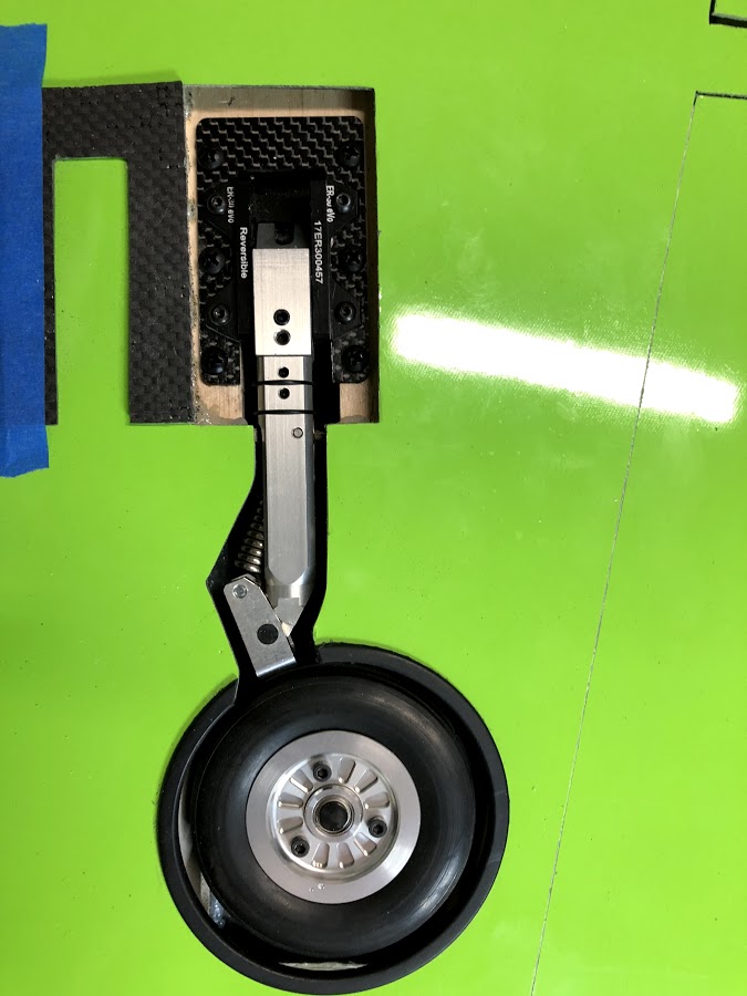

next step... front gear
Old 03-29-2018 | 12:38 PM
Joined: Feb 2018
Posts: 23
Old 03-29-2018 | 12:41 PM
Joined: Feb 2018
Posts: 23

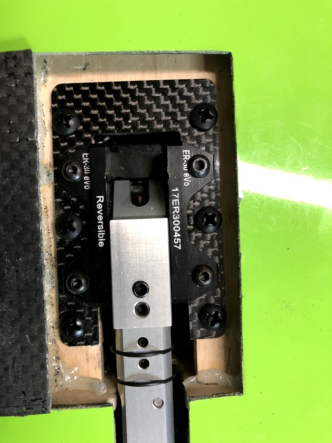

for main gear (electron er30) you need a small servo because if you use the same size of hole... not opening

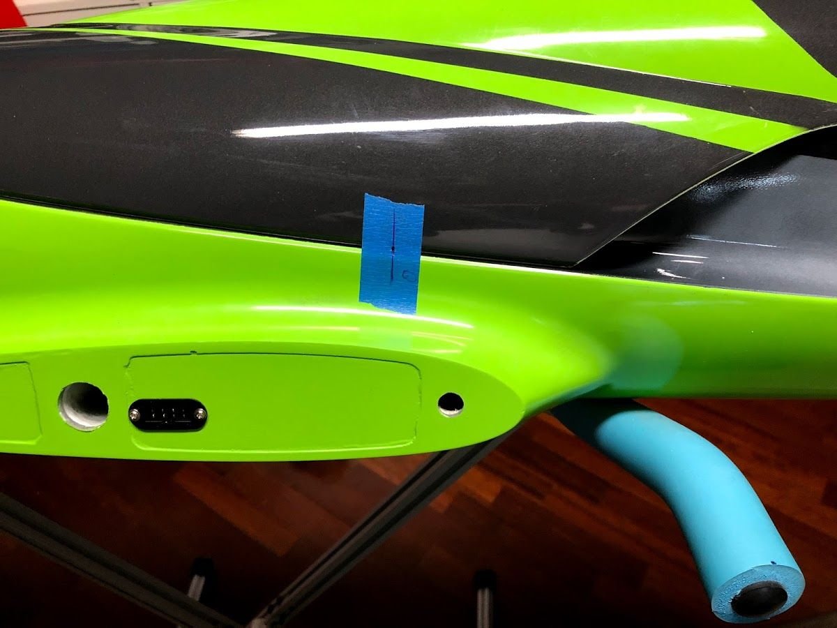

Old 03-29-2018 | 12:48 PM
Joined: Feb 2018

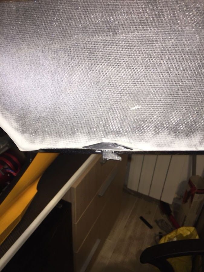

Posts: 23

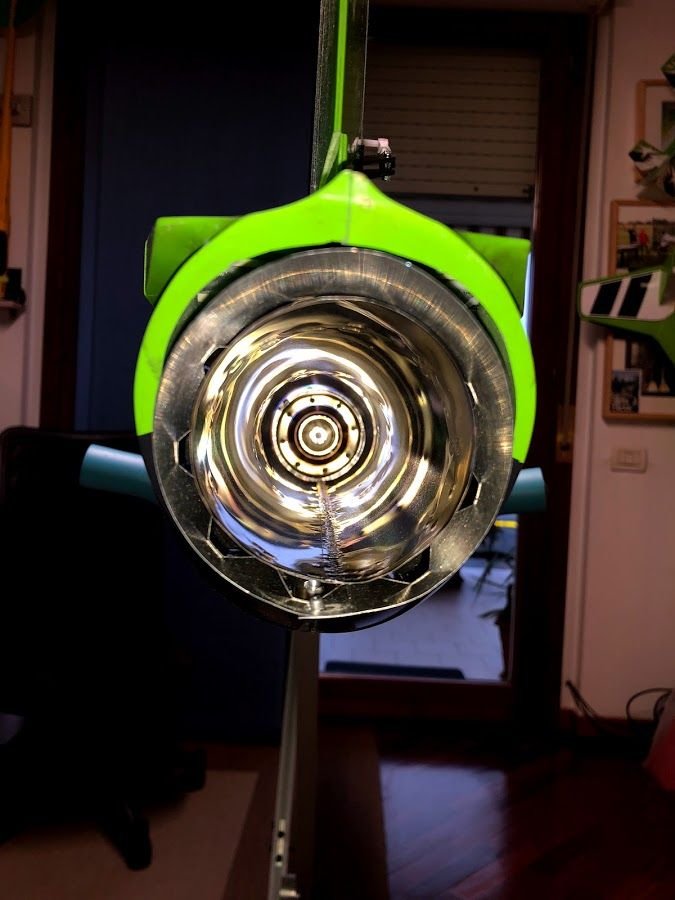

mounting the exaust tube is very difficult, you needs to disassemble for insert and remount inside!!! terrible

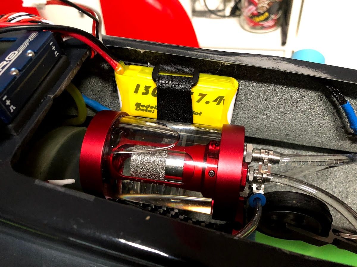

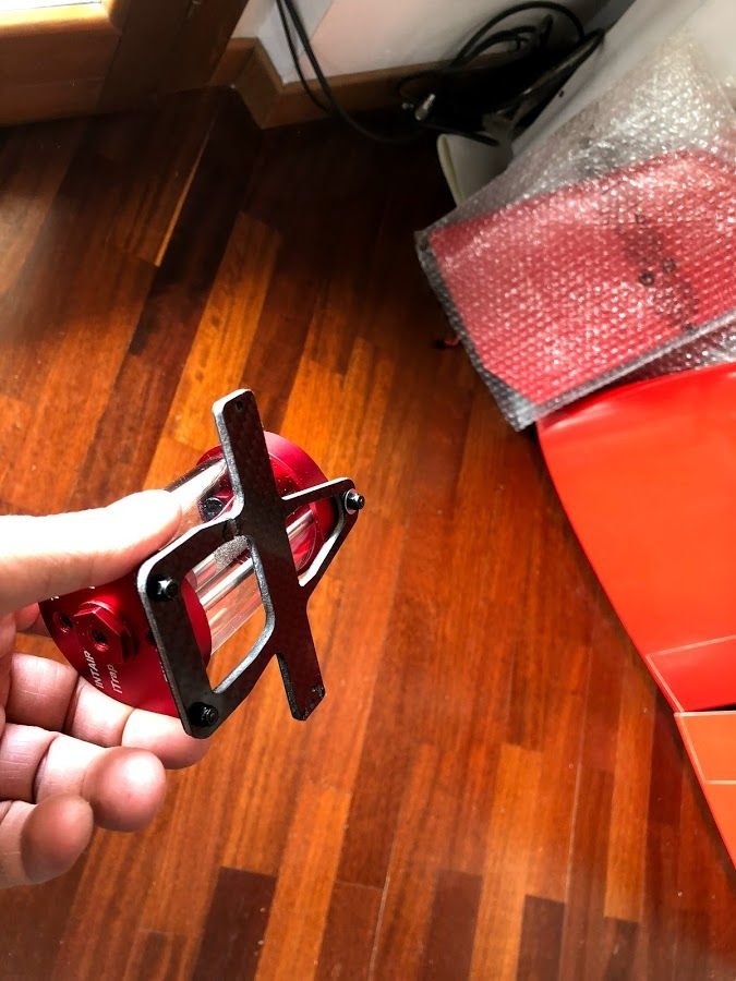

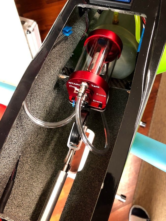

for UAT i create the carbon support
Old 03-29-2018 | 12:57 PM
Joined: Feb 2018
Posts: 23

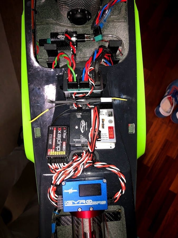

turbine and electronics

Some questions:
- When mentioning 'disassemble', I guess you are talking about the "funnel" part of the exhaust pipe ?
- You are using an I-trap, 40size, as UAT ... correct ? Or is it the mini-trap ?

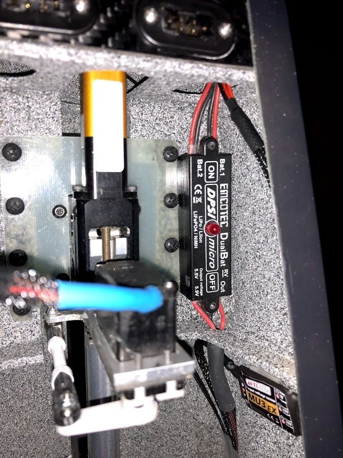

- Are you using voltage regulator / dual input batteries ? If yes which module ?
And last but not least .... you first feelings in flight ?

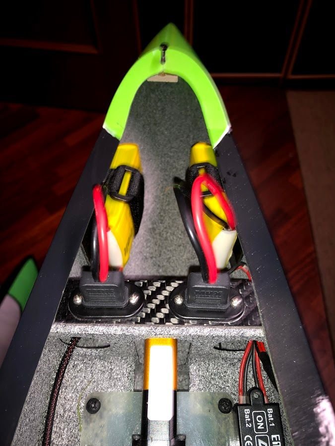

Old 03-30-2018 | 01:46 PM
Joined: Feb 2018
Posts: 23
hi,
1: yes, you need disassemble the funnel from exahust and fixing 3 screw inside, it is also very difficoult to make hole for fixing exahaust support.
2: yes i use itrap 40 size.

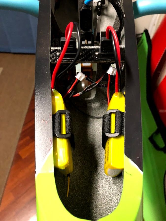

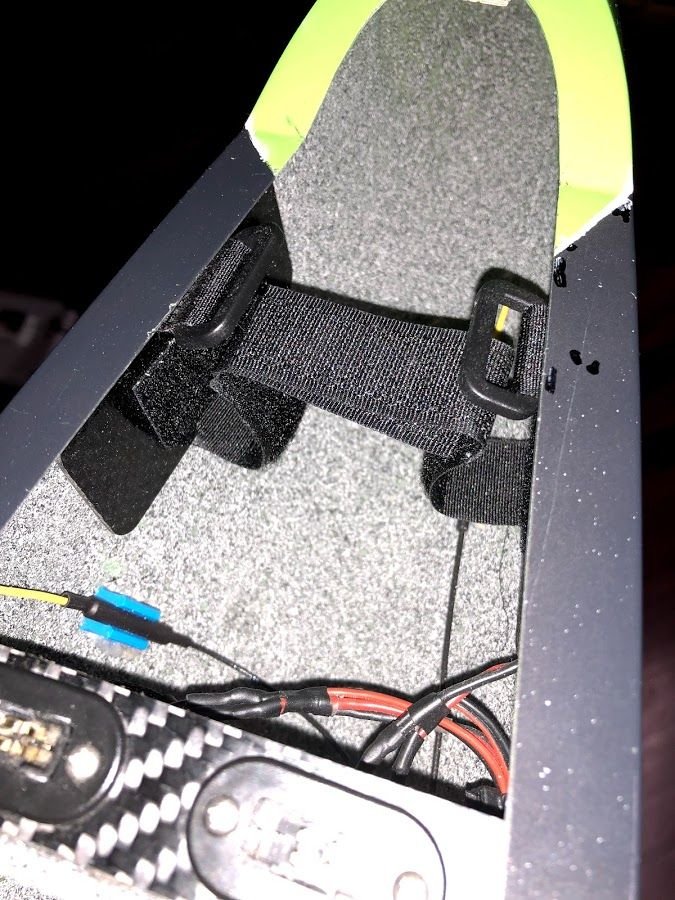

3: I use Emcotec Dualbatt regulator with two 2S lipo 1300 in the nose and another one same size for gear fixing to the side of UAT.
with the turbine battery placed on top of main tube, the CG is perfect.
I try to re-link the videos again...
The model in flight is fantastic, precise at the control, neutral, with K70 the speed is very very high, but when you need to go slow, there i no problem never stall.
I'm very very satisfied.
