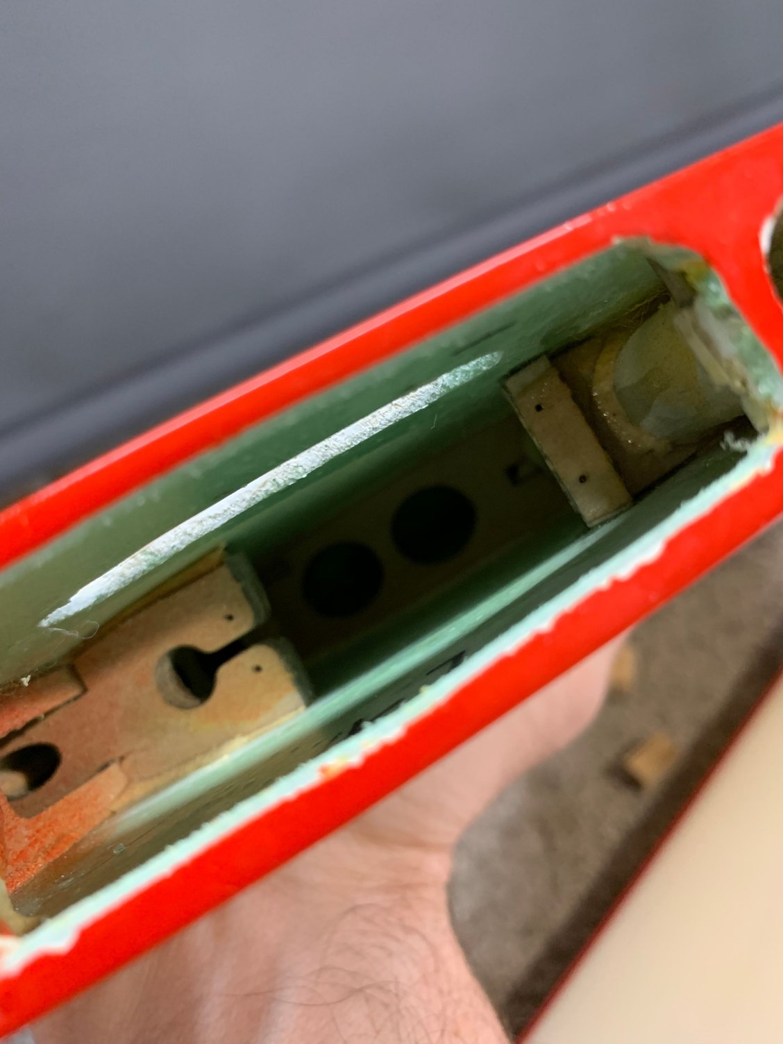

I used Futaba S3071HV all round on mine. Fit into the elevator stab was fine
Jeremy
Old 03-12-2020 | 03:11 AM
  #77
Jeremy_D's Avatar
Joined: Feb 2005
Posts: 1,079
From: Central Coast, AUSTRALIA
found some photos from the build showing the fit

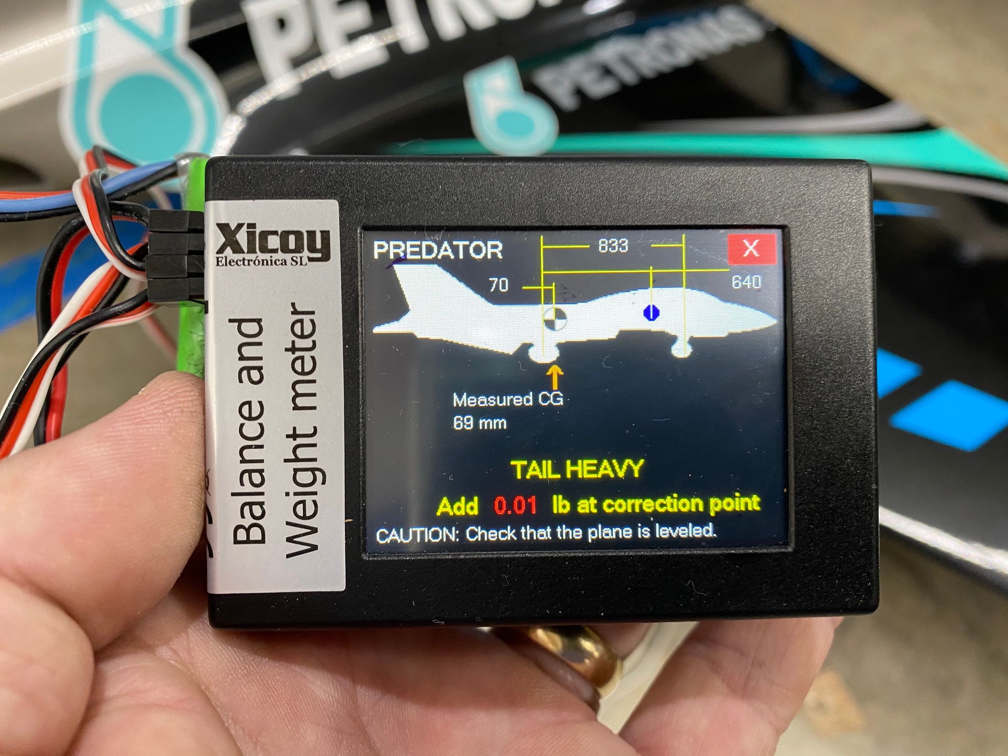

Default Ready For maiden :-)
Nervously exited for my maiden. CG seems to be spot on. Checked it with my EZ balancer and with my Xicoy for good measure.
I did have some trouble with my wing tube being a little loose. Anyone else have the same ?
great looking install, best of luck on the maiden! FWIW, my wingtube isn't loose at all. Snug, but not overly so.
also...just noticed that your gear is down. I thought it was to be balanced with the gear up.
Old 03-27-2020 | 06:09 AM
  #93
sipixx's Avatar
Joined: Dec 2014
Posts: 40
From: SC USA
Thanks for the heads up. I did measure the CG gear up and down.

Default Pilot rc 1.8 Predator
CG & Total Weight
Defiantly gear up for cg. The shift in cg is quite surprising when the gear drops.
good luck with the maiden!!

Hey Guys, I have been thinking about the cg... According to the video from Pilot they balanced the Predator with the gear down (the red and white plane). I balanced mine with the gear down using the xicoy balancer and a full UAT (I am about .1lb nose heavy) and just like the image Jeremy posted I have to add a little up elevator for level flight. To me everything looks good. My area just went under quarantine so, therefore, I have to wait a little while before I can get to fly. So take videos so I can enjoy some Predator flights... and enjoy!!!
