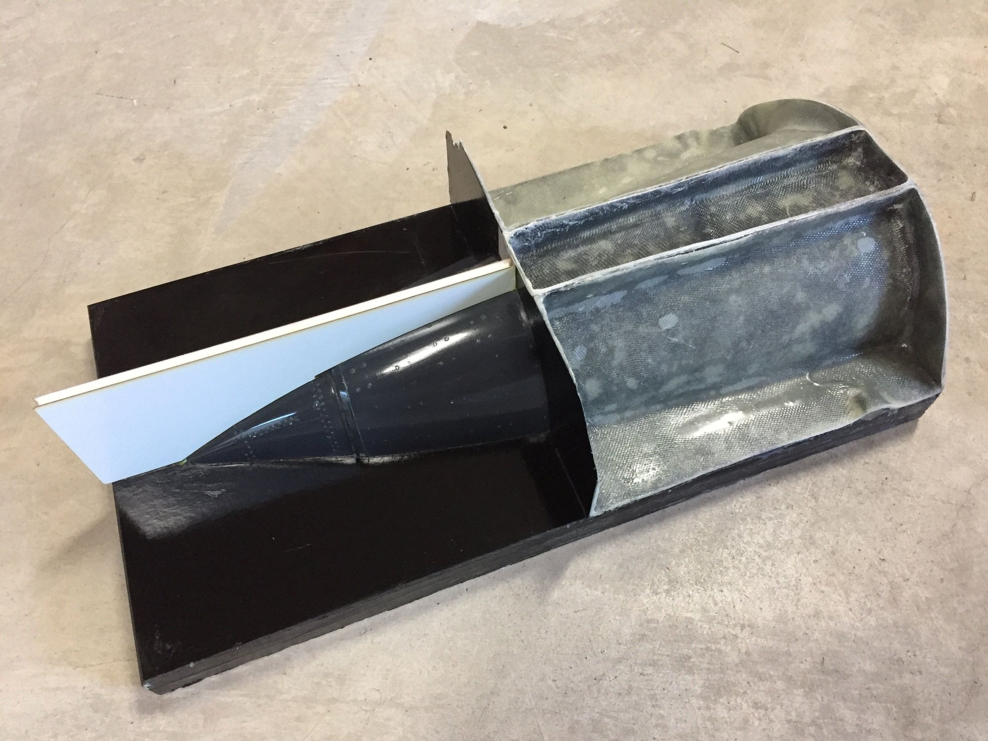

I finished the second build of the speedbrake plugs and started on making the molds for one of them. I have the parting plane made and the surface coat applied. Should be able to get the glass down later today.
I am using wax & PVA this time as it seems to handle the raised surface detail much better than the Frekote. I am only going to work on one at a time so if this attempt fails like last time I will only have to make one speedbrake petal, not both. The outer surface molds will be multi-part to help them release from the plug.

First half of the mold completed. Looks good so far. 6 layers of 9oz glass for the mold.
It can sit all week before I work on the second side as I'm away on a work trip.
I laid the surface coat down at 08:30 this morning, and by 16:30 the glass/ epoxy had cured. 90F+ in the garage certainly has some advantages.
Paul
Paul

After what seems like ages, here's an update. Slow progress due to work, vacation and it being over 100F in the garage which slows progress significantly.
I continued with the speedbrake mold, finally ending up with a usable set for the first half. The plug did split as I was trying to free it from the base mold part, but no damage to the mold.
I just have to do it all again for the other side.
