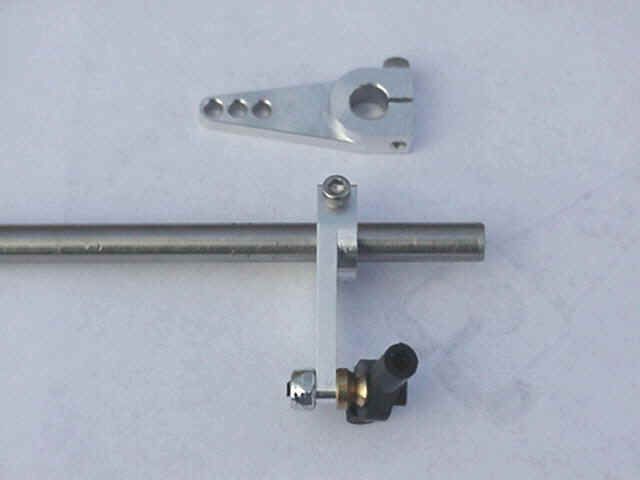

im looking for something like this
Old 11-08-2018 | 08:10 AM
Joined: Nov 2014
Posts: 106
but double ended

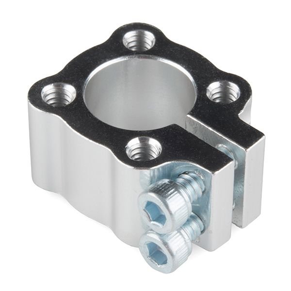

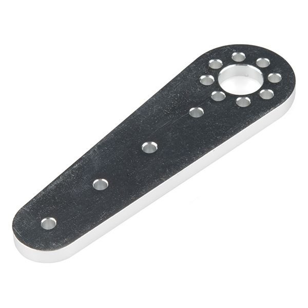

Use robot parts by a company called Actobotics. They are easy to find at robot suppliers. Servo City also has them. I considering them for the stabs on my F-105 project.
Get one of these hubs and bolt it to the arm below. They are like erector set parts and all fit together. The bore sizes are common sizes. 3/8, 1/2" etc.
Some links:
https://www.sparkfun.com/products/12177
https://www.sparkfun.com/products/12519

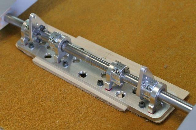

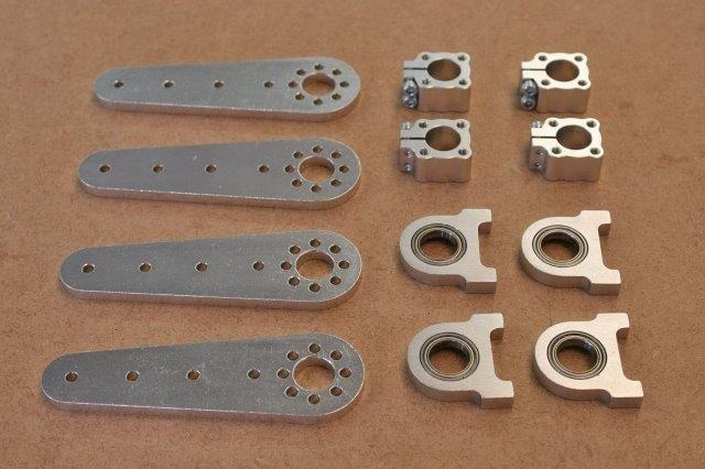

Here are some parts used to put together a stab system I am looking at for my F-105 project. These photos came from Fighteraces in the UK who gave me the idea. All Actobotics parts except for the aluminum base.
Gary
