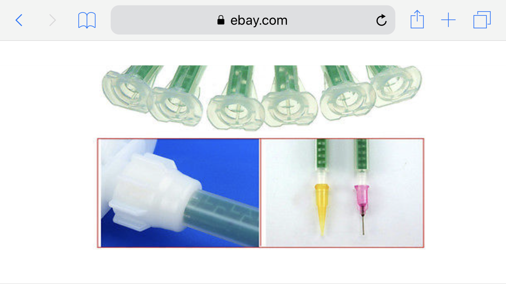

Hi you could use the regular small size mix tubes just install them inside the plug ,I’m usually mixing the glue on the side with wood stick.

I never use the mix nozzles because you can’t see what’s going in the nozzle. I always dispense on a paper plate and mix like regular epoxy. I have never had a hysol glue joint fail!

If the nozzles weren't so wasteful I would use them. I've never used Hysol but have used West Six10 for years. Lately I've been using the Jamestown Dist. version too.

Flush the epoxy out of a Nozzle sometime, you waste so little I stopped worrying about it years ago. The insert fills most of the small tube. Squeezing the glue into many joints is what makes them so good, fillets are just a bigger waste of glue and added weight.
