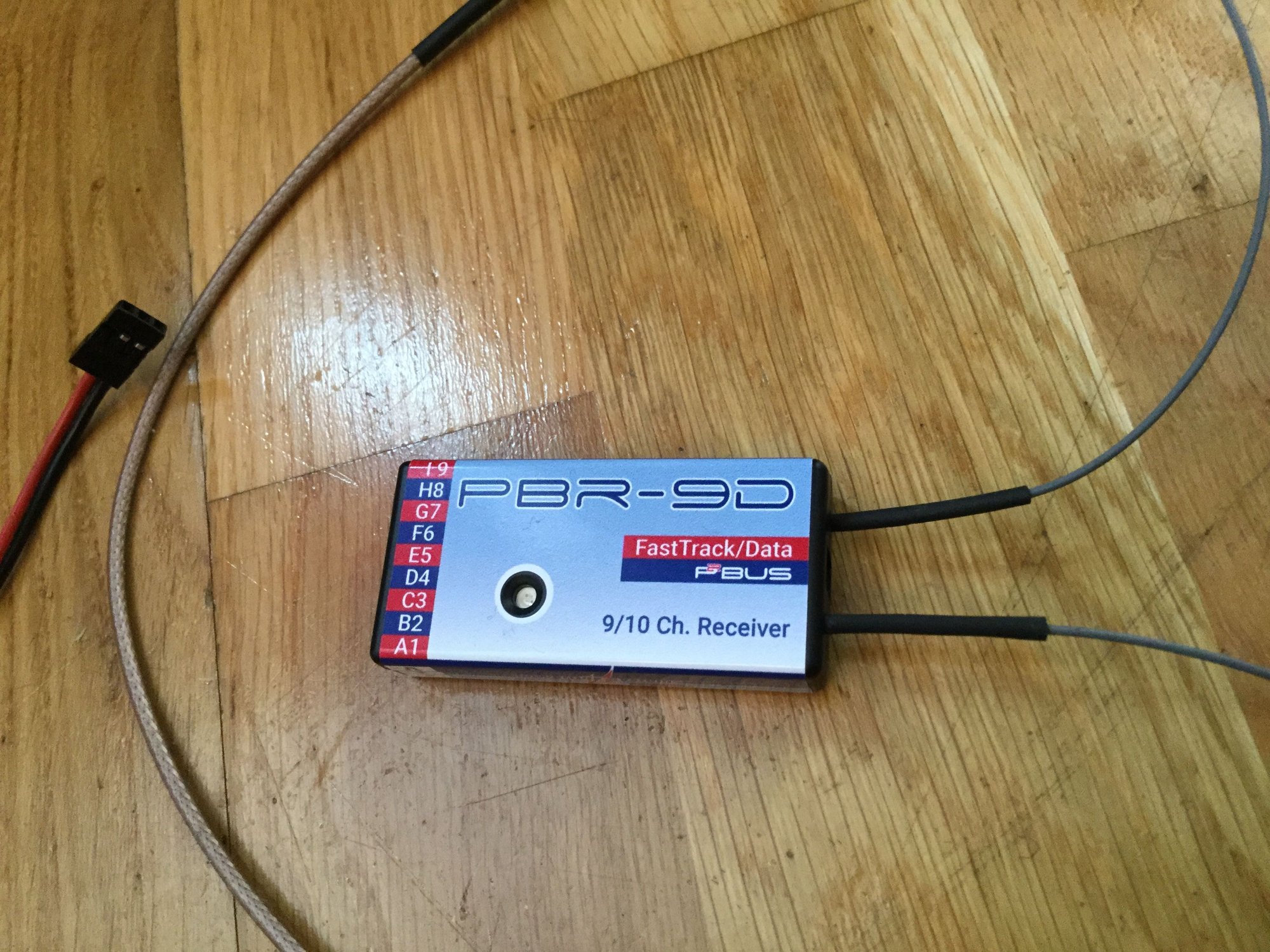

As some of you will remember I added patch antennas to the Weatronic Micro Rx’s...well I like to fiddle...
Swapping over my Extra to CORE which has patch antennas all installed so wanted to continue to use them as dB figures returned off the Weatronic system have always been excellent...

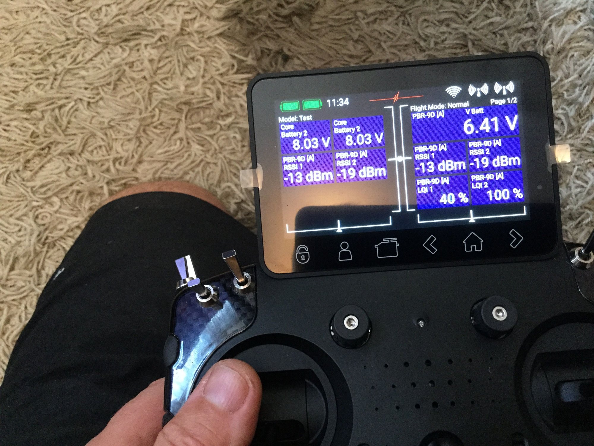

Why the differences in Q and dBm between the two in the photo?

Hi David hope your well, I have done range test with the 9ch temporally plugged into my extra but with both antennas screwed into the existing two patch antennas in the aircraft etc. I have not yet set up program so just had rudder set up so I could do range test etc the only issue on the core whilst conducting the range test is you cannot view the RSSI figures or LQ etc which is a shame. With the range I got under test condition I would have no problem in flying with the 9ch Rx hooked up to the patch antennas. Richard did tell me that they have made the Rx more sensitive and he did not know if patch would improve or not etc but he did ask me for results which I have told him the results of ground range tests. Should not be to many weeks before I get chance to change over completely.
I have installed my Core for test in a Elan I brought for testing etc and have a mercury SRS with PBR26 and it had first flight the other day with everything being fine.
Going to install another Mercury SRS and 2 x PBR26 and CTU unit in my T1 jet also installing Power Expander with PBR26 feeding Powerbox into CARF Hawk...
I am still flying my Graupner MX24s with DV4 module with all four wires internal going up inside of mounting shaft ie no external patch lead at all, this also working faultless.
I really like the CORE!

LQI is quality etc reason of 40% I had Tx a bit near to Rx and it was simple case of being over swamped. Normally you would expect this to be as high as possible but I have set alarm to go off at 40% and 45% in the Core. Also when I was testing and took photo one of the patch antennas was actually upside down and one was right side up! Not ideal :-)
dBm is showing the strength of signal ie the typical antenna you have on a JR/Futaba/Spekky is normally a 2db gain antenna. If we see the output attenuated then the dB figure will alter. The Core uses patch antennas same as the Weatronic did achieving 180deg perfect radiation from antenna, these antennas achieve a greater all round output with no ‘squashed doughnut’ radiation patterns such of those from the end of a normal dipole antenna. For example if you cover the top of the patch antennas with your hand you are attenuating the output hence the change in dBm figure.
Hi
Something still doesn't seem quite right
It appears as though the Rx with the lower Q has a higher signal strength while the other Rx has a higher Q and lower signal strength.
What am I missing?

Originally Posted by ltc
Hi
What am I missing?
Yep, that is very strange, indeed. We have never seen a similar data readout on our Weatronics.

Dont worry about it. The Pb receivers are set to a higher sensitivity than Wea and with extra sensitive patch antennae and being close to the Tx there is probably some swamping.
I have noticed occasionally that my Wea receivers, paricularly those with patch antennae, give a slightly odd behaviour when the Tx was very close. Never a problem in flight, or even when moving the tx a couple of feet away.
I have just tried my Core with the 9 channel receiver. When the tx was within one foot or so of the Tx the RSSI and LQI values were all over the place. Moving to about three feet all was perfect,, RSSI S around 18 and LQI at 100 % .

How close were the 2 Rx and patch antennae to the Tx?

The Tx power is so high anything closer than 2’ will swamp, actually it’s a good way of testing the failsafe without switching the Tx off.
None of this is new, even Spektrum does something similar if you switch on with the Tx close you can see the remotes flashing sometimes where they have been swamped.

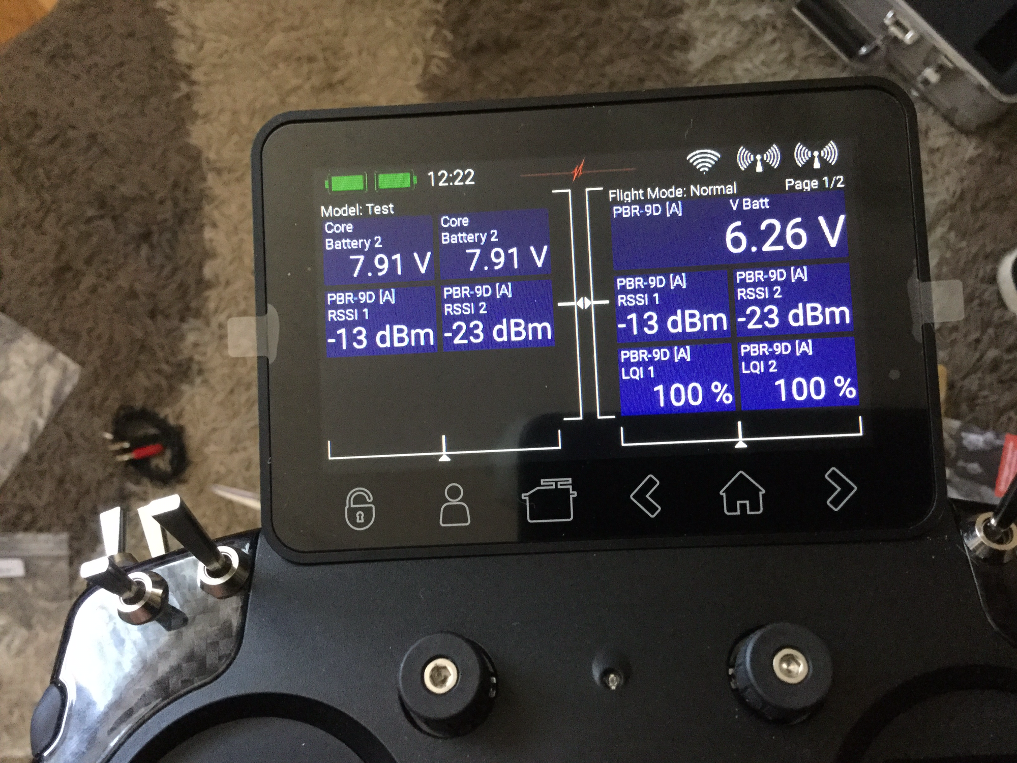

This is another pic that’s was taken whilst doing same test note about 40min later note Rx voltage drop only on small Fe batt etc
Hi Oli
When I took that first pic the Tx was very close to Rx antennas and as I said one was facing face down on rug the other facing up...soon as I moved Tx away a bit all figures were normal.
Look the only reason I have tried this as I have told Richard is pure curiosity and as I had frameworks/assemblies installed for patch antennas in certain models I decided to use them. The RSSI figures are good and I agree with Dave there is no need for them but as with the Wea the system performance was good without the patch. The range test as I said with the patch was very good and this is purely an exercise.
