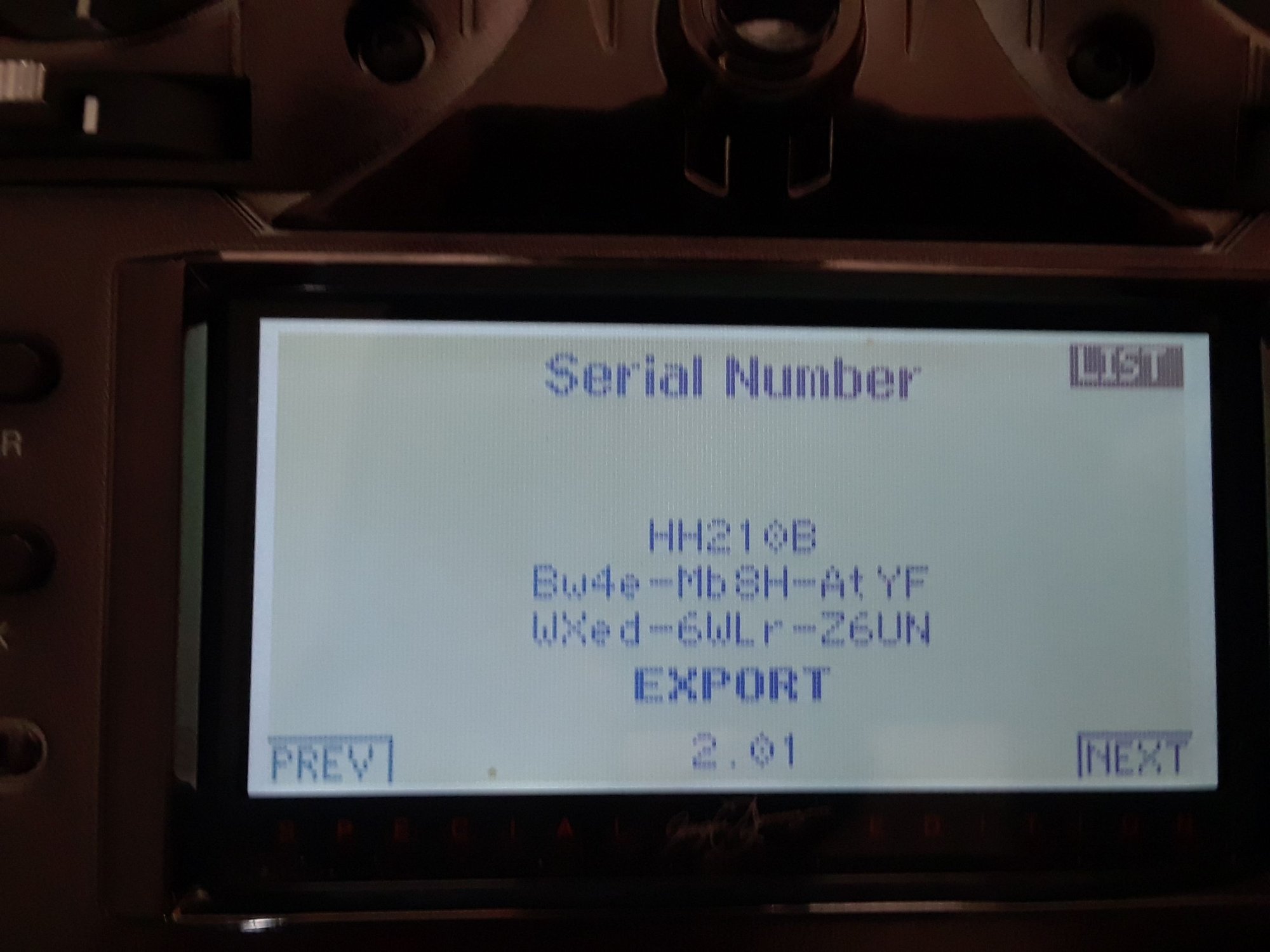

That's exactly what I was told, I was also told that the radio may have a bug and will have to update the software to v2.01 to get the fix.

I'm at v2.01 for the TX, and v1.6.45 for the RX. Once I got plugged into the correct numerical channel everything worked fine.

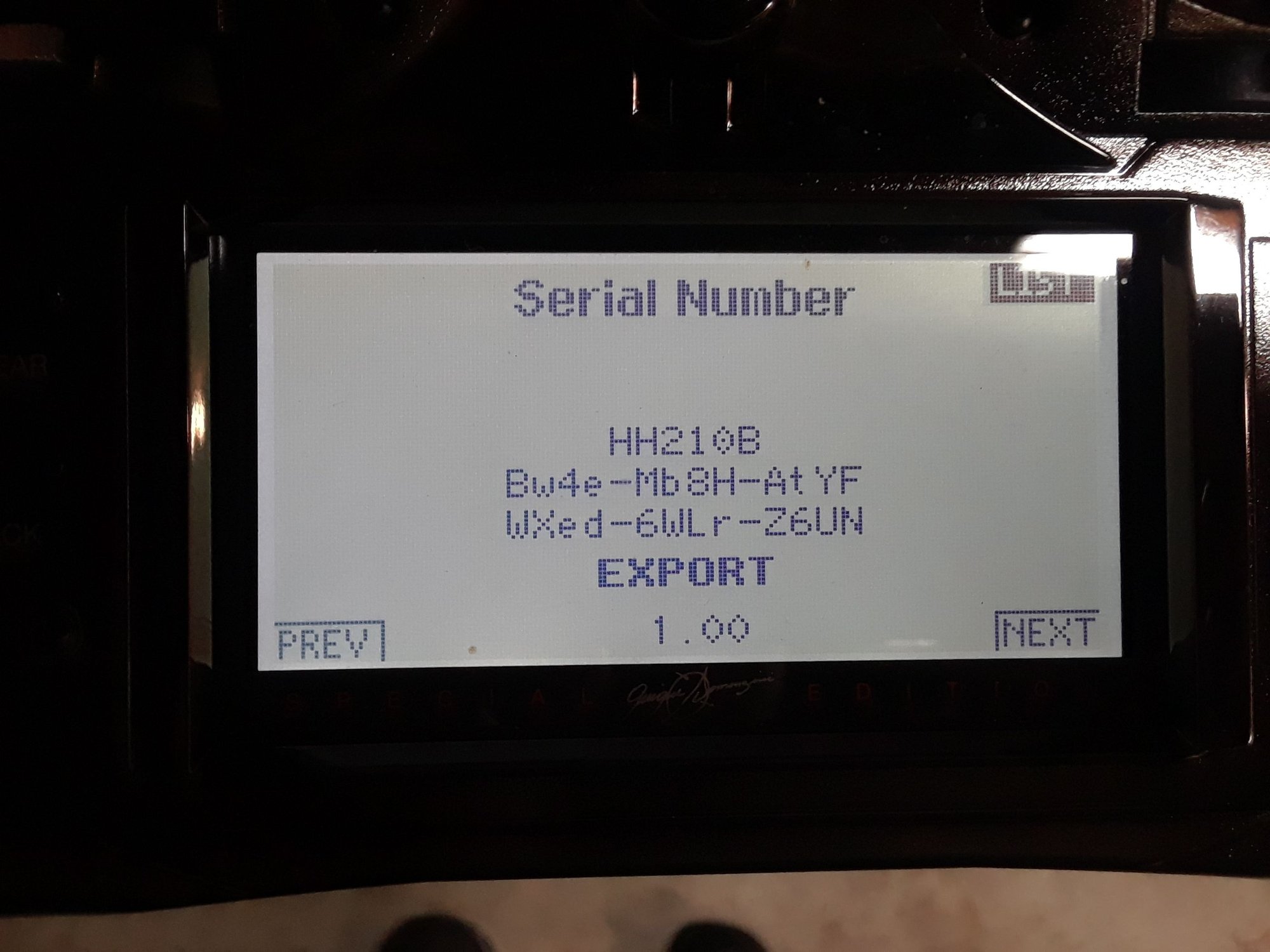

Is this the page that shows the software version on the transmitter? if so, then I'm looking at V1.00, correct?
Old 08-13-2019 | 10:13 AM
My Feedback: (49)
Posts: 2,987
Received 20 Likes on 18 Posts
From: Plymouth, MI
Yes, you're at v1.00.
Also when you first turn on, or turn off your TX, the version number is displayed in the upper right corner of the screen for about 1 second.
If you haven't already, you need to go to https://www.spektrumrc.com/MyAccount...2fDefault.aspx
and set up a "My Spektrum" account in order to register and update your TX and RX.

Yep, that's dinosaur egg old Carlos
Export that SN to the SD Card and use it to register, its pretty tedious to type it in and get it correct, you have the option to upload it from a card or local file during registration

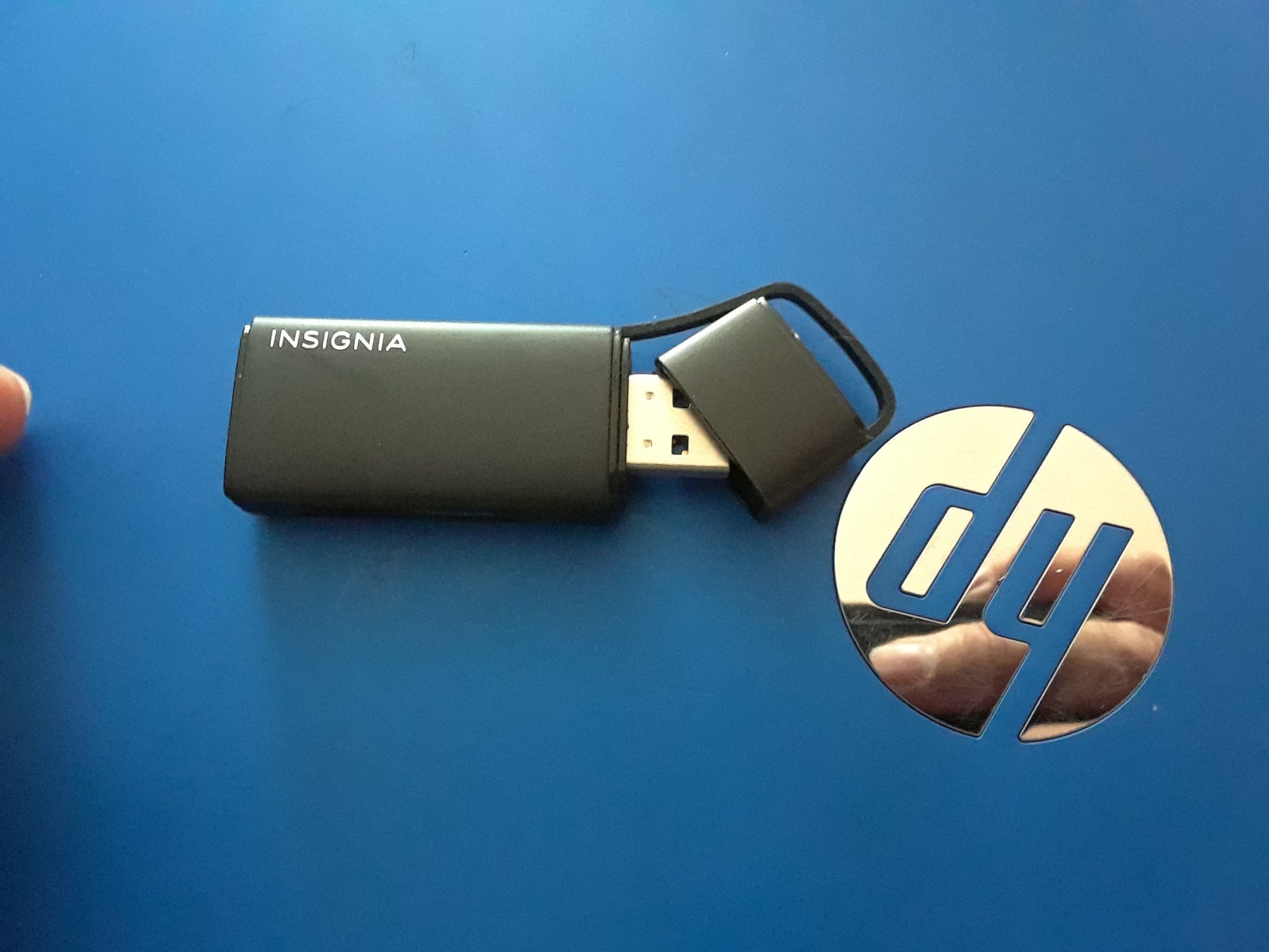

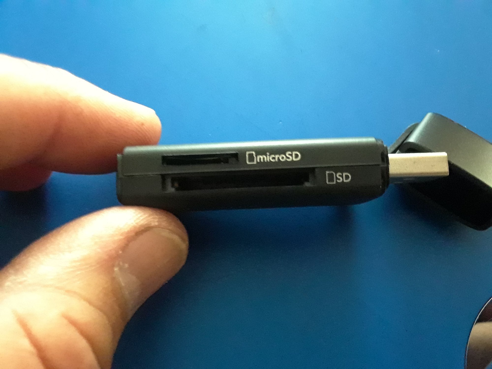

I finally got the SD card and I also had to get an SD card reader with a USB adapter in orser to get the job done, my laptops don't have card slots, about $25 for both at BB.
Thank you to all for the suggestions.
