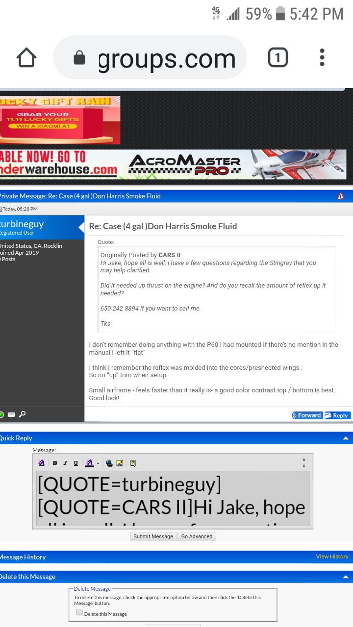

Better it climbs on power then duck under ...
I might add a few degrees. But I will wait if you can come up with any info.
For sure it needs reflex for takeoff... So, upthrust can only be good.
It seems she ducks under in turns too, signs of no up thrust. Me thinks.

I would abandon that mount and go to the tab and strap type. BVM makes them (it used to make them). As you suspected you want the thrust line much lower.
I ran maybe 1/8 inch reflex but I don't remember exactly how much. Your speed brake rigging looks perfect BTW.

Here is what my friend said and I agreed on the suggestion of the mount from BVM, I used that mount, the more precise you build it the easier it will be to fly, I also agreed on 1/8 reflex up to start with.
On my Kangaroo I took half of the reflex up today, that's after 3 flights, it will take around 6 flights to get all dieled in.

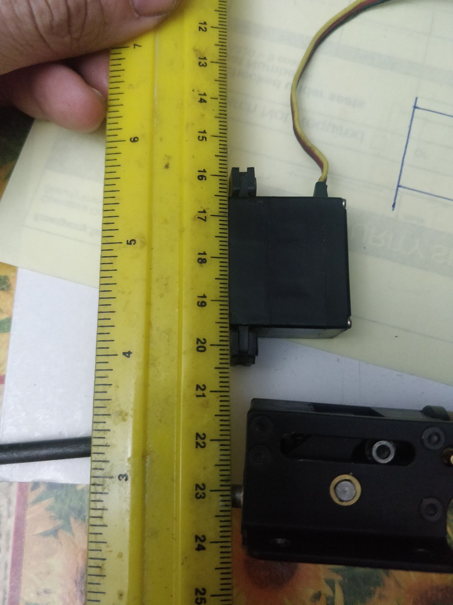

So, one stupid question....
Anyone use a 3/8 robo strut for the nose???
I want to order the servo plate too to remove pull pull.
But... How the heck do the 3/8 robo strut get hooked up on a nose wheel retract?
Can I use the servo plate with a robostrut at all??
https://robart.com/products/550sbd-steering-servo-mounting-bracket-mini-servo-7-16-strut-1-4-axle
Servo.. gear up..32mm
Servo.. gear in transit..32mm
Servo.. gear down..32mm
