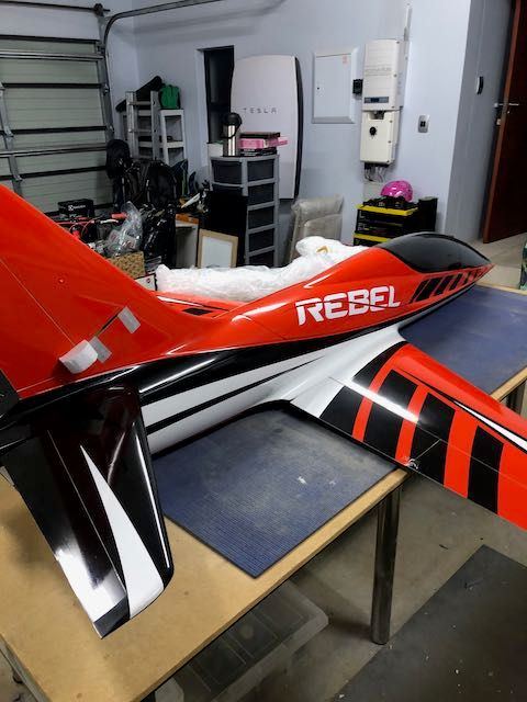

Old 05-09-2020 | 12:46 AM
  #92
Joined: Aug 2005
Posts: 72
Received 14 Likes on 8 Posts
From: Skerries, Republic of Ireland
Some pictures of mine. Must say the quality is pretty spectacular. CARF have done a good job.
The following 5 users liked this post by jamessymons:
bodywerks (05-09-2020), camss69 (06-20-2020), Desertlakesflying (05-11-2020), Kenrico (05-09-2020), paulhat (05-09-2020)
