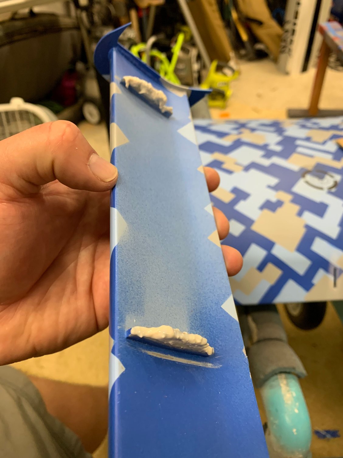

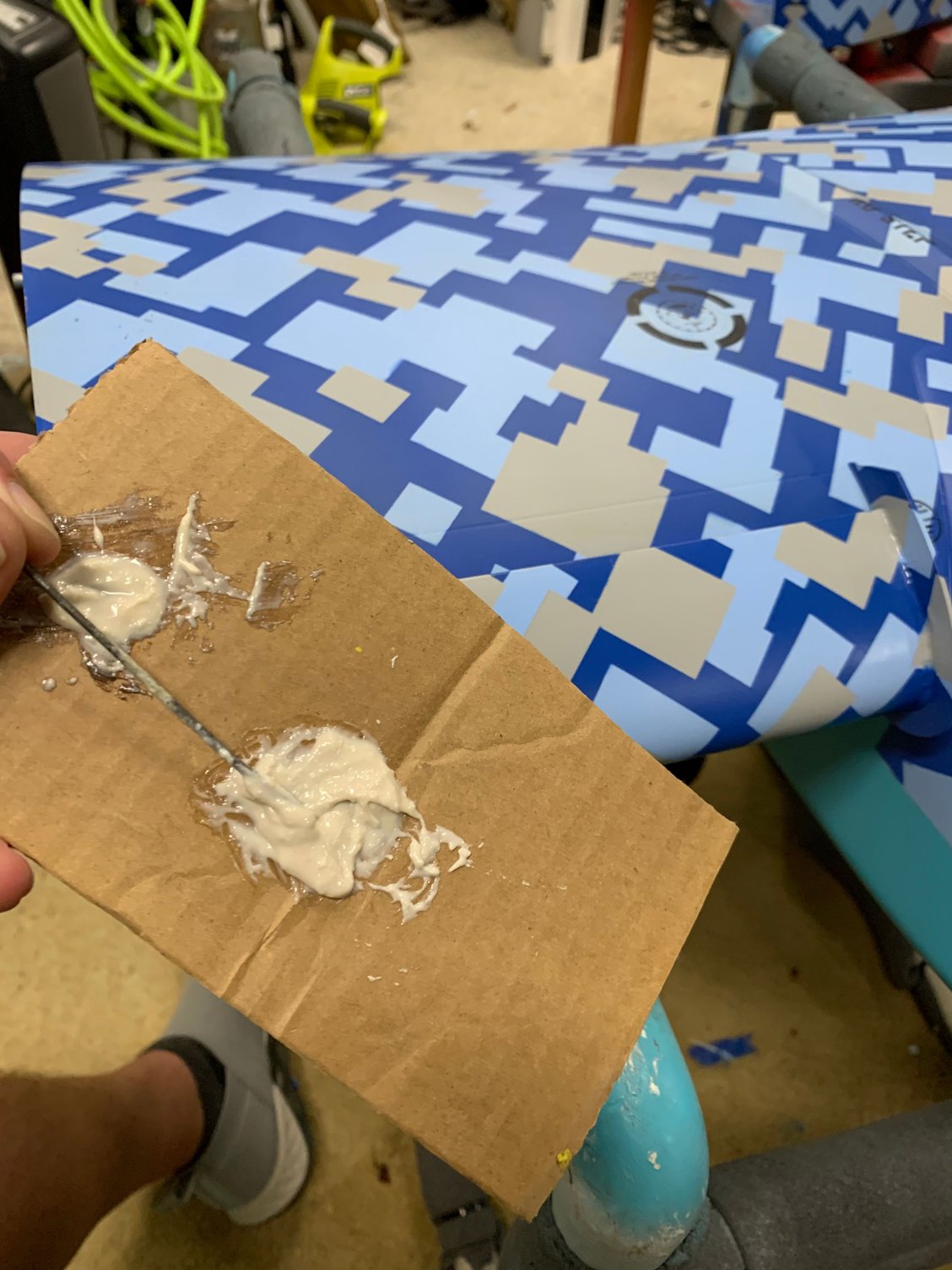

This some hysol I just used last night. It’s holding just as hard as it always has.
And yet, I don’t know why it can clump up?!

I’ve been using 9462 for 20 years. Even when past date, it has worked fine and was smooth. Every cartridge I have bought for the last 2+ years has been clumpy. I have a local friend that works for them. He has actually replaced a couple of my tubes with fresh tubes right from Loctite ( they are local to me) and the same clumps. He does not know the reasoning, but says not to worry as it will cure the same strength. If using mixing nozzles, I submerse tubes in hot water for 10-15 minutes and it smooths right out. If mixing on cardboard, I just hit with heat gun for a few seconds after mixing and it smooths out also.
