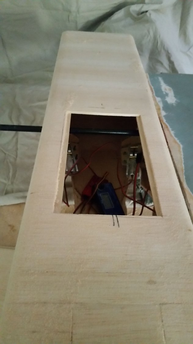

Some more progress has been made! I decided to glass the outside of the fuse to add strength and fuel proofing, and as an aid to paint. That took a couple of days. I then attached the wings. I almost painted myself into a corner there. I had projections at 90 deg to one another where they were to slide together. I have a carbon fiber spar six inches into each wing and across the airframe. I also have aileron torque rods on each wing. I solved the problem by bending one of the torque rods enough to slide through a slightly enlarged hole in the airframe side, then straightened it back up again after install.
The servos are a little out of alignment as I had to install them in the blind. I had to reach in from the hatch and from the rear at the same time to glue them in place. This left my nose at the top of the middle of the airframe. I tried it with a mirror as a last resort and this is what I ended up with. They work fine so I'll leave them as is.

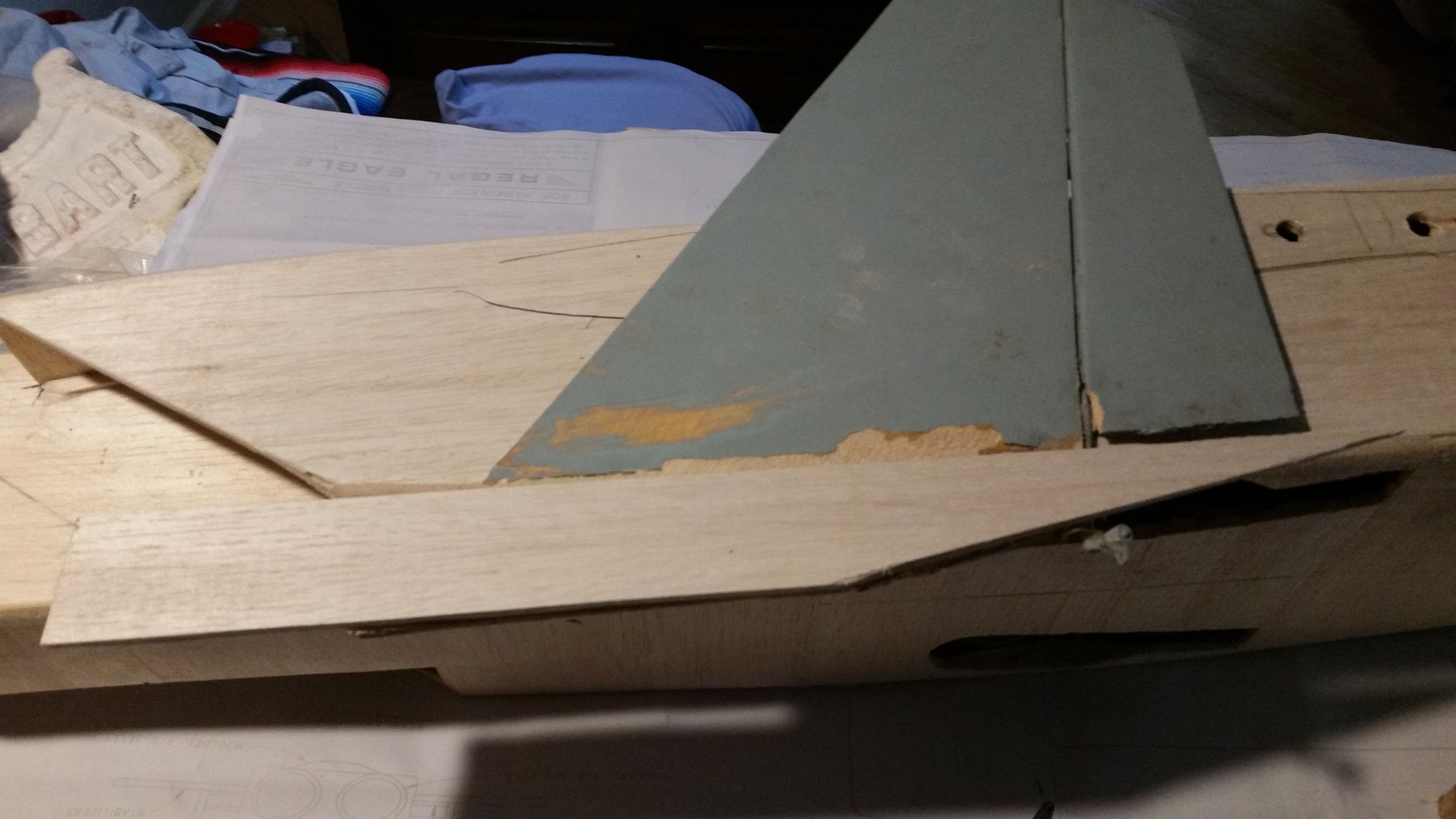

The next step was to build in place the booms.
They build up against two alignment pegs in the side of the fuse. The horizontal stab glues to the bottom of the boom.
I used a sheet of balsa clamped to the stabs as the epoxy set to make sure the surfaces are in alignment with each other. The next step is to install the elevators and their torque rods, which I am awaiting in the mail, then the vertical stabs and rudders. The rudder servos are buried in the booms as well as their linkages and I will be working on those for the next couple of nights. I can then sheet the sides of the booms and the extension of the booms on the bottom of the wings. I decided the elevators I had hoped to salvage were not sufficient so I have made new ones. This brings the cost of this build up to about $95 less the hardware I am replacing and the electronics I decided to upgrade.

The next part of the process was to build the stabilizer booms. These have alignment pegs on the prints matching the alignment pegs for the wings to keep the angle between the wing and stabs correct. The bottom alignment boom part glues to the bottom of the pegs with the angle cut in the part even with the rear of the balsa fuse.
This bottom alignment piece gets sheeted completely over in the process while the top one is the finish surface of the boom.
The top piece is cut and flushed to the top rear of the wing core. Then the bottom of the boom is extended along the bottom of the wing and terminates at the thickest part of the wing making a box structure. The horizontal stabs are glued to the bottom of the lower alignment piece then the box structure is built fore and aft of that. Since I am using torque rods for the elevators I don't sheet the lower aft portion of the boom till the torque rods and elevators are installed.
I used a straight edge across the hor stabs to ensure their alignment while the epoxy set.
The fins are then glued to the outside of the box structure, and the servos for the rudders and linkages are installed inside the boom structure. I zeroed the servos during install as I would have to cut open the side of the boom to change their centering.
