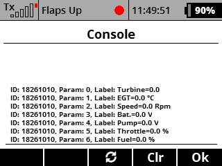

I use the Xicoy telemetry adaptor to display ECU info on my Jeti DS-24.
I would like to write a LUA script that displays the ECU status messages (User Off, Pre-Heat, Running, Cooling etc.).
The ECU Status message is not registered as an available output from the ECU adaptor.
As that info is available via the Jetibox, I presume that it is available somewhere in the low level telemetry adaptor data stream.
Does anyone know how to access the raw output from the ECU TM Adaptor?
And no, don't suggest I just buy a CTU.
I have checked with both Gaspar and Carsten Groen, the Jeti TM guru, both with no luck.
Paul

Agree that it is not part of the standard output, but as I mentioned, it is available via the Jetibox interface on the TX.
As Jetibox can get the info, it must be being provided from the TM adaptor.
Paul

According to the Jeti guru, Tero over at RC-Thoughts, LUA cannot communicate with Jetibox using the publicly published interface/ protocols.
Looks like a dead-end, unless I buy a CTU.
Paul

Originally Posted by Ruizmilton
Please validate, I’m not at home so I cannot check with my Xicoy ECU engines, I know SwinWin does, I believe there is a engine status parameter on the telemetry, this data point is a up to two digit number, if the LUA includes a lookup table with number definitions you should be able to do it
No, the Xicoy TM Adaptor only outputs 6 parameters (7 including an overall sensor label). It does not include a status parameter.
Paul

I didn't fully understand your email, current telemetry adapters output the status as a number so that you can use this number in a script. I presume your adapters are old. you can send to us to upgrade.
gaspar
gaspar
Gaspar,
Many thanks. That is great news. I'll try to pull my old adaptors out and send them to you for an upgrade. I have 2 new ones coming so I can try with those.
