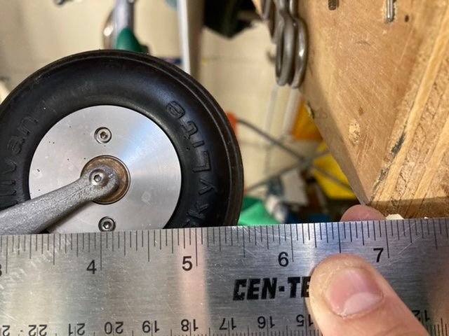

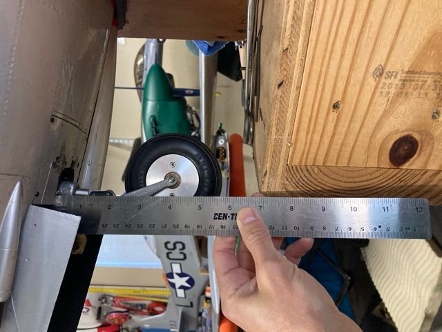

Originally Posted by Auburn02
Mine is on the bench, if you don’t get an answer by tomorrow I’ll grab some measurements for you.
If you could get me the measurement from the bottom of the nose wheel to the bottom of the fuselage, that would be great. I'm using Electron gear in it (with the Intairco strut) and I need to make sure I have the gear positioned correctly.
Thanks!
Bob
Thanks!
Bob
Morning Bob, on mine the distance from fuse bottom to bottom of the tire measured along the nose strut is almost dead on 5.5". And as mentioned, it is a 3.5" tire.
That's awesome, thanks! I really appreciate it!
Bob
ps. Its helpful to see that your's has a hatch for access to the nose wheel bolts too - I was contemplating that mod...
and that your's has a Sullivan Skylite wheel - just ordered one...

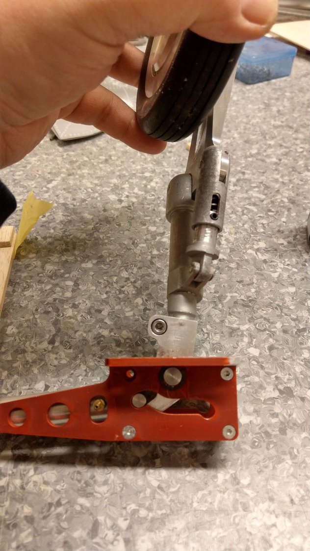

Old 01-06-2021 | 03:36 AM

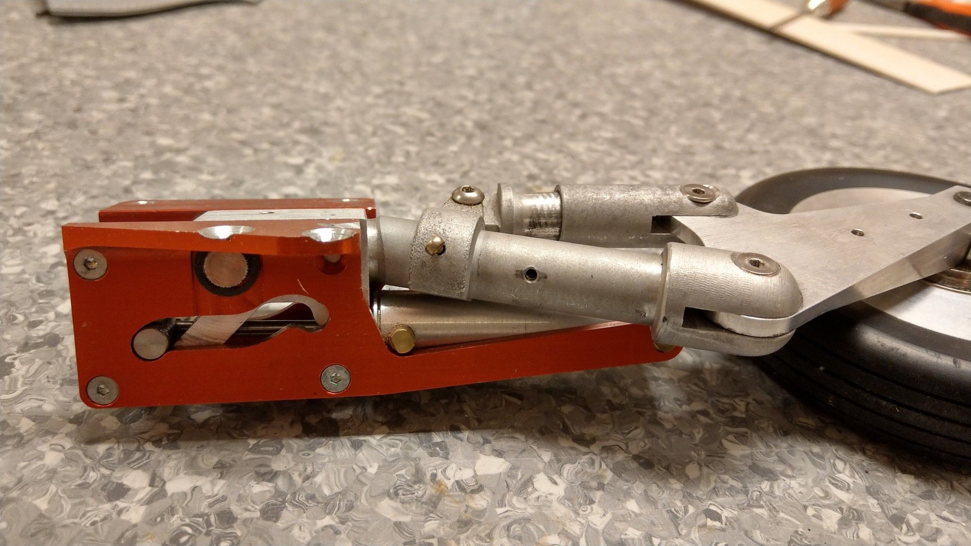

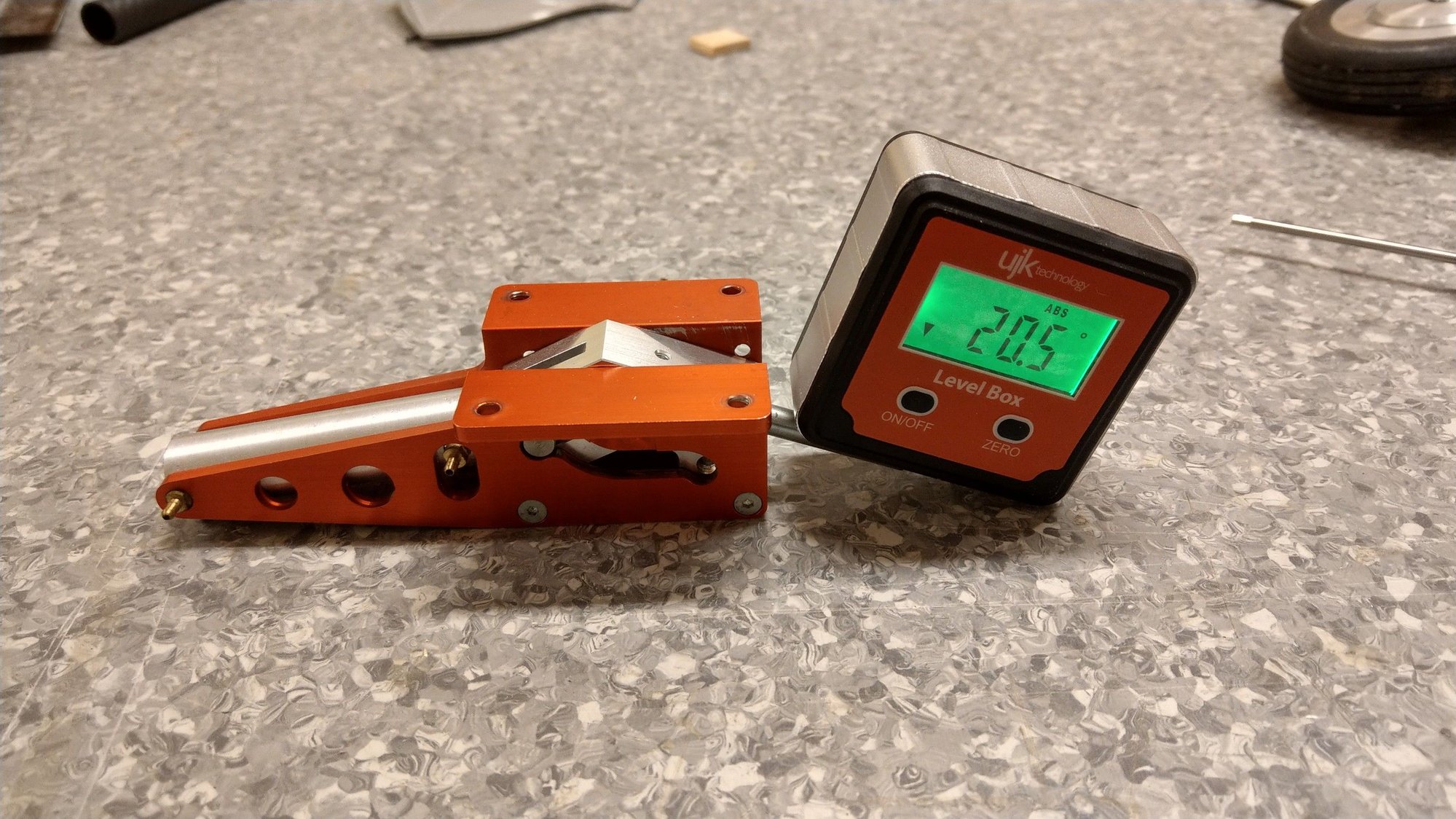

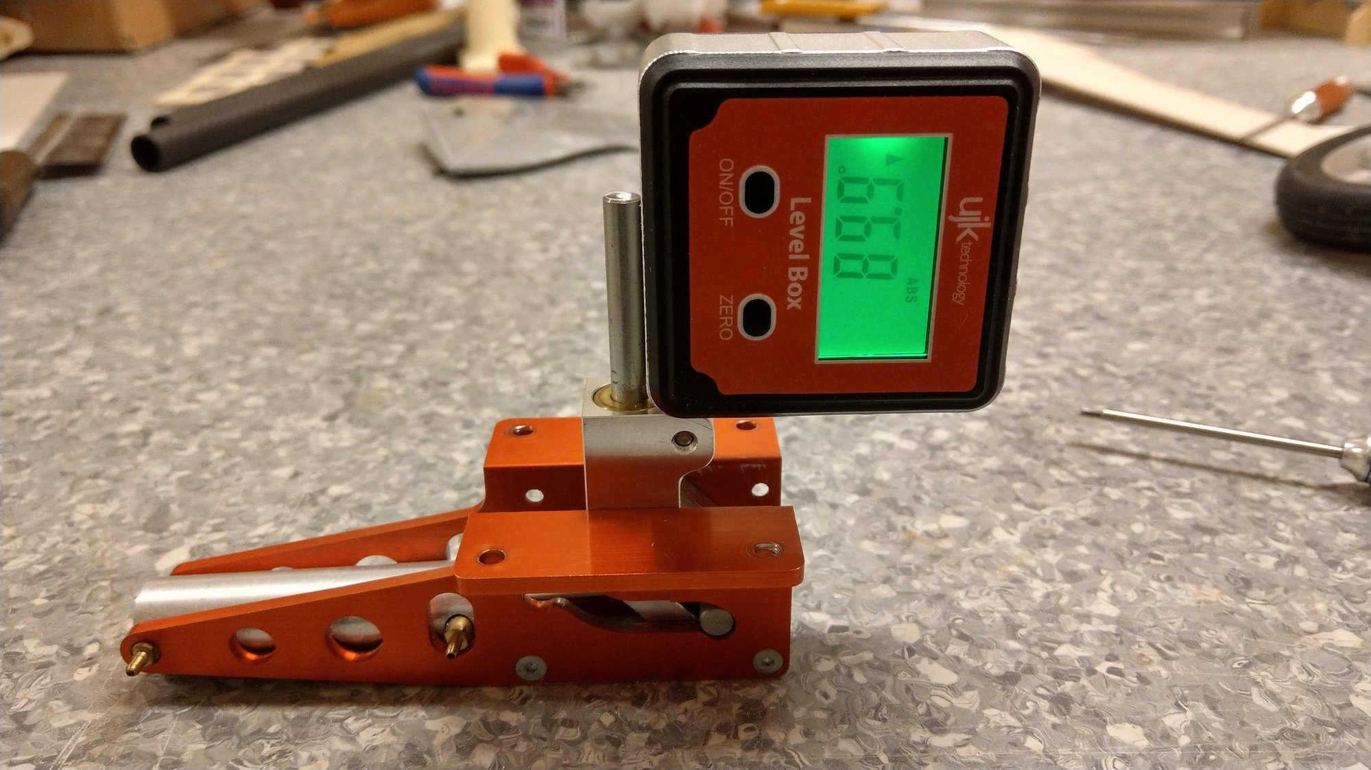

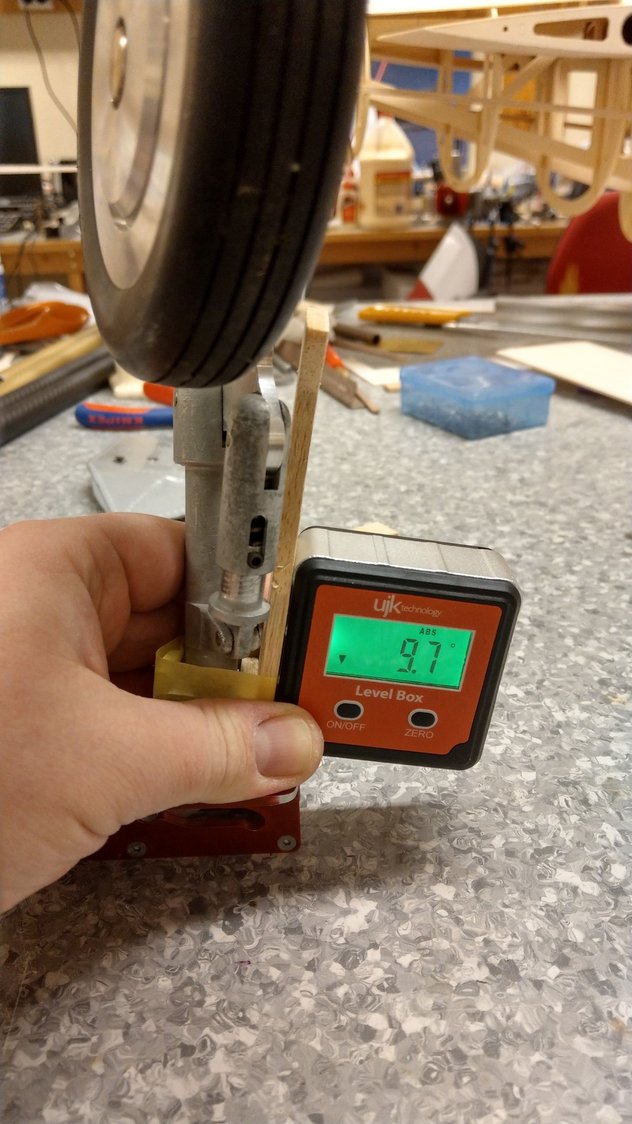

Joined: Aug 2004
Posts: 108
Received 5 Likes on 5 Posts
From: Molde, NORWAY
Bob,
I've got the gear out of the MiG to give you measurements, and here's what I found.
Nosegear : 110 degrees, Strut is 90 degrees to the retract mounting flange when in the DOWN position.
Maingear : 100 degrees. Strut is parallell with the retract mounting flange when in the UP position.
See attached pictures for more details.
Main gear in the UP position.
Main gear in the DOWN position.
Nose gear in the DOWN position.
Nose gear in the UP position.
skunkwurk (01-06-2021)
Old 01-06-2021 | 08:42 AM
rhklenke's Avatar
My Feedback: (24)
Joined: Jun 2002
Posts: 6,005
Received 34 Likes on 21 Posts
From: Richmond, VA
Originally Posted by Pondus
Bob,
Wow, that is really helpful, thanks! I appreciate your effort in doing that for me.
According to the Electron website, I can get the 100 degree retracts for the mains. For the nose gear, they say that they have an option for a reversed 100 degree retract.
Its less than the 110 degrees of the Intairco units (which I can't get any more anyway), but I think I can make it work by playing with the mount position and angle...
Thanks again!
Bob
