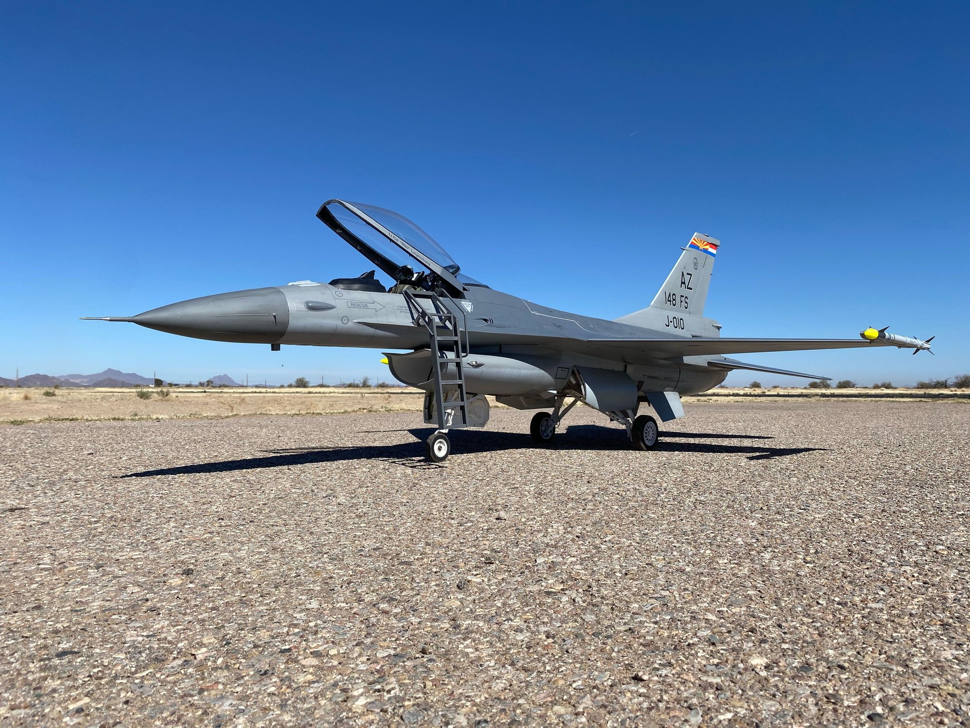

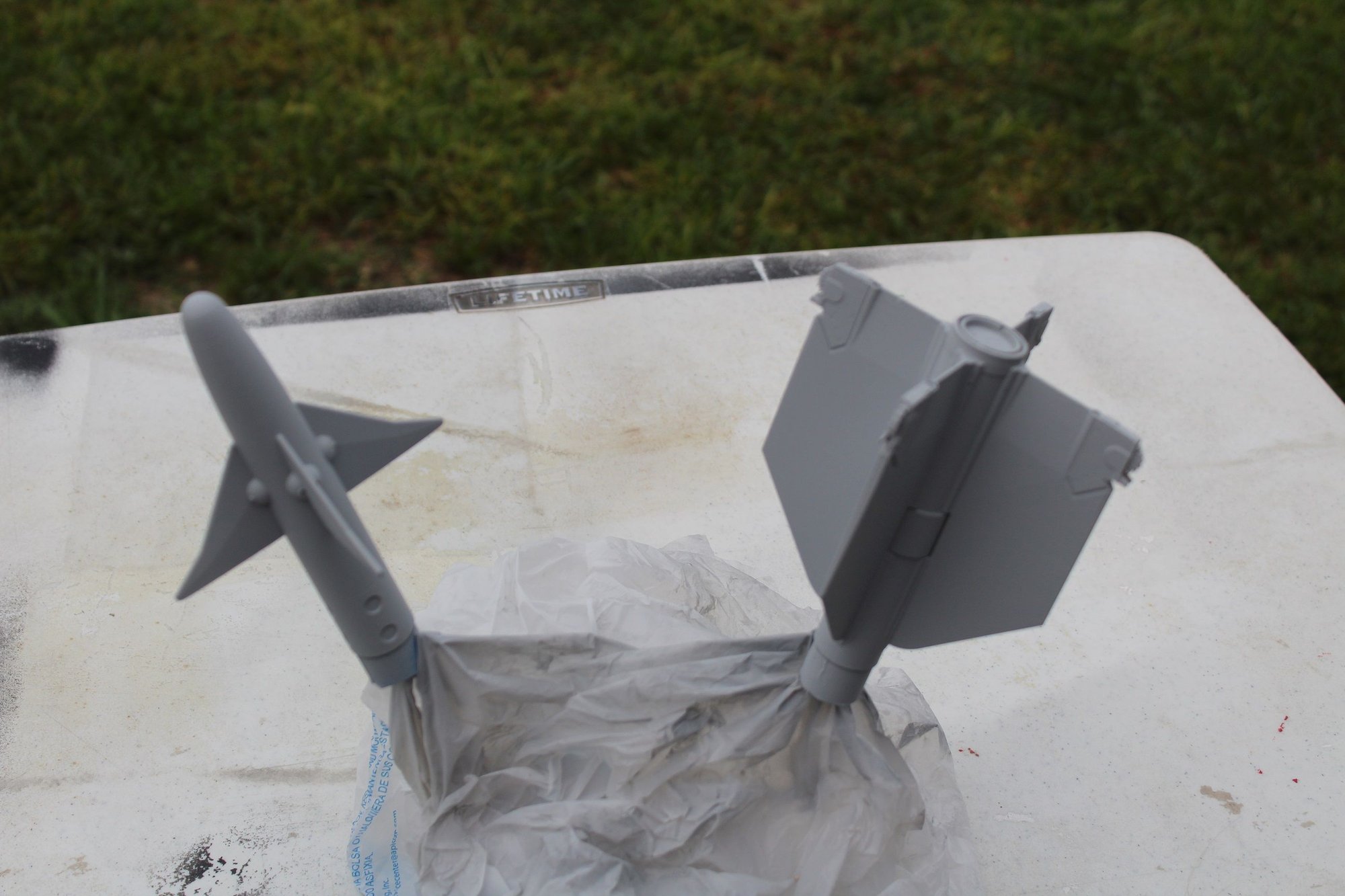

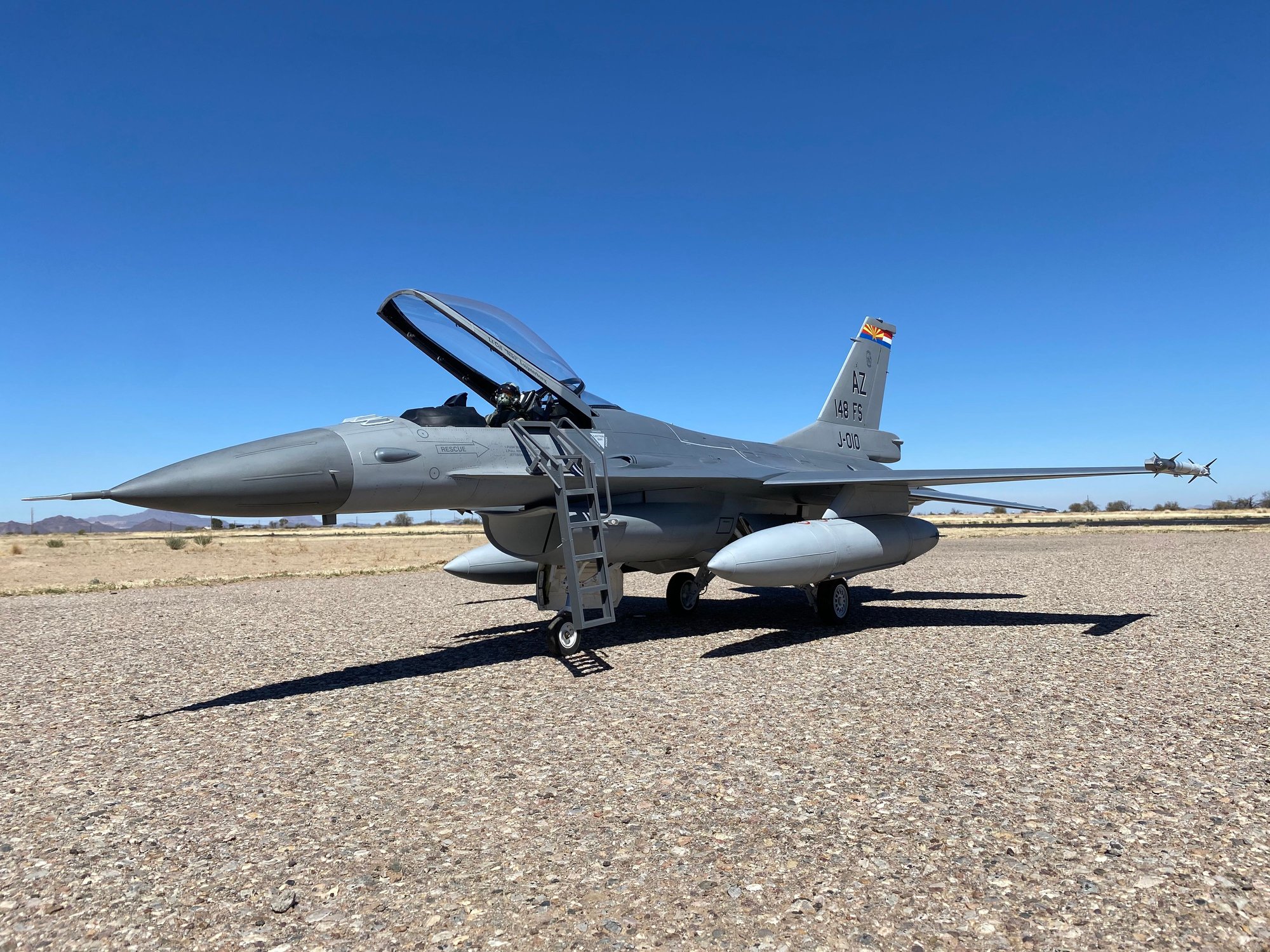

My skymaster 1/5 F-16 with boarding ladder, balancer and Aim9x and of course personalized chocks!
Zero sanding, this is what the 1/5 AIM9X head looks like after a quick shot of primer and model masters airbrush paint!

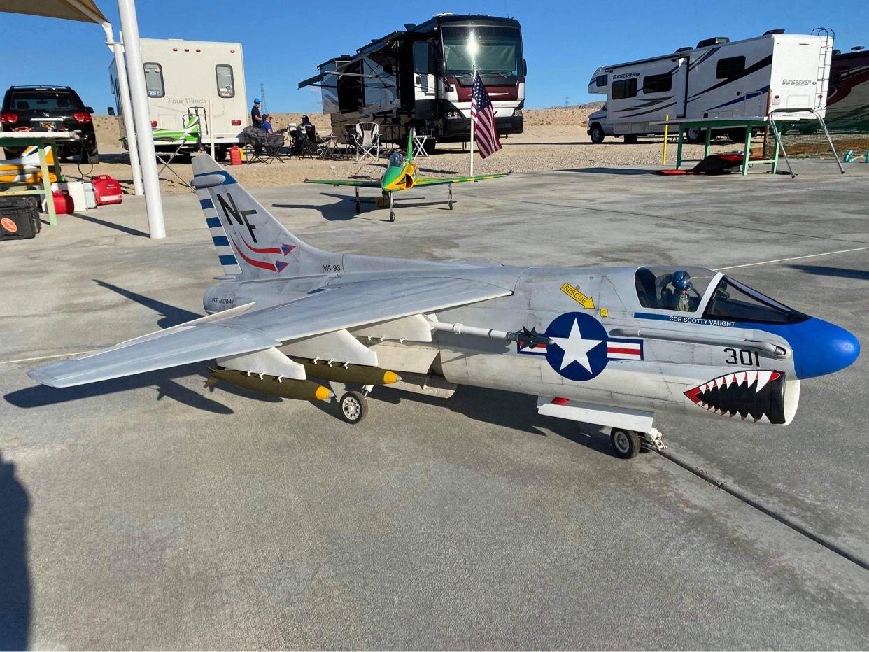

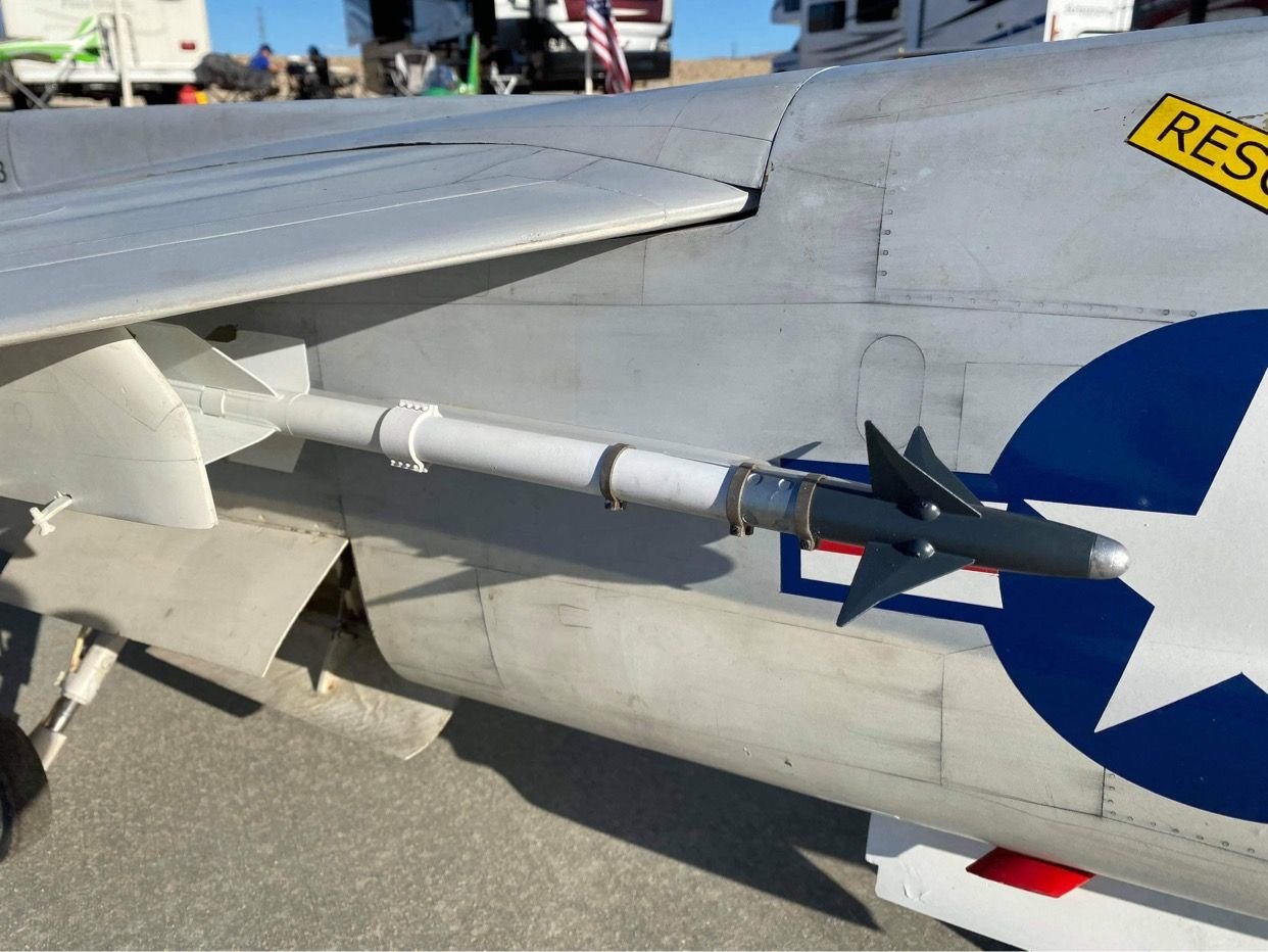

After 12 years, my A7 got a makeover with Spencer Scale AIM-9s. An AWESOME addition! Thanks Spencer!
I still need to add a couple stripes and decals to the Sidewinders. The 3D printed detail is incredible.
I think the new Sidewinders help me bring home the Best Scale Finish plaque at the Coachella Jet Jam last weekend.

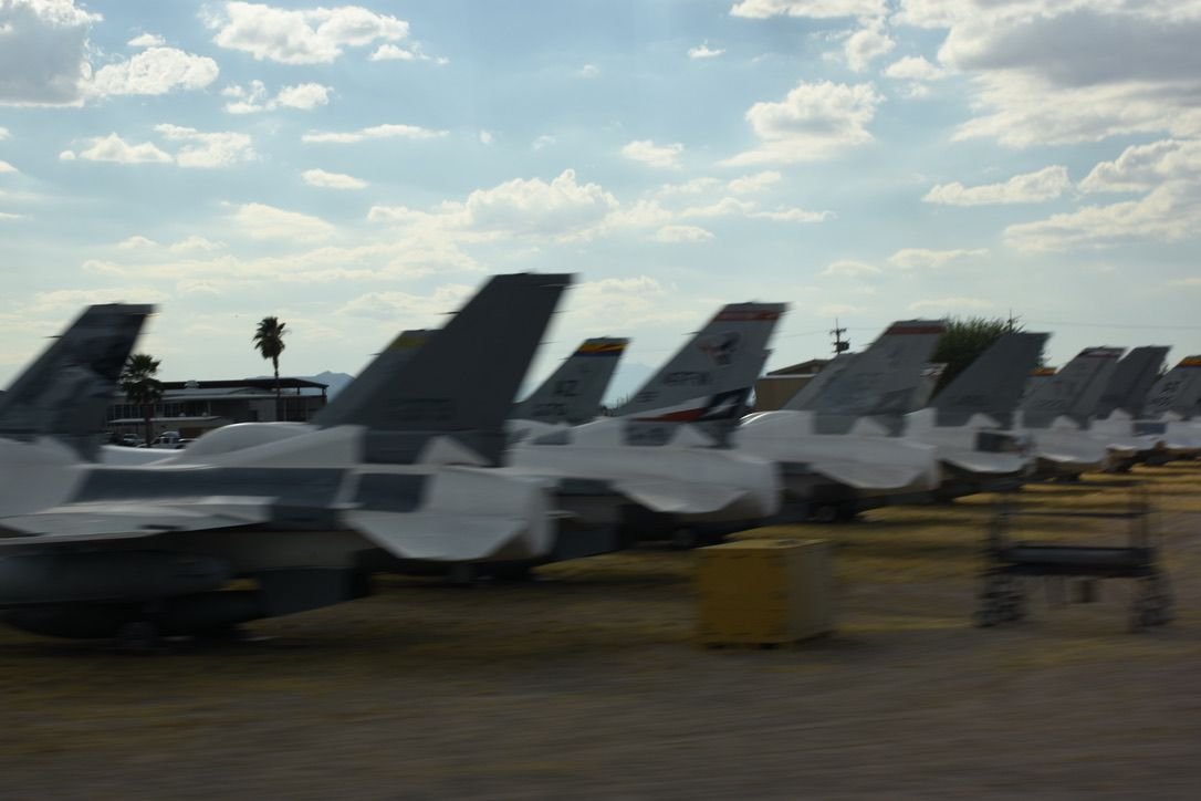

Interesting article, didn't know the F16 had these issues with flutter. So if the sidewinder helps reduce it is their video of wing flutter without the missle attached to the wing.
I was shocked back in 2017 at how many F16 were retired at Davis Monthan airfare boneyard. At the time the guide suggested there were over 350 F16 slated for destruction.

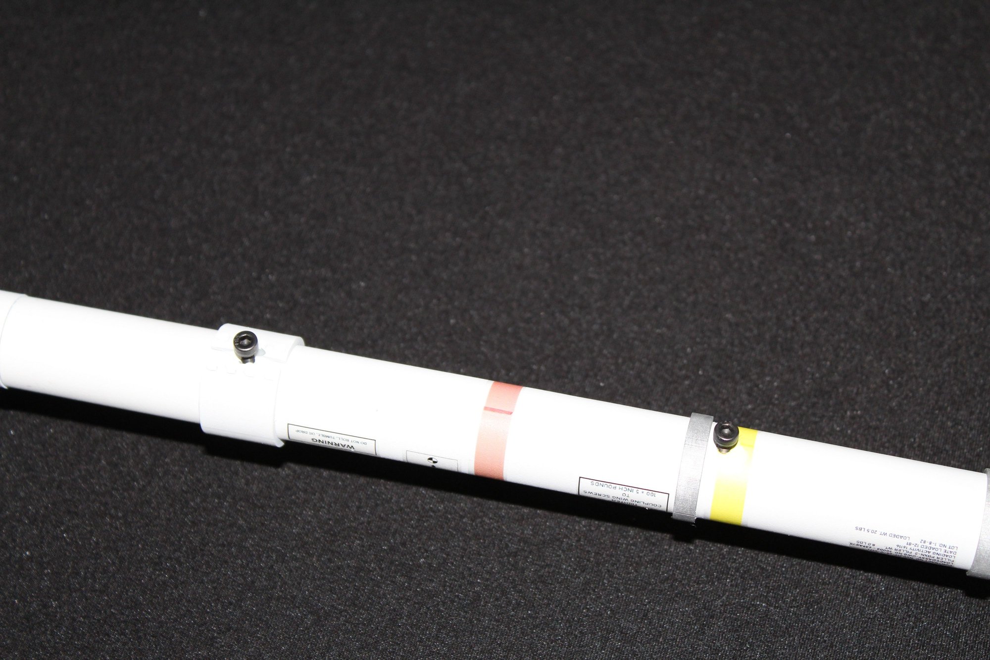

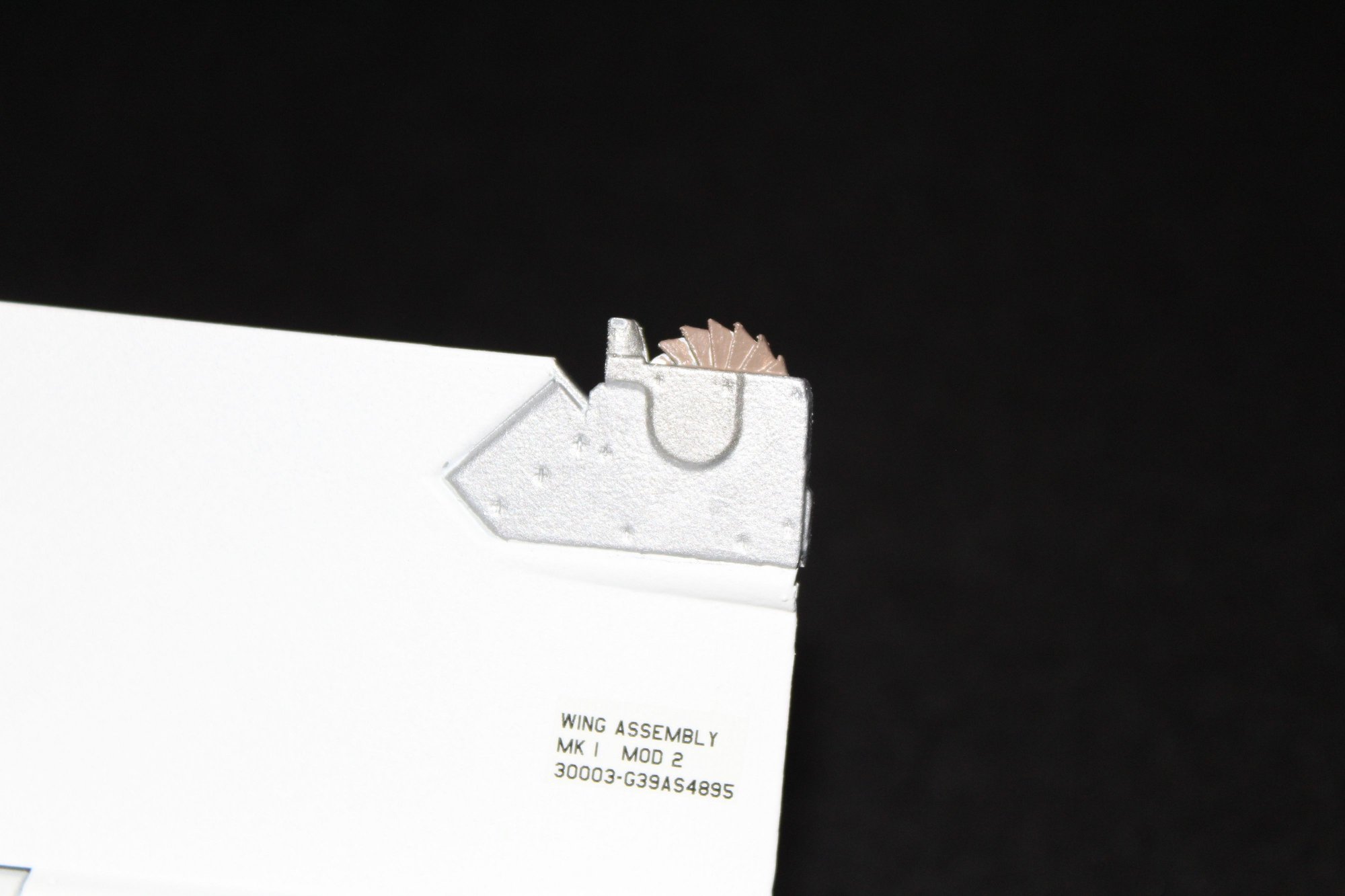

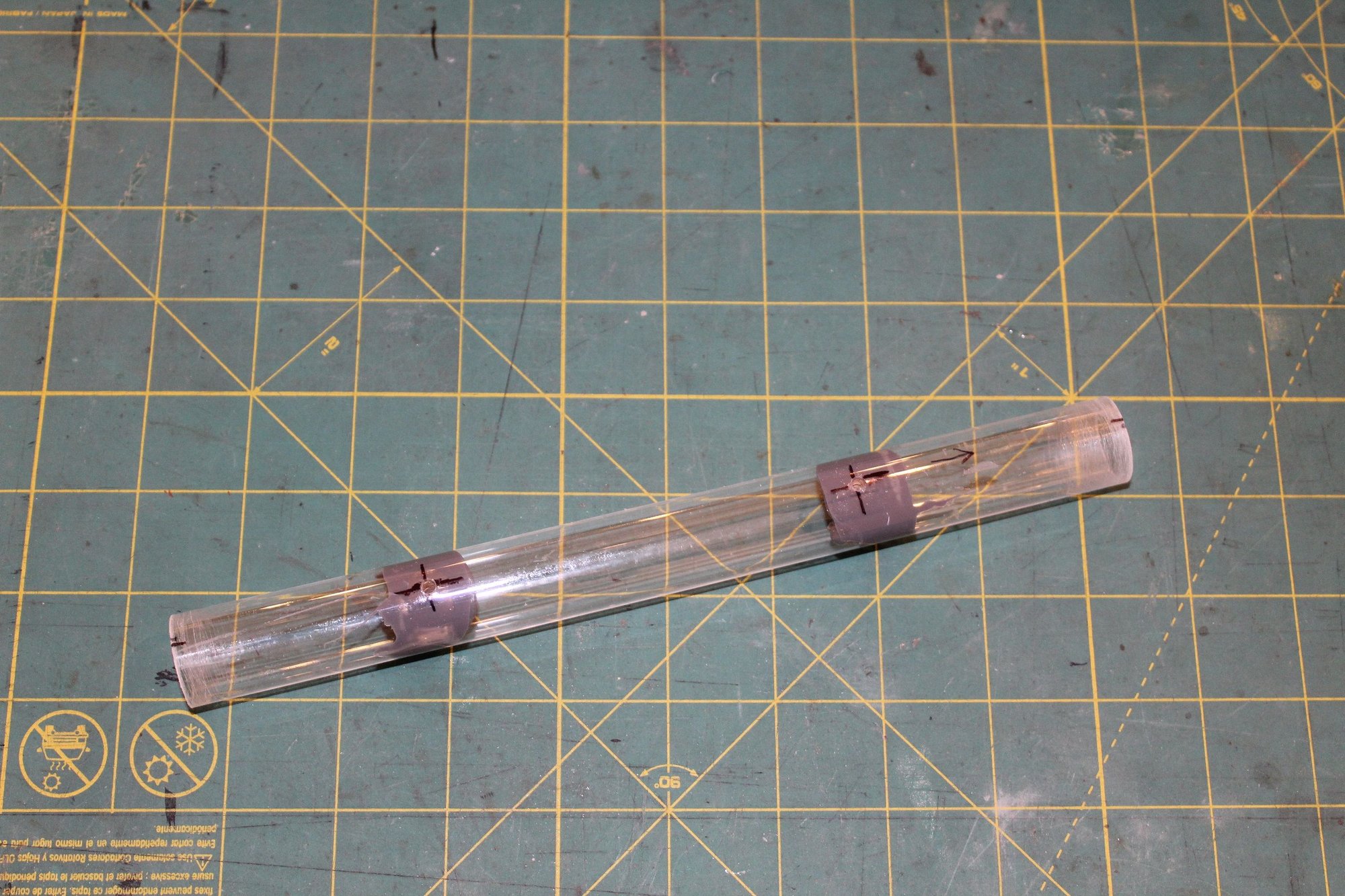

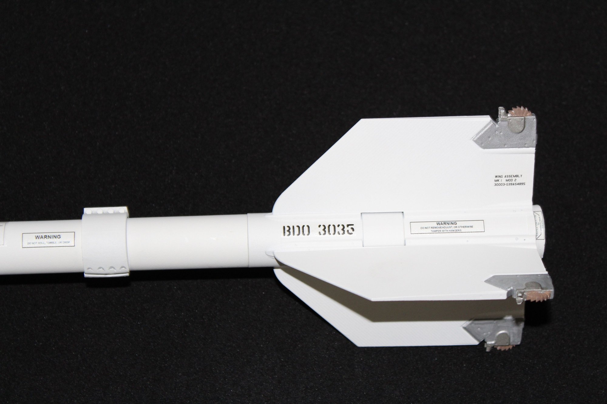

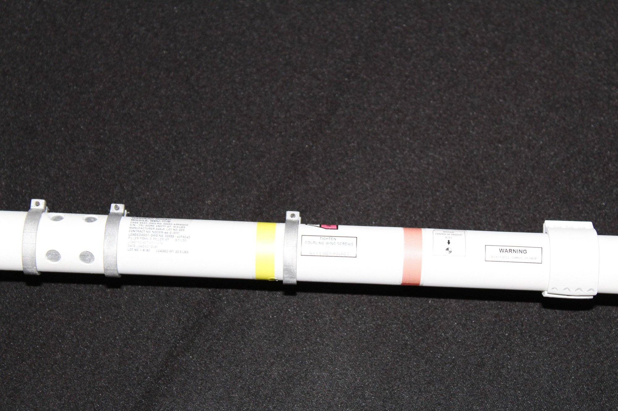

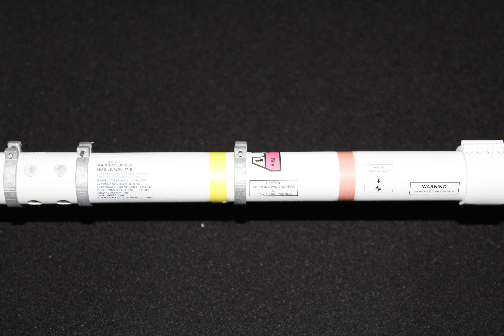

OK, I've assembled one of the Sidewinders. I said it before, but I'll say it again. The scale details of this thing is amazing! Here's a step-by-step guide to building these.
Step 1 - Carefully remove any parts attached to support rafts. A sharp knife (Xacto) works well here. I also light sanded the areas where the rafts were attached to remove any excess material. (Save some of the raft material to test your primer and paint on!)

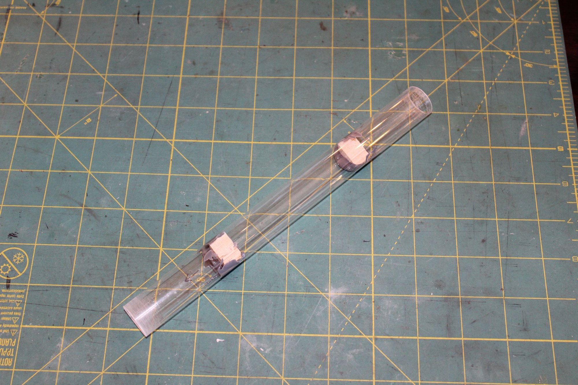

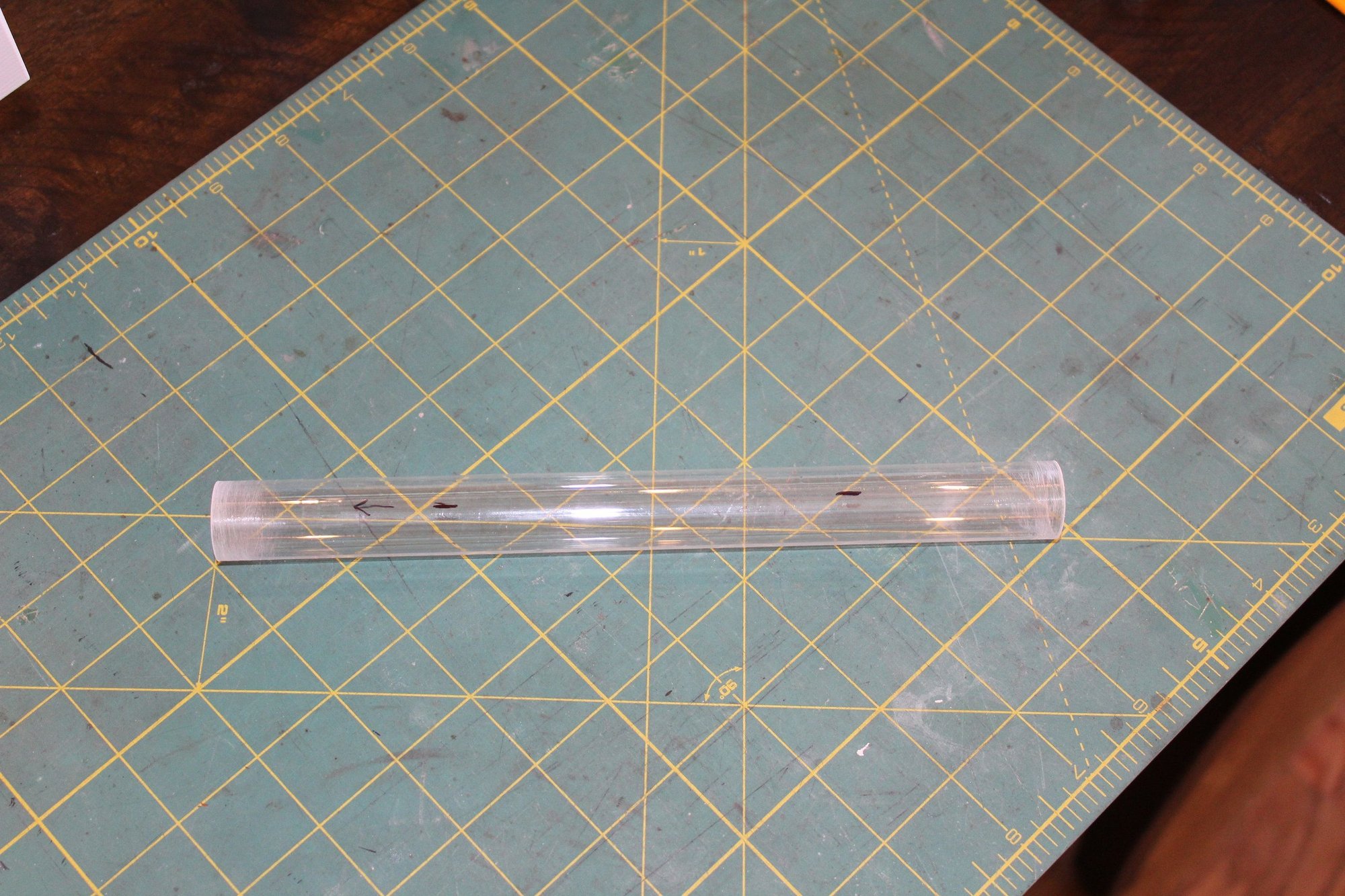

Step 2 - Cut your clear missile tubes to length. I'm doing 1/6 scale missiles. The full scale AIM-9M is 113" long, so 1/6 scale is 18.83". The nose section is 5.1875" from tip to tube join and the tail section is 4.6875", for a total of 9.875". This means I needed to cut the tube to 8.955", or right about 8 17/16". I marked my cut line and used a band saw to make the cut. I then sanded the ends of the tube to be flat and level.
Step 3 - Determine what type and where your mounting system will go. Spencer provides half circle wood dowel to use as mounting blocks for the interior of the tube. I'm using M3x12mm socket head screws for my mounting tabs. Mark the tube for your mounts, then scuff up the area where the wood will glue to and glue them in place. I used Hysol. If your mounts are going to be different lengths from the tube openings. make sure you make a direction mark on the tube! I also made a mark on the inside of the tube so that I can still see it after painting.
Step 4 - For what I did for mounts, once the Hysol dried I marked a centerline then marked the locations to drill for the M3 screws. I started with a 1/16 drill bit to make a pilot hole, then went back with a 1/8 bit to make the screw hole.

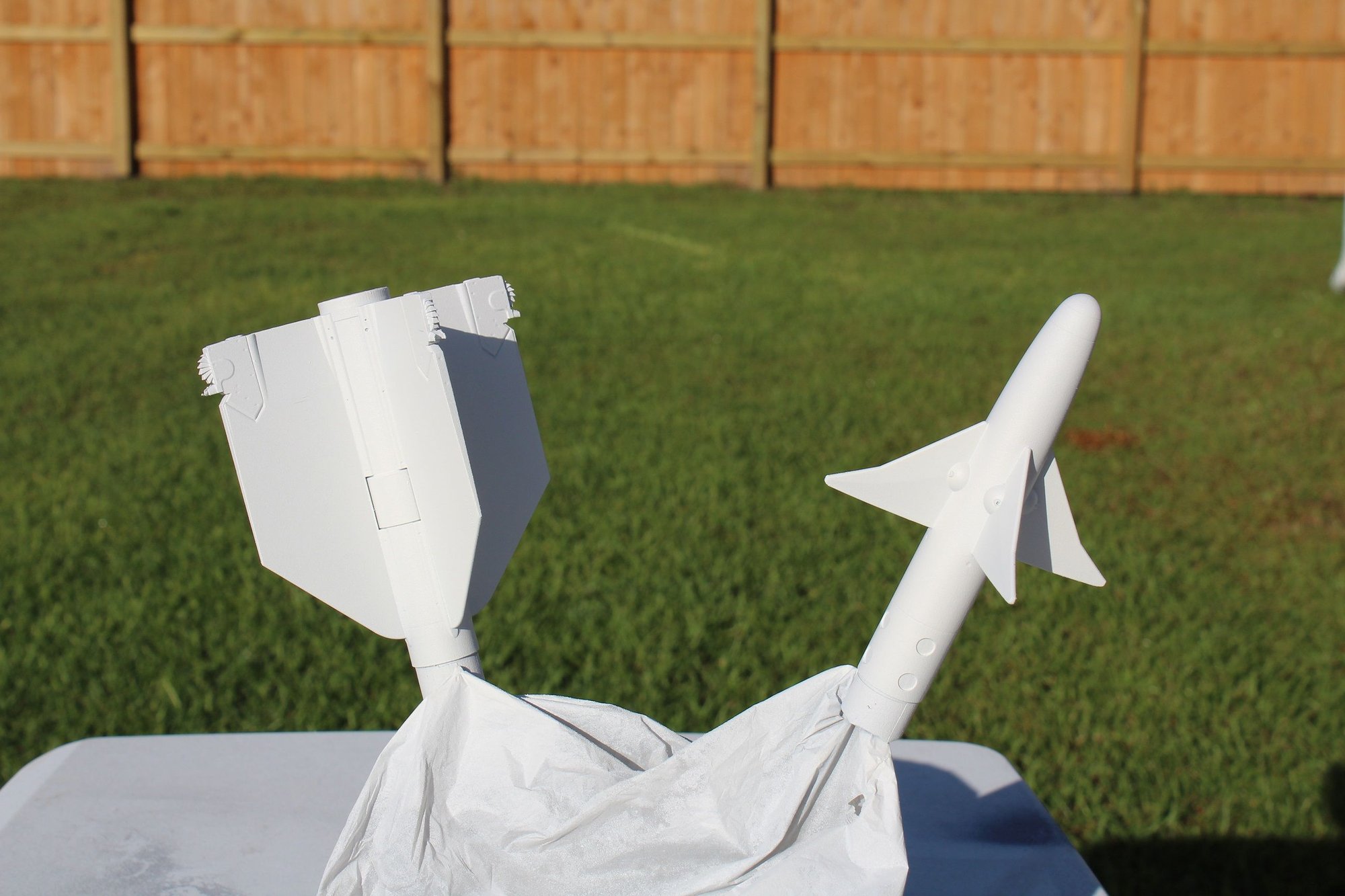

Step 5 - Prime and paint all parts. Scuff the outer tube before primer. I used 400 grit sandpaper. There are 3 "metal" band clamps that come separately, along with a larger clamp. I painted the band clamps with Model Master Aluminum. The larger clamp gets white. The scale details really pop once paint goes on!
Step 6 - Once all the parts are dry, assemble your parts. Be sure to slide the clamps onto the tube before gluing. There are 8 circles at the back side of the printed nose. One of the clamps will go on the line ahead of those, one will go on the join with the tube, and one will go approximately 2.5" back from the join. The large clamp will go approximately 2" ahead of the tube join of the tail section. When you glue the nose and tail to the tube, make sure your fins are all aligned. A good way to do this is to lay the missile down on a flat surface and have all four points touching the surface. DO NOT ever allow the missile to rest on the fins to avoid any possible warping, including after assembly. The fins are somewhat flexible because of the material used to print them. Spencer recommends making an ordnance case so that the missiles rest on the tube section only.

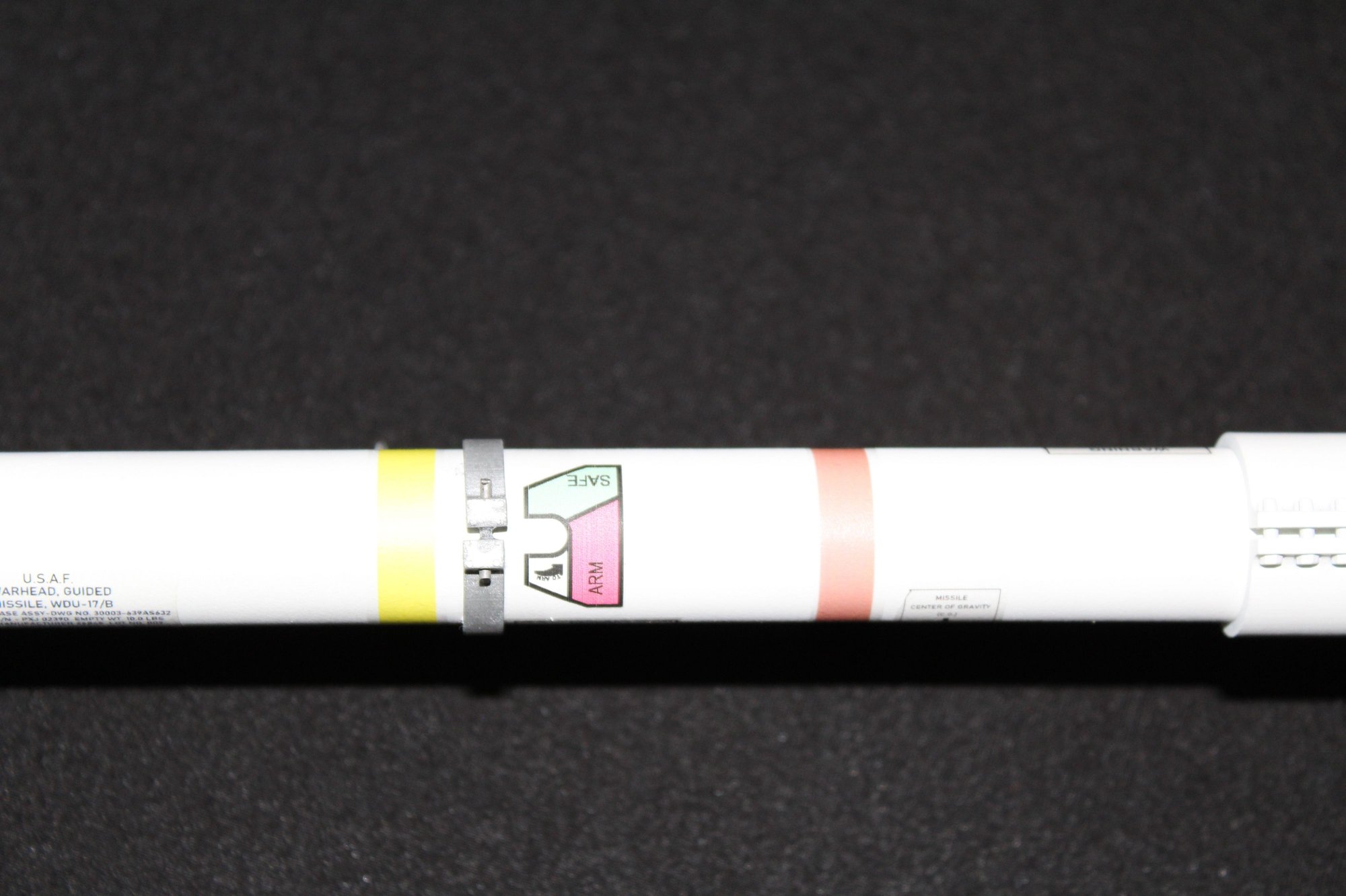

Step 7 - Detail and decal your missile!

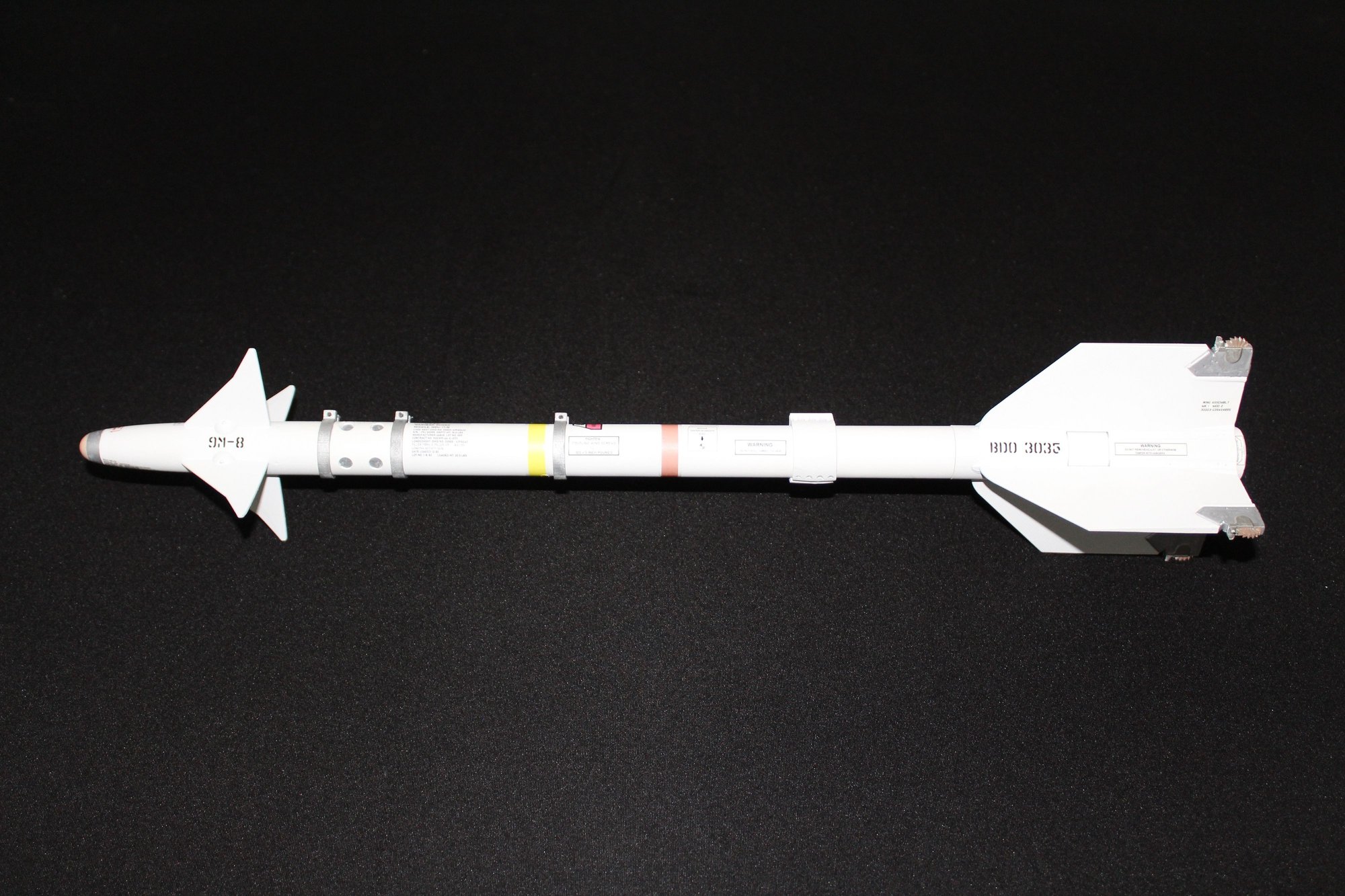

OK, here's where I went a little crazy. I was searching for examples of late 70's/early 80's pics of AIM-9s (as they were mostly painted white) and came across a couple 3D models on turbosquid. These models had lots of scale details and markings, and although Spencer makes a nice set of decals for these, I went a little overboard on scale. I took some time and made up a new set of decals based on what I found. Another thing I did was drill out the holes in the smaller clamps with a 1/16 bit, then inserted piano wire to simulate screws. I still need to add a couple coats of Testors Dullcote, but had bad weather moving in so I have to put it off till later.
And here's the finished product!
