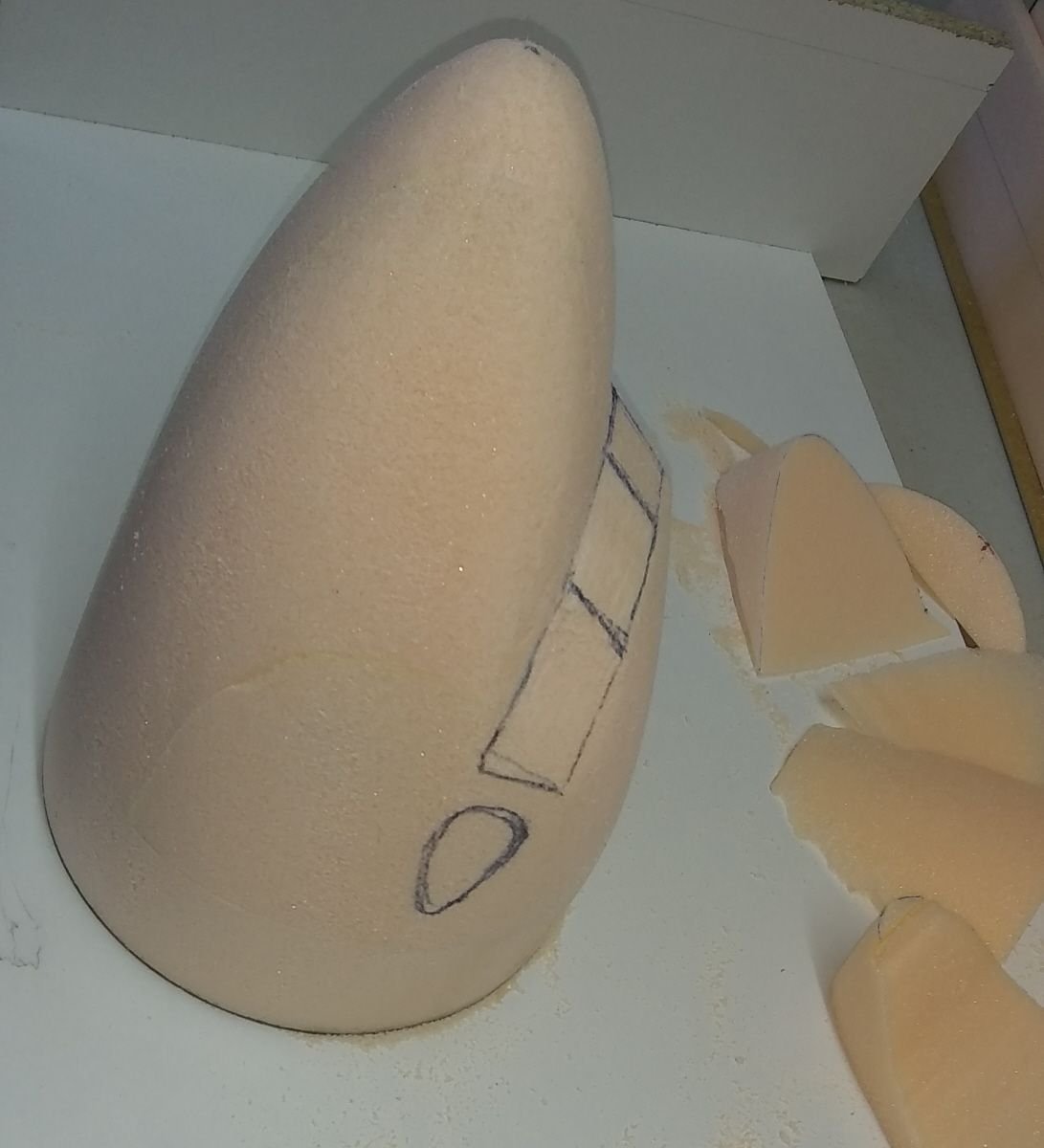

Here's the first stage, cutting a bit of foam to the trial sections.

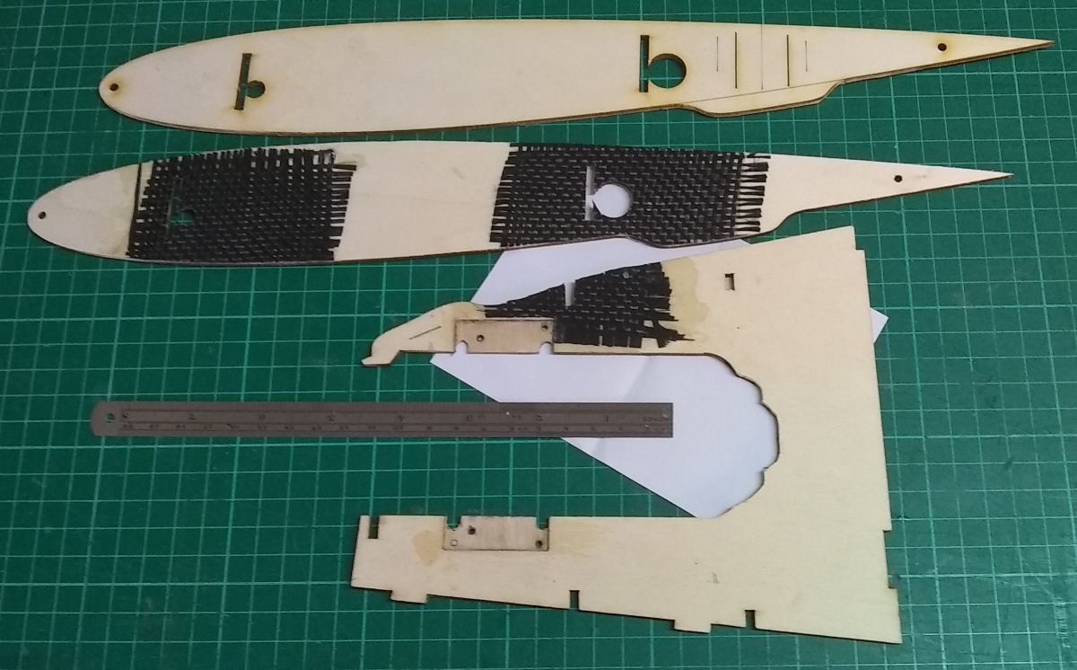

The Trident wing inner panels were hot wire cut from foam. I was working alone due to lockdown: nobody on the other end of the bow, so it wasn't easy. I made a lot of scrap but also ended up with two usable panels. The root rib is NACA 0013 (symmetrical 13% thick) and that blended to the section at the panel join to NACA 33012, which is a 5 digit NACA with a low pitching moment and 12% thick. Since the join is skewed away from the centreline by about 30 degrees the airflow will see this as an even thinner section. I use templates made from plastic laminate (Formica). I built in 1.6 degrees of washout in the cut.
I made two identical plastic laminate templates matching the planform and used them to make cutouts in the panels using a foam cutting wand bought off ebay.
I used a sanding block to cut 4 degrees dihedral into the root face and then made a foam ramp at 4 degrees to support the panels while I bored holes, using a sharpened serrated steel tube, for the wing joiner.
A 4" long hot wand cut the holes right through
Dihedral sanded into root. Hole bored for wing joiner.
14mm carbon tube within home-made epoxy/glasscloth sleeves.

Laser cutter was used for fuselage formers, all from 3mm liteply.
F1 is a plywood ring, 7.5" dia outside, 6.5" inside. Four were cut, each with four 1/8" holes for locating pegs.
The A and B are identical and join the nose section to the main centre fuselage.
The C and D join the rear fuselage to the front, so F1D on the built up rear section has 1/16" shaved off the outer edge for the balsa sheeting and is spit into two parts, right and left.
Also cut were the engine mount plate and root ribs.
The root ribs are reinforced with carbon cloth on the inside around where the wing supports and undercarriage supports fit.
The engine mount has carbon cloth all over on its stbd side
These four formers slide into the slots already cut in the fuselage. All are reinforced with carbon cloth on one side, applied with laminating epoxy.
The left two support the main undercarriage, the right two support the root ribs and the wing joining tubes.

Next job was to make the nose section.
Three thicknesses of 2" foam were cut on the old Dremel scroll saw to the side profile. The centre one had much of the inside hollowed out using the saw. The two on either side had some foam removed using the hot wand, and then the three pieces were glued together. A bit of the curved scrap that had been removed by the hot wire was added to make up the extra thickness.
Some of the pieces.
All the pieces glued together ready to add to the foam ring.
After gluing all these pieces onto the foam ring, with its plywood ring former F1A, the whole thing was carved to shape (messy).
As part of the carving process the flat spots for the cockpit windows were made.
The whole thing (except for windows) had its outside covered with 50g glasscloth and epoxy resin (messy again).
Some of the pieces.
