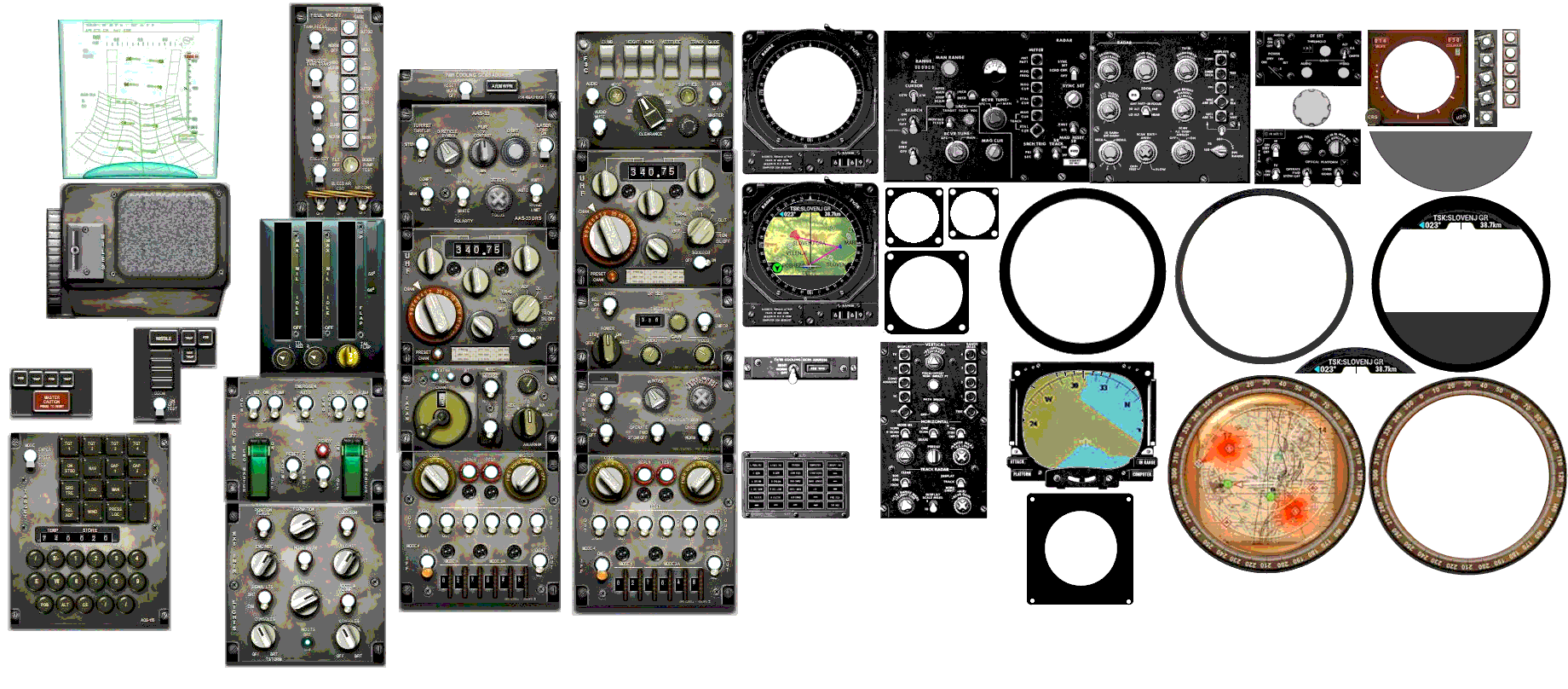

Printed Resin Instrument Panel
I provided documentation for an CAD .STL file with which we will print the plug for an RTV mold permitting endothermic resin to be used.
From:
To:
To:

Hydro,
No problem! I didn't mean to sound curt. I have been very fortunate to have the luxury of being able to reverse engineer these from
CAD/CG created for film productions. At the degree of detail contained in each they are worth considerably more than the $160~$190
each of these cost.
I welcome any and all contributions. Without them this project would fall short of it goal. Additionally we were fortunate to find a CAD
artist in Argentina to create the 3D CAD for our cockpits at a reasonable price.
From This:
To This:
each of these cost.
From This:
To This:
