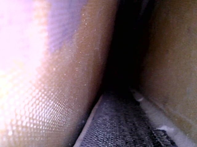

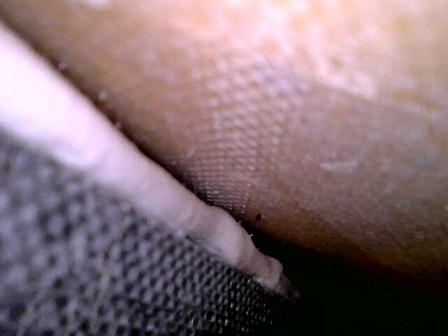

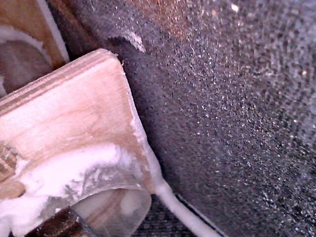

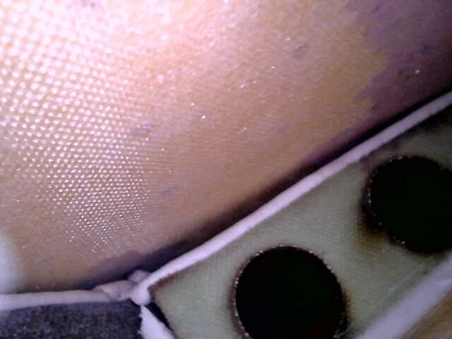

I have a replacement composite wing for one of my jets. I happened to notice that there was a decent amount of movement along the whole top of the wing. When I borrowed a camera and scoped it, I can see about a 1/16 to a 1/8th inches gap between the lengthwise vertical wing structure and the skin. There is also asimilar gap between the wing ribs and the top skin. Even a couple in the front. Almost like the supports were a bit too short or not enough glue was used. This includes the landing gear area also and some point at the leading edge. This lack of attachment explains why the wing top skin is floating up and down so much.
Because this gap runs the length of the wing the majority of the supports I will not be able to reach to add additional glue. Is my understanding was that the top and bottom composite skin being attached to the vertical supports are what gave the wing its strength. Kind of like a engineered joist. So I am not sure how structurally sound this wing would be at 200mph or bank and yank turns. Nor do I want to unnecessariky risk my turbine and electronics. Therefore I am seeking the advise of some fellow builders. Do you guys think this wing will be safe?

This is the landing gear area. You can see a lack of glue and a large gap between the support and the wing skin.
This is near the wing tip, as you can see, the top skin is still not attached
Gap between the wing skin and the lengthwise support.
Gap between the vertical ribs, lengthwise support and the wing skin

I would not trust it. If you can see movement on the ground imagine what it would do in the air.

good thing not to fly this wing. Both wing skins must bond with the internal structure. When you build a wing mold, tuning up the perfect internal structure takes a lot of time - trial and check and again and again - so that the fit is perfect and the gaps between skins and the structure are minimal.

In the first picture it looks like it delaminated. In the next few looks like it was not a good fit. DON'T use that wing. It is not a matter of if it will come apart as apposed to it WILL come apart.

At first i thought delamination, but when you look at the 2nd photo you posted, one side of the rib has a good contoured joint, so it looks to me like the rib and wing skin never made contact. Tough one to fix yourself, hope the mfgr makes it right for you with minimal waiting

I saw the same thing on a Krill 3m aerobatic model someone in my local club bought. They had skipped putting adhesive on all but the leading and trailing edge joint. It’s impossible to fix. They gave him new wings.

Just spoke to the manufacturer. They were very receptive to the issue and we are working on replacement options so it looks like things will be handled. I appreciate everyone's feed back.

To me it looks like the mold halves weren't fully closed. The lack of prep on the bond line is an issue as well.
