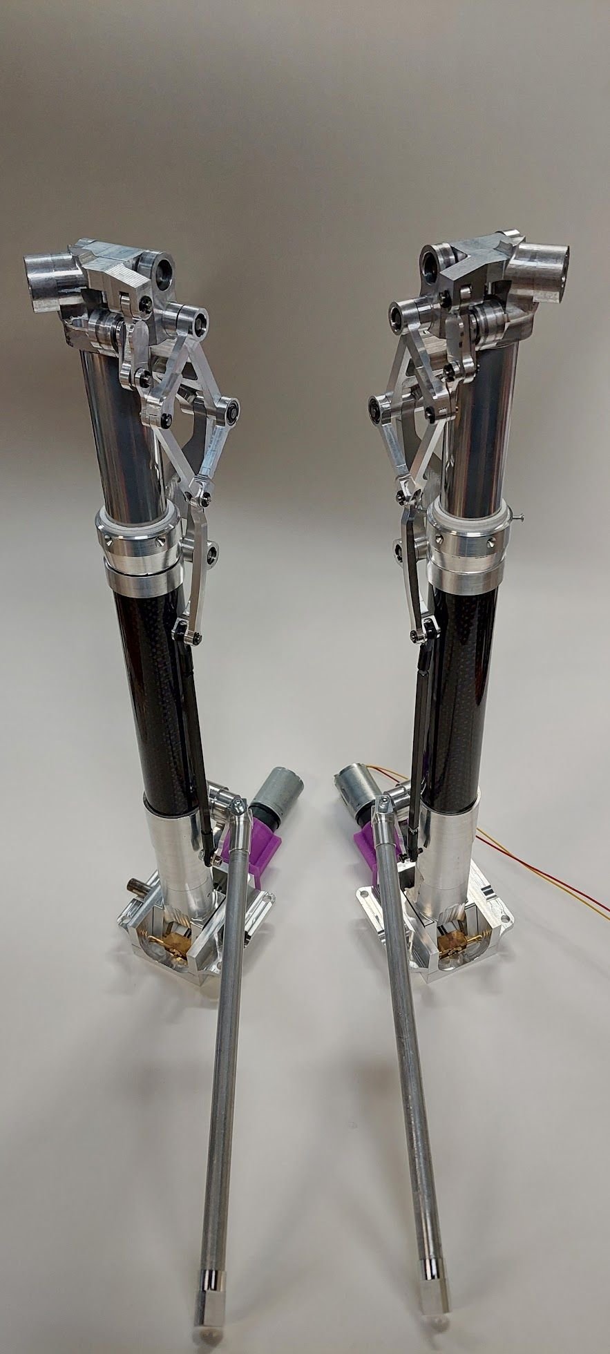

While building airframe, parallel project was to figure out how to make landing gears. Mig-21 gears are far from simple, and even though scale is big, parts tend to be quite small.
After design process I printed parts and tested their function and fit. After great success there was time to materialize them in metal, part by part.
First iteration printed.
Testing fit and function.
Time to change plastic to metal.
Almost all parts in metal.
Before I started building main gears I built nose gear, which I thought to be like walk in the park. Well, it was not. Unfortunately I have not really pictures from that project.

Great job on the mains!!

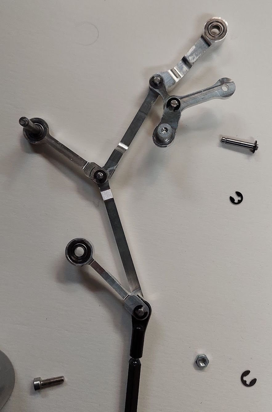

It took some time to make all the parts and there is a lot of them. Even making those small axles took several evenings.
Links to operate wheel rotation.
Pretty much done.

Those legs are a work of art! In fact the whole project is. Nice work.

I would suggest doing a load analysis on those actuating arms ..
at that physical size I’m not sure if aluminum is up to the task as the preferred material to make them from .
it might turn out you’ll have to switch to a harder metal .

You might be right.
Having simulated everything in my head and the question "will it survive", makes this hobby interesting.
Al7075 and steel have been used everywhere I think the load is greatest.
