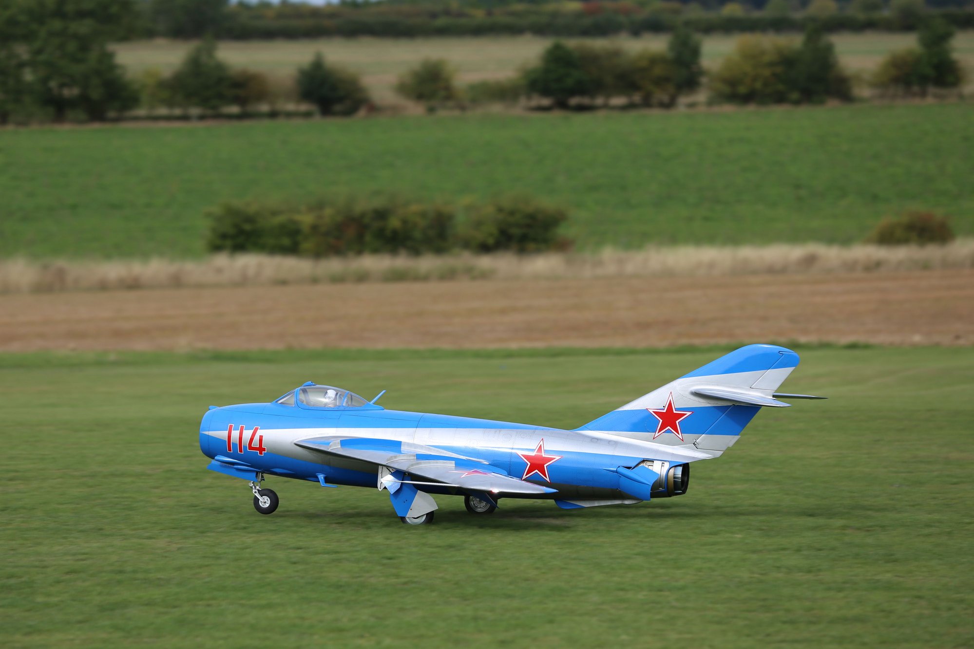

Two Migs flown today at the U.K. home of model jets Abingdon. Now identical in set up with RB owner swapping to Core before the test flight, I set the model up exactly as mine and both flew without a single peep of trim. The JetCat P-220 Rxi set ups give 9+ minutes and perfect scale power. Landing roll in the 12mph wind we had today was 45’ or less!
Anyone without assistance the model needs little to no expo and as much movement you can get.
Our gear is both running small low C 2s Li-Po batteries and we need to slow up and stol climbing to reliably get the gear away. I’ll try a 3s Li-Fe next time.
Awesome models though.

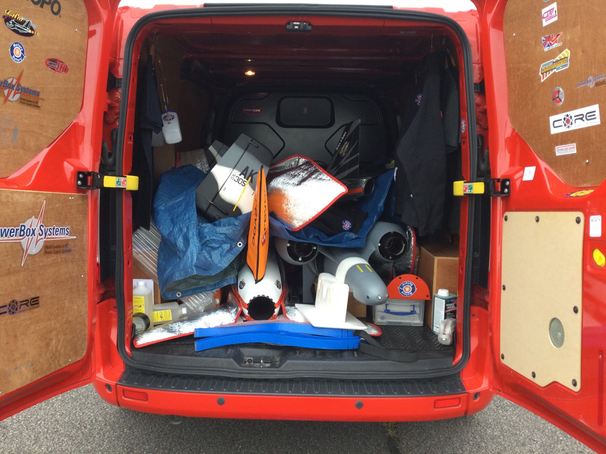

Plenty of room for a couple more jets

I generally pack my van like that…just not with the Mig
